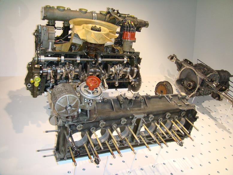

tomeric914
I want to see a flat 12 in a (stretched) 914. This is a pic of an original 12, but the bird board link is about someone who put two 3.0 liter engines together.
http://forums.pelicanparts.com/porsche-911...-flat-12-a.html
