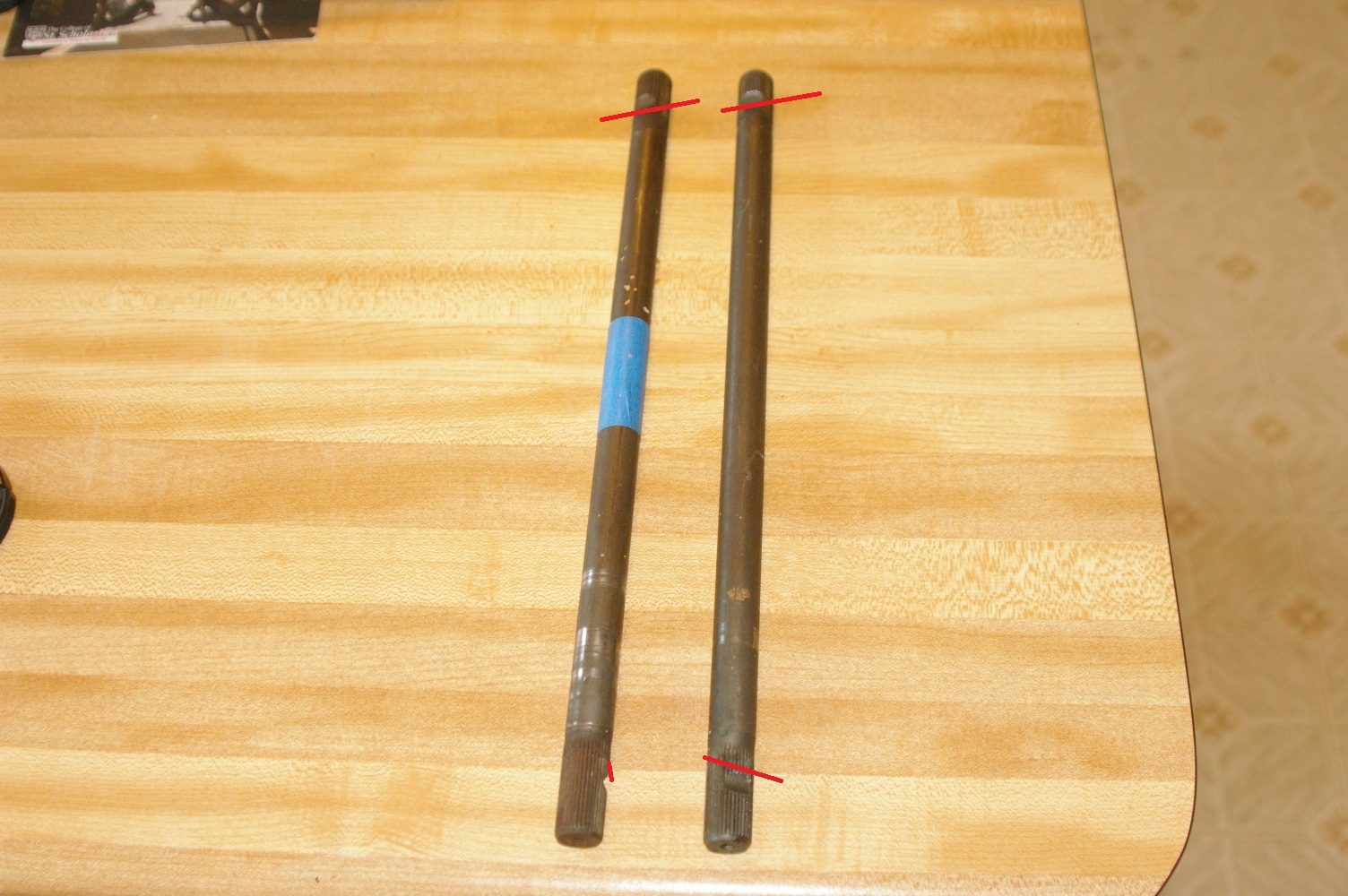

Ever since I put my steering wheel and shaft in it's had an annoying "over center" notchy feel to it. Well I deceided to fix it and tore it apart today. I had read some threads to swap the shaft end for end to correct the problem but that doesn't index the u-joints any differently. I dug out a shaft from my spare parts to compare and the index slots are about 90 deg. different between the two.
Anyone else run into this before? Is there also a difference in the u-joints?

QUOTE(Phoenix-MN @ May 17 2013, 09:31 AM) *
The geometry is different between early and late cars.
When i installed the '74 steering column in my '70 car i had to re-notch the shaft because everything is aligned differently.
It was a *lot* more work than i had anticipated.
The mounts for the steering column are different early to late and the u-joint on the back of the column is not in the same exact place.

Thanks, that makes sense. Mine is a '71 and I had spare parts from a '74, when I put it together I must have used the shaft from the '74 (IMG:style_emoticons/default/mad.gif) Hopefully now when I get it back together all will be well (IMG:style_emoticons/default/biggrin.gif)
(the early one is the one with the tape on it)

I read this yesterday and I went out an looked at the shafts I had. They are all the same length but all three are different. If you line them up with one groove at the top all the bottom ones are at a different angle.

I have already differentiated the column differences. Let me see if I can break down the upper shaft and intermediate shaft differences.
Upper shafts:
Upper shaft early 70 had larger diameter at steering wheel hub/ spline differences. U-joint was unique to the shaft and serviced as part of the shaft assembly.
Late upper shaft had separate U-joints that are still serviced under 930 Part numbers. Oddly it shows 1 joint required for the 9144 and 2 joints for the 9146.
Will try to keep the 6 cyl parts out of this as its confusing enough.
Intermediate shafts:
9146
Early thru 71
72 on
72 on required 2 of the same U joints.
Column:
72 9146 used the 4 cyl column with the electric wiper switch.
I just figured out why. Early cars had an issue with the upper U joint, they changed the column and upper shaft which slightly altered the angle of attack on the intermediate shaft. This explains the keyway timing differences on the intermediate shafts.

Update.... I have put everything back together with the early shaft and it rotates smoothly now with no binding (IMG:style_emoticons/default/piratenanner.gif)
