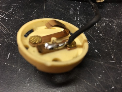

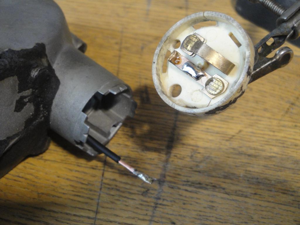

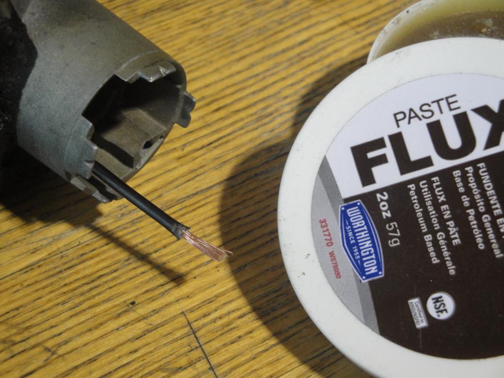

With the 57 terminal cut as shown, and your wire cut and striped back just slightly, use a soldering iron to tin both. Its critical. In the photo here I cut back to much insulation. I redid this but did not re take the photo. You want insulation down right to the solder joint. If you don't, it will cause an internal short.

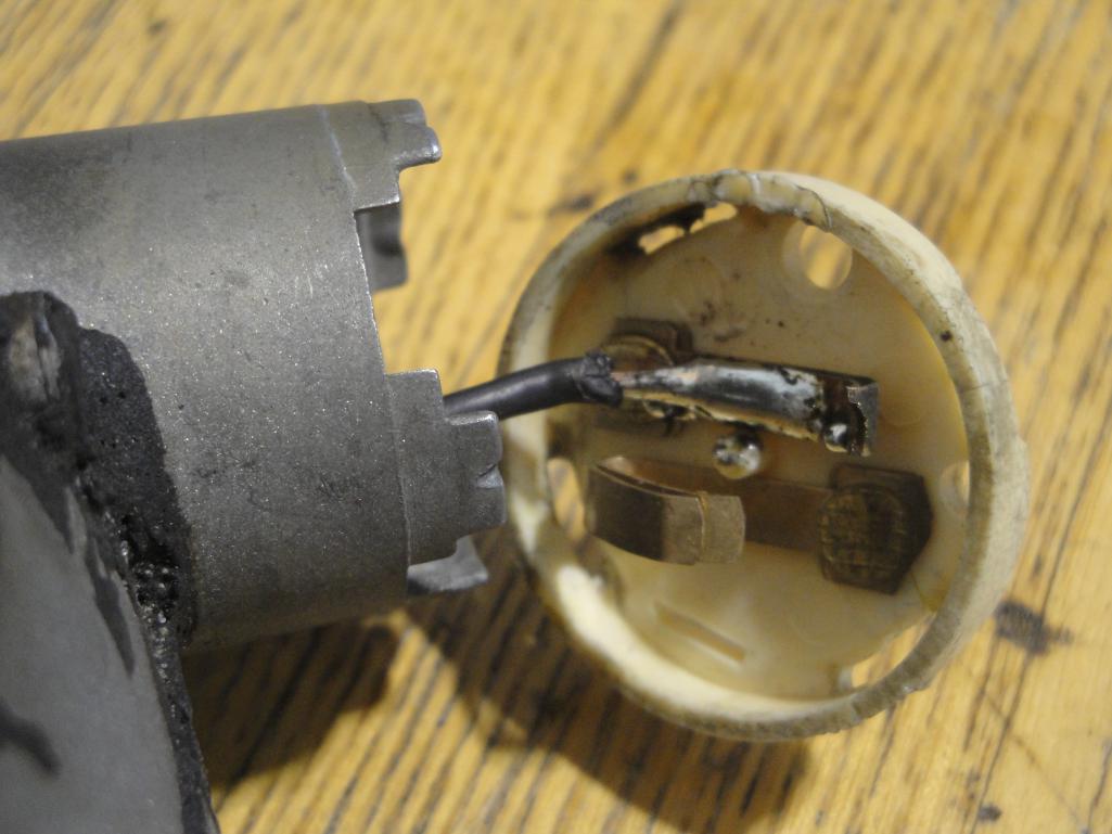

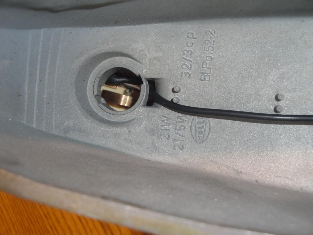

Next solder up your connection. The direction you come in is critical. Be careful of the plastic on the terminal cap. Don't melt it. Come in from behind the rivet holding the 57 terminal. Use a heat sink, like my extra hands. Once connected, I use a small rubber hammer to tap the terminal back on to the housing. Be gentle, use common sense here as well. Just tap it on, and work your way around. Pay attention to the wire, as it will need to remain clear of the remaining terminal inside for the 1157 bulb. See photo. You will notice the wire is not set in the photo, its because this unit will eventually be sold. I used it for demo only.

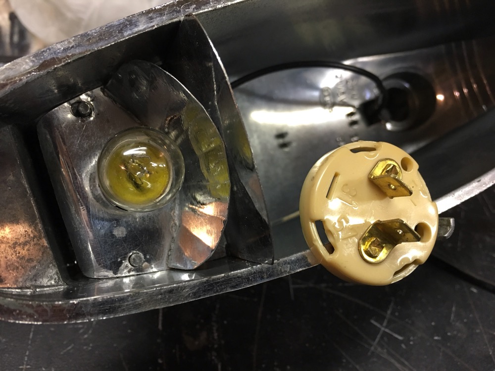

I test every unit I build here before I send them out. I use a 12 volt power supply. Hook up to the 31 terminal for ground. The BL will be the 20 watt side of the 1157 bulb. The 57 terminal will be the 7.5 watt 89 bulb in the refractor I built and you just installed. If you have any questions. I will help you.

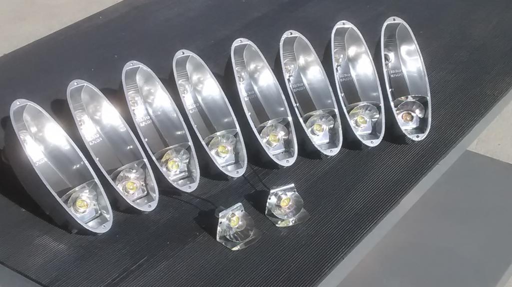

Here is what I will ship today, I am caught up! (For Now)
