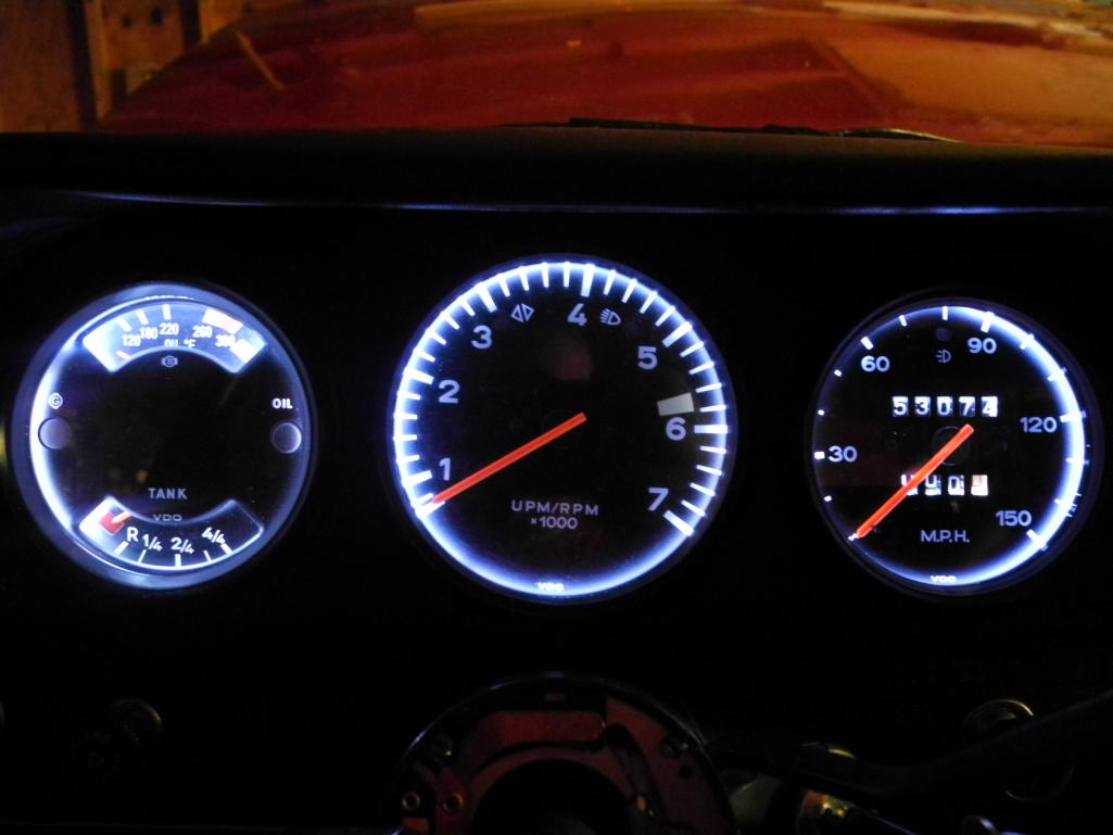

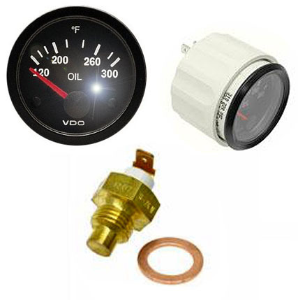

I'm sure there is a sender out there for your gauge. I went a different route and bought this from ebay for 50 bucks.

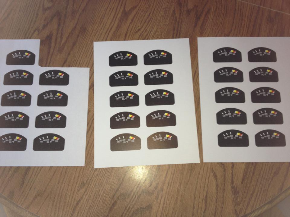

I then dissembled the new gauge and stuffed it into my old fuel gauge. It actually fits very well. If you already have a true combo gauge, then this may be even easier. I had to print off a new gauge face, you can just reuse yours.

QUOTE(timothy_nd28 @ May 24 2013, 01:41 PM) *
BTW (IMG:style_emoticons/default/welcome.png)
How did you "print off a new gauge face"? (IMG:style_emoticons/default/smile.gif)
timothy_nd28
post May 24 2013, 01:38 PM
Posts: 2,299
Joined: 25-September 07
From: IN
Member No.: 8,154
Kinko's. PM me, I have extras

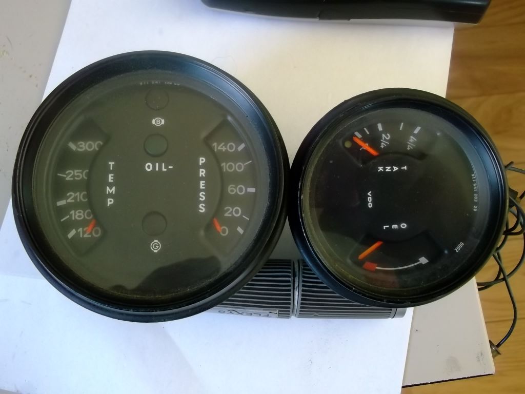

QUOTE(timothy_nd28 @ May 24 2013, 03:38 PM) *
Thanks for the offer on the gauge face. but it's not quite what I'm after.
I just thought you had a line on how to make the little gauge emblems.
I'm thinking I have a /6 combo gauge oil temp one side and pressure the other, but then I lose my gas gauge. The 911 gas gauge is small and if I make a new face and some mods to the can, I bet it would fit at the bottom or top.

QUOTE(timothy_nd28 @ May 24 2013, 10:41 AM) *
That looks great (IMG:style_emoticons/default/beerchug.gif)! what does it look like from the gauge rear? is it closed up completely?

I don't know which thread to put this in this one or the /6 idiot light thread ...so I put it in both (IMG:style_emoticons/default/rolleyes.gif)
I'm thinking of making this into a combo gauge, pretty sure the gas gauge would fit in the top and then I'll mount the idiot lights in the bottom.
I wish I could just get the printing decals, I can do the rest. I think I'll just make a blank face, use the temp/pressure numbers and make the gas gauge with basic markings.

QUOTE(timothy_nd28 @ May 24 2013, 12:38 PM) *
I have a combo gauge with the boring blank temp gauge, does it look like it belongs. Can I pay you for a copy ?

QUOTE(gothspeed @ May 24 2013, 12:58 PM) *
I don't have a picture showing the back, but its stock looking and closed up. Being that the ebay unit is VDO, it pretty much walked straight in without any issue.

QUOTE(porsche913b_sp @ May 24 2013, 02:05 PM) *
I printed off 3 sheets from Kinko's. The first sheet is sticky back adhesive style paper, the other 2 are photo gloss and photo semi gloss. I chose the sticky back for my gauge, just because I'm lazy. You would need to use adhesive for the other two. I can mail you a sample of all 3 styles I have, or I can email you the file which you can take to Kinkos.
