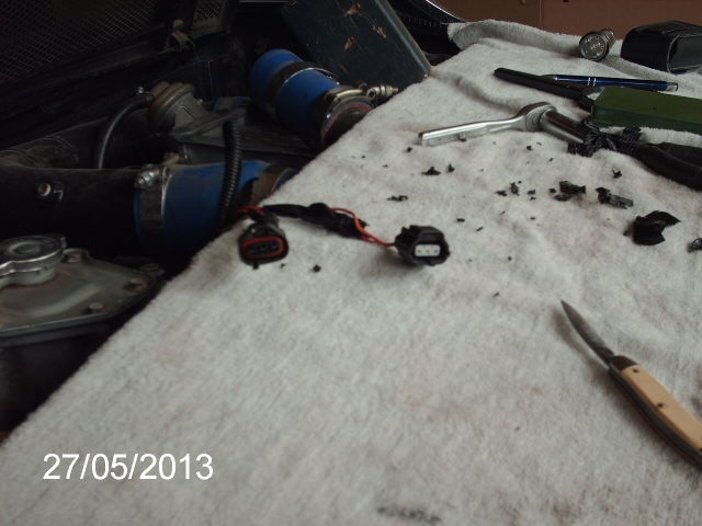

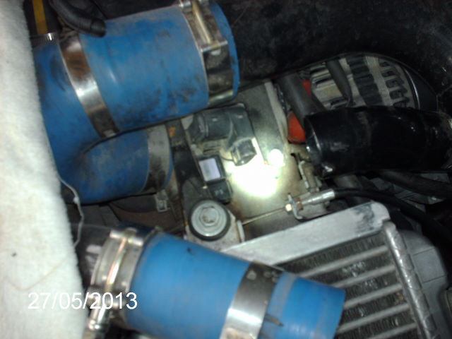

I went back to check up on the spot that I fixed last fall to see if it was creating the problem again, but appears it was sealed up still, but where it had rubbed, was right at the edge of the electrical connector. I cleaned it up and used silicone caulking to seal it. I'm not sure if this is creating these other issues, but would like to be able to put a name to the connector in question, and maybe be able to take the inside out of the housing to see what I can all see, but don't know exactly how to unclip it out of the housing to take a better look. Maybe deeper in the clip, the questionable wire could be causing problems, but don't know?
If I could find the correct connector, and get a new one?
I know the rubbed wire had a direct influence with the fuel pump running/not running, which was the red wire.
It is the one with the white innards, and Orange, green, and red wiring. There is a part number on the part it clips to:
22627A A170
079800-5320
5V 11E24
Denso
