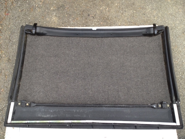

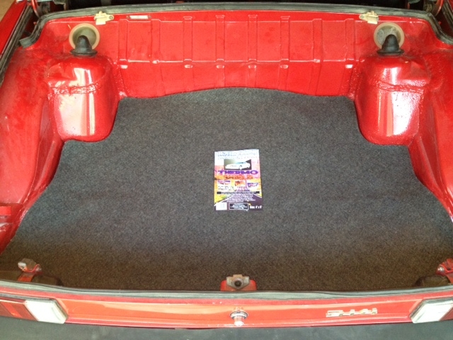

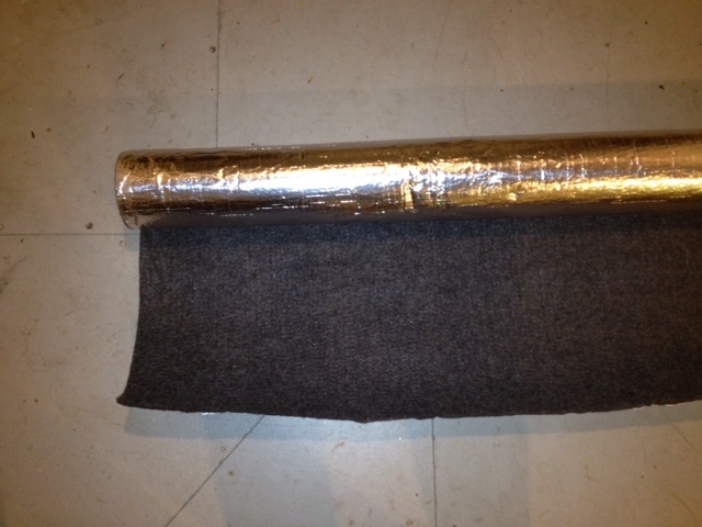

I used this stuff - see below. I wasn't expecting miracles but I am happy with the results. Cost was $45 at pep boys and enough to do the trunk and targa top. Some spray adhesive holds it very securely to the top.

That looks like original material. In person how close is it to the original material?
post May 26 2013, 06:54 AM
914-6 GT in waiting
Posts: 20,750
Joined: 19-September 09
Member No.: 10,825
QUOTE(bandjoey @ May 25 2013, 11:47 PM) *
Very close.
