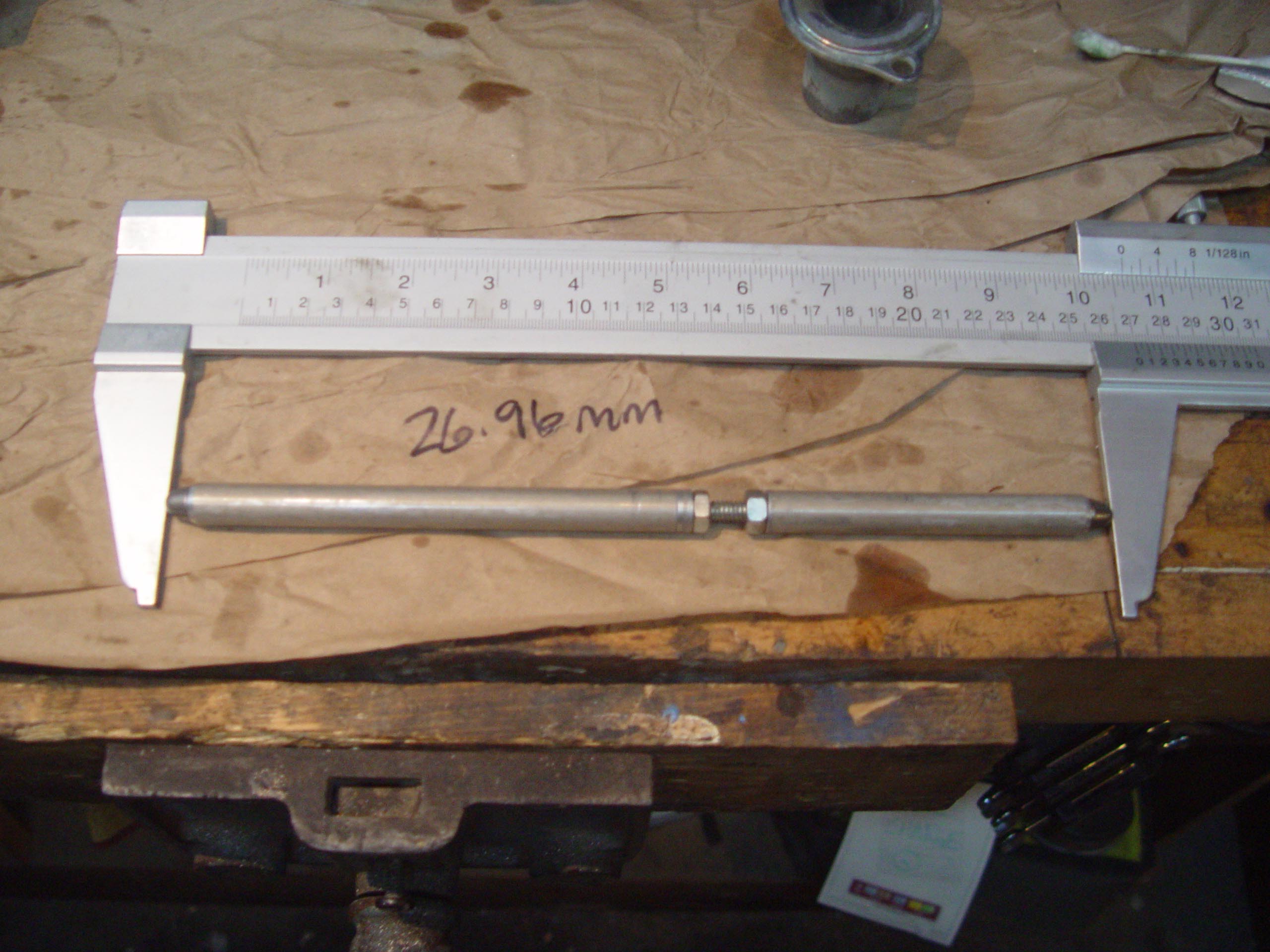

worn
post Jun 7 2013, 09:46 AM
Posts: 3,571
Joined: 3-June 11
From: Madison, WI and North Bend WA
Member No.: 13,152
QUOTE(Highland @ Jun 7 2013, 06:35 AM) *
Does anyone know if the Raby 9590 Super Kit includes the adjusting pushrod or do I have to purchase that separately?
You can do what I did. Saw a chunk out of an old push rod, tap it, cut the head off a threaded object or use all-thread, and add some lock nuts. I used 1/4 by 20.
In the end they turned out pretty close to stock. Also, those aluminum push rods are thick!
JFJ914
post Jun 7 2013, 05:41 PM
Posts: 813
Joined: 13-June 03
From: Alpharetta, GA
Member No.: 814
QUOTE(worn @ Jun 7 2013, 11:46 AM) *
Nice, BUT the radius of the steel pushrods is different. Your lengths with the aluminum push rod will be different than the steel push rod.
