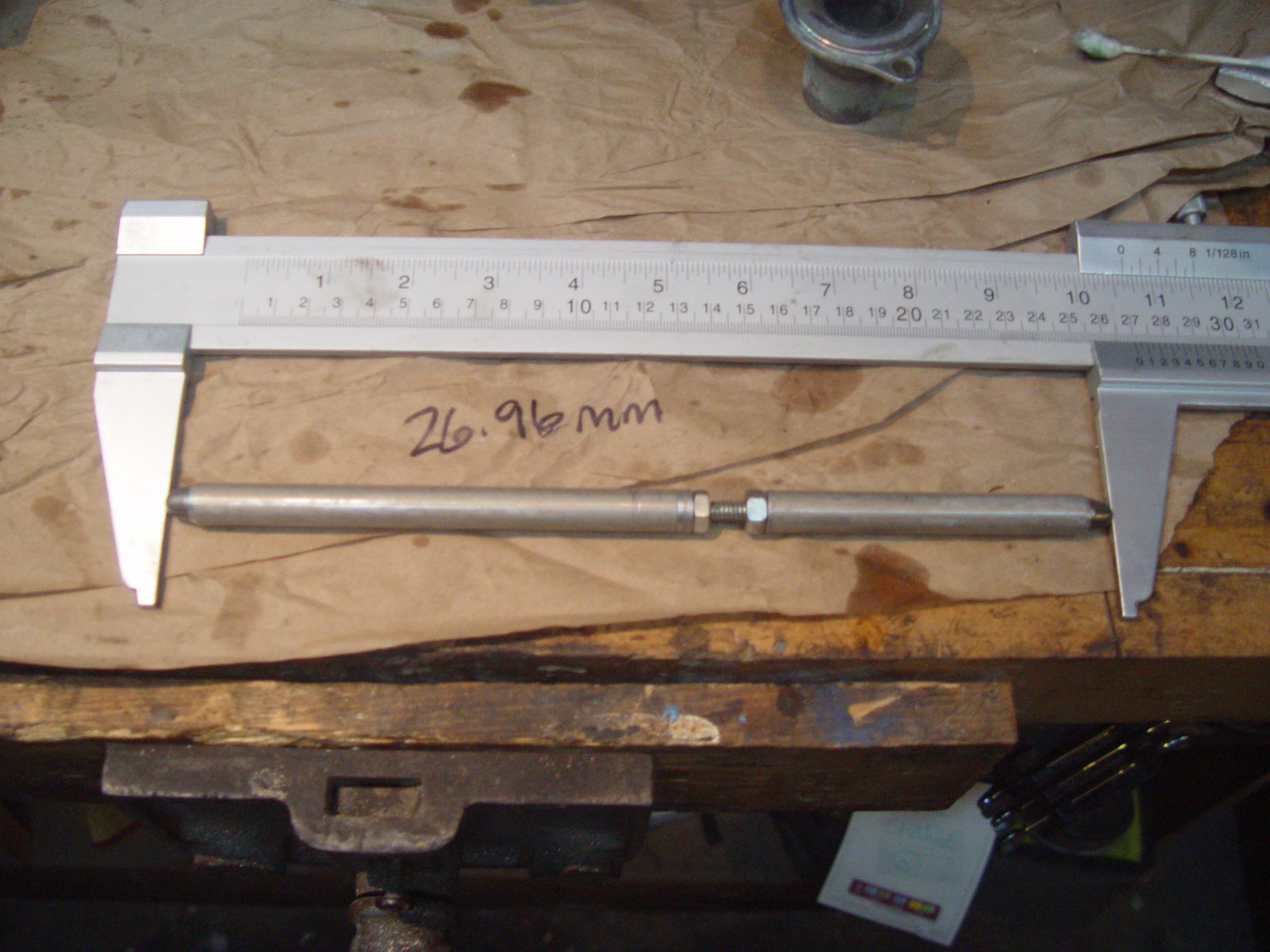

Does anyone know if the Raby 9590 Super Kit includes the adjusting pushrod or do I have to purchase that separately?

You can do what I did. Saw a chunk out of an old push rod, tap it, cut the head off a threaded object or use all-thread, and add some lock nuts. I used 1/4 by 20.
Click to view attachmentIn the end they turned out pretty close to stock. Also, those aluminum push rods are thick!

Nice, BUT the radius of the steel pushrods is different. Your lengths with the aluminum push rod will be different than the steel push rod.
