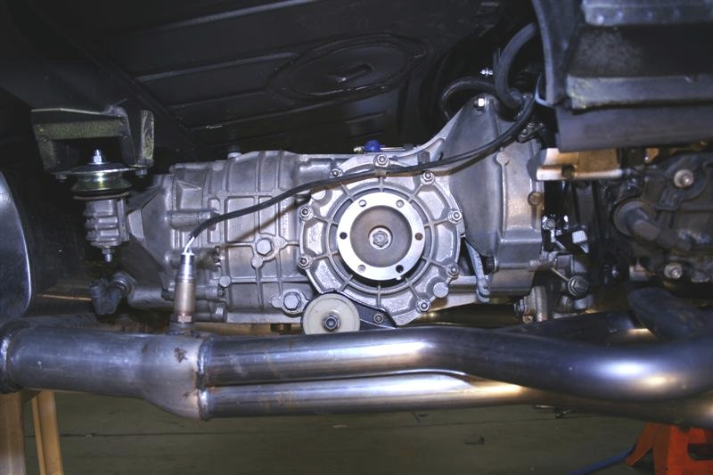

I'm looking for something like this... It is an adapter made for an Audi 016 transaxle (100mm) for 930 CV's (108mm). I emailed the blogger but it got kicked back... (IMG:style_emoticons/default/sad.gif)
(IMG:http://www.914world.com/bbs2/uploads_offsite/home.comcast.net-10496-1370700034.1.JPG)

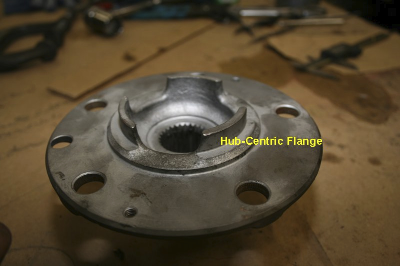

The 108's will fit fine, I am using them in a stock arm.
They will have four 10mm bolts with two roll pins
You can buy both tranny and drive flange in this pattern and the Sway-Away axles are an excellent upgrade that simplifies installation without adapters.
If you go this route don't buy the early drive flanges but instead get the later 911 hub-centric flanges. (requires 5mm bearing spacer)
This is all assuming you are going to go 5 lug.....
