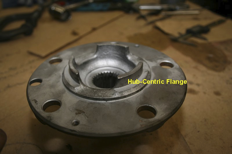

The 108's will fit fine, I am using them in a stock arm.
They will have four 10mm bolts with two roll pins
You can buy both tranny and drive flange in this pattern and the Sway-Away axles are an excellent upgrade that simplifies installation without adapters.
If you go this route don't buy the early drive flanges but instead get the later 911 hub-centric flanges. (requires 5mm bearing spacer)
