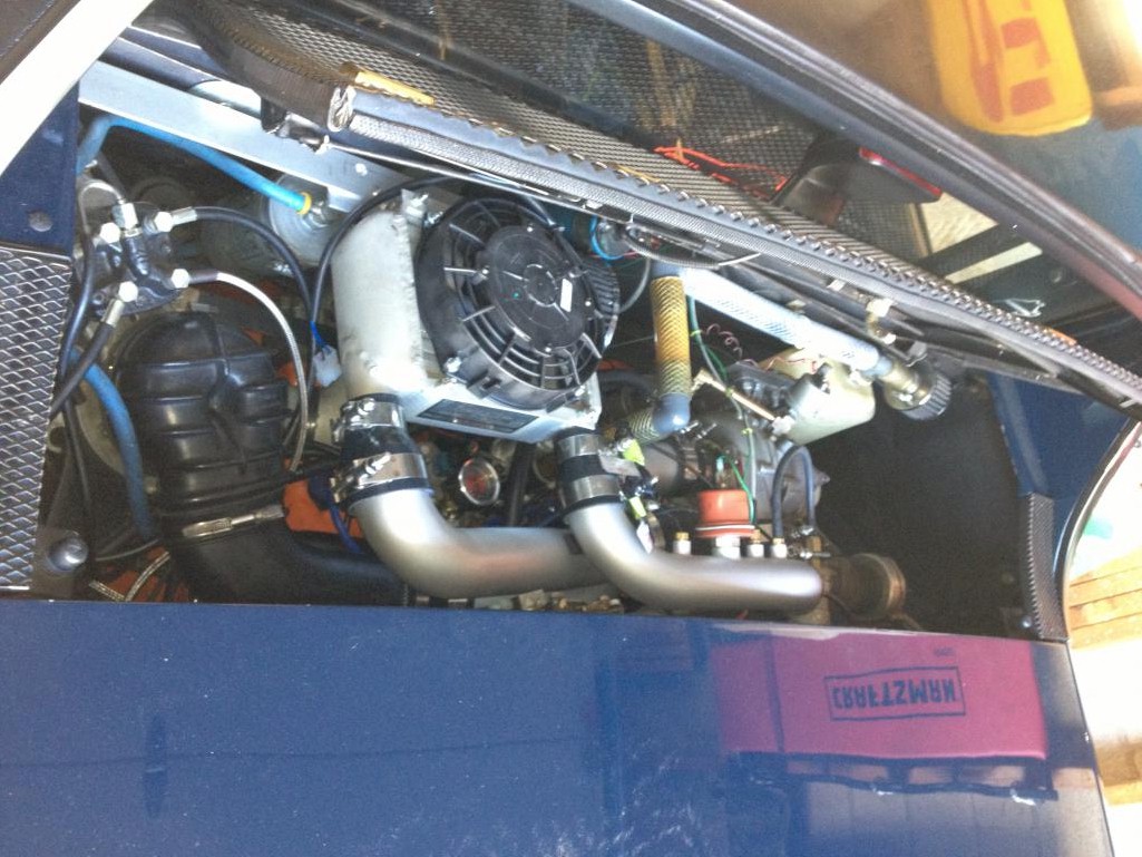

mcmark - what are your thoughts about running a turbo set up like yours - with cis ?
cis: in an effort to avoid the cost of an ECU and the technology curve involved.
like nein14's car (pic below).
I assume the computer interface of MS and similar ECU, has lots of benefit.
I agree too with sirandy, most won't want to open their engines up, though most should, but then there is the cost of head and cylinder work, and more.
I think you have gotten closer than ever before to having an answer to the question "what is the best, low cost, bolt on power increase option?"

It's been 10 yrs since I got the turbo from Evil Ed who was the first to think outside the box Kudos to Ed!!
That being said I made a lot of performance upgrades to improve the original , upgraded larger injectors quicker spooling K26 , cold air intake, 930 WRU, etc.
IMHO it has been very reliable (knock on wood )for power it is the most bang for the buck (IMG:style_emoticons/default/smile.gif)

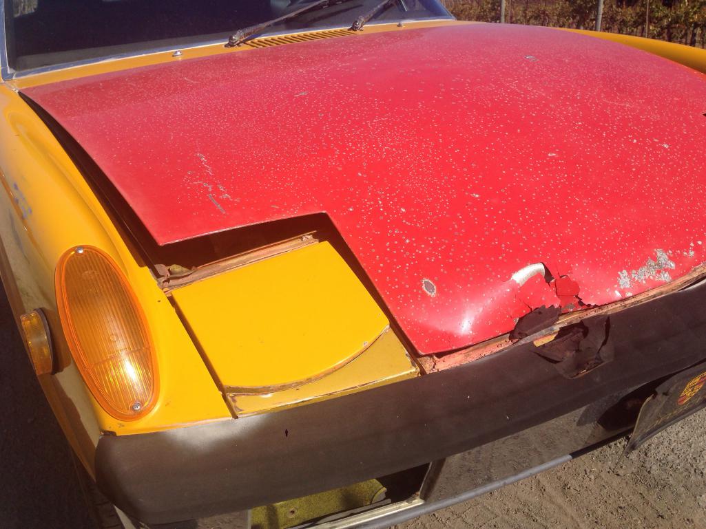

BOOOOOOOO!

That sucks !!!!!!

Bummer about the big dent in the front there. That dent shouldn't keep ya off the road entirely.

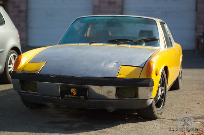

Fixed the hood. Pics on Sunday. Other than that, just driving it and working on the 2.4 six that will eventually go in. I'll also be starting on a new base engine for the 1.7 turbo, which will end up in my Blue Car.

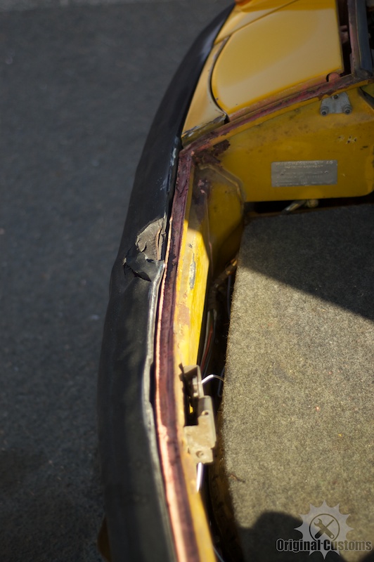

All fixed up. The hood is a crappy one I had laying around. It was stripped of paint already, so I just waxed it to keep it from rusting terribly. Trying to focus on just keeping this car drivable (versus pretty), because I really should be working on getting the blue/black car finished up and ready for paint and reassembly.
