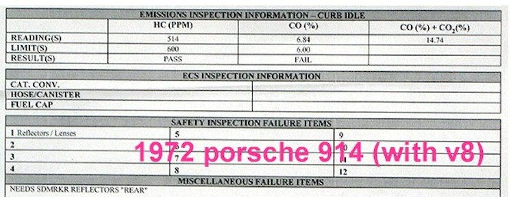

I know you don't need to pass emissions in CA for cars 1975 and older.
http://www.dmv.org/ca-california/smog-chec...s-Old-and-Newer
but I wonder how it would do?
if it tested high, could the numbers be brought down via the MAP alone?
in Delaware my 1972 needs to be under 600 for HC and under 6.0 for CO, regardless of engine in it.
I found a local shop that tuned my, carbureted V8 car, to pass, they had a sniffer, charged $75 at that time.
