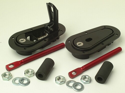

I'm thinking maybe two of these but maybe not. I don't want anything silver looking what with all the "dzus" fasteners installed.

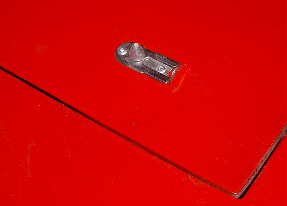

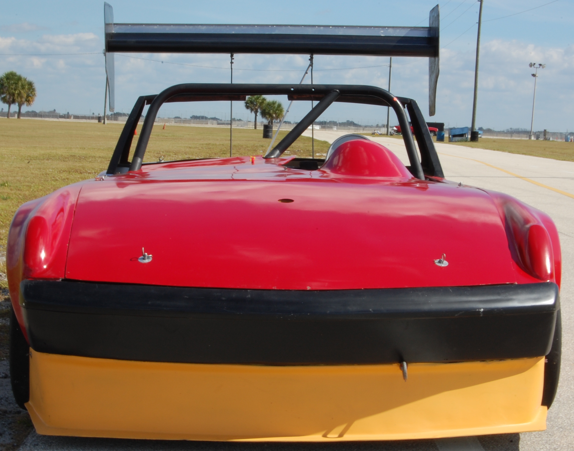

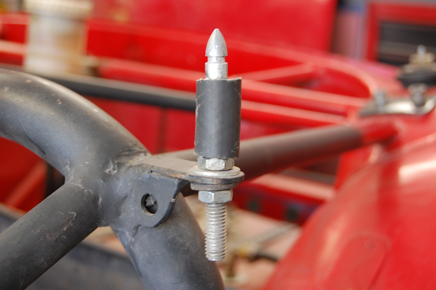

The two in the rear of the hood are these slider type...
