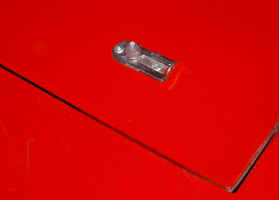

I'm thinking maybe two of these but maybe not. I don't want anything silver looking what with all the "dzus" fasteners installed.

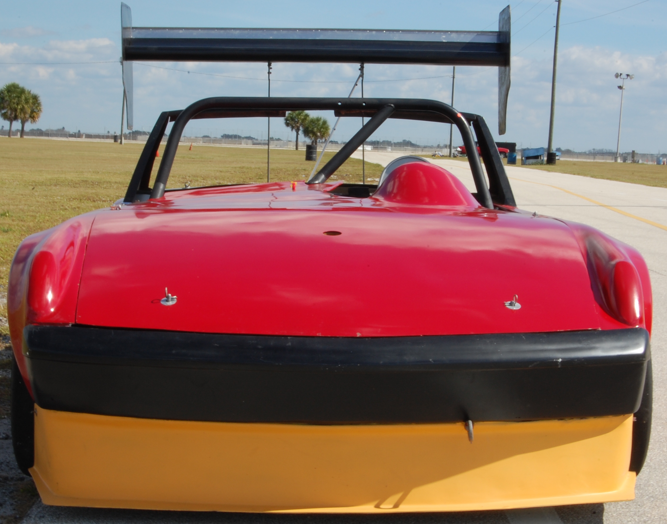

URY914
I use 4. The two in the front are typical aluminum pins.
URY914
The two in the rear of the hood are these slider type...

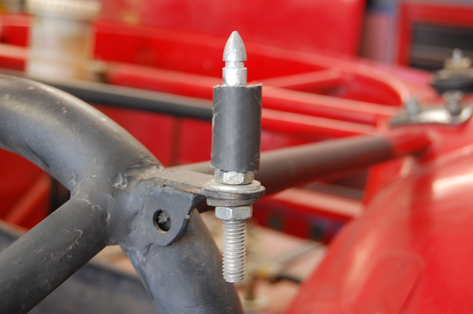

URY914
Here is the pin. It's threaded to adjust the height. The rubber hose is cut so the pin's hole is at the position to the hood. This way the bracket doesn't have to perfectly placed when you weld it in on.
