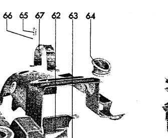

Anyone know where to get the Protective Cap for the Oil Pressure Switch? It is #64 in the picture below.

QUOTE(74914LE @ Jun 10 2013, 09:44 PM) *
Pretty sure that those are NLA. But I found some "blind grommets" on Ebay awhile back to seal up the holes in my tin, and they work great.
http://www.ebay.com/itm/10-x-PVC-Electrica...=item5d3ee9ea22
I can't remember who my original supplier was, but I got several in a couple different sizes. You'll have to measure the hole, as I don't remember what size it was. I think 45 mm?

QUOTE(Jeff Bowlsby @ Jun 10 2013, 07:42 PM) *
Bus Boys had them the last I checked.
(IMG:style_emoticons/default/agree.gif) Just looked on the site. Here's the pn 021-119-957

Sorry, I forgot that I use the dual sender on a grease hose extension, so the hole in the tin is really large without some kind of grommet to seal it. If you're using the stock sender, then the Bus Boys solution is probably the better way to go.

AutoAtlanta has them too.

QUOTE(ThePaintedMan @ Jun 11 2013, 06:31 AM) *
The original formed grommet should work just fine for the remote mounted sender. The hole in the center is pretty small. Because the hole is not a simple circle cut in a flat surface, a plain grommet may not work at all .............
