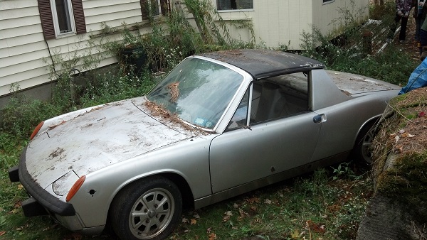

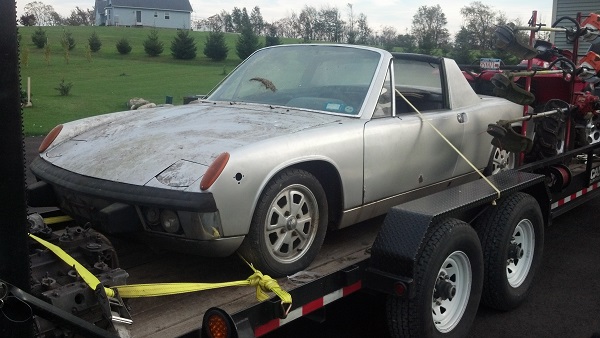

I figured why not start this thread. The car is a 74 914 2.0 that's been sitting since the early 90's. It was parked outside/in the woods up until my brother purchased it last fall. It didn't look too bad from 20 feet away but when you look closer it gets pretty bad. So, here's the plan... strip the car, fix the rust problems, paint it, add a 5 lug suspension, and convert it to a 3.0 6. Stay tuned for pics of the progress..

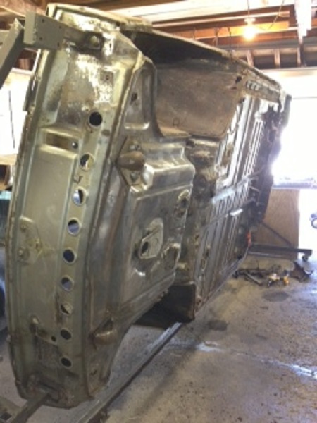

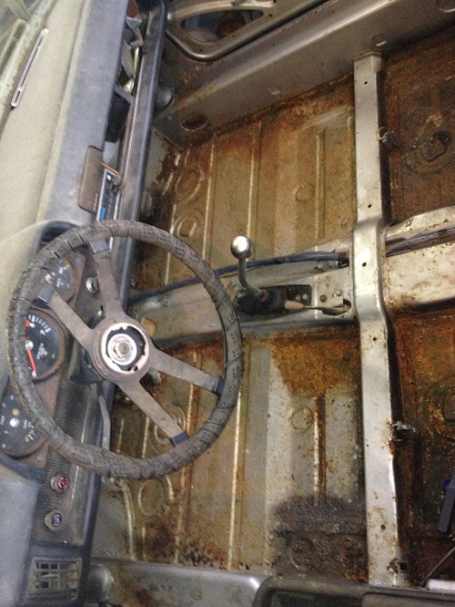

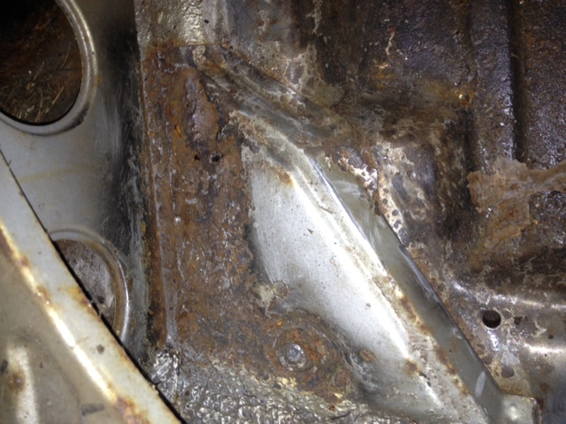

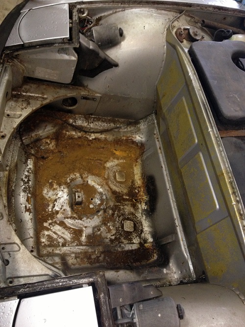

Luke M   Here's a few pics of the car when it was purch...   Jun 22 2013, 11:44 AM

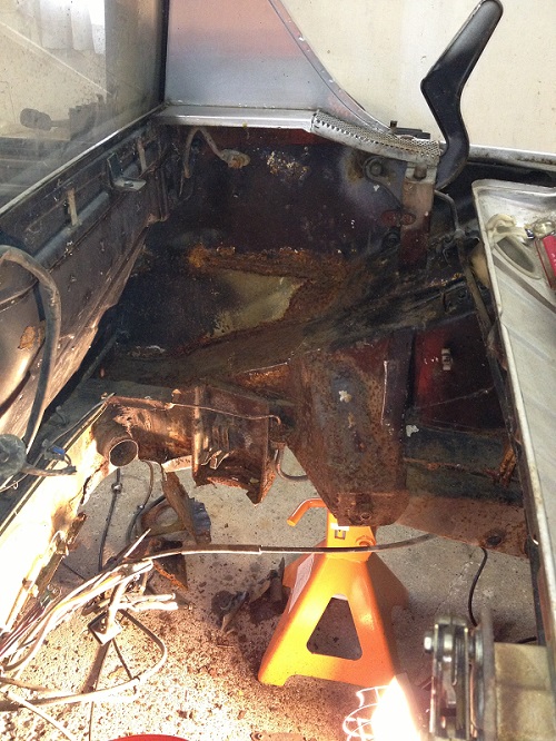

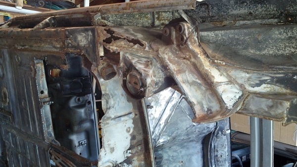

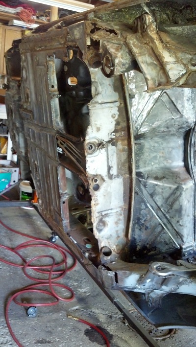

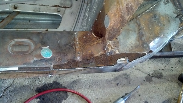

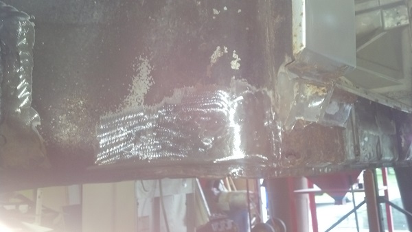

Luke M   Rust repair in the works.. :sawzall: :smash: :w...   Jun 22 2013, 12:26 PM
Spoke   Good luck and happy welding. Looks like a typical...   Jun 22 2013, 05:40 PM
Luke M   Good luck and happy welding. Looks like a typica...   Jun 22 2013, 06:57 PM

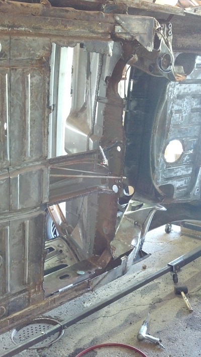

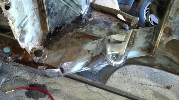

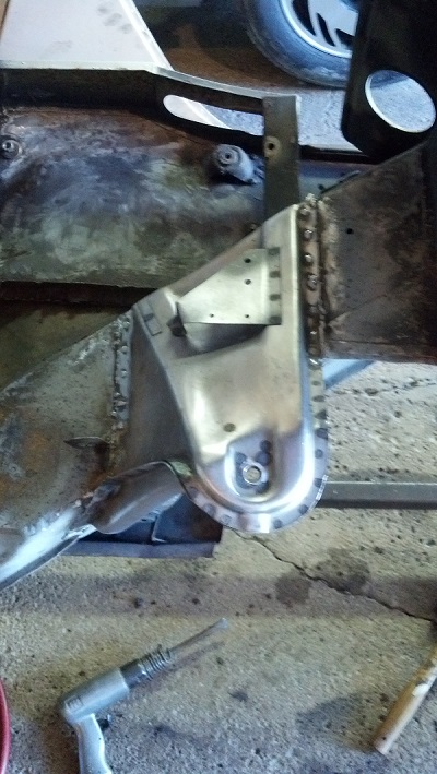

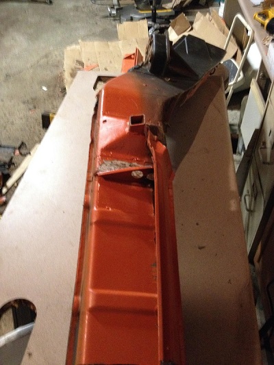

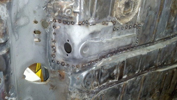

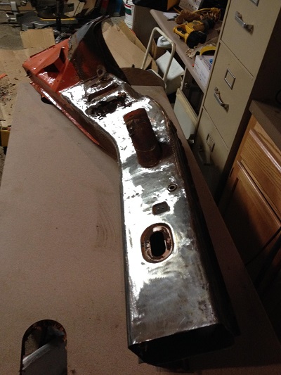

Luke M   Replacing the r/r inner control arm mount was a re...   Jun 24 2013, 07:08 AM

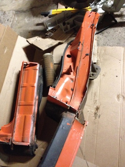

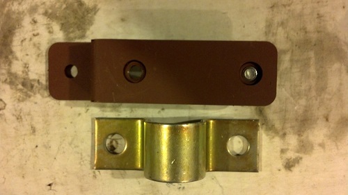

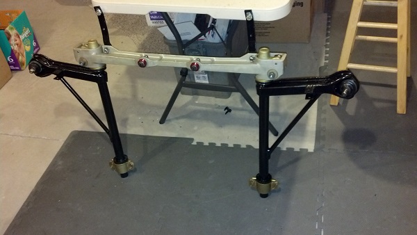

Luke M   Some of the parts that will be used : Original 91...   Jun 25 2013, 07:48 AM

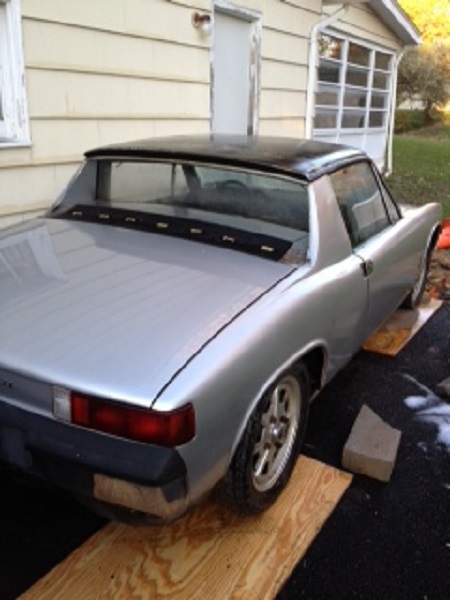

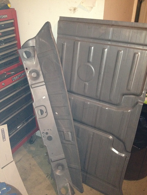

Luke M   Finally got some sheet metal in from a CA parts ca...   Sep 30 2013, 06:36 PM
914forme   Thats some nice work your doing. And don't fe...   Sep 30 2013, 06:48 PM

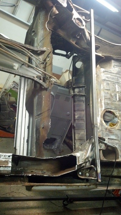

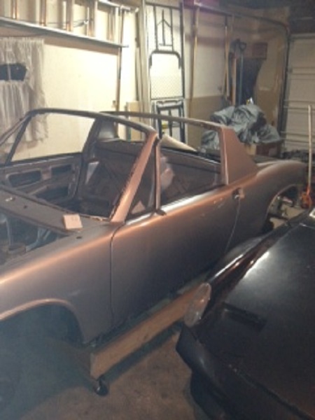

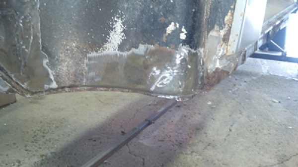

Luke M   My brother and I finally got a few things done on ...   Nov 24 2013, 08:20 AM
trojanhorsepower   Man that looks familiar. Looks like it is going we...   Nov 24 2013, 09:16 AM
jimkelly   that's a pretty big - and nicely done - repair...   Nov 24 2013, 09:40 AM
Luke M   The door gaps should be ok as I placed the cross b...   Nov 24 2013, 10:04 AM

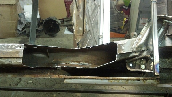

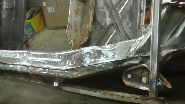

Luke M   The work continues. The right long is done and sta...   Mar 2 2014, 07:49 PM

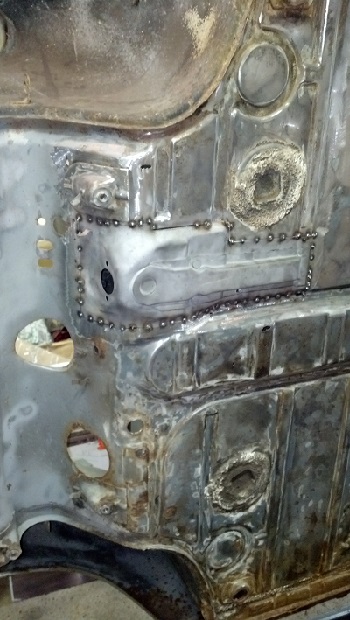

Luke M   We got the floor pan/seat mount reinforcement all ...   Apr 19 2015, 08:09 PM

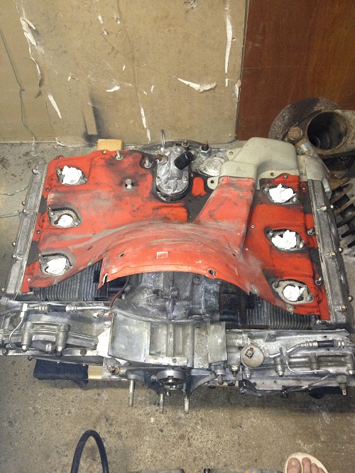

Luke M   The case and a few other parts came back from the ...   Aug 25 2015, 05:54 AM

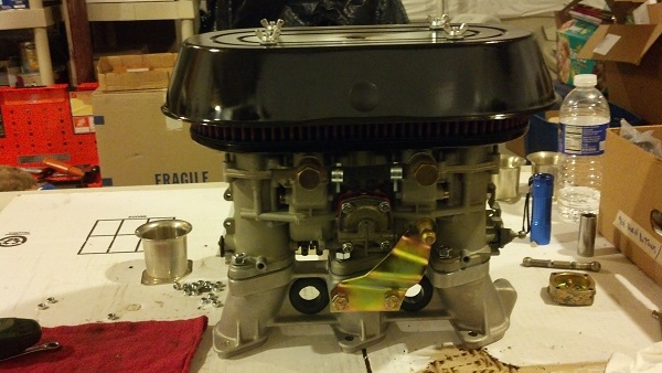

mepstein   What kind of induction on the 3.0   May 19 2018, 02:17 PM
Luke M   What kind of induction on the 3.0 Weber 40 IDA...   May 19 2018, 05:20 PM

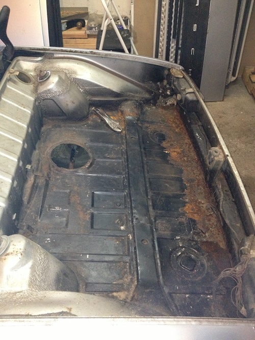

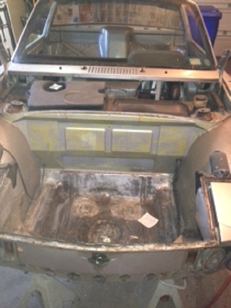

Luke M   Worked on the rear trunk pan today. The spot welde...   Mar 13 2021, 05:45 PM
Root_Werks   I really like the spot welder you are using. Yes,...   Mar 16 2021, 05:13 PM
Luke M   I really like the spot welder you are using. Yes...   Mar 16 2021, 06:18 PM

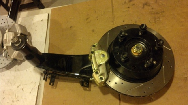

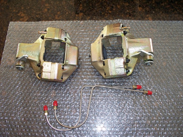

Luke M   We've been working away here.. Got the brakes ...   Sep 11 2021, 06:30 PM
