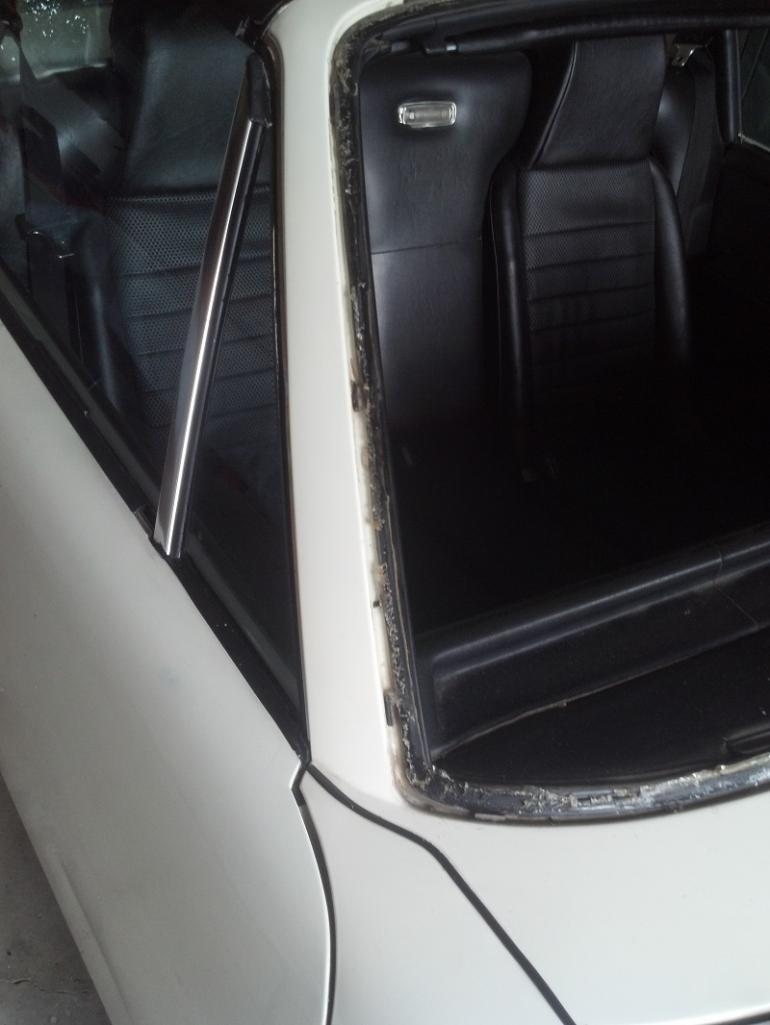

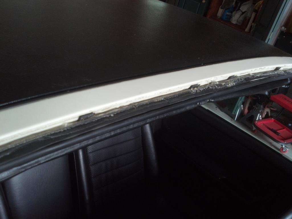

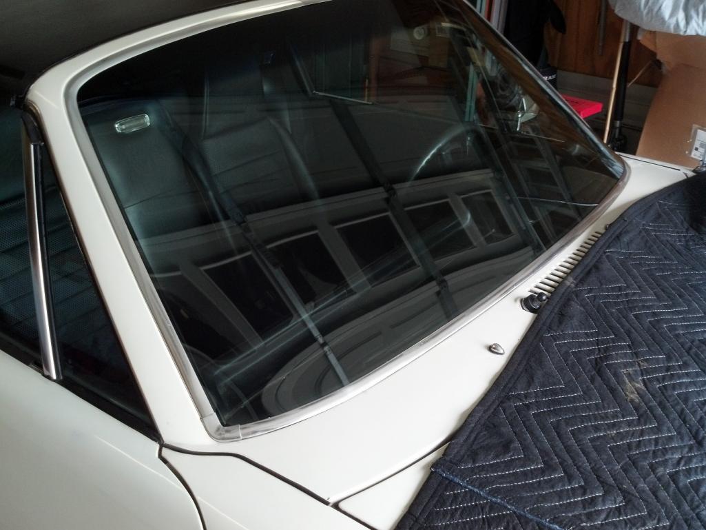

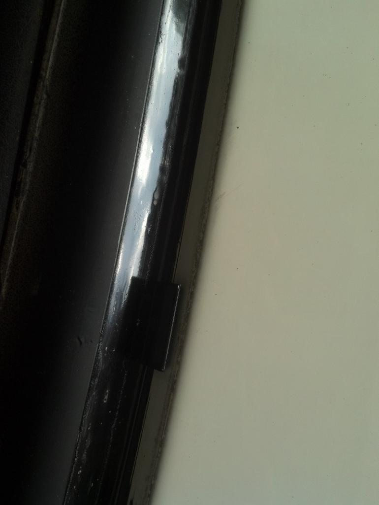

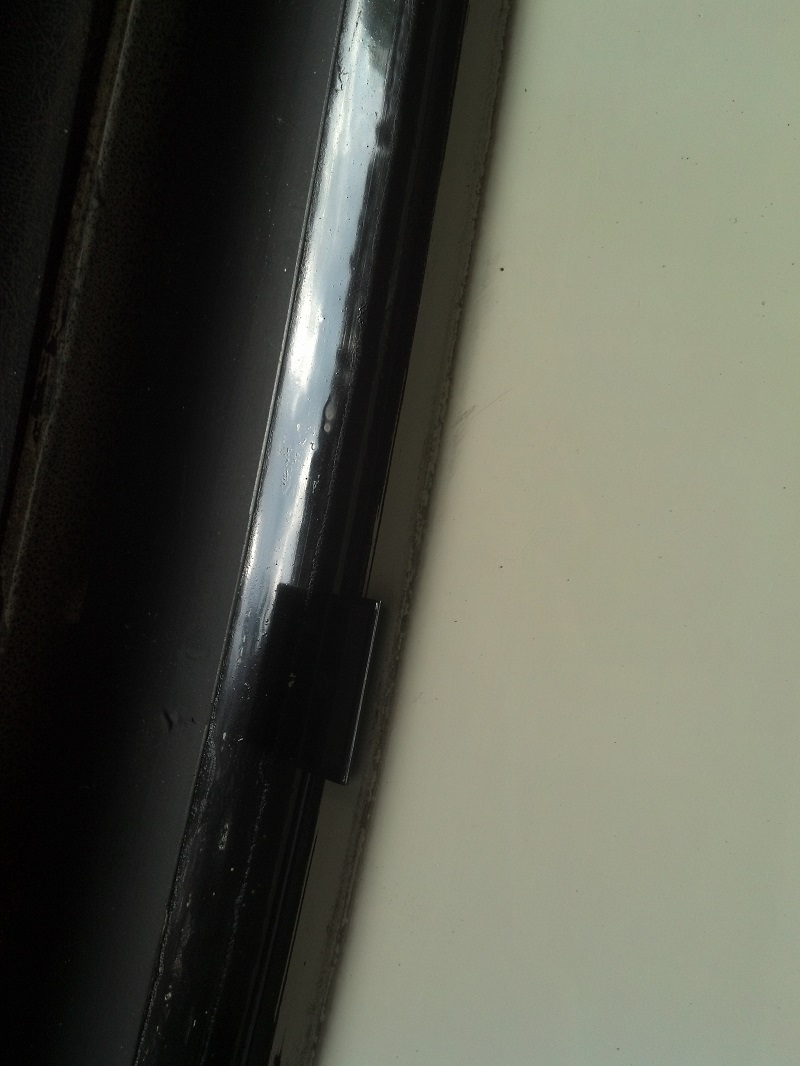

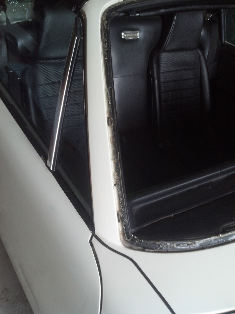

So I got my new windshield installed today. Mel's Auto Glass in Cincinnati did the work, and I'm VERY happy with the job.
True story, my installer was Steve Boehner (Speaker of the House, John Boehner's brother). Great guy, used all the parts from the AA Windshield kit I purchased, including the butyl strip.
We were both pleased with how the non original windshield came out, and the channel cleaned up. No rust at all! (IMG:style_emoticons/default/piratenanner.gif)
The glass went back in, we used the rubber setting blocks, replaced the trim clips with new, trim went back on perfectly... really a great job. $304 dollars + my AA install kit. I also purchased the Windshield to dash seal from Mikey914, and that went it without any issues as well.

.....Without using a microscope....well done!! (IMG:style_emoticons/default/shades.gif) (no self liability)

Looks good, who did you get the glass from?

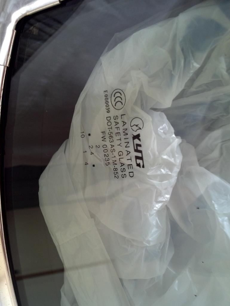

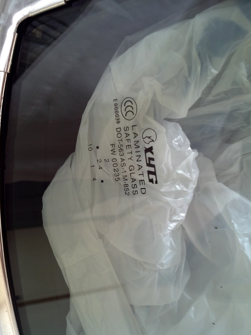

Mel's Auto Glass supplied the windshield. Not sure where they get them from. You can see the maker specific info in the last picture.
I had to call several local Windshield shops before I could find someone to take the job, but these guys came thru at a reasonable price. The guy did a great job getting the old windshield out, without any damage to the interior.
The Windshield has a tinted stripe on the top, which is not original.

Tinted windshields were available, and original...

I knew that you could get tinted windshields, but this one has a darker blue strip at the top of the windshield, which I thought was not something original.

If it isn't a Sigla it isn't original. Too hard to tell from the pictures if it would match the Sigla tint.
I'm glad you're happy with the windshield and price but I don't want others to be discouraged from trying this themselves. It is a rather easy one or two person job that doesn't require special tools. Clips, spacers, butyl tape, window primer to help the butyl bond to the window... You should also plan to replace the vinyl forward of the dash as it should be done with the window out. Easy-peasy... (IMG:style_emoticons/default/biggrin.gif)

yep, I agree, after watching it done, it really wasn't to bad. However the windshield removal really damaged the edges of my already cracked windshield. The previous install was a cobb job and was definitely not a normal standard install.
I guess there are other methods of removal that are not as destructive, but the installation is pretty straightforward, and I wouldn't hesitate to do it myself next time...guess that's always the case, after you see it done....
