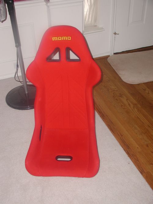

The new seat for ti came in. (IMG:http://www.914world.com/bbs2/html/emoticons/smile.gif)
