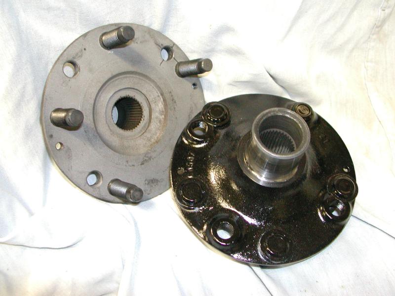

Eric_Shea
post Dec 7 2004, 11:50 AM
PMB Performance
Posts: 19,304
Joined: 3-September 03
From: Salt Lake City, UT
Member No.: 1,110
these? (I guess I should stick them in the Resource section... (IMG:style_emoticons/default/blink.gif) )

Eric:
I looked at your stuff in resource section. Pretty cool set up, but I had some questions. Is that whole kit (700-800 dollar one) include everything for both front and rear? I was confused with the stub axles. Im guessing the stubs go on rear and hubs go on front. I am confused?
Thanks,
Drue
