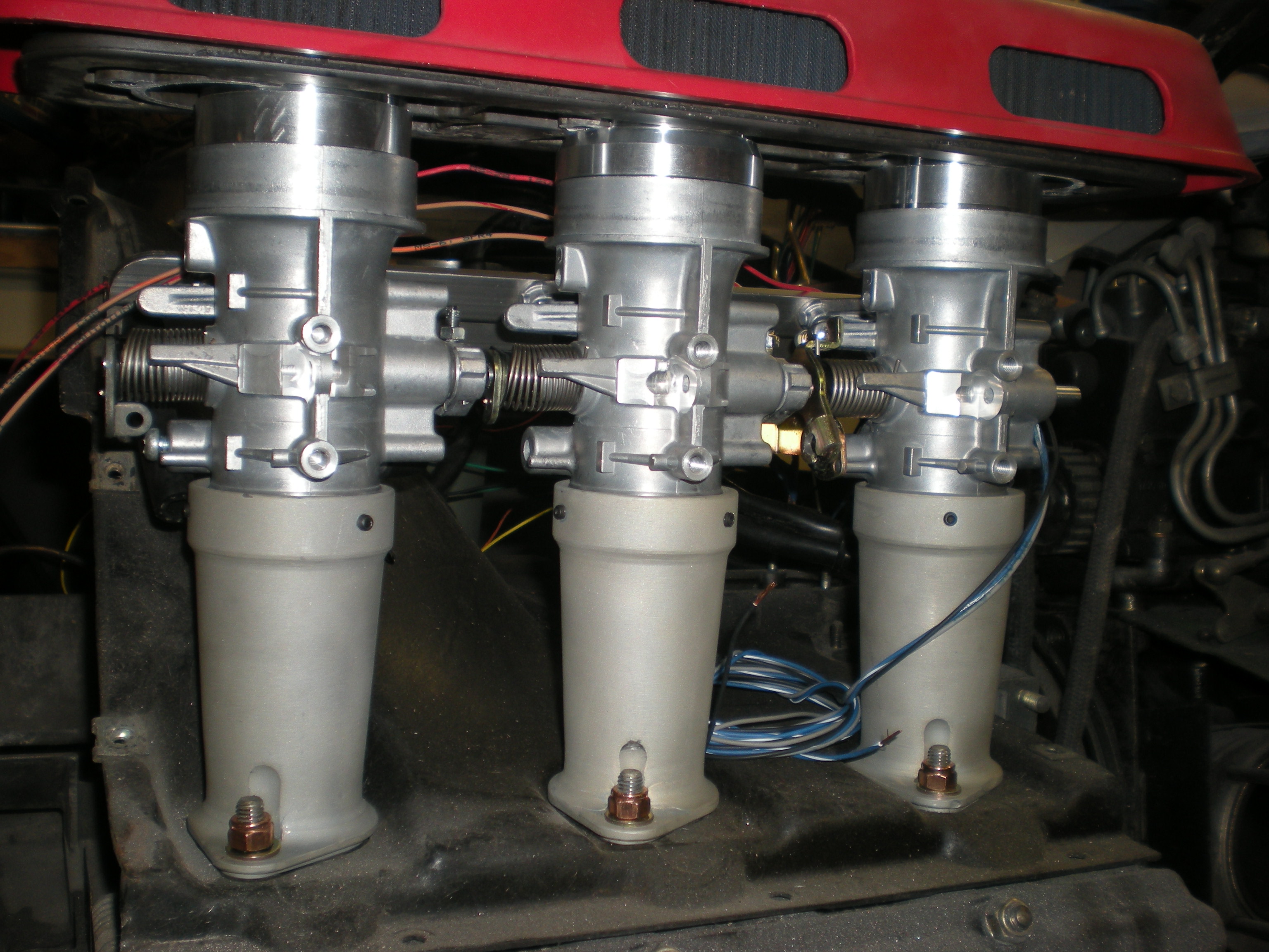

These are mine. A little different from Mark's. Taller (IMG:style_emoticons/default/biggrin.gif)

QUOTE(sixnotfour @ Nov 8 2013, 10:03 PM) *
Wow !! Those are cool. Sorry McMark, I am not trieing to hijack this, but I would like to know whats the story behind Mr Sixnotfour´s ?? Are they 3D pinted, cast or what ?? Whitch TBs those are??

mine are machined aluminum, with the flanges welded on, because of the free material being small in diameter.. I just like green.. Mark can tell the injection story, I just happen to be doing the same, but different.

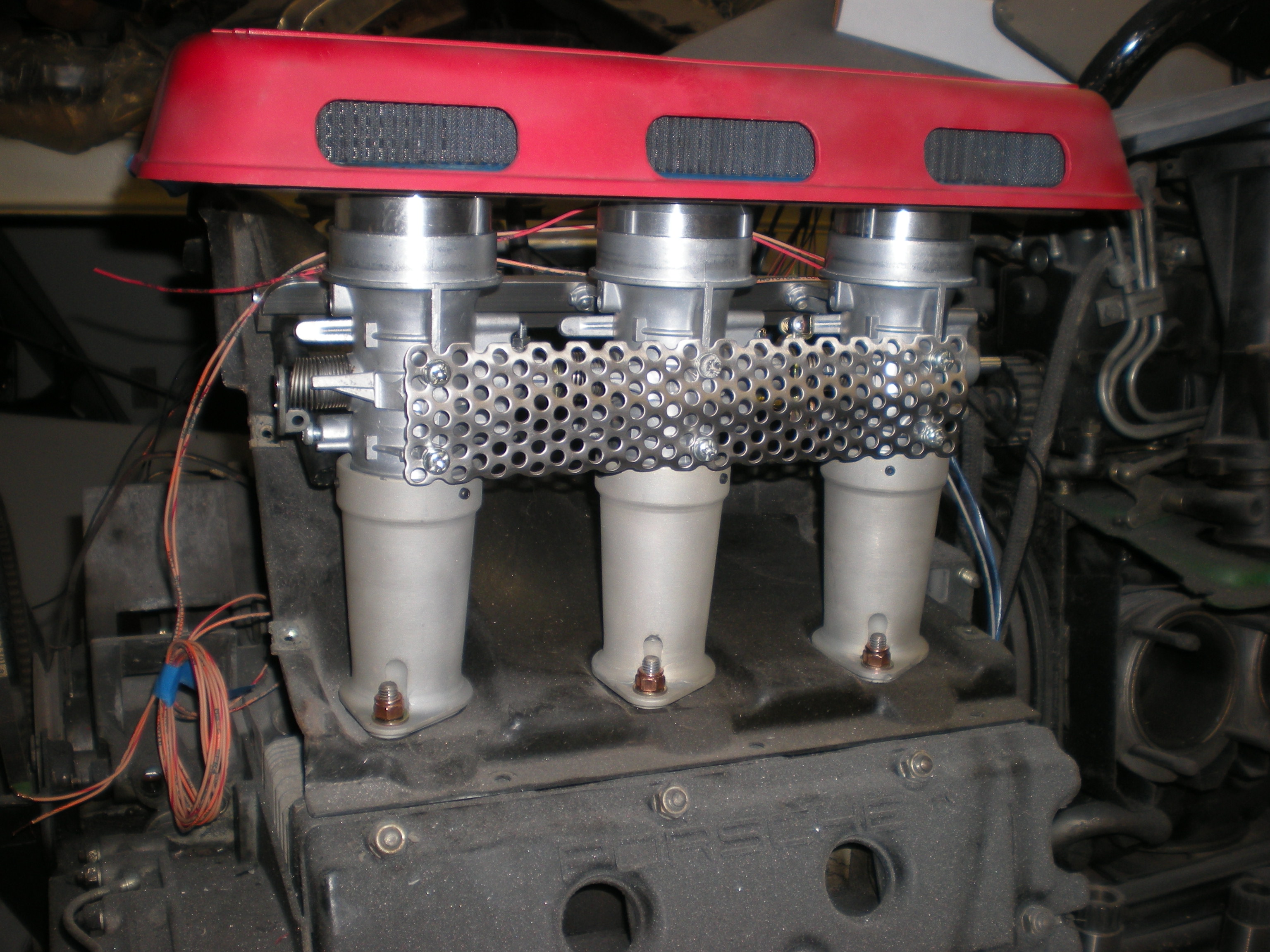

sixnotfour

It looks cool, but what's the perforated metal for?

Those are Jeffs, but it's a mount. It ties the three TBs together. The spacing on the Polaris TBs is just a little off. So the mount that comes on them won't work.

QUOTE(McMark @ Nov 17 2013, 09:07 PM) *
Mark, It looks like the TB's are attached to the printed intakes with set screws. I'm still thinking of using these with my Datsun L28 motor. I think these could be tied together with a heat shield under the TB's and over the header?

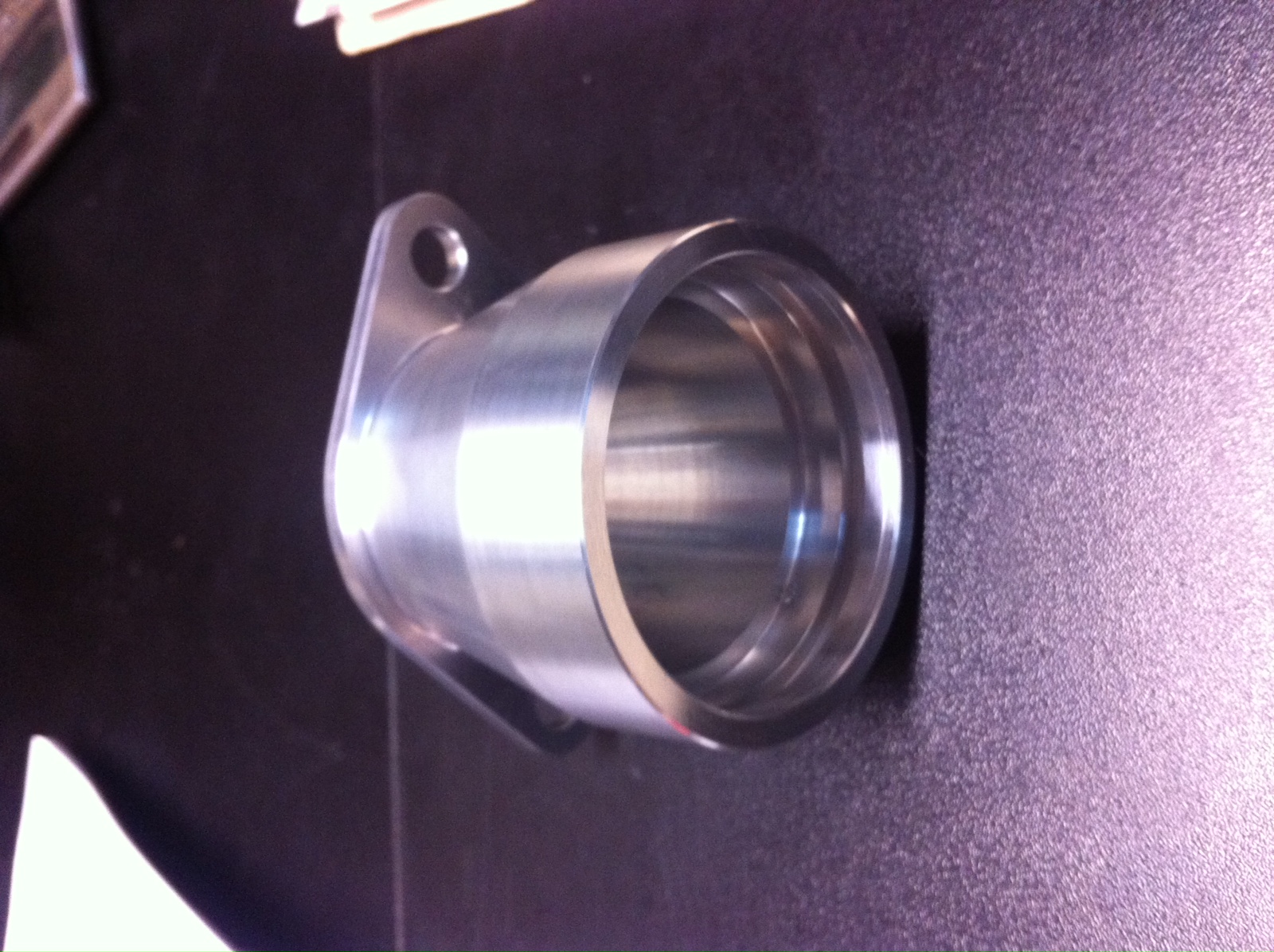

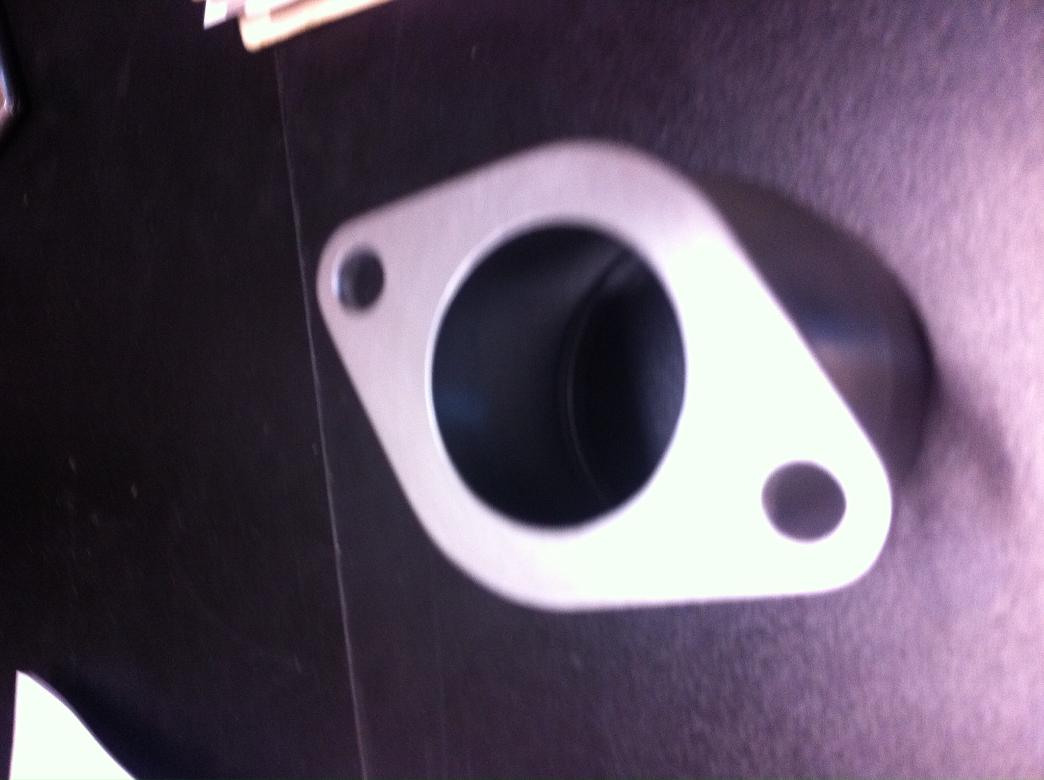

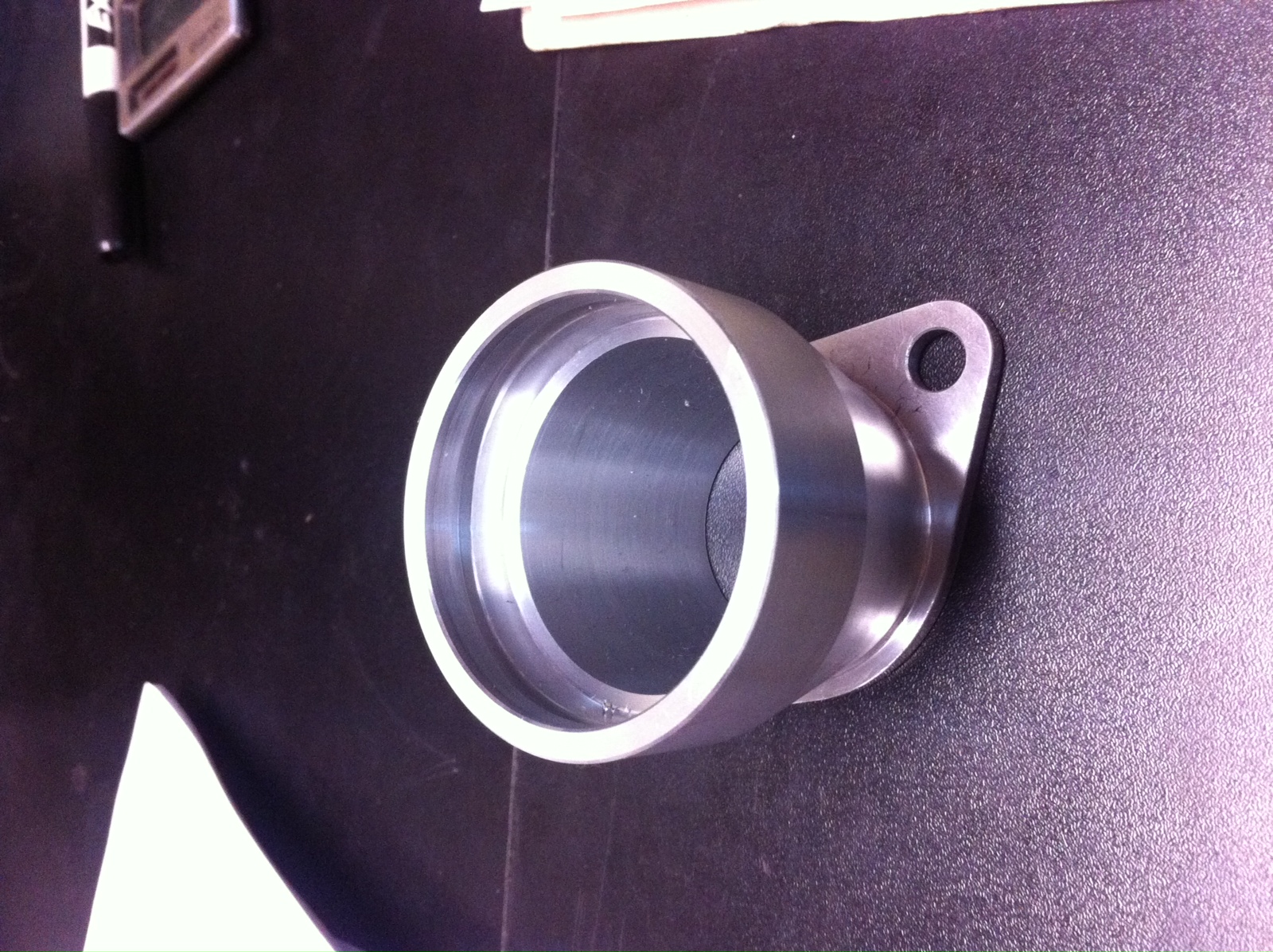

Here's my adapters. Got a sample piece in bare aluminum. The other 13 pieces are out for anodizing. (IMG:style_emoticons/default/boldblue.gif)

QUOTE(ConeDodger @ Nov 18 2013, 08:04 AM) *
They are aluminum, and will be sealed in with 890 sealant from expired product from work. set screws are just extra.
Mark mine are still 116mm the two outer intakes stacks are angled in. The stainless perf. was leftover, just tried something different. I also removed the coolant passage
