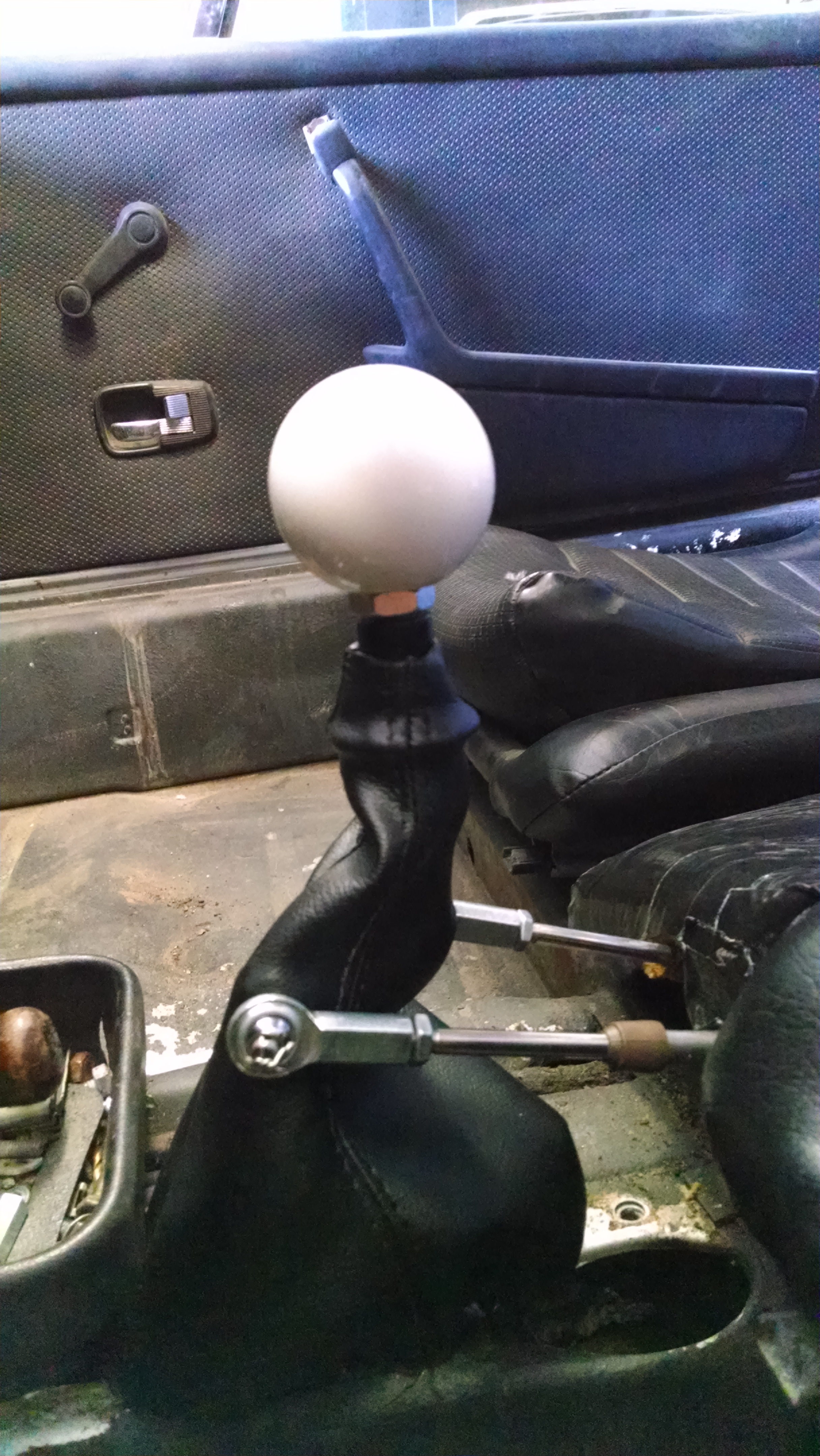

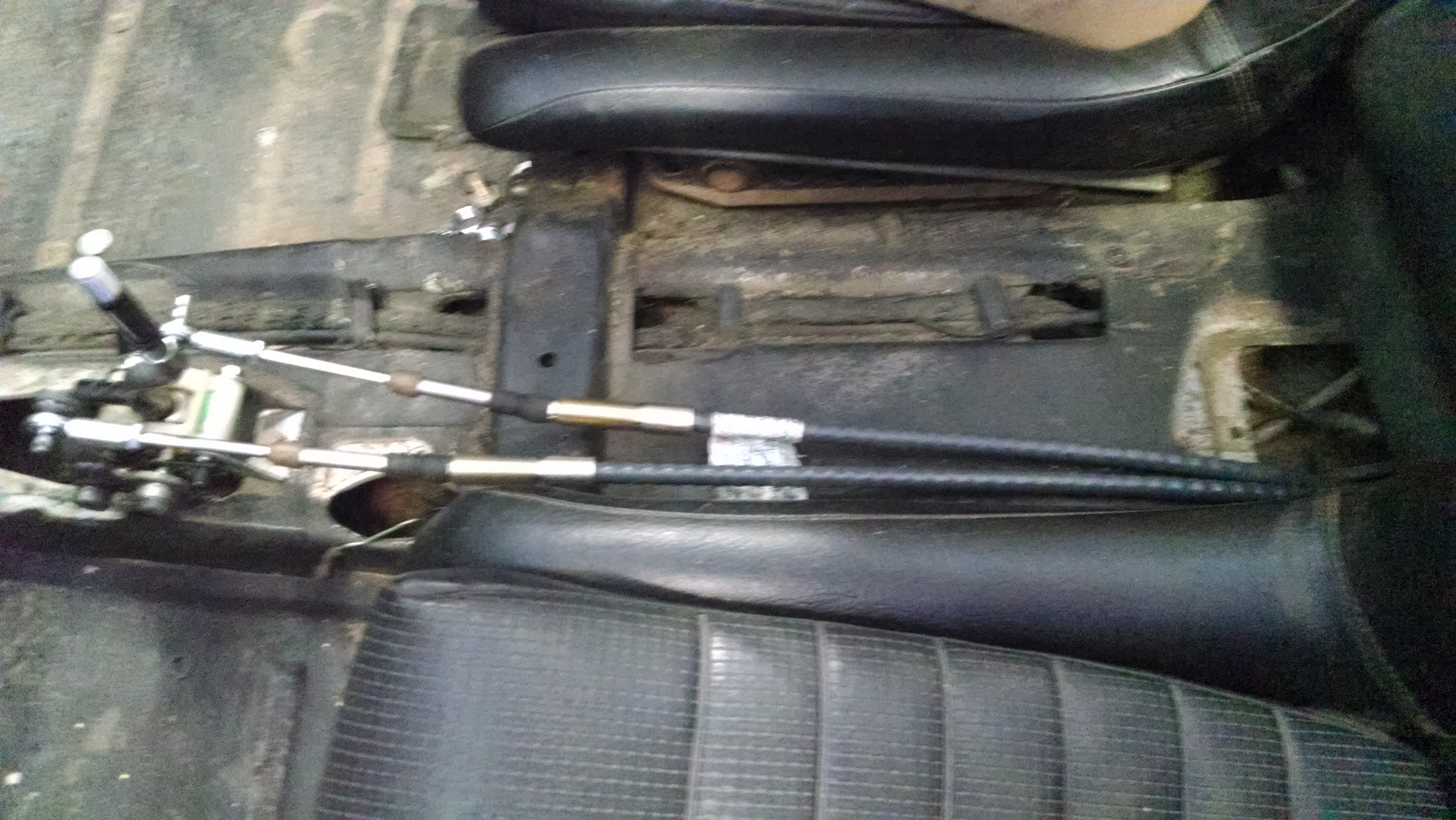

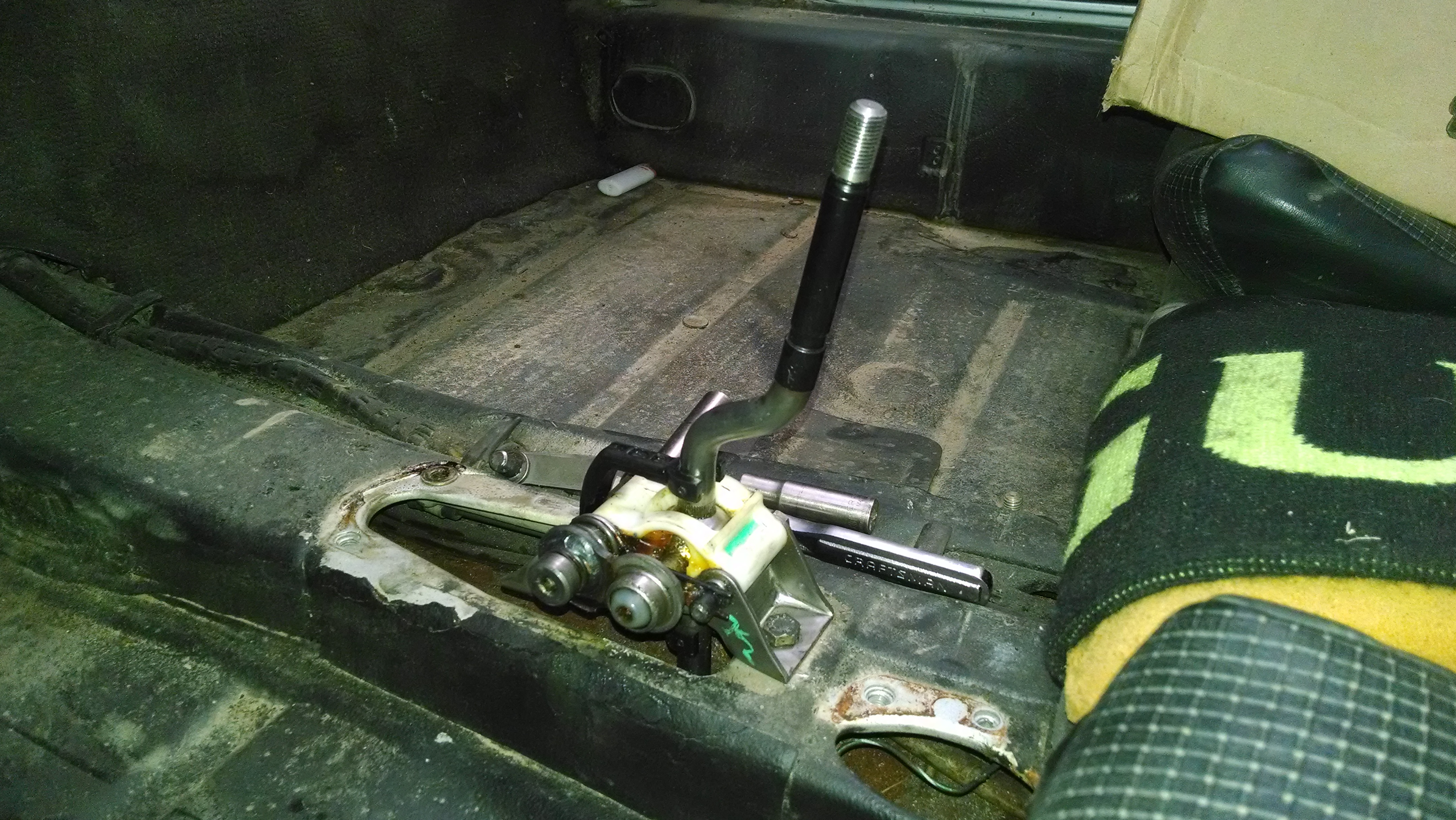

Bought a 91 celica shifter from a pick and pull junk yard I liked the way it felt and how short it was

feels like a short shifter

shifter fabricated and cables bought from a shop in town I have all my paper work for every part and will have a list at the end no shift mechanism at the moment

Shift knob that was order off ebay also order the factory shift boot and a sick speed shift knob retainer

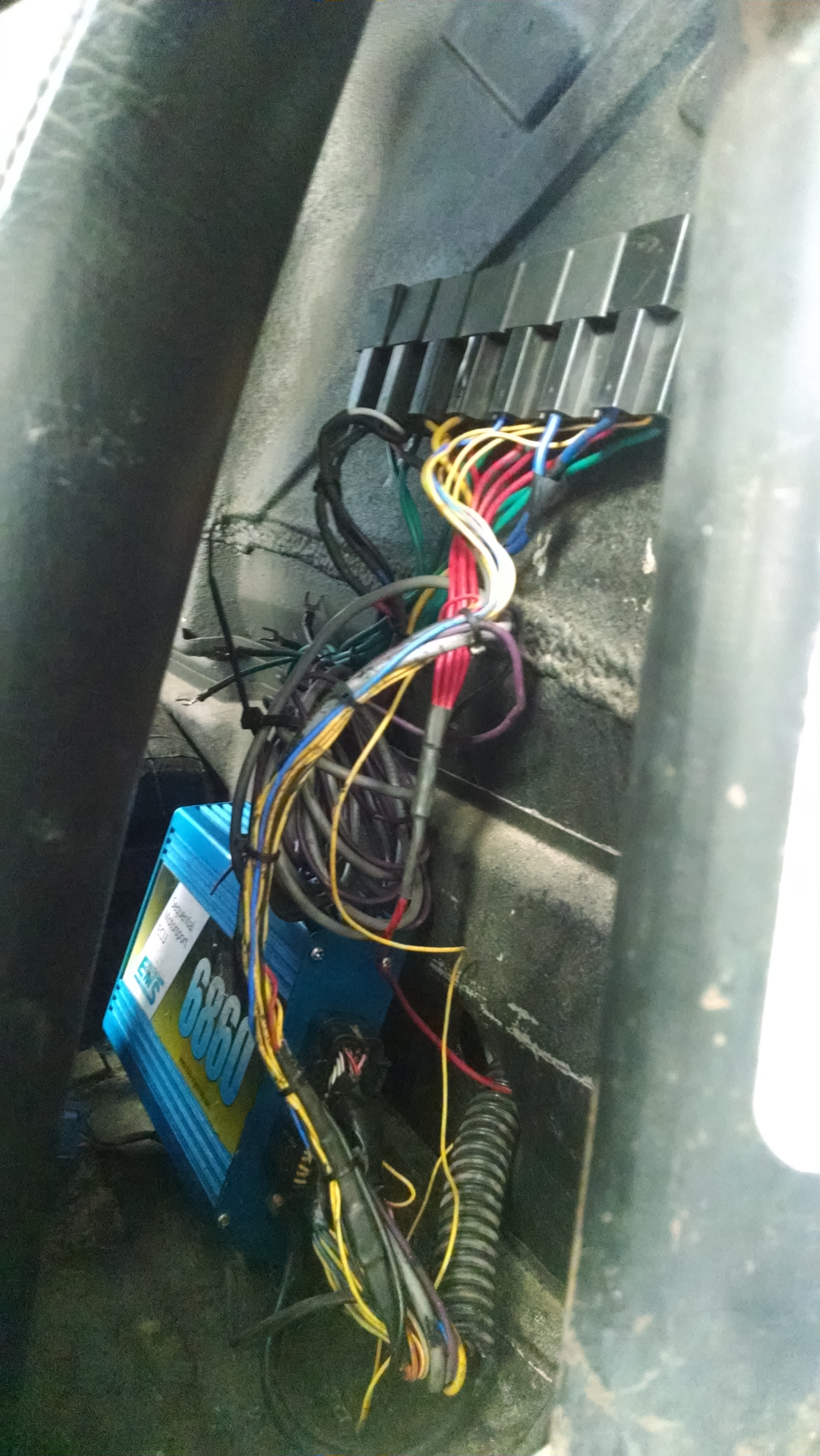

I had some time to officially found the computerS home tuff spot but there was a indent on the bottom on the fire wall on both sides that work very well got the computer from outfront motorsports in Buena park CA I so happen to come at the right time when john the owner pulled his out of his sand rail to swap over to a newer version and doing some tweaks to his turbo chatged motor so it has a full turbo charged set built into the harnesses already now the fun part

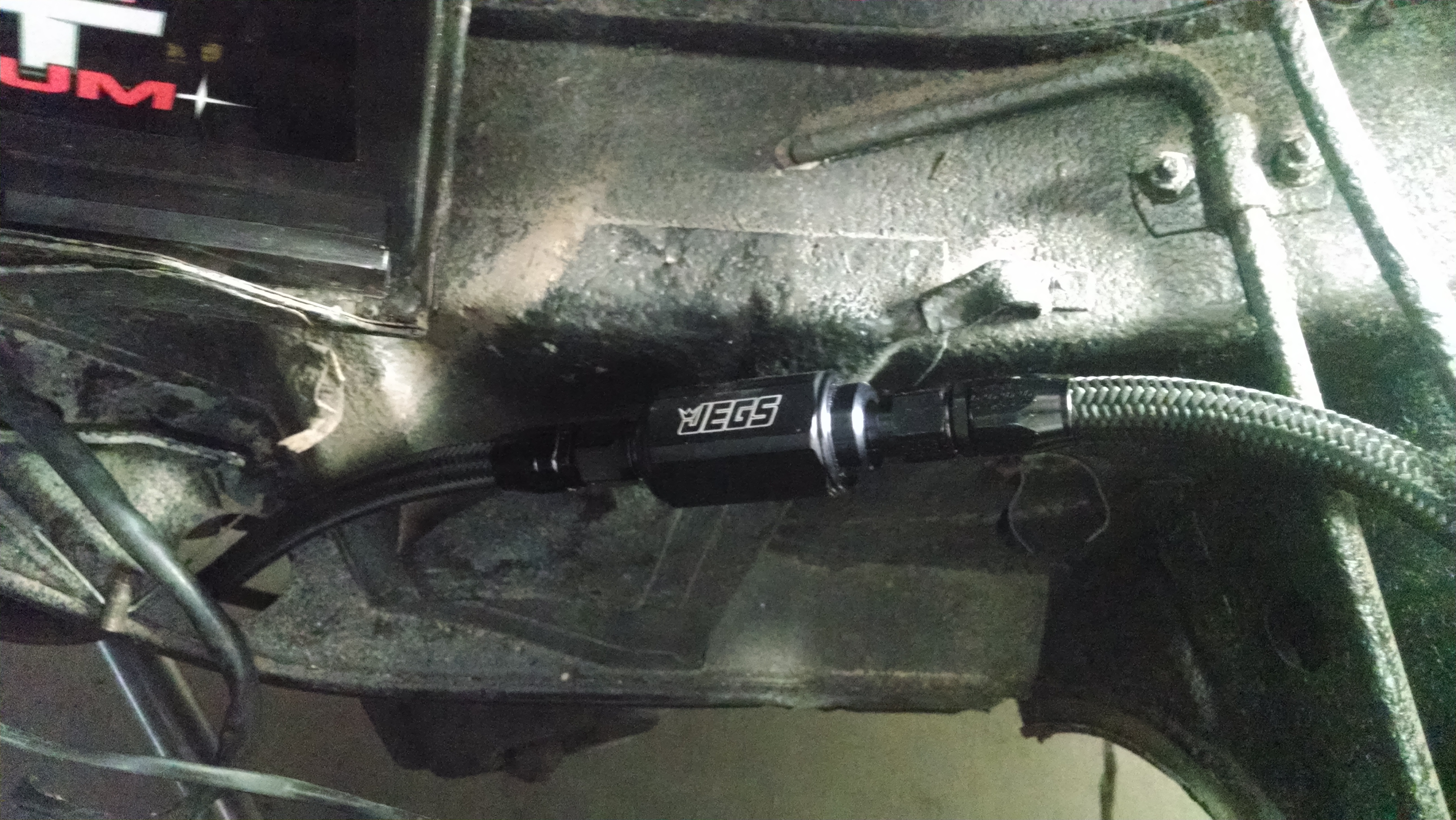

Jegs fuel filter

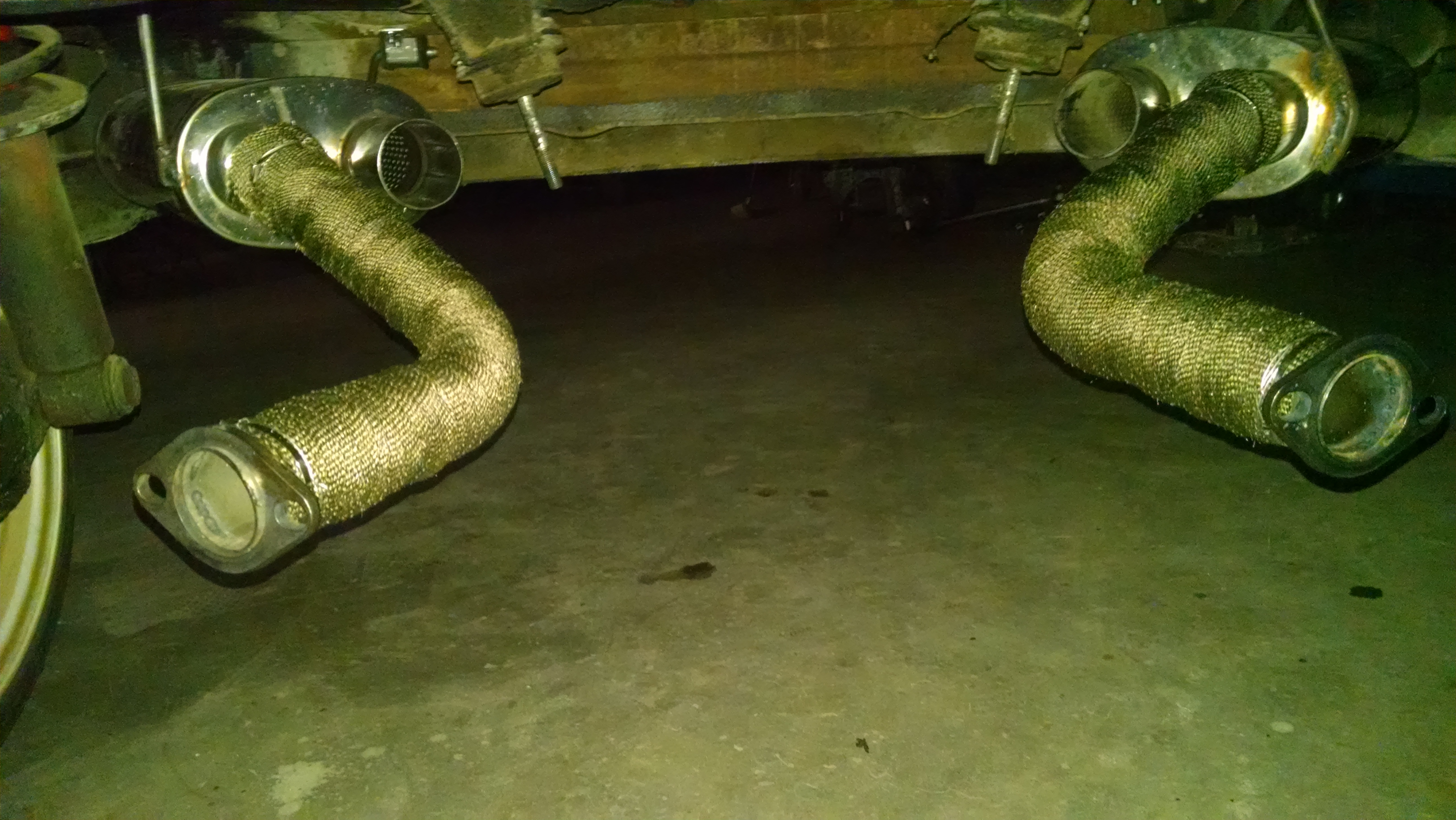

Exhaust hung and wrapped

Whats with the open areas of the exhaust? Going to do a crossover or is that the exit area?

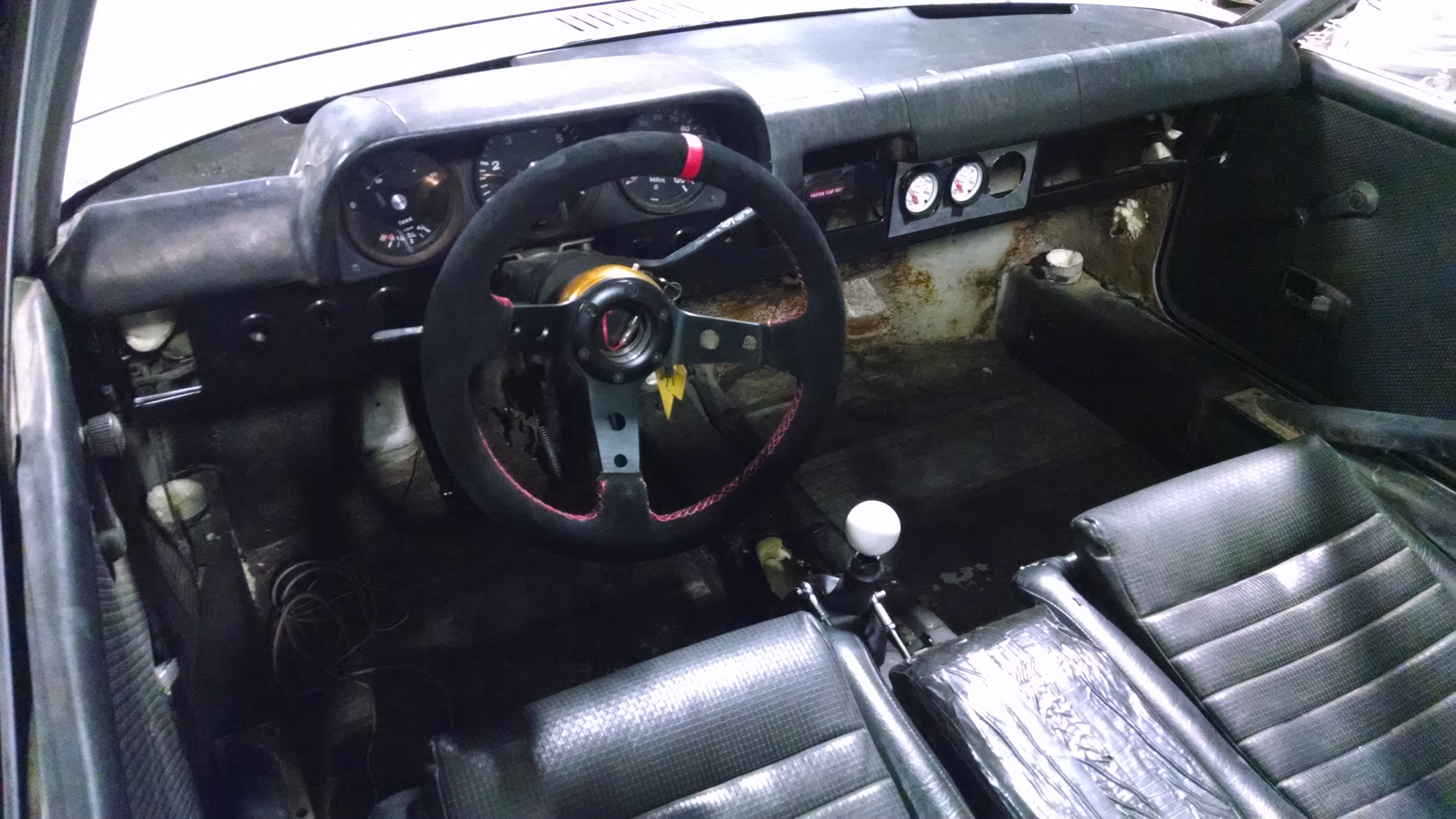

Thought about it maybe later down the road. I am just going to run them out the back or sides. Also got some new stuff in
-autometer phantom guages water temp/oil pressure
-momo steering wheel adaptor
-universal quick release
-universal black shade steering wheel
-used track 914 roll cage
-stinger ecu hooked up
-Water and fuel lines done

Gauges are just there for now until we get everything settled and set in stone but for now here a little video of its first true start still working things out but it has raised from the dead..

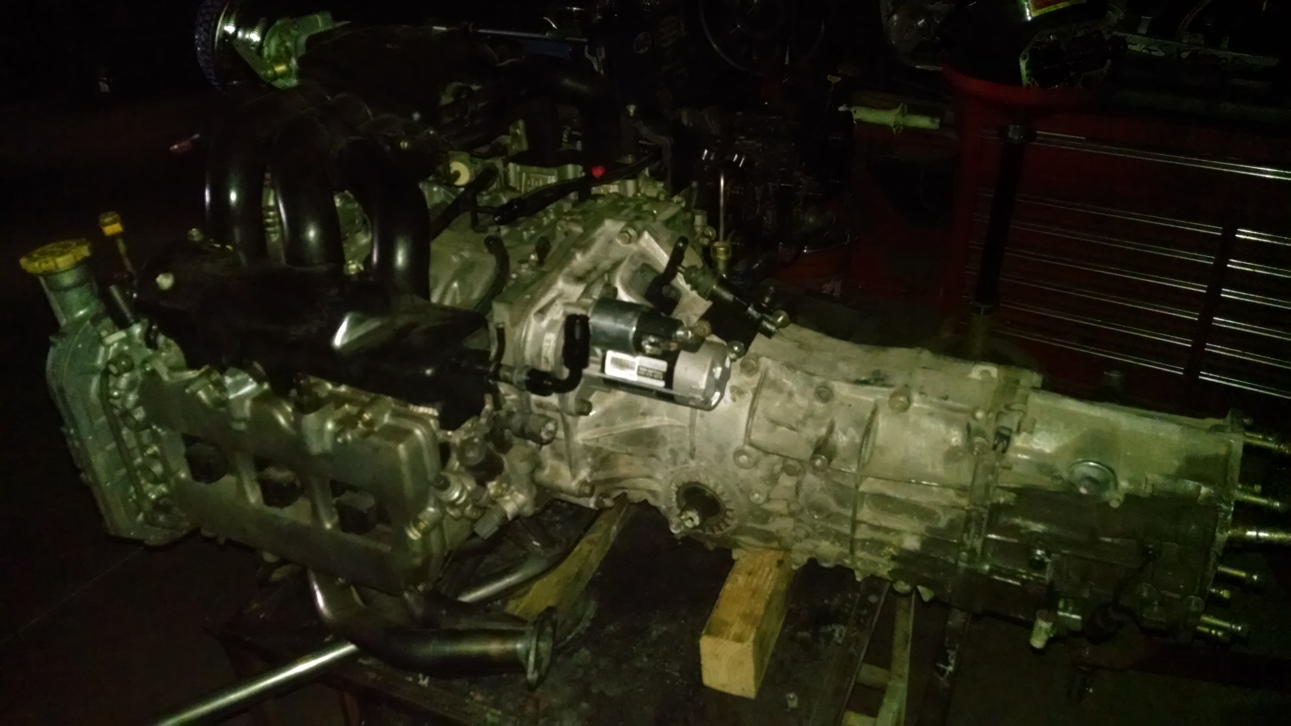

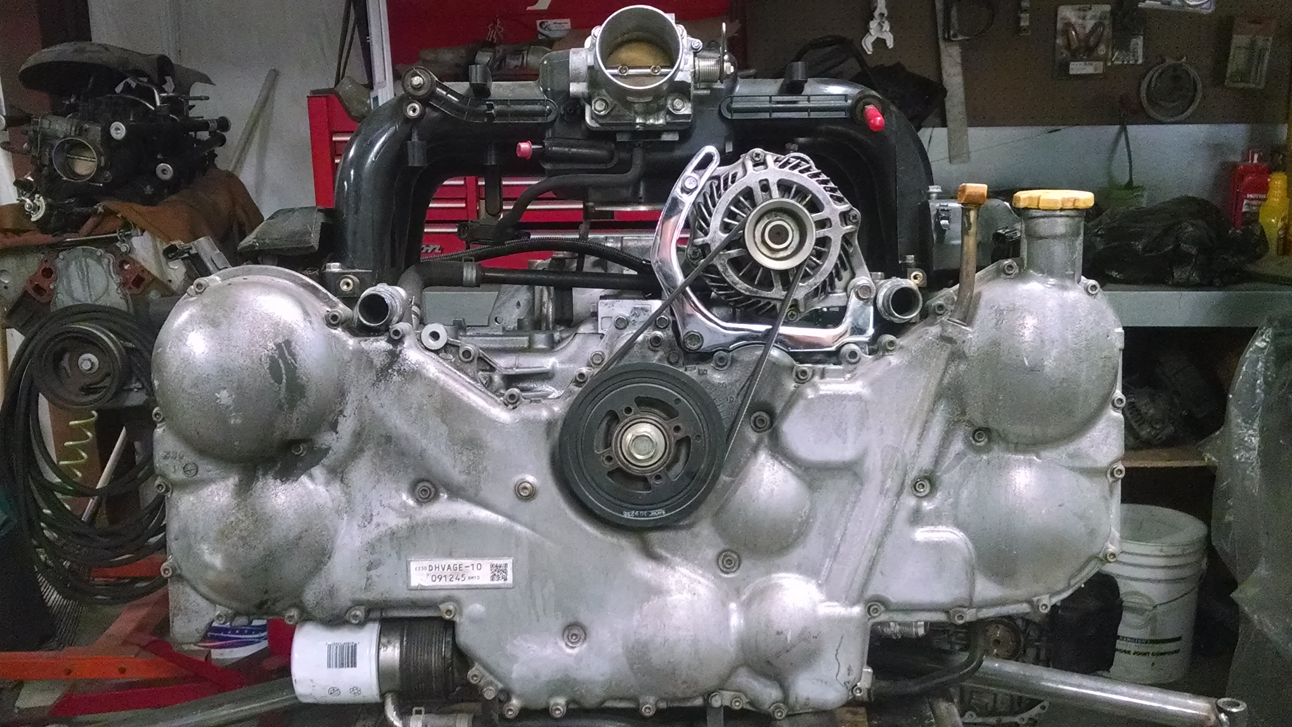

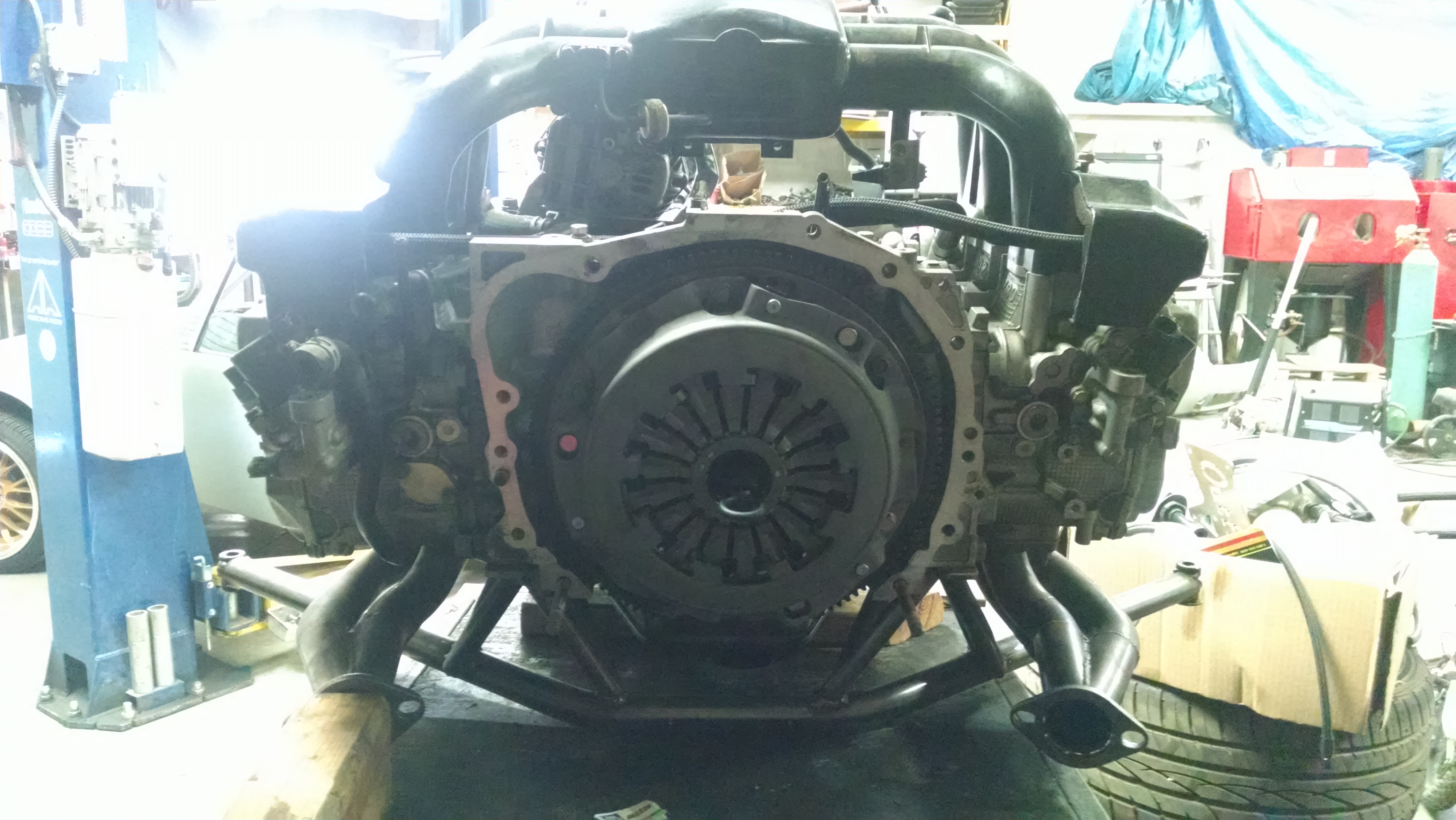

Here is some picture of the motor when it was out

Thank you guys at 914gonewild for doing the tig on the most important parts cause who knows what kind of mess I would have made

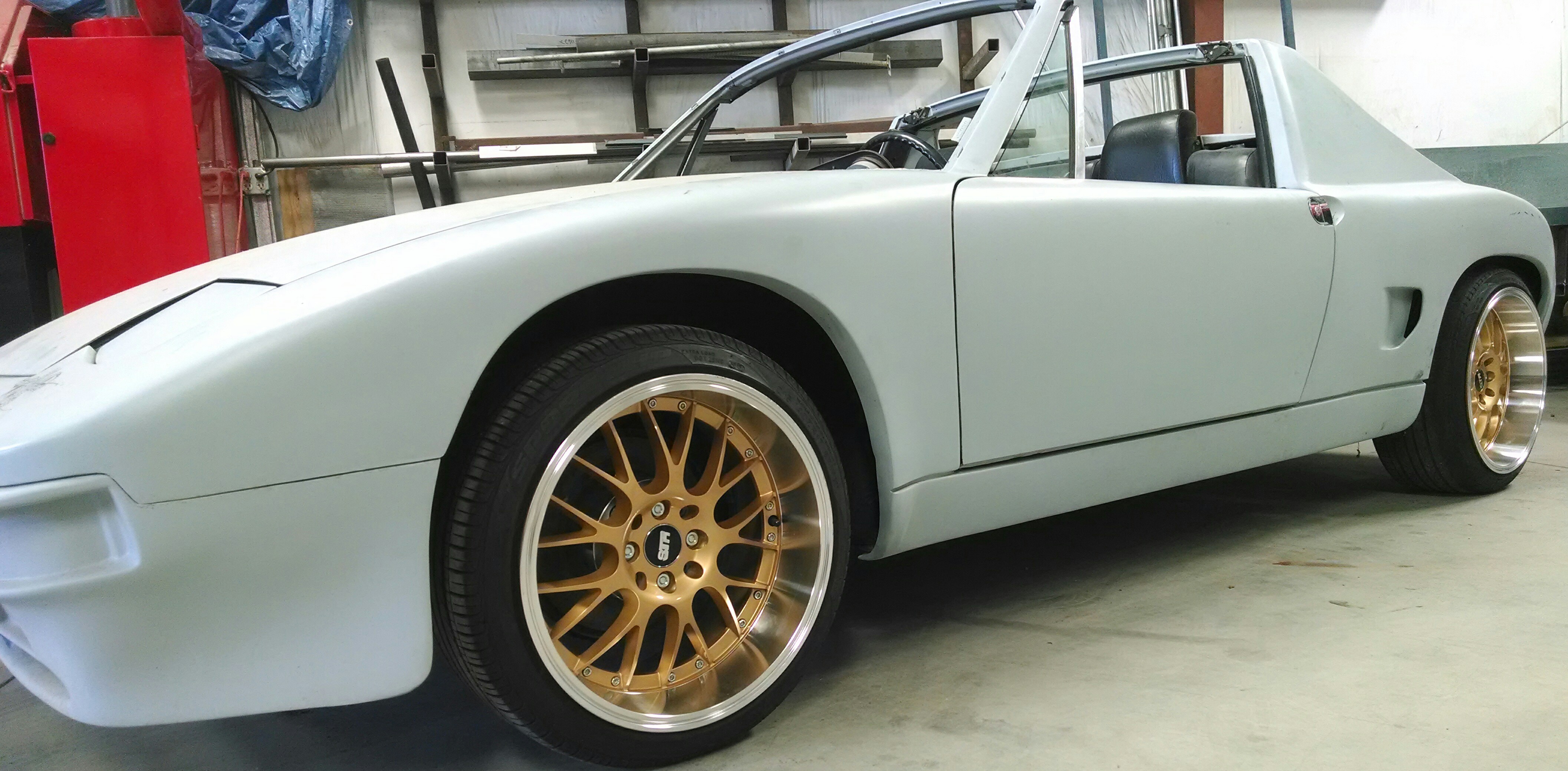

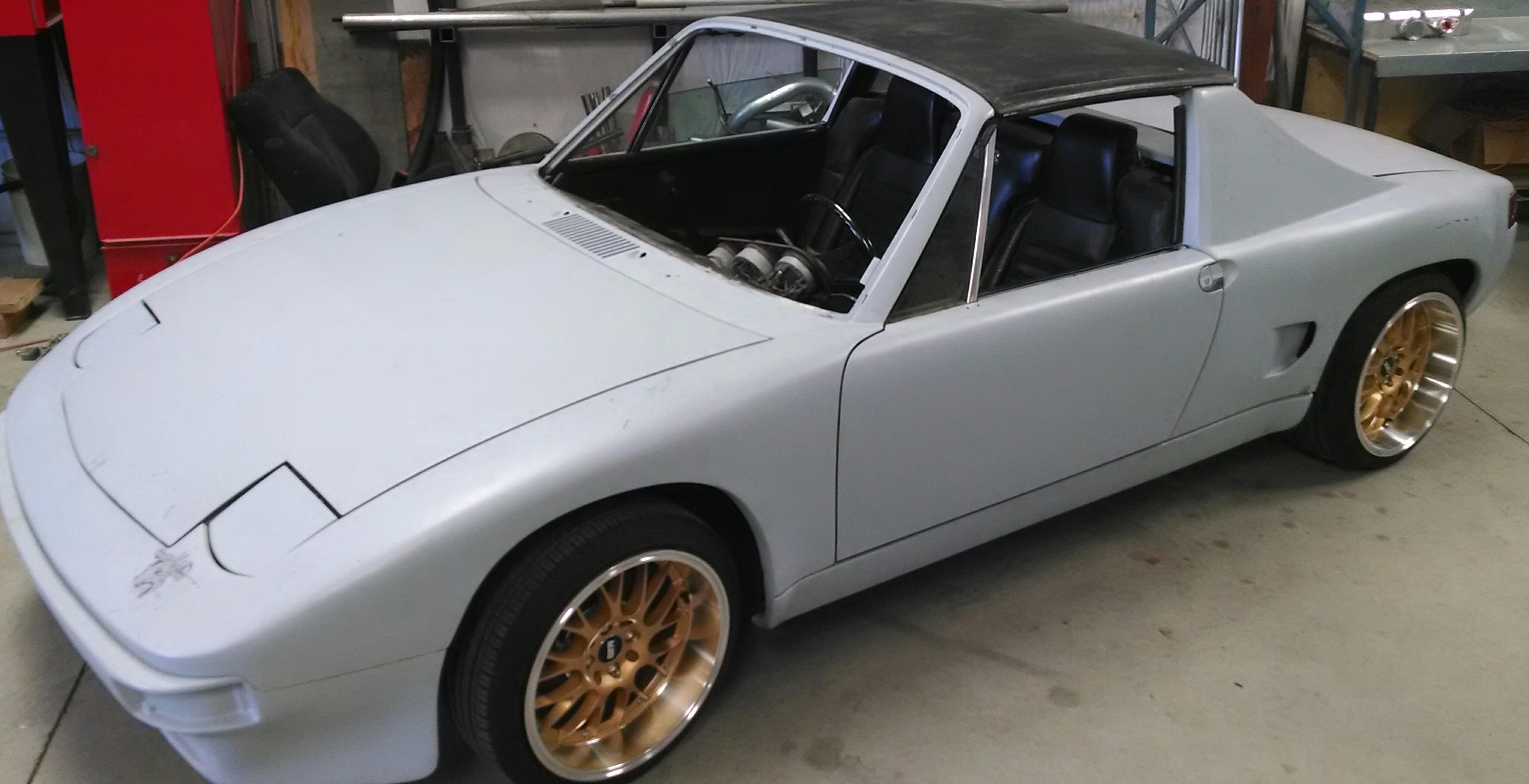

Well.... anyone following this thread will probably get an alert that it has been updated. SO HERE GOES:
The car now belongs to me. Fired it up last week. Heats up to operating temperature. Lots of plumbing was done for cooling system along with some trick water lines that route under the car (so no speed bumps for this badboy, period). I'll need to make some bump stops or a skid plate to protect them.
Most of the HARD work is done. I got it with no gauges and a broken driver side axle. I currently have a friend building axles for it (very stout ones) that shouldn't have any issues. The motor sits forward a bit, place some extra strain on axle angle, but it's more proper for weight distribution. Motor runs good. Heats up well. Charges battery.
Widebody done well. Need a new engine cover (rear deck lid, trunk, bonnet?).
Suspension is good, have coil overs I need to finish. Just added new tail lights.
Engine cradle is legit, trans mounts need work. Driver side obstructed by shifter cables. Easy fix.
Roll cage needs to be welded in.
New to wire and add all necessary gauges.
Need to finish air flow for radiator.
Need to fix exhaust. Great idea, poor design for airflow.
Need to paint it.
Needs the proper width tires installed. Running 215s on a 9.5 wide rim like the honda guys, should have 235s or 245s.
I will keep updating this from time to time. Unfortunately, this side had more info on what I picked up than the owner did. All in all, it's all there. Once its registered (after axles come) I'll get it over to my friend's dyno shop and get you guys some numbers on the engine output.
I'll also run it down Sonoma's drag strip just for an idea of power to weight, but it will be built for roadracing, NOT the drag strip. That's what an LS1 is for.
Any comments or suggestions are welcomed. Especially if you know anything about the car, hahahaha! It's pretty close to done and I'm excited to FINISH this thread for you guys, clearly it's been dragging on for quite some time!
