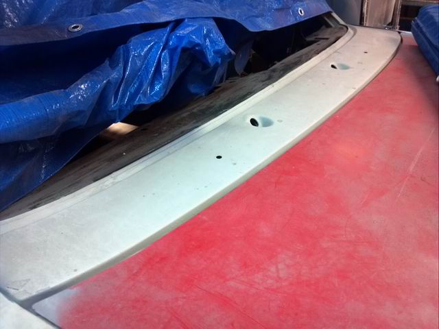

I currently do not have a fresh air box, but would like to keep water from running into my trunk during a rain or carwash. Any ideas as to how to tastefully seal the front grill? I'm considering maybe a plate underneath, sealed with silicone. Suggestions?

Tastefully... Weld and paint.
Or, put the fresh air box back in
Or, I once used polyurethane tape on the top to seal it temporarily.

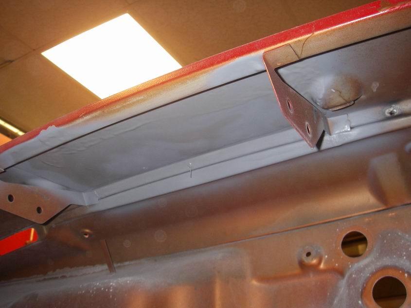

make a box about 3/4 inches deep, rectangular.
Put a drain in the corner and run the drain hose like the original, down under the gas tank and to the ground.

I may give that a try as welding is not an option. I will need to remove the gas tank to run the drain line, right?

no, you should be able to slide a hose about 3/4 inch diameter behind and down through the round hole at the bottom specifically for the drain hose from the original box.
The hold is towards the middle of the car in relationship to the big ass hole you can put your hand into underneath...
If I recall correctly, you can flick the hose into that hole via the large hole.
