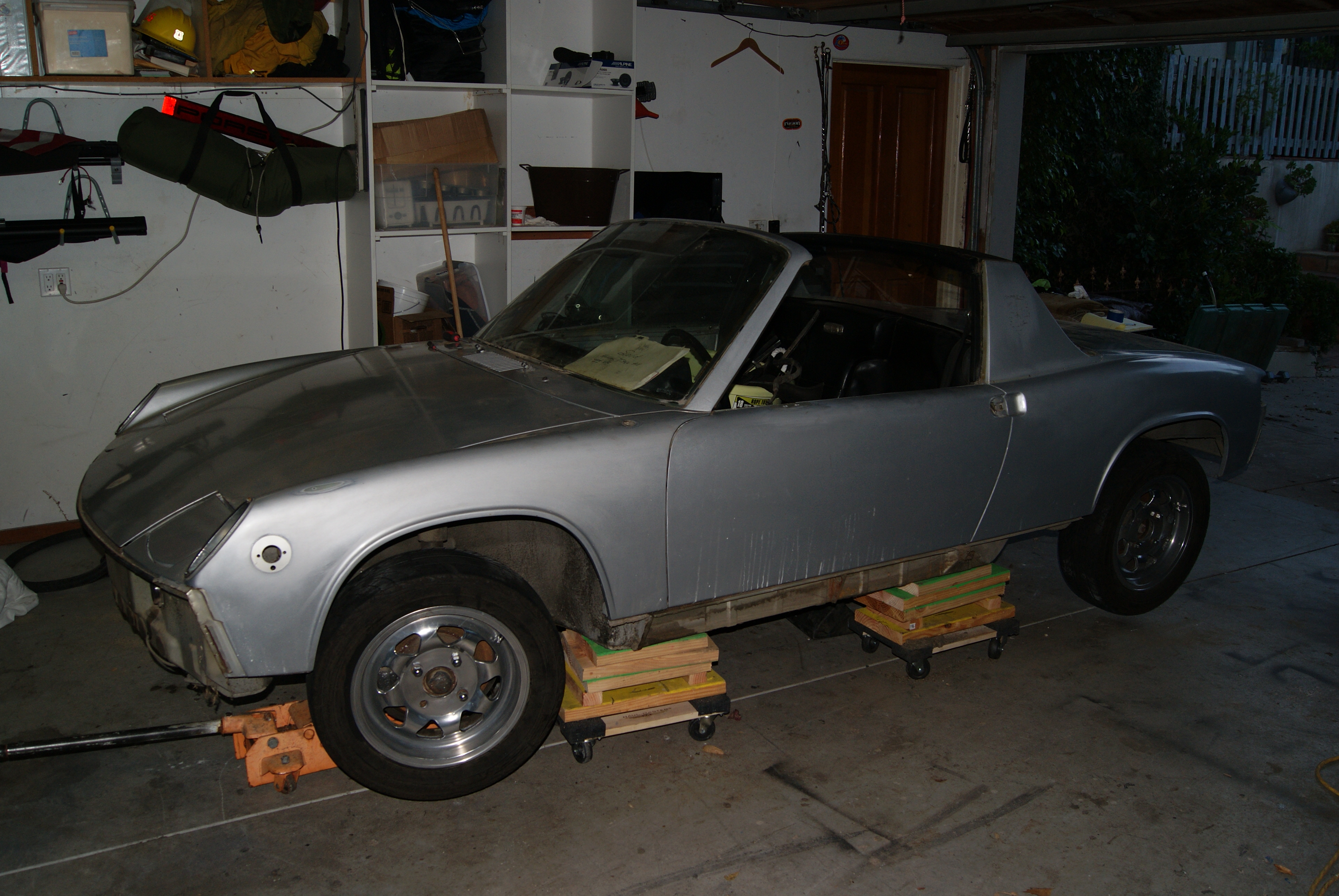

Today was a good day to start. Got help from my son and his buddy which really moved things along. Seats, carpet, trim, bumpers, valances, and AC unit have all been removed, labelled and carefully cataloged and stored away. We found the battery tray rusted away as well as a hole on the adjacent fender. Both will be an easy fix. Otherwise the body is in very good condition with no other rust. Picked up some used tires which we put on the alloy wheels. I believe they are Empi's as I had a set on my VW Variant years ago.

UhhOoo. Just a small hole. Good looking car. See the restoration threads on battery tray rust and I hope that's all there is. (IMG:style_emoticons/default/welcome.png)

Chassis looks pretty nice in that picture. Take your time and go over that whole chassis looking for rust. Best to ID it right away and address it before you do anything else to the car.

Pop the back pad and insulation pads off the firewall if you haven't already. Mine was a CA car and my firewall was swiss cheese.

Good start, check the passenger side jack post and under the longitudinal where it's welded on. Also the base of the bulkhead just in front of the engine where the floor pan stops. (IMG:style_emoticons/default/smash.gif) (IMG:style_emoticons/default/sawzall-smiley.gif) (IMG:style_emoticons/default/welder.gif)

The wheels on your car now are called Westerns. Even cooler than EMPIs. Nice save. That will turn out to be a very nice car.

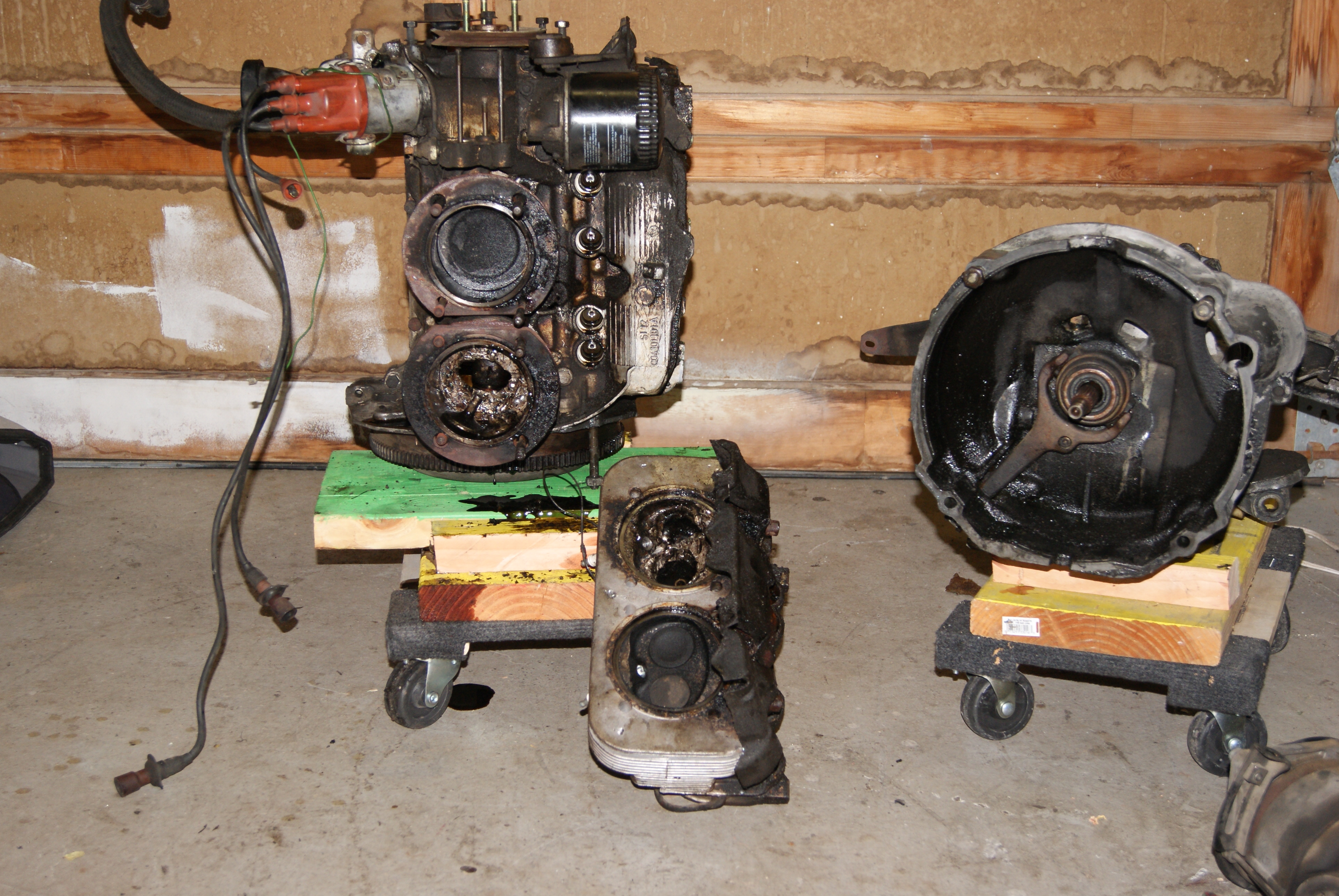

Today we pulled the engine/trans with not too much difficulty. Separated the trans from the engine and started engine breakdown. The good new is the I have a 2.0 #GC000317. The bad news is it looks as though I have sucked an intake valve into the cylinder. There's no valve there and I can see chunks of metal in the cylinder. Tomorrow should bring additional information once I get the heads off. Obviously it will require a rebuild, but should I increase displacement or leave it stock. Any thoughts? I will post pics tomorrow of what I find. Neil

2056 ... Same expense but more displacement ...

Well, just finished pulling the heads and wouldn't you know it we found armageddon. Somehow I don't think we will be repairing this head or using these cylinders. Look closely at the valves that we found inside the cylinder. The other side is in fine shape so I need to find at least one head. Any leads would be appreciated although I'm in no hurry as I want to get the body done first. I want to take my time and do things properly as well as learn everything about this project. Attached Image

Outsch! (IMG:style_emoticons/default/blink.gif)

That's rough, pull the rest of the engine apart and see if you have a useable case/crank etc. May just require new pistons/cylinder/head (1), might need rods as well.
What head do you have on the other side? (3 or 4 bolt intake)

They are three bolt. I originally thought it was a 1.8 as I couldn't see the engine ID. Now we know it's a 2.0. The engine turns over easily and am hoping not to break the case, but will do further investigation before I move forward. I look at it as just part of process and will enjoy the rebuild whatever will be necessary. I knew that there would be challenges when I bought the car. I'm just glad that this is virtually a rust free car, I feel as though I'm ahead of the game. At this point I'm going to put the engine aside and concentrate on body work. I will keep an eye open for a replacement head or a set if necessary. Any input is appreciated. Neil
