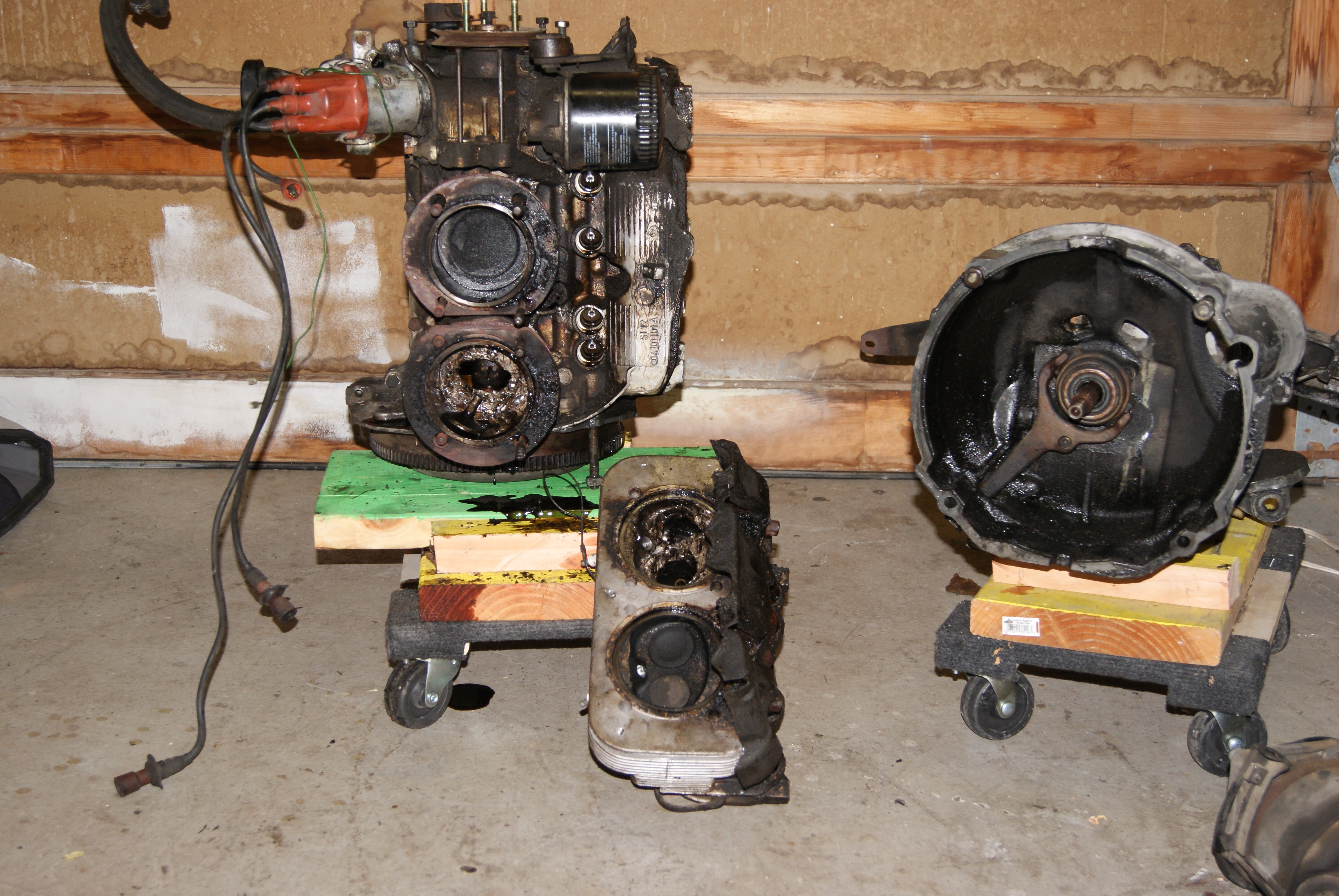

Today we pulled the engine/trans with not too much difficulty. Separated the trans from the engine and started engine breakdown. The good new is the I have a 2.0 #GC000317. The bad news is it looks as though I have sucked an intake valve into the cylinder. There's no valve there and I can see chunks of metal in the cylinder. Tomorrow should bring additional information once I get the heads off. Obviously it will require a rebuild, but should I increase displacement or leave it stock. Any thoughts? I will post pics tomorrow of what I find. Neil

Well, just finished pulling the heads and wouldn't you know it we found armageddon. Somehow I don't think we will be repairing this head or using these cylinders. Look closely at the valves that we found inside the cylinder. The other side is in fine shape so I need to find at least one head. Any leads would be appreciated although I'm in no hurry as I want to get the body done first. I want to take my time and do things properly as well as learn everything about this project. Click to view attachment

AE354803
QUOTE(X911IC @ Aug 8 2013, 09:12 PM) *
That's rough, pull the rest of the engine apart and see if you have a useable case/crank etc. May just require new pistons/cylinder/head (1), might need rods as well.
What head do you have on the other side? (3 or 4 bolt intake)

They are three bolt. I originally thought it was a 1.8 as I couldn't see the engine ID. Now we know it's a 2.0. The engine turns over easily and am hoping not to break the case, but will do further investigation before I move forward. I look at it as just part of process and will enjoy the rebuild whatever will be necessary. I knew that there would be challenges when I bought the car. I'm just glad that this is virtually a rust free car, I feel as though I'm ahead of the game. At this point I'm going to put the engine aside and concentrate on body work. I will keep an eye open for a replacement head or a set if necessary. Any input is appreciated. Neil
