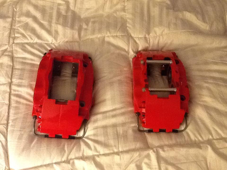

Ive got a line on some calipers, and wondering if anyone can ID them.
Eric?
Any idea on what they are worth? They are missing your standard hardware, but were rebuilt and coated.

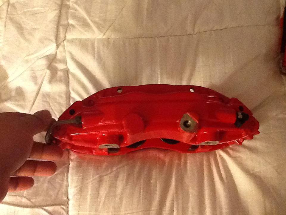

Hard to tell... piston size?

Donno. Im thinking they are rears though. But they were built from ECS tuning for a big brake kit. Thats about all I know.

Looks like my 993 Big Reds.

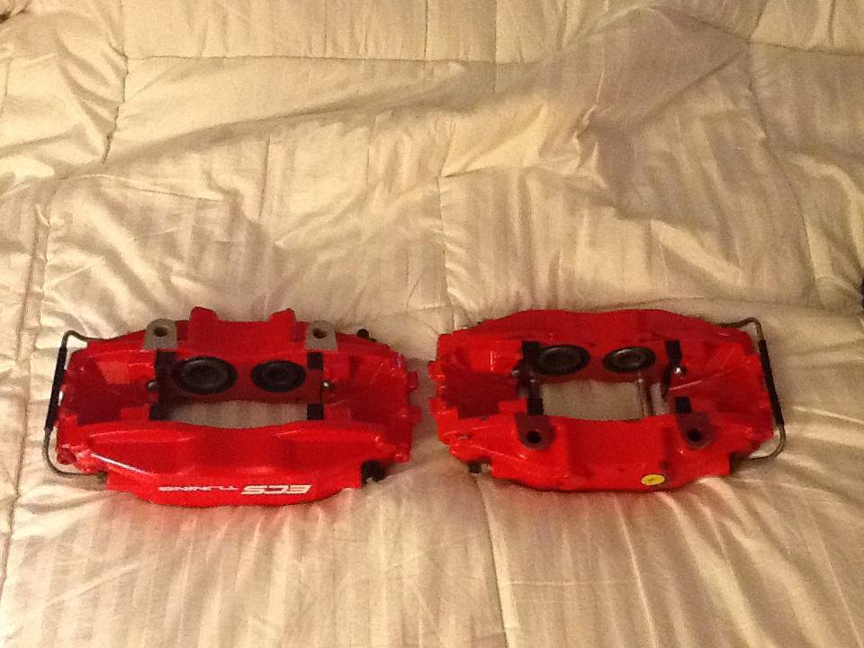

You need measurements from each caliper, either they are mismatched or the cross over tube is installed incorrect on 1 of the calipers.
On 1 caliper the cross over tube is near the small pistons and on the other caliper the tube is near the large pistons.
Does ECS use real Brembos or are they a copy?

Looking at the mounting holes in relation to the piston size it looks like there is one left and one right. I they they just have the tubes and bleeders installed wrong.

They look more like S4 Fronts than Big Reds to me, but a little hard to tell.
The difference is the dimension of the pads. Top to bottom is the same but in/out dimension is larger on the big reds (48mm vs. 58mm).
That is an excellent price btw.

Essentially that was what I was pointing out, although without measurements (pad size, piston diameters, etc...) from each caliper you don't know for sure if they match each other.
I have a 'pair' of Ferrari (F40) calipers that turned out to be 1 front caliper and 1 rear.
I also had to swap, side to side, a pair of Brembo calipers that the shop before me had installed wrong and I had to move the bleeders and cross over tubes. Would have been easy except the flair nuts on the cross over tubes had been epoxied in.

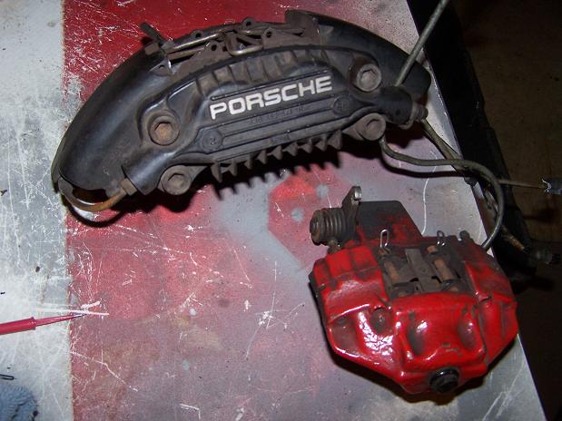

Here's a 930 rear caliper from an '86.

Price is OK but, again, pistons size will tell the story. Rears will have smaller 30, 34 and possibly 36mm pistons.
The one on the left (in the last picture) is set-up properly.
