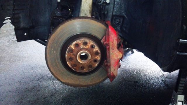

I was thinking of putting these on my 914 or maybe my Allroad if I can do it cheap enough.
Here is what the S4 and A6 (Allroad) calipers look like.
