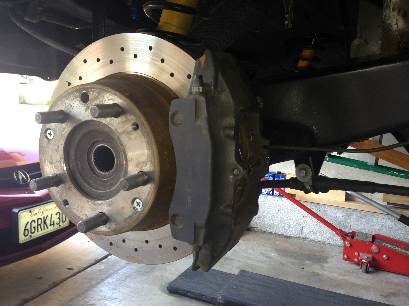

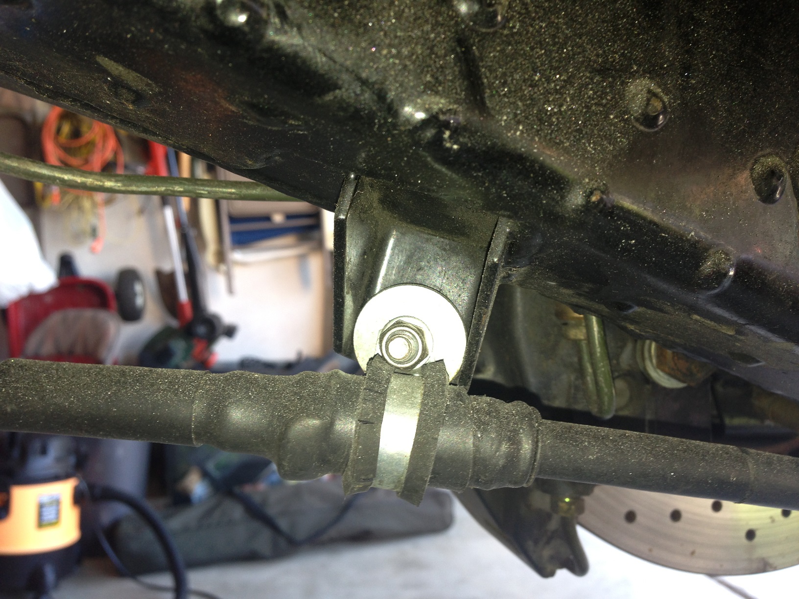

Jeff Hail   First pic to give an idea what the 11 arm looks li...   Aug 19 2013, 07:57 PM
jaxdream   First pic to give an idea what the 11 arm looks l...   Aug 20 2013, 07:46 AM
