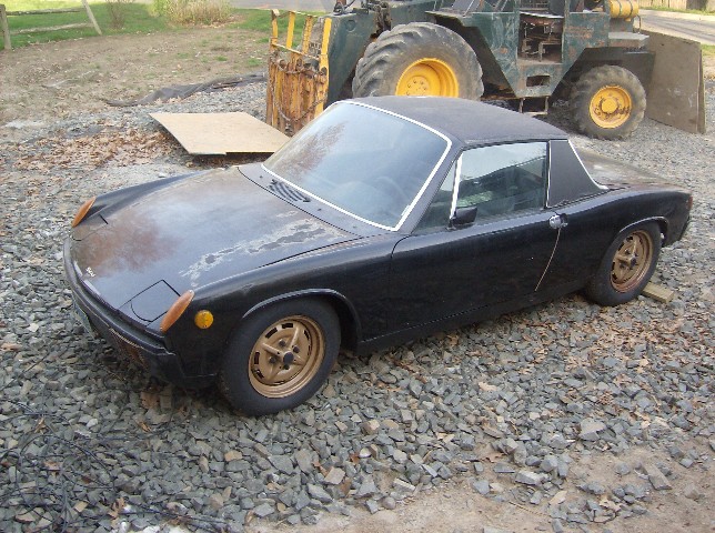

914world dip thread
I'm considering this process for my daily driver/beater.
thinking the cost would be around $300ish
the finish would seem to be very forgiving (minimal prep)...just want it to look presentable and somewhat clean.
curious what results others got... (IMG:style_emoticons/default/confused24.gif)

You're going to spend close to $500 to have it plasti-dipped. But if you're going to spend that much for that kind of work, why not rough up the paint with a DA, and shoot the Dupli-Color stuff you can get at Autozone? I bet you could do a decent driver-quality job for under $400 for paint and supplies.
Or you can go to Home Depot and get the Plasti-Dip basic colors in an aerosol can and do it yourself. Keep in mind though, if the paint has a bunch of holes in it/isn't smooth, that stuff won't just peel off later on.

I just "dipped" my co-workers old 540i. It took 2.6 gallons of pre-thinned dip to do 7 coats.
Turned out really nice, and much cheaper than a paint job. The sweet thing, is you don't really need to mask off anything(we just did windows for speed and wheels to keep it off the brakes). Just wash, rubbing alcohol wipe down and go.
(IMG:http://www.914world.com/bbs2/uploads_offsite/img826.imageshack.us-11125-1377026687.1.jpg)
(IMG:http://www.914world.com/bbs2/uploads_offsite/img51.imageshack.us-11125-1377026687.2.jpg)
If the dip starts to look beat-up, you just re-coat.
Matt

A 914 is smaller, so you'd probably need closer to what, 3 gallons? Each of those is $60.00 a pop. If you don't have an appropriate sprayer, you have to buy that too. I do like the fact that you can re-do it, but I'm not sure how well it would lay down on an already spotty paint job. Plus, no matter how much "glossifier" or whatever add-ons those guys sell, Plasti-dip never comes out as glossy as real paint. And you get that "cool" ricer look that everyone is raving about. (IMG:style_emoticons/default/dry.gif)
If it were me, I'd go the paint route.

The BMW in the picture had super flakey clear coat all over the hood. While not perfect, it certainly is a huge improvement that can be done in your driveway and driven in hours.
It's not for everyone, but you can get a great looking coat and a wide range of colors (including pearl effects).
My suggestion for the best looking coat on the 914 trunk and hood is to paint them off the car sitting vertical.
Matt

You can use a cheap home depot sprayer(high volume low pressure). A 914 probably could get by with 1-2 gallons. You can buy the full strength dip, and thin it yourself for cheaper.
You certainly will not get a glossy paint job, but its cheap and if you screw up you just peel it off and paint again.
