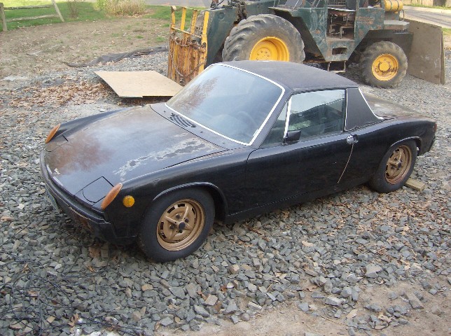

I'm considering this process for my daily driver/beater.
thinking the cost would be around $300ish
the finish would seem to be very forgiving (minimal prep)...just want it to look presentable and somewhat clean.

I just "dipped" my co-workers old 540i. It took 2.6 gallons of pre-thinned dip to do 7 coats.
Turned out really nice, and much cheaper than a paint job. The sweet thing, is you don't really need to mask off anything(we just did windows for speed and wheels to keep it off the brakes). Just wash, rubbing alcohol wipe down and go.
IPB Image
IPB Image
If the dip starts to look beat-up, you just re-coat.
Matt

matthepcat
The BMW in the picture had super flakey clear coat all over the hood. While not perfect, it certainly is a huge improvement that can be done in your driveway and driven in hours.
It's not for everyone, but you can get a great looking coat and a wide range of colors (including pearl effects).
My suggestion for the best looking coat on the 914 trunk and hood is to paint them off the car sitting vertical.
Matt
