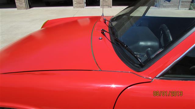

I bought the rubber from Mikey and had the pro's install it with a new windshield. Very happy.
Lemme see if I can find a pic.
Andyrew
post Aug 19 2013, 12:01 AM
Spooling.... Please wait
Posts: 13,380
Joined: 20-January 03
From: Riverbank, Ca
Member No.: 172
As good a pic as any (IMG:http://www.914world.com/bbs2/uploads/post-172-1314494826.jpg)

.my installation
