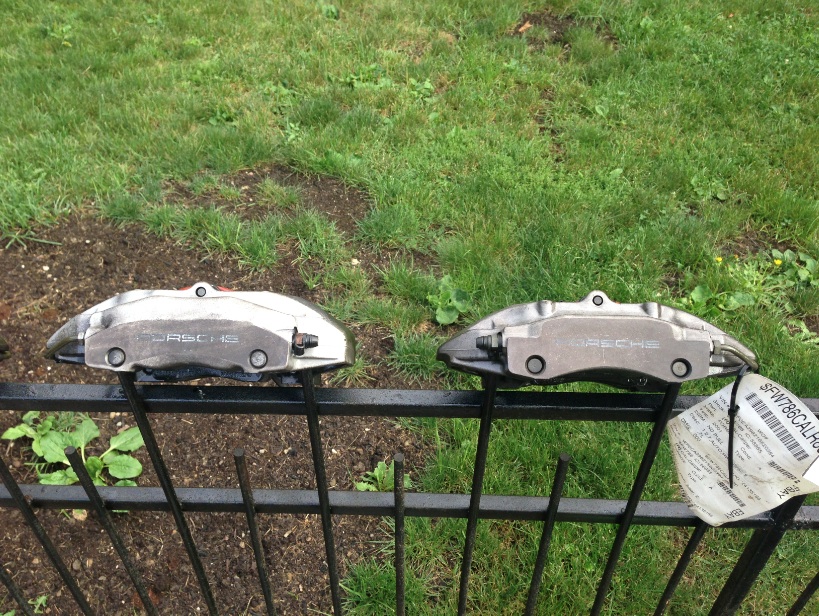

CptTripps   Brakes arrived! ...and they're wrong. ...   Aug 30 2013, 06:49 AM

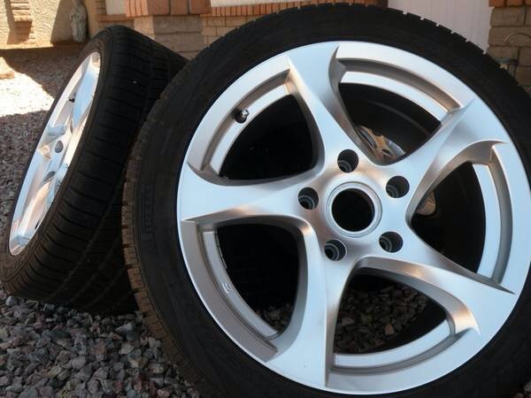

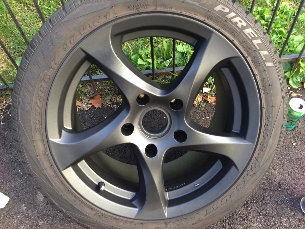

CptTripps   Rims I picked up locally off of Craigslist. ...   Aug 30 2013, 06:53 AM
uncle smokey   The wheels look great. I am curious to see how the...   Aug 30 2013, 09:38 AM
CptTripps   Just the regular PlastiDip Spray you buy from Home...   Aug 30 2013, 07:10 PM

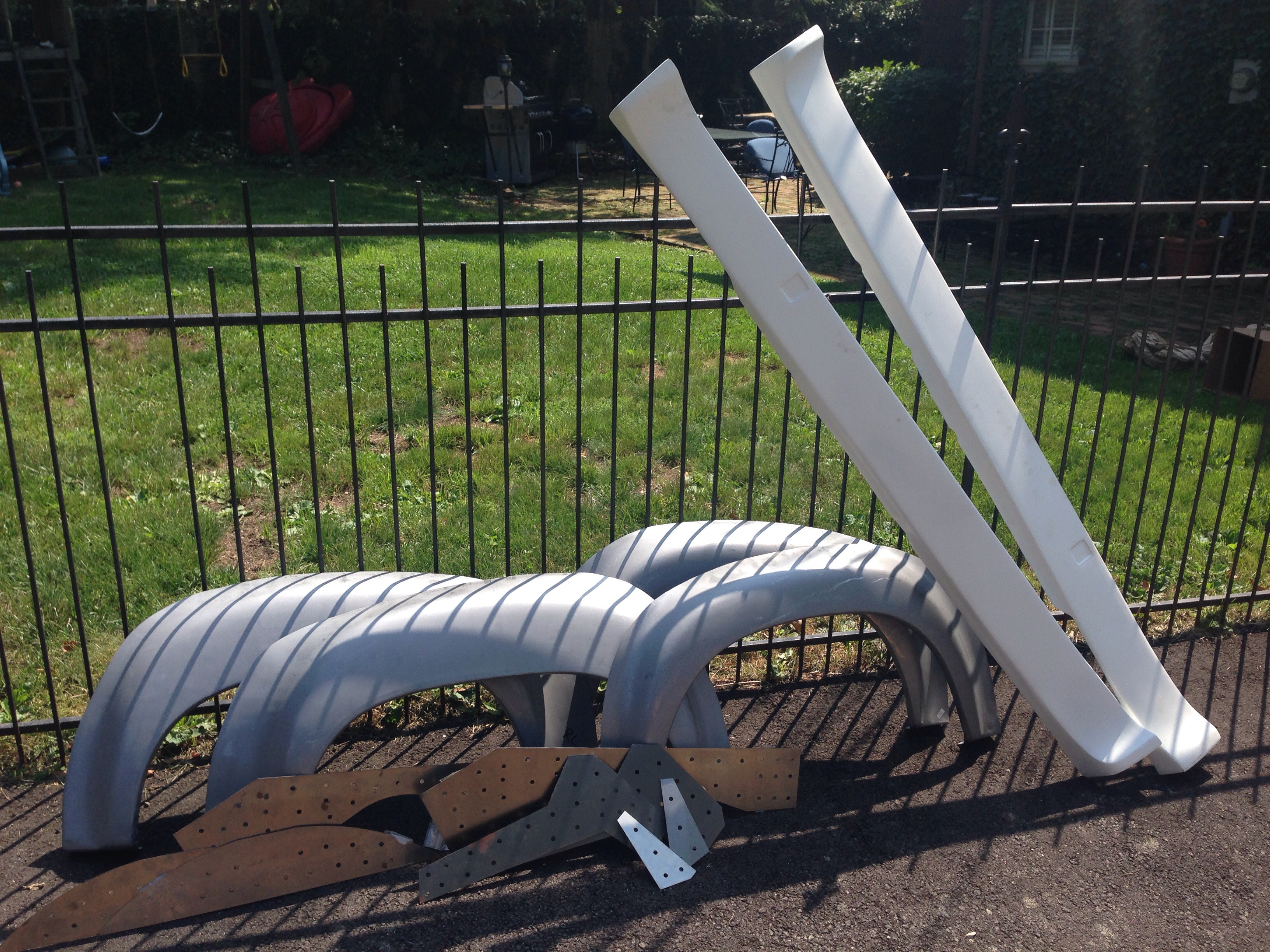

CptTripps   Parts fairy showed up today...with a great deliver...   Aug 31 2013, 12:44 PM
914forme   Parts fairy showed up today...with a great delive...   Sep 5 2013, 09:42 PM
CptTripps   Got the RIGHT calipers in today. They're quite...   Sep 5 2013, 06:57 AM

CptTripps   Dropped the Calipers off today for Power-Coat. The...   Sep 9 2013, 06:22 PM
McMark   Flush them when you get them back. Then flush them...   Sep 9 2013, 07:39 PM
CptTripps   Flush them when you get them back. Then flush the...   Sep 10 2013, 07:42 AM

CptTripps   When he called this morning, I was expecting the p...   Sep 10 2013, 12:09 PM

CptTripps   Got the calipers back from powder-coating. They lo...   Sep 11 2013, 10:59 AM

CptTripps   Got the calipers sorted last night. Started rebuil...   Sep 12 2013, 01:46 PM
CptTripps   A bunch of perforated metal showed up today. Gett...   Sep 12 2013, 04:06 PM

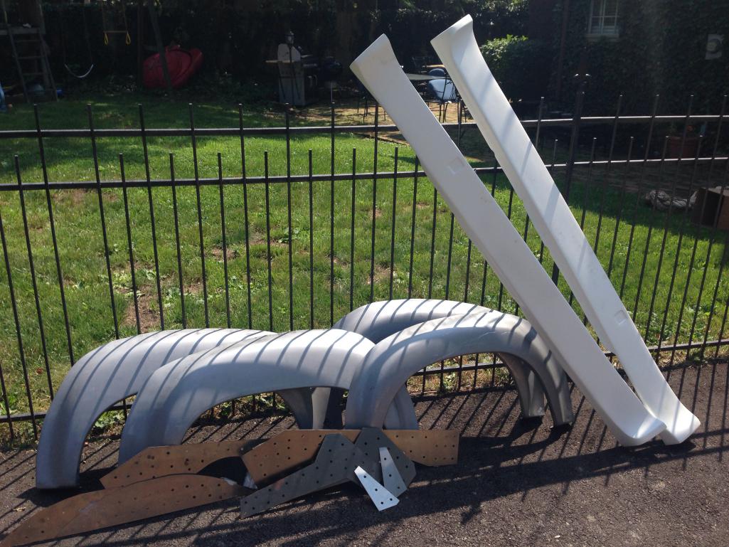

CptTripps   Started working on the flares today. Marked everyt...   Sep 14 2013, 04:26 PM
CptTripps   Flares are on...time for some banging and bondo th...   Sep 19 2013, 08:15 AM

strawman   As someone who has done the trailing arm reinforce...   Sep 21 2013, 10:44 PM
CptTripps   As someone who has done the trailing arm reinforc...   Sep 23 2013, 06:37 AM
rick 918-S   As someone who has done the trailing arm reinfor...   Sep 23 2013, 08:29 AM
CptTripps   It's all un-sprung weight. The worst kind to ...   Sep 23 2013, 08:39 AM
r_towle   If you can break a pinion gear clean off the shaft...   Sep 21 2013, 11:03 PM
CptTripps   Interesting call on the trailing arms. Hadn't ...   Sep 22 2013, 06:31 AM
jimkelly   I think the consensus will be to fully spot the en...   Sep 22 2013, 06:48 AM
McMark   :o Weld it all.   Sep 22 2013, 07:12 AM
CptTripps   Most of the gaps between welds are under 1/2...   Sep 22 2013, 07:13 AM
CptTripps   Worked on welding up the gaps today. My welder too...   Sep 22 2013, 04:25 PM

CptTripps   The calipers were powder-coated...the "PORSCH...   Sep 25 2013, 09:01 AM
