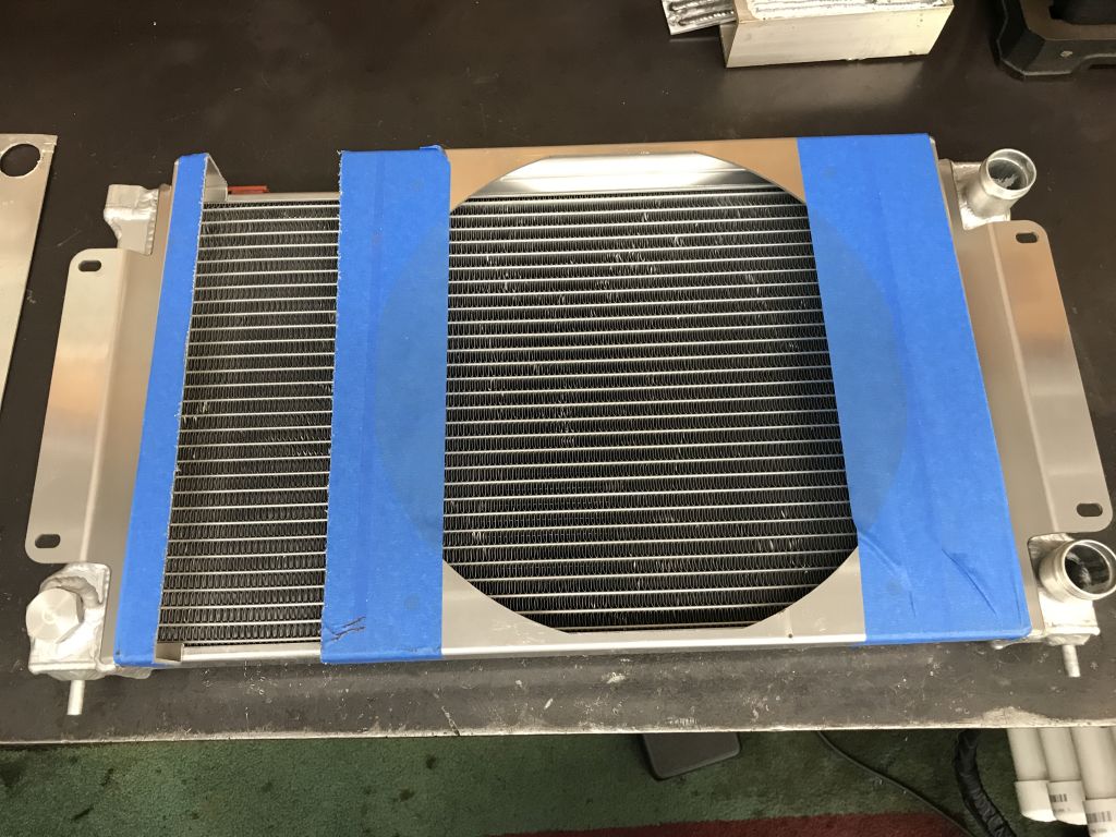

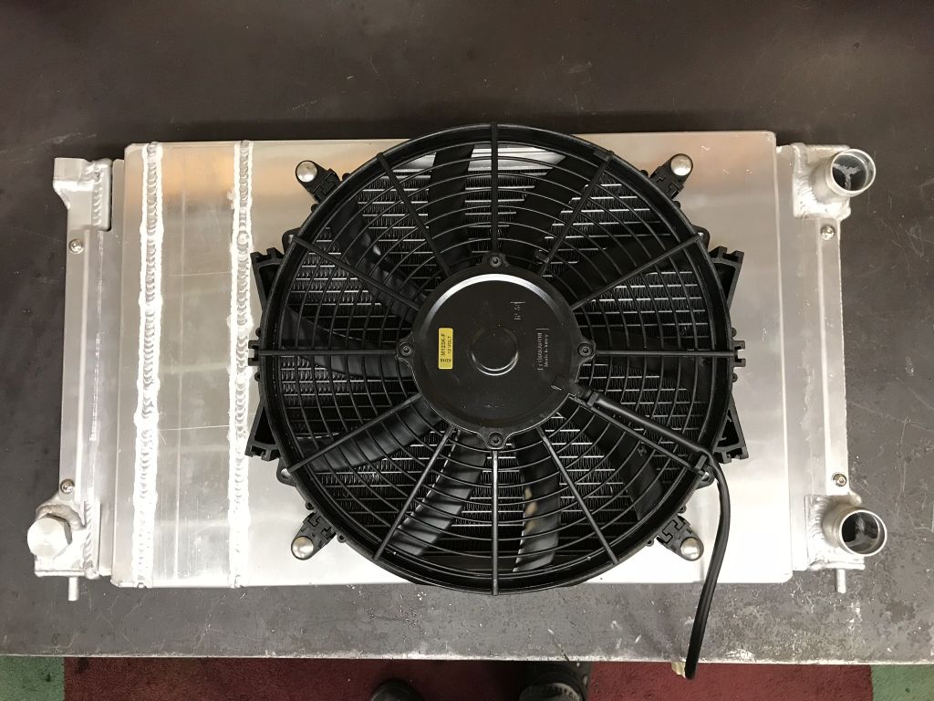

The AFCO Scirocco radiator fan shroud showed up. Really nice piece but something is not right?! (IMG:style_emoticons/default/blink.gif)
After much measuring and internet searching it turns out that it is not the standard Scirocco rad but some universal radiator for Volkswagen Golf, GTI, Rabbit, Scirocco.
Radiator
Unfortunately there is not a nice fan shroud for this rad...I guess that I will have to widen this one:welder:

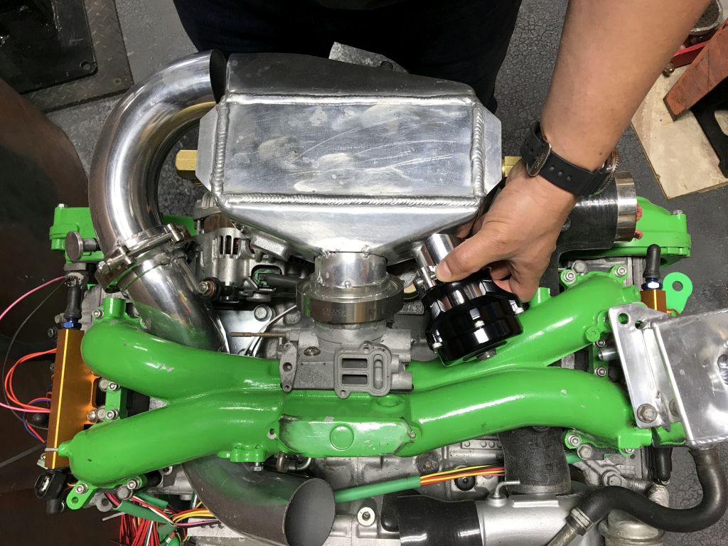

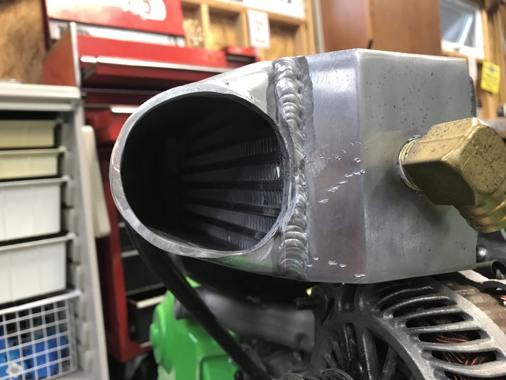

Business travel is over for a while so it it time to get serious about Grey.
Got the new Tig welder dialed in so it was time to finish the IC plumbing.
The best execution looks simple...it wasn't. Many fine adjustments to get the gaps tight enough to Tig weld. Final fitting was done on the belt sander.
Lots of work to open up the outlet of the IC, should flow cleanly.
Still need to weld the seams on the IC and then fit the Tial BOV.
Also started modifying the radiator fan. Could have made more progress but the new brake didn't show up on Friday.

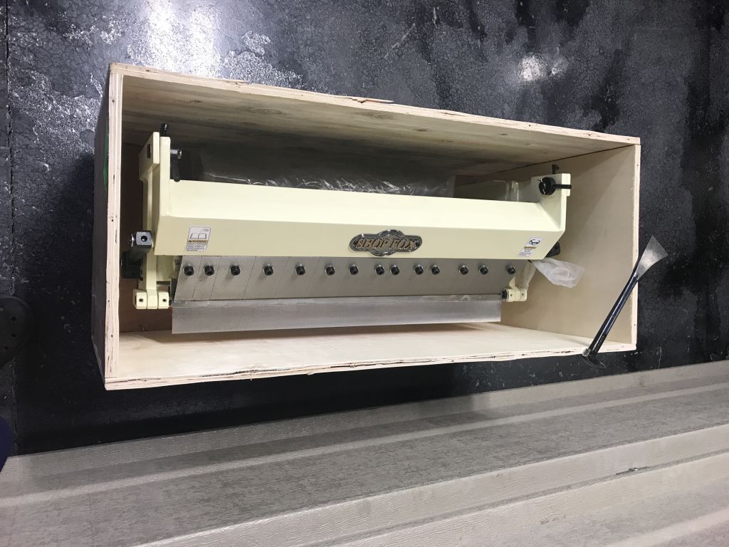

What day is it...new tool day!!!
No more (IMG:style_emoticons/default/smash.gif) to bend sheet metal.

effutuo101
post Oct 9 2017, 10:10 PM
Post #1009
Posts: 2,737
Joined: 10-April 05
From: Lemon Grove
Member No.: 3,914
Sweet!
post Oct 10 2017, 07:39 AM
Post #1010
Posts: 3,896
Joined: 24-July 04
From: Dayton, Ohio
Member No.: 2,388
QUOTE(Amenson @ Oct 9 2017, 07:57 PM) *
Cheers,
Scott
(IMG:style_emoticons/default/piratenanner.gif) I'll be over once I mock all my stuff up.
Nice finger brake.

QUOTE(914forme @ Oct 10 2017, 09:39 AM) *
Cheers,
Scott
Nice finger brake.
You can use it any time. Just keep in mind that it is only 24" wide. I could not justify the cost or footprint of the 48".

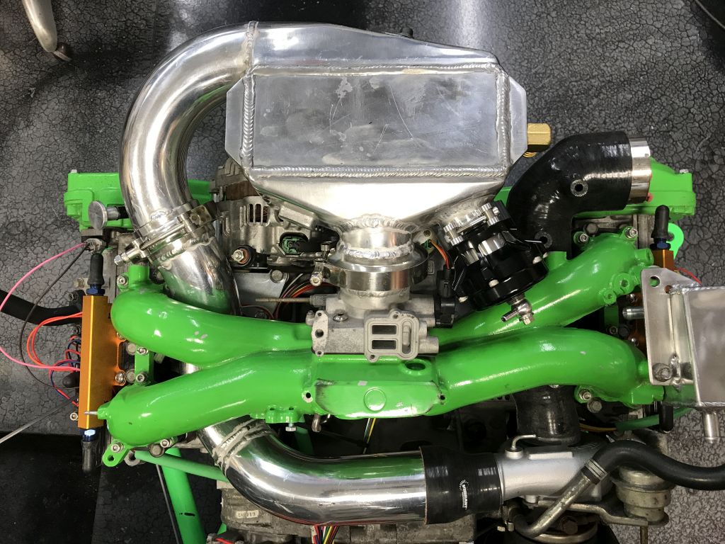

Finished welding the IC joints and installed the BOV.
Not quite #weldporn quality beads but nice and tidy. I did get myself in a bit of trouble on the inside of the sweeper coming out of the IC. My torch would not fit for proper arc position but I tried to make it work and left a blob that took a ton of work to smooth out. Lesson learned....always take the time to configure the torch to fit.

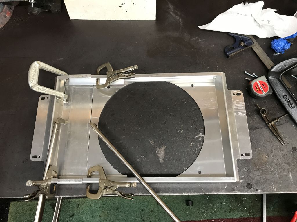

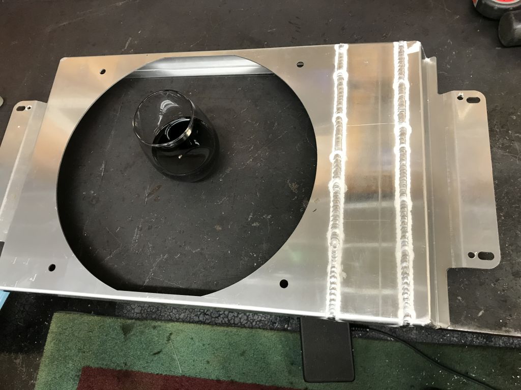

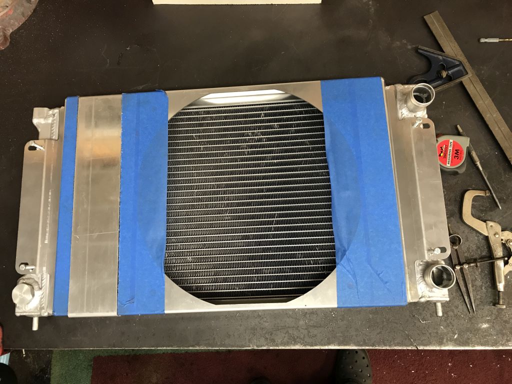

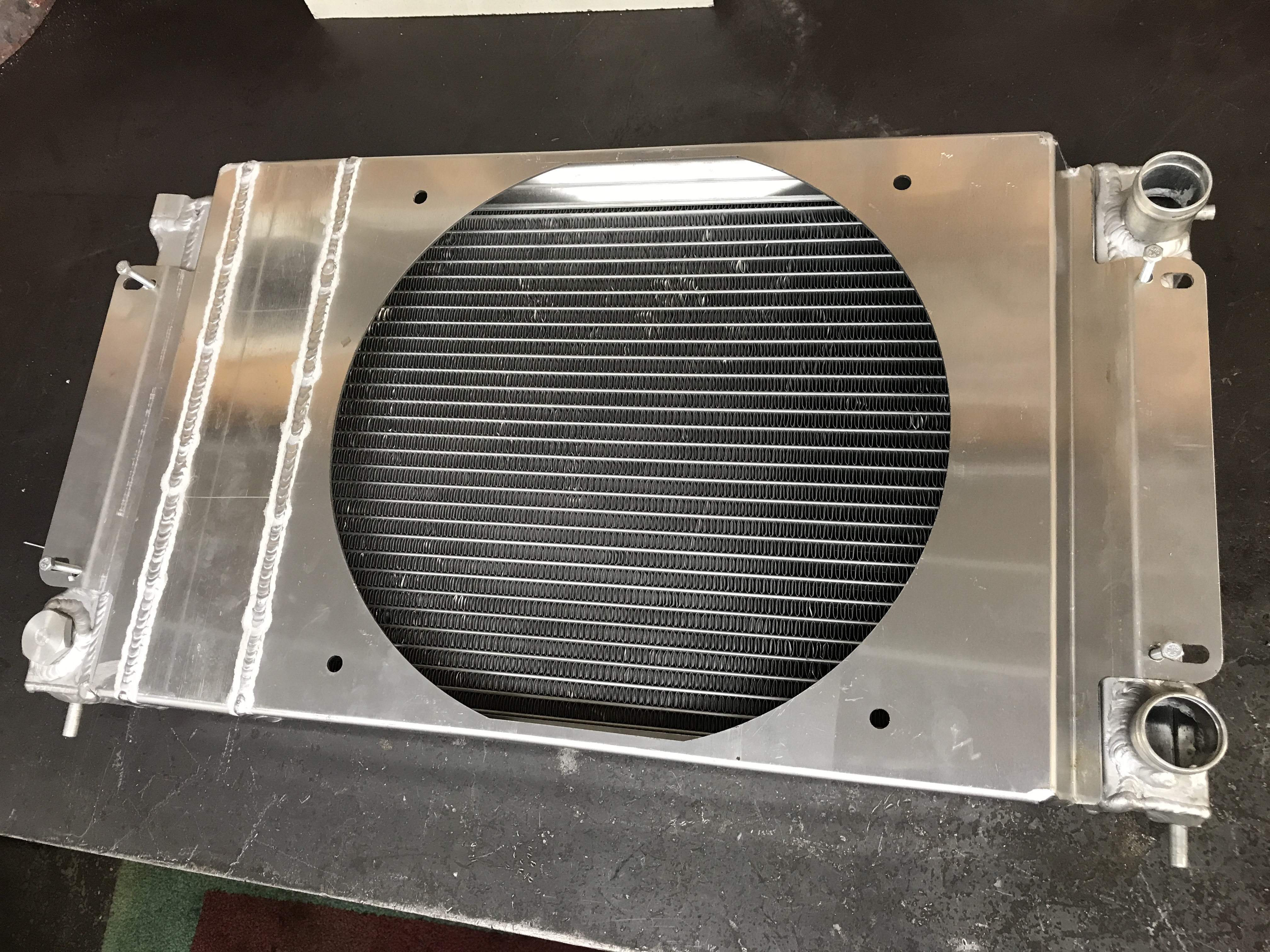

Time to fix the radiator shroud.
A little measuring, remeasuring and then again. I also had had to reshape the mounting flanges and move the mounting holes because the bosses on the radiator were shorter and in a different location.
I do have more clamps, this was all that was necessary to keep everything aligned.
Dialed in. That was some really, really satisfying torch time.
The holes still line up!
Still need to trim the mounting flanges and then back in the car.
Cheers,
Scott

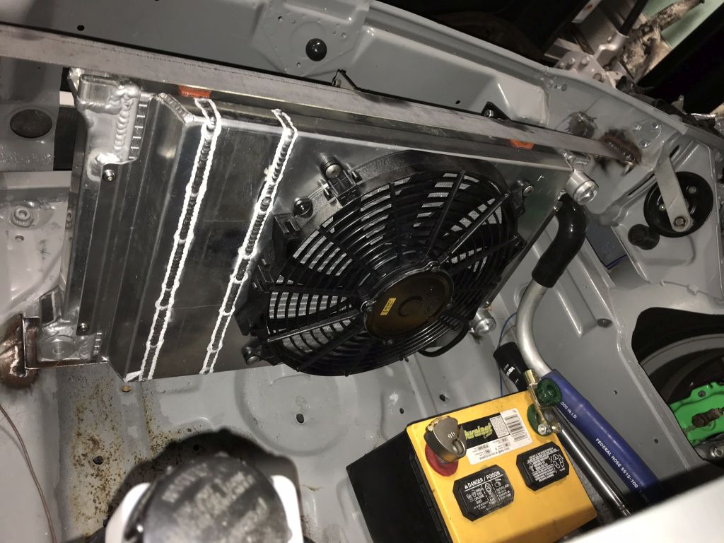

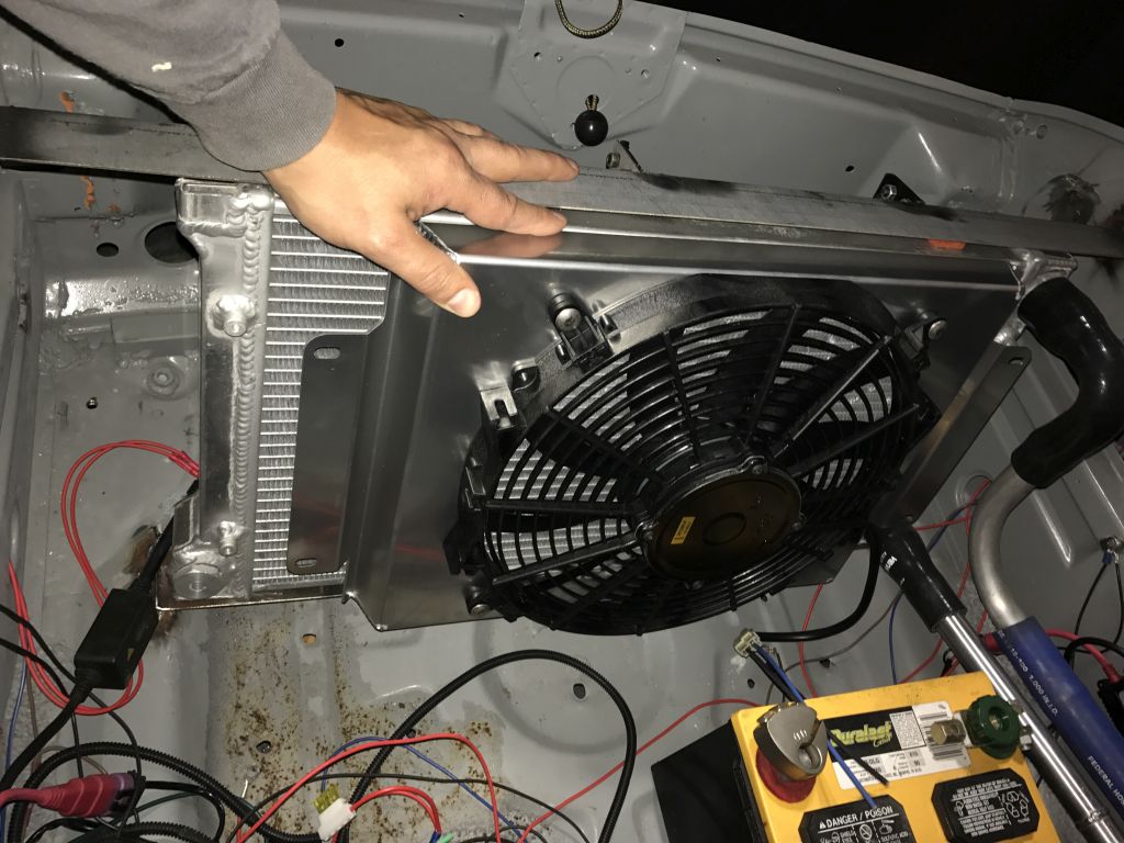

From: United States
Member No.: 16,395
Be careful , that shroud is going to murder your high speed airflow....fan is blocking airflow over about 25 , and not needed , your shroud is reducing the remaining cooling area , rendering your radiator less efficent ...
Amenson
post Oct 20 2017, 09:12 AM
Post #1016
That's opposite lock!!
Posts: 645
Joined: 27-May 05
From: Dublin, OH
Member No.: 4,154
QUOTE(ablesnead @ Oct 20 2017, 12:05 AM) *
Purpose of the shroud is to increasing radiator utilization while stationary or at low speeds by allowing the fan to draw air through the entire radiator instead of just the area covered by the fan. Certainly, at speeds higher than what the fan can create, the shroud will limit the flow to what is capable of passing through the fan.
That said, I have yet to experience a shrouded radiator that cools while stationary, not cooling at high speeds. I have experienced an un-shrouded radiator not cooling effectively while stationary, that does cool at speed.
Cheers,
Scott
post Oct 20 2017, 05:45 PM
Post #1017
Posts: 3,896
Joined: 24-July 04
From: Dayton, Ohio
Member No.: 2,388
If your up for the challenge, you could build flaps on the other side of the rad shroud. In the above picture it would be the left side, for the flaps. So when air pressure became to great they will open up, and then close once stoped or air pressure is not great enough to over come either gravity or cavity pressure in the trunk or exhaust duct area.
This presumes that the air pressure will be greater outside the rad than inside the trunk due to speed.
More than likely over kill (IMG:style_emoticons/default/screwy.gif)

Finished the modifications to the shroud by removing the extra mounting ear material.

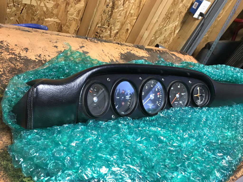

A few things came in the mail this week.
The dash looks really good. A few scuffs here and there but really nice shape.
Unfortunalty it is missing all of the bulb holders. Hopefully the ones from my old cluster fit.
We will need an electronic speedo from a 911 to work with the suby trans. speed sensor.

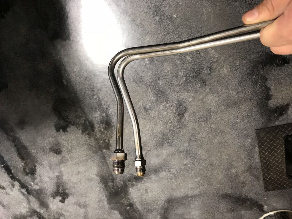

Stainless fuel lines with AN fittings arrived from CFR. He even custom bent the engine side!

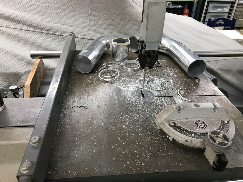

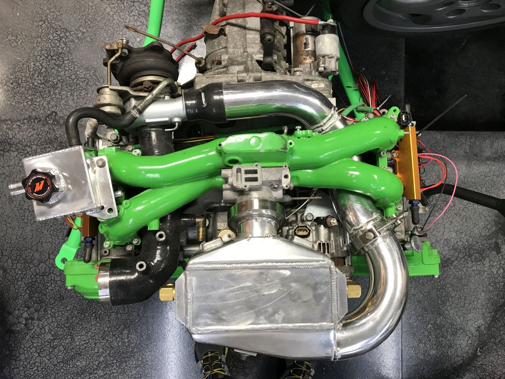

I went through the IC pluming to make sure that it was good to go and didn't like the transition to the outlet V-band flange so I got out the die grinder and ported it a bit. The carbide burr always gets clogged when cutting aluminum so in desperation I tried AL tap magic and it made a world of difference. A few drops every once in a while and the burr stays clean!!

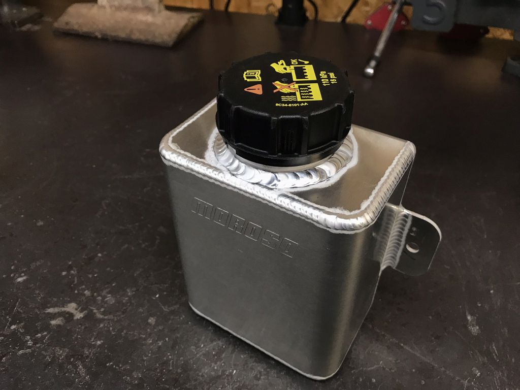

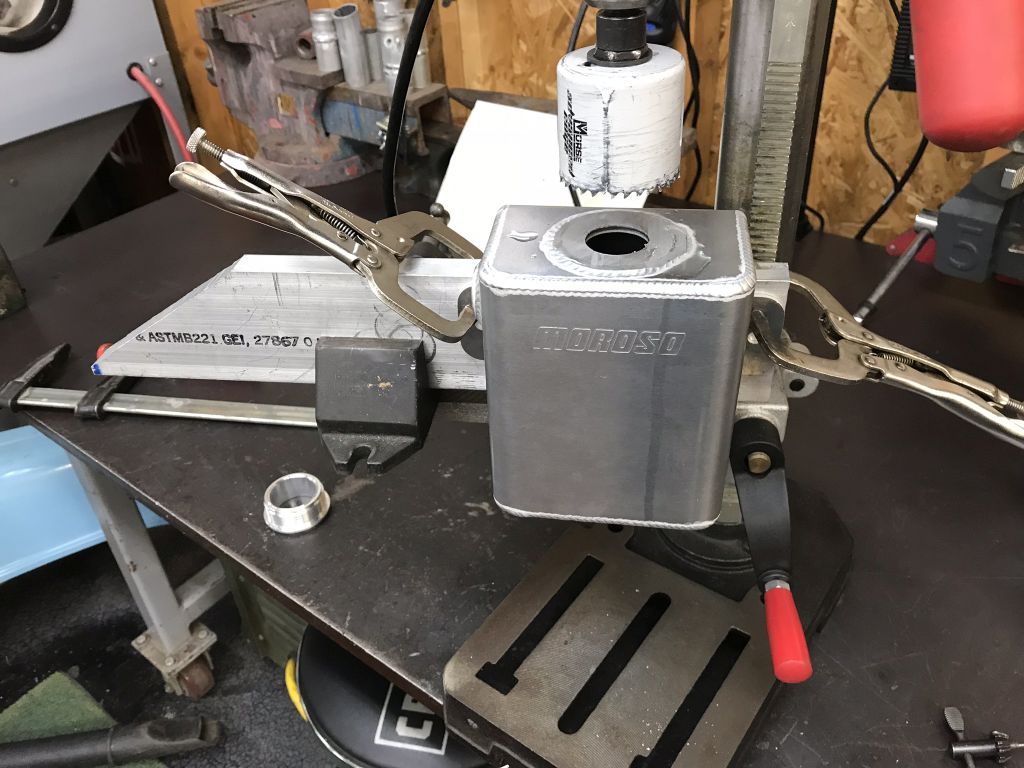

Had some time left so I modified the IC water header tank. I didn't want to run a water exchange type radiator cap so I found weld fittings for a mustang radiator cap. Sliced off the old cap on the band saw and then made a sketchy fixture to cut the hole for the new fitting.
My best AL welds to date. Really getting dialed in with the new welder. Also helped that I changed my tungsten type and got a proper tungsten grinder.
The mustang cap had a huge flange stuck out over the sides of the tank so I cut it off. Much better.
