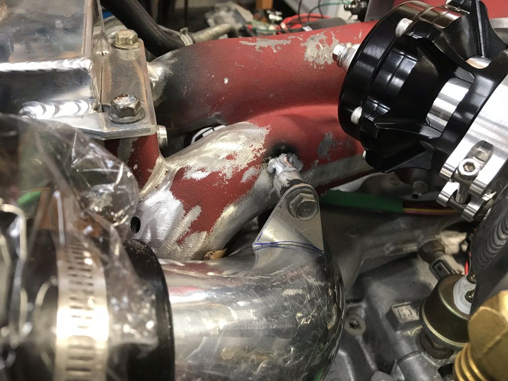

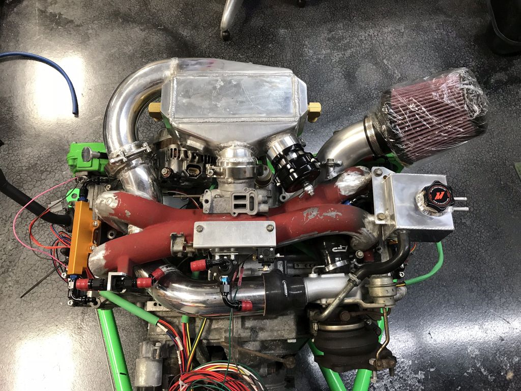

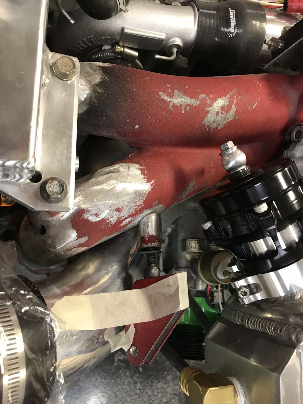

Few "minor" tasks checked off the list.

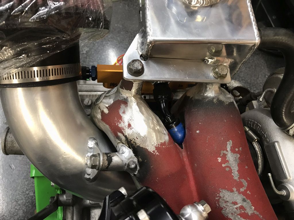

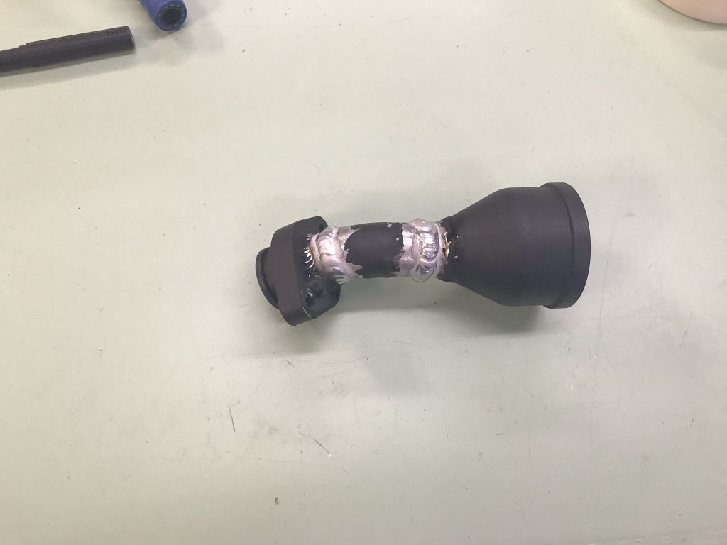

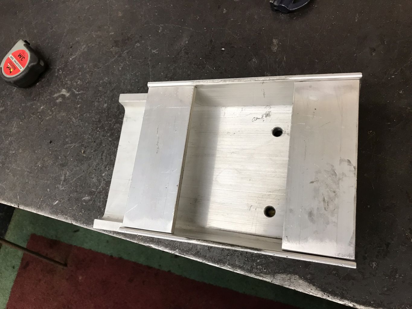

Step one of mounting the air intake...add a threaded lug.
Step 2, make a tab paying careful attention to leave 1 thickness of cardboard around the tube.
Weld, no touching except the tab and turbo coupler!!
Oh, ya...along the way I added a connection for the crank air oil separator.

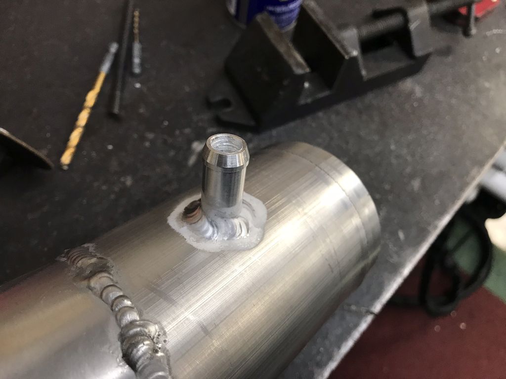

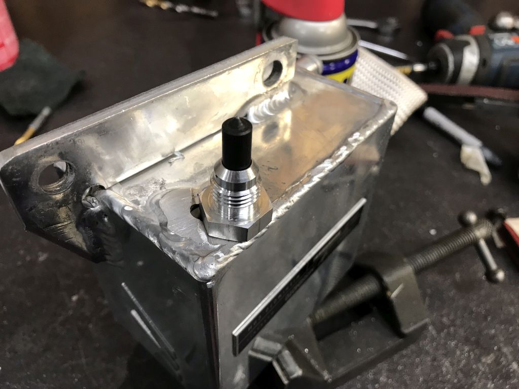

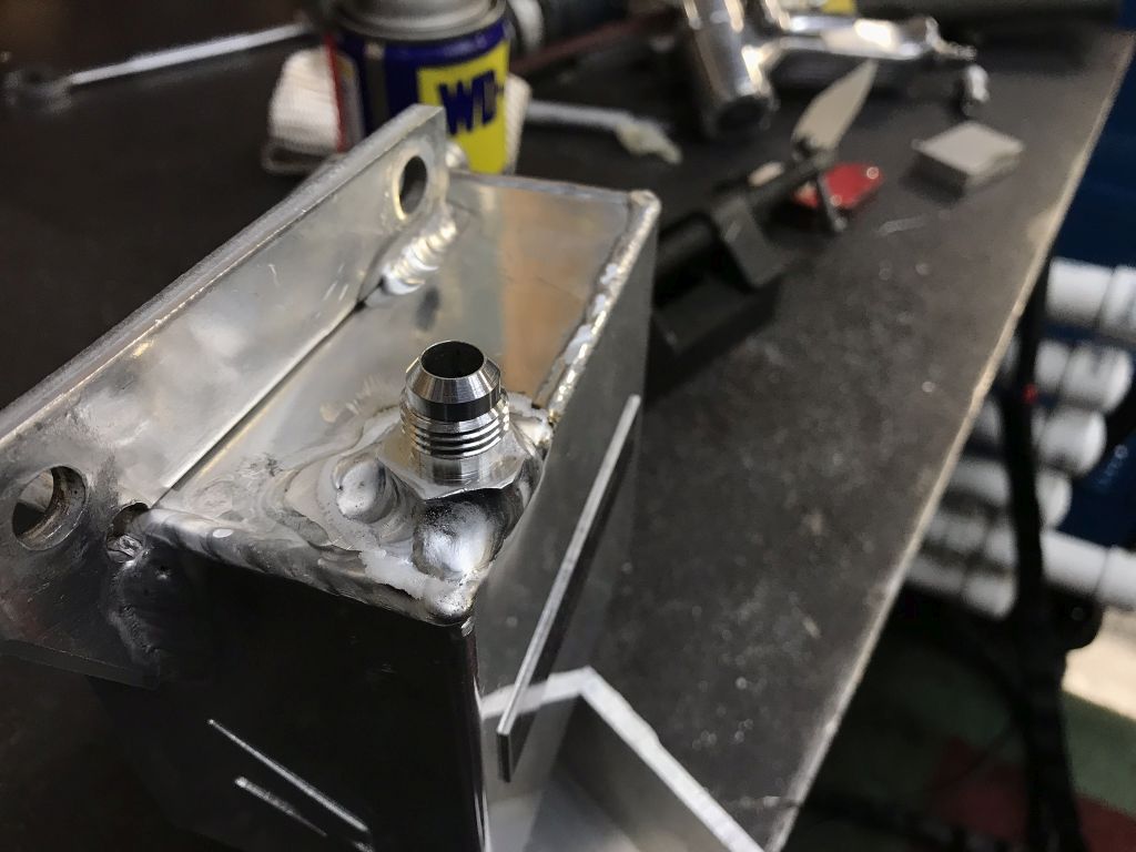

The position of the lower bung on the coolant tank was not in the best place so I moved it (re-purposed on the air intake). AN all the things!
Welded.
Much better.
Almost done with the engine fab, just need to at the IAT threaded bung just in front of the throttle body.

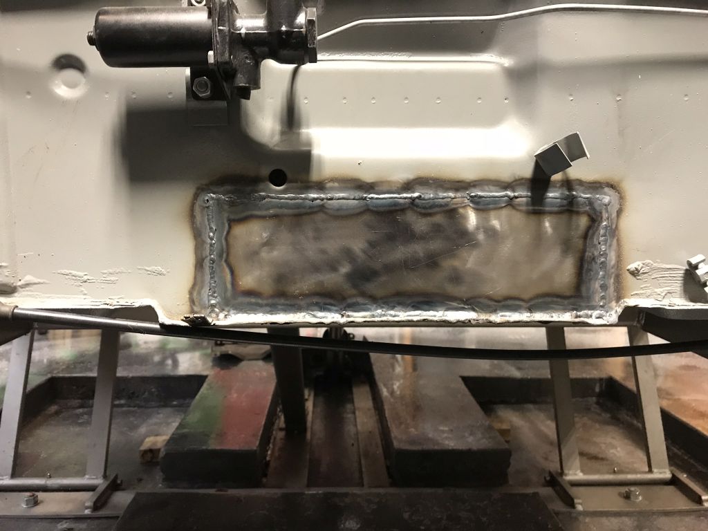

I had anxiety every time I looked at the mess of holes in the firewall, so I got rid of them.
Ugly.
Now I can sleep at night. I can't wait to put fresh holes in the proper place.

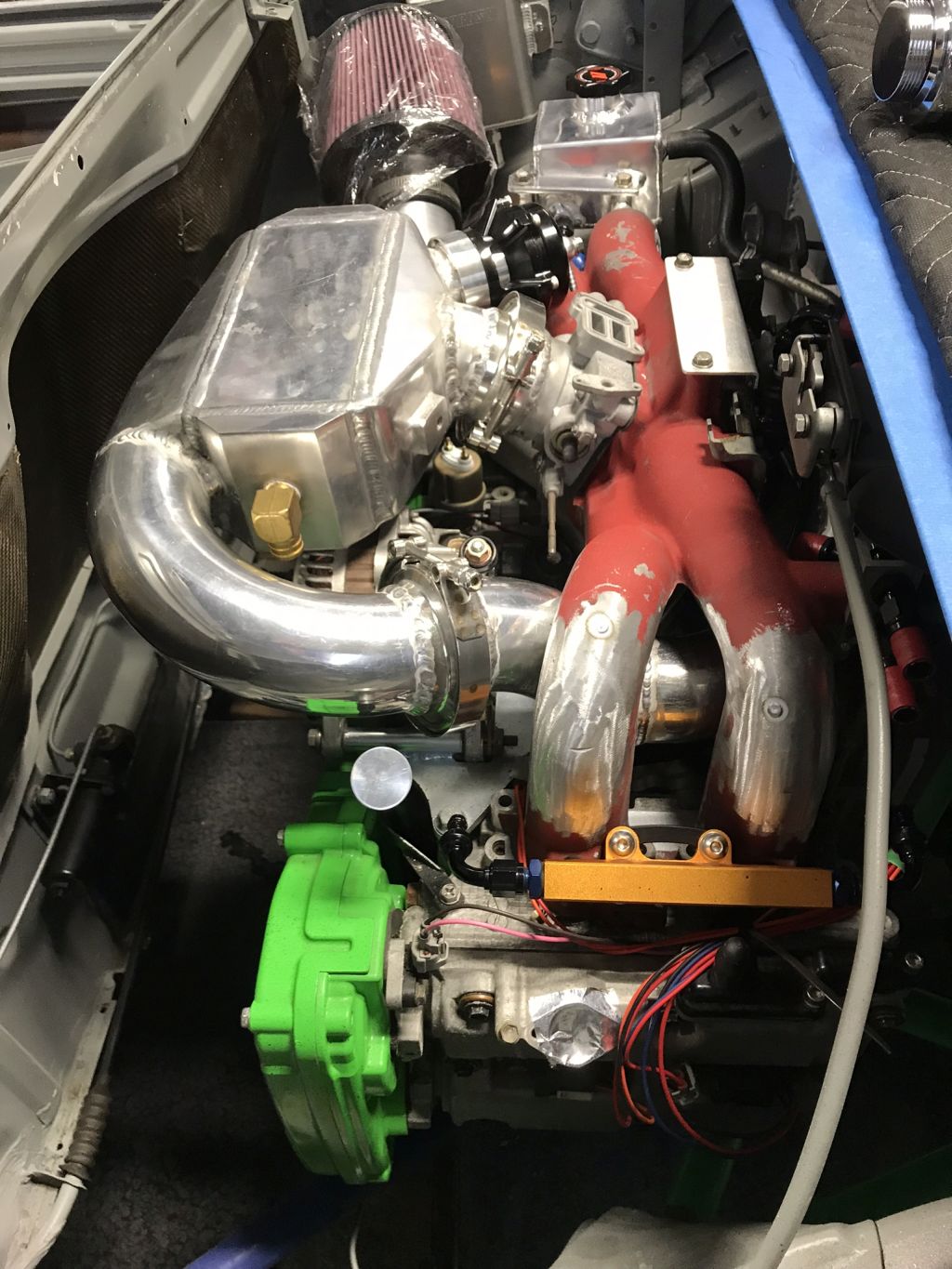

Yesterday was the last day in the office until after the new year so I thought that I would start the long vacation with some inspiration by test fitting the drive-train.
Fits great! Only had to remove the air filter and oil filler neck. The oil filler neck will be modified to avoid this...and because it is ugly in the stock position.
Time to pull it back out.

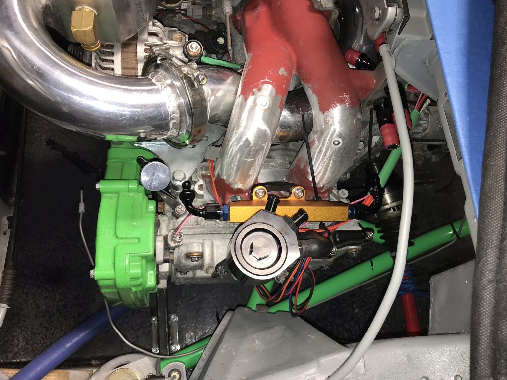

I decided to leave the engine in for a few days so that I can work out a few routing/mounting details.

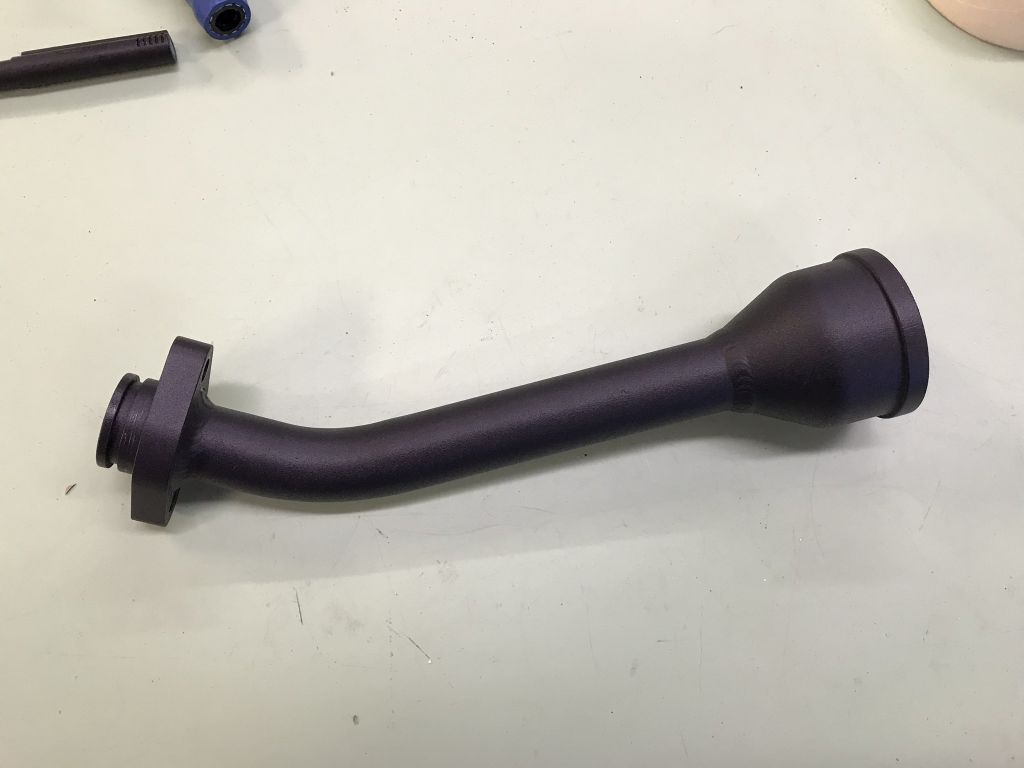

First up was the oil filler/AOS cap.
Gangly thing isn't it.
Looks about right.
Right where it needs to be. Took quite a bit of tweaking so that I can discretely run the octopus of OAS hoses. I set up the driver side vent to use a hose section from a stock vent hose from my bin of parts.

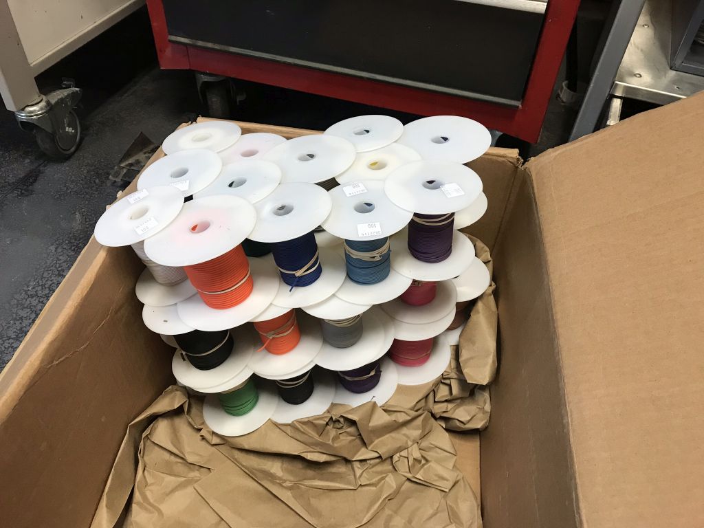

Wire was on sale so I bought some...and by some I mean 100ft of every color in 3 different sizes (TXL/GXL for the nerds) (IMG:style_emoticons/default/rolleyes.gif)
That should cover any additions/corrections that I need to do.

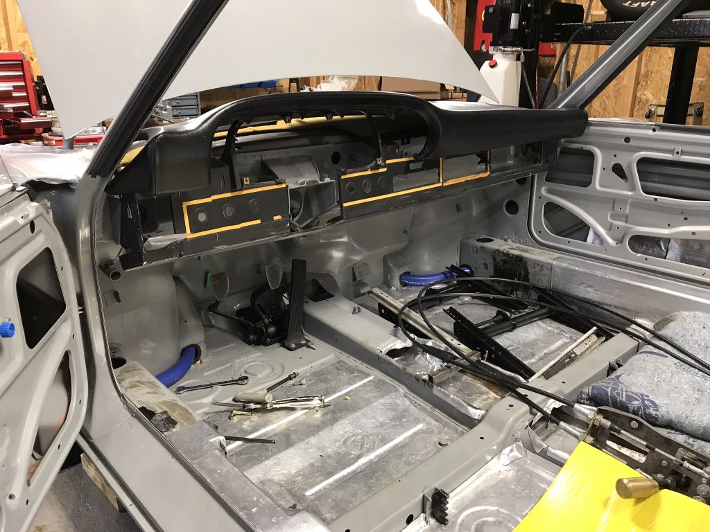

With the stock dash going back in, using stock switches, relays, fuses box for basic function with a dedicated fuse/relay box for the drivetrain makes a lot of sense. Unfortunately we do not have a stock harness for the car. Anyone part out a car want to sell a harness. Does not have to be 100% perfect (90% would be nice) just looking for a solid base to work back to a mostly stock harness.
mgp4591
post Jan 5 2018, 02:48 AM
Post #1058
Posts: 5,805
Joined: 1-August 12
From: Salt Lake City Ut
Member No.: 14,748
QUOTE(Amenson @ Jan 4 2018, 05:58 PM) *
I've got a complete harness from my 71 1.7 less the wires I snipped for the fog lights and the heater motor. Pulled it all through the grommets and all including the fuse box. I really have no idea what it's worth but you're welcome to it and I could send it out Saturday...

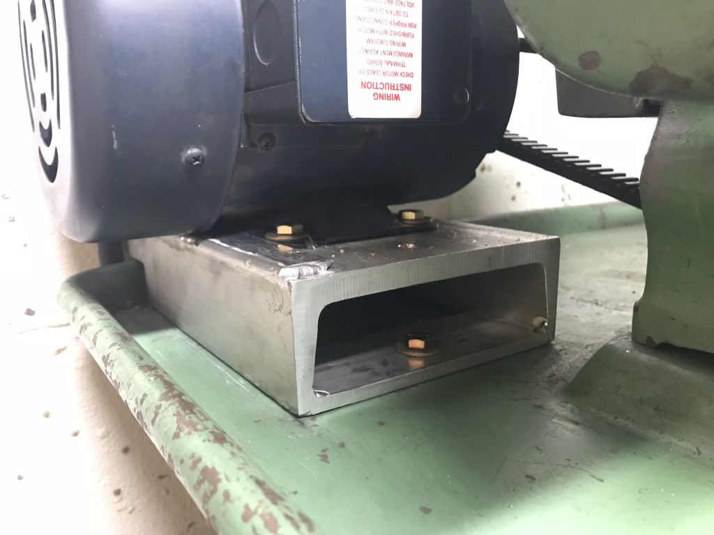

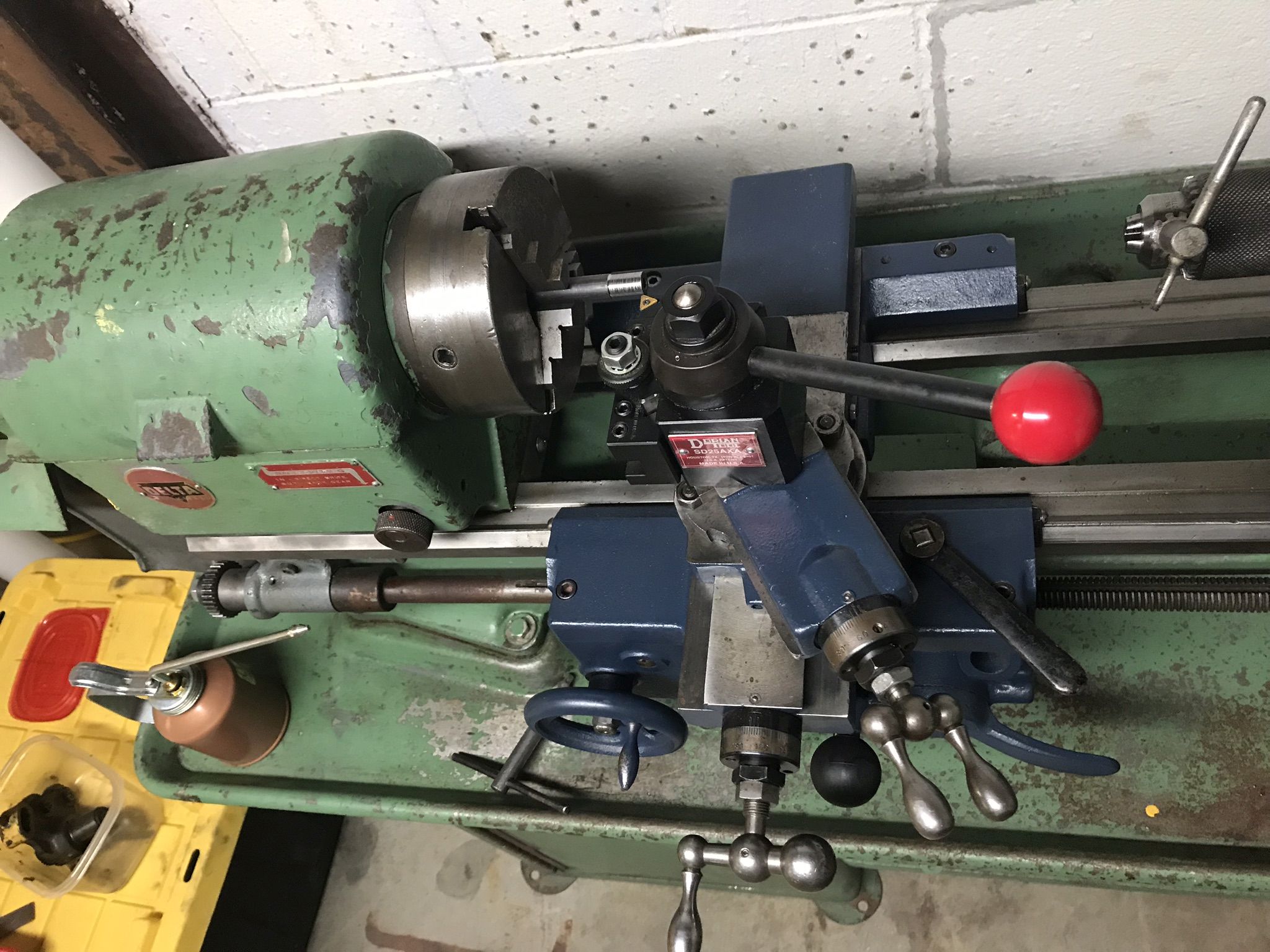

New tool day!

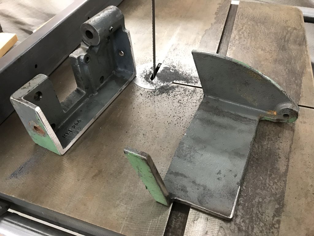

Well, not exactly. It has spent more time on "jack stand" than most 914's (IMG:style_emoticons/default/blink.gif) I picked it up from a neighbor and tore it completely down and then converted the CVT speed adjustment to 3 phase VFD control.
It was 20 deg in the garage and even if I turned on the heater the tools would be freezen so I finished the lathe in the nice warm basement. Still getting it set up but it is making chips and the first part is in the chuck...replacement for the missing steering shaft lug.

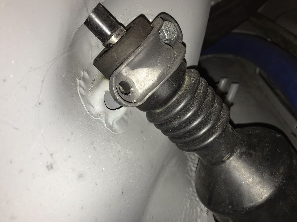

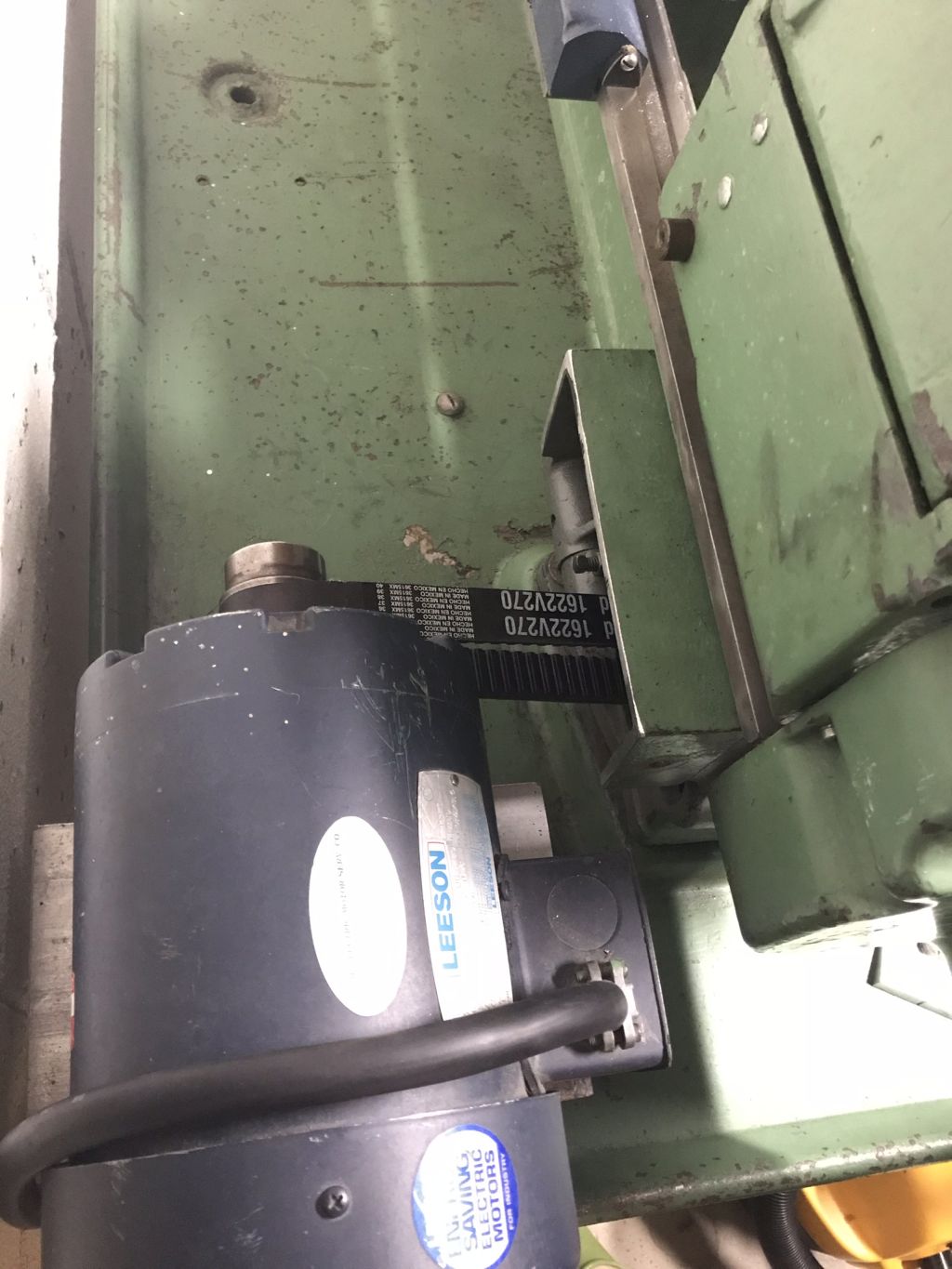

Had a very unproductive weekend in the garage. I intended to get the steering shaft clamp fixed but when I went to finish the new part, the belt on the lathe started slipping. I had a replacement drive belt on hand but still slipped. Apparently my custom mount did not allow the motor to move enough to tighten the belt properly.
Fix.
Got it working again and then ruined the carbide insert for my cutting tool (IMG:style_emoticons/default/headbang.gif)

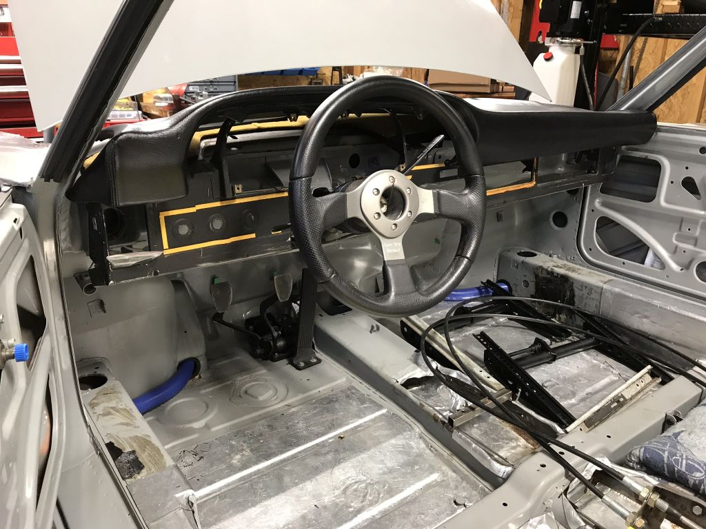

I needed to accomplish something so I continued the stockification.
Pulled the custom wiring harness and steering column.
Installed the replacement steering column.
Stock harness should be here this week.
