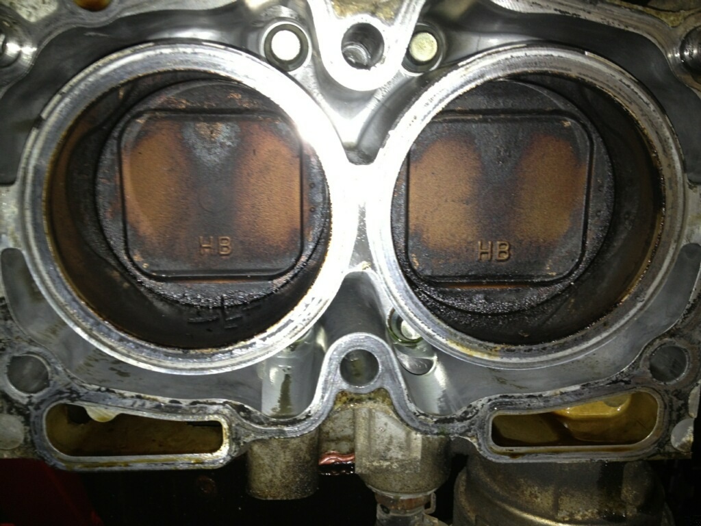

So...we've got the motor torn apart and starting to get it back in shape.

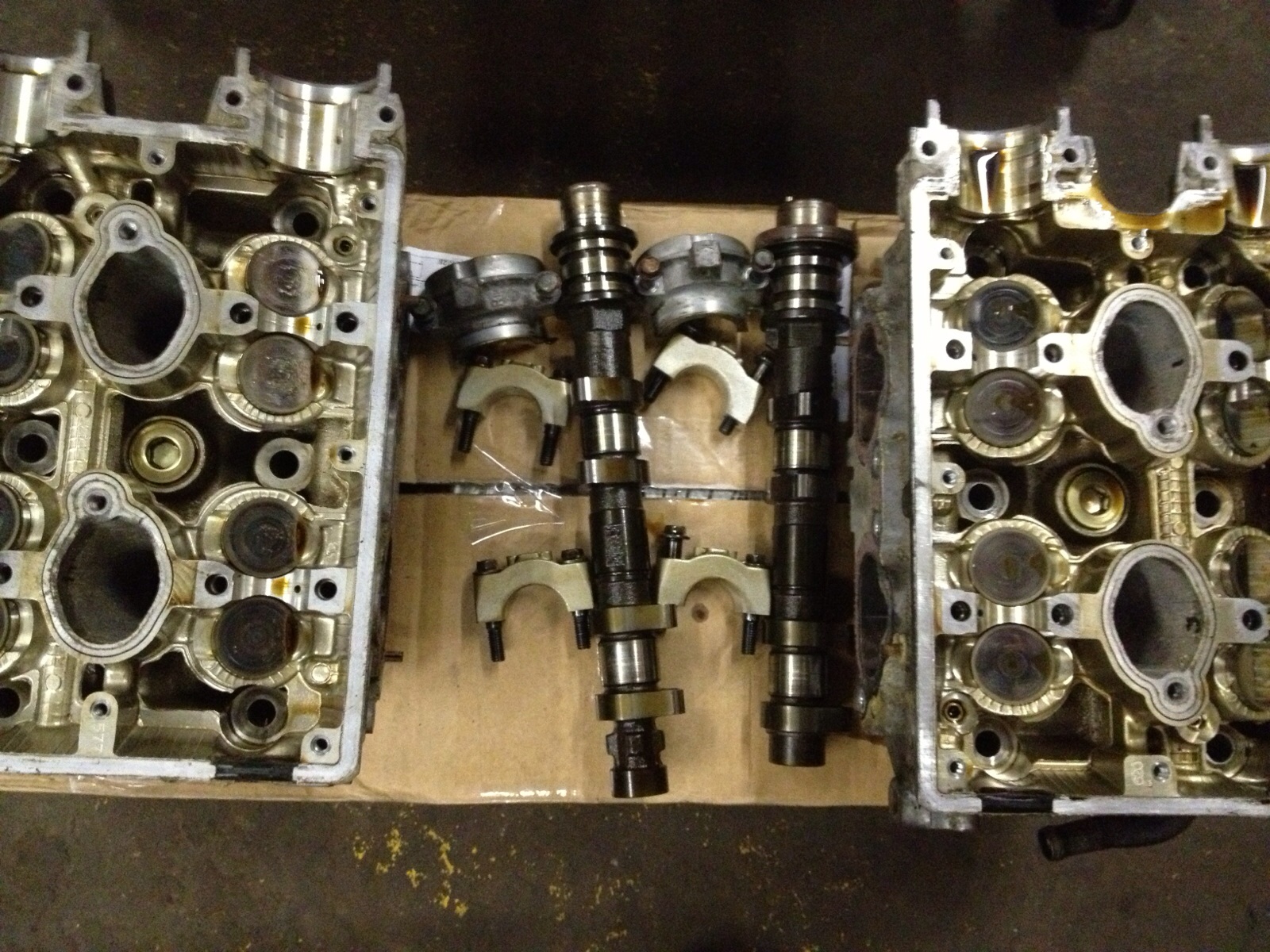

Heads looked great. They're off being cleaned and bead blasted. New guides and seals is a they need.
The pistons look a little crusty, and there's a little gauging by the skirts. Perfect opportunity to have it boated out .5mm and replace the pistons. I'm going to leave the rods alone. They're just fine. I'm not sure a set of forged rods are going to do a lot for me.

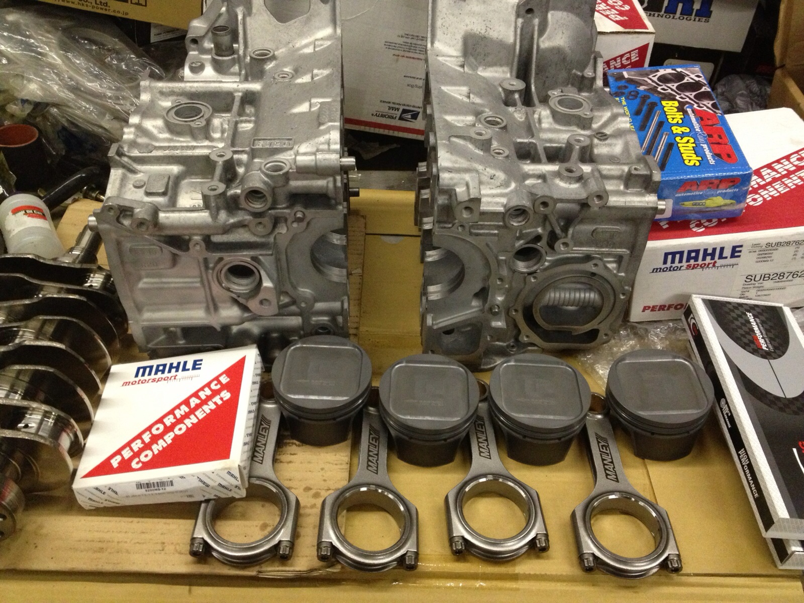

Turns out I needed new bearings too. So...we're just going to do it all. Why not. I'm going to have a "built" motor, and the end result (according to my builder) should be north of 380fpt at the wheels. I got a set of PPG 1-3rd gear and a cryo'd Trans center shaft for a song, so I'll be able to push north of 600hp if I so desire down the road.
This is a never ending hole at this point, but I'm quickly running out of things to replace, and he's going to start building it all back up next week, and I'll have the whole motor/Trans completed in about 3 weeks.

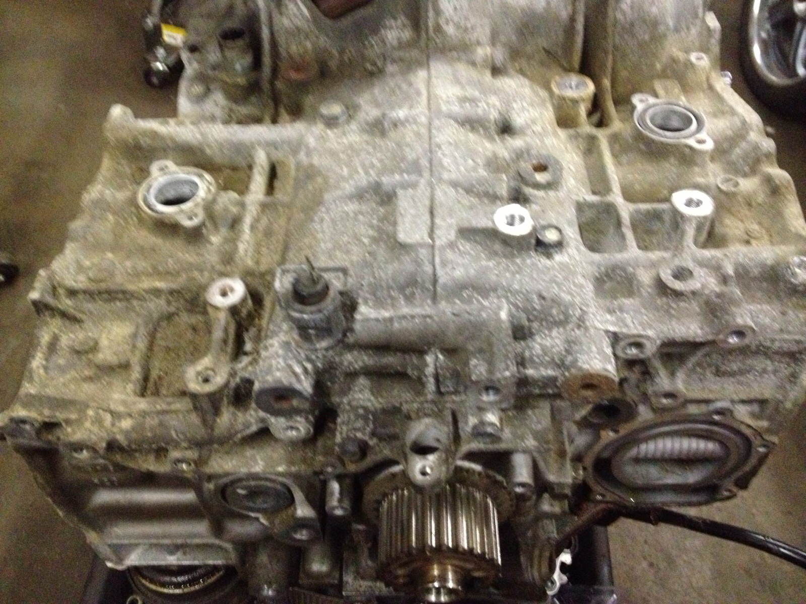

Got the block back from the machine shop...and all the purdy new parts layed out. Time to start putting the motor back together!

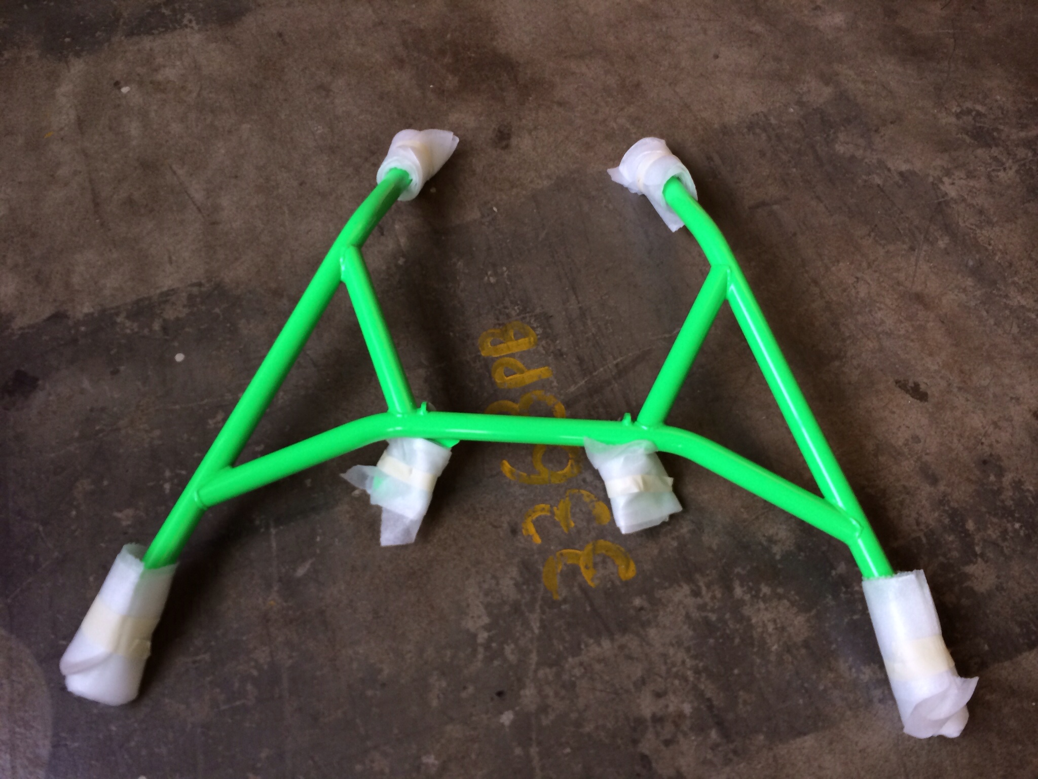

Got the equal-length headers ceramic coated, and had the awesome engine/Trans mount from Ian at ColdWater914.com powder coated to match the Boxster brake calipers. I'm also going to have them do a few more pieces for me in green and polish the aluminum on the air intake. This is starting to come together quickly. I should have the engine built in the next week or so.

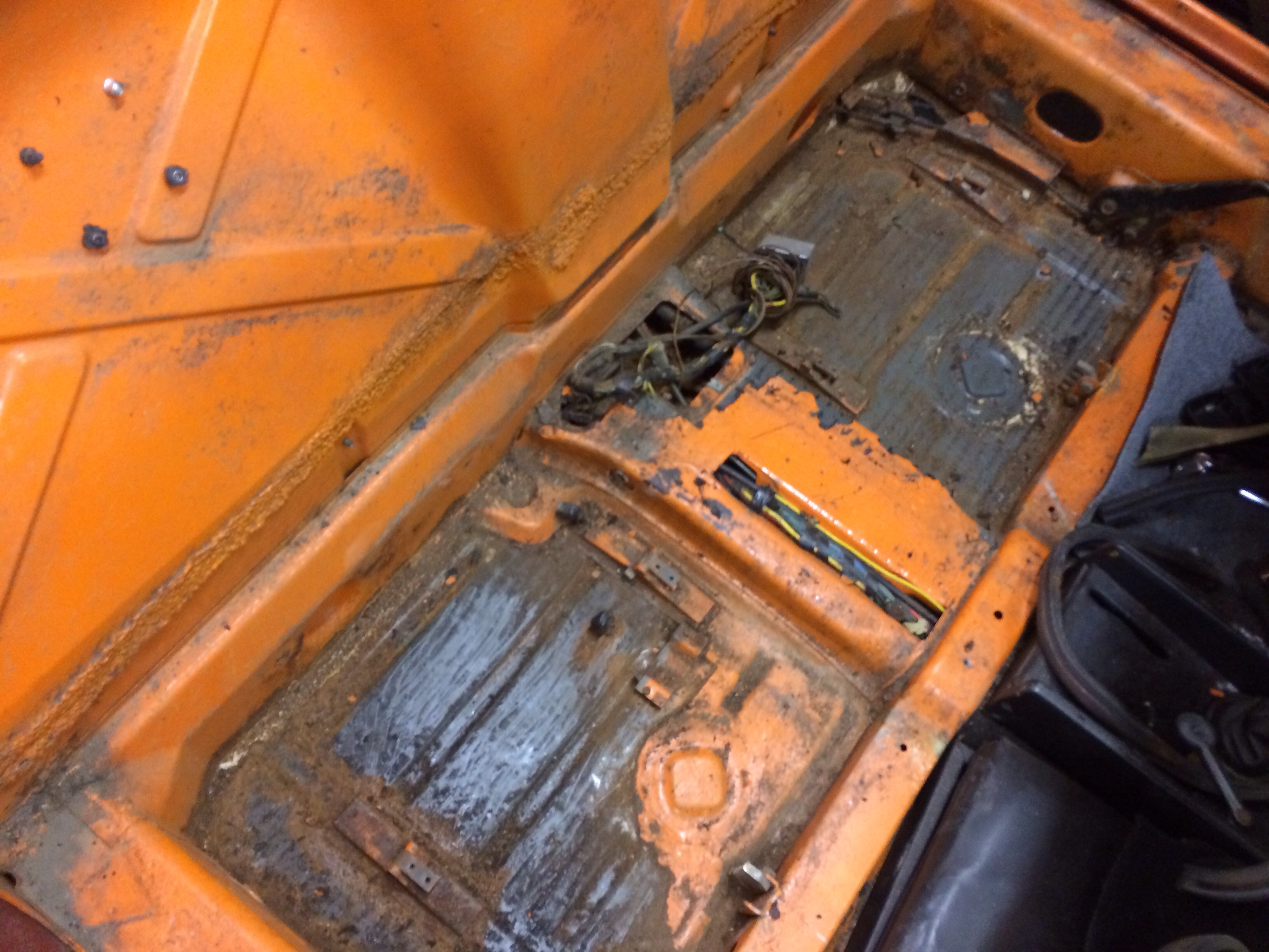

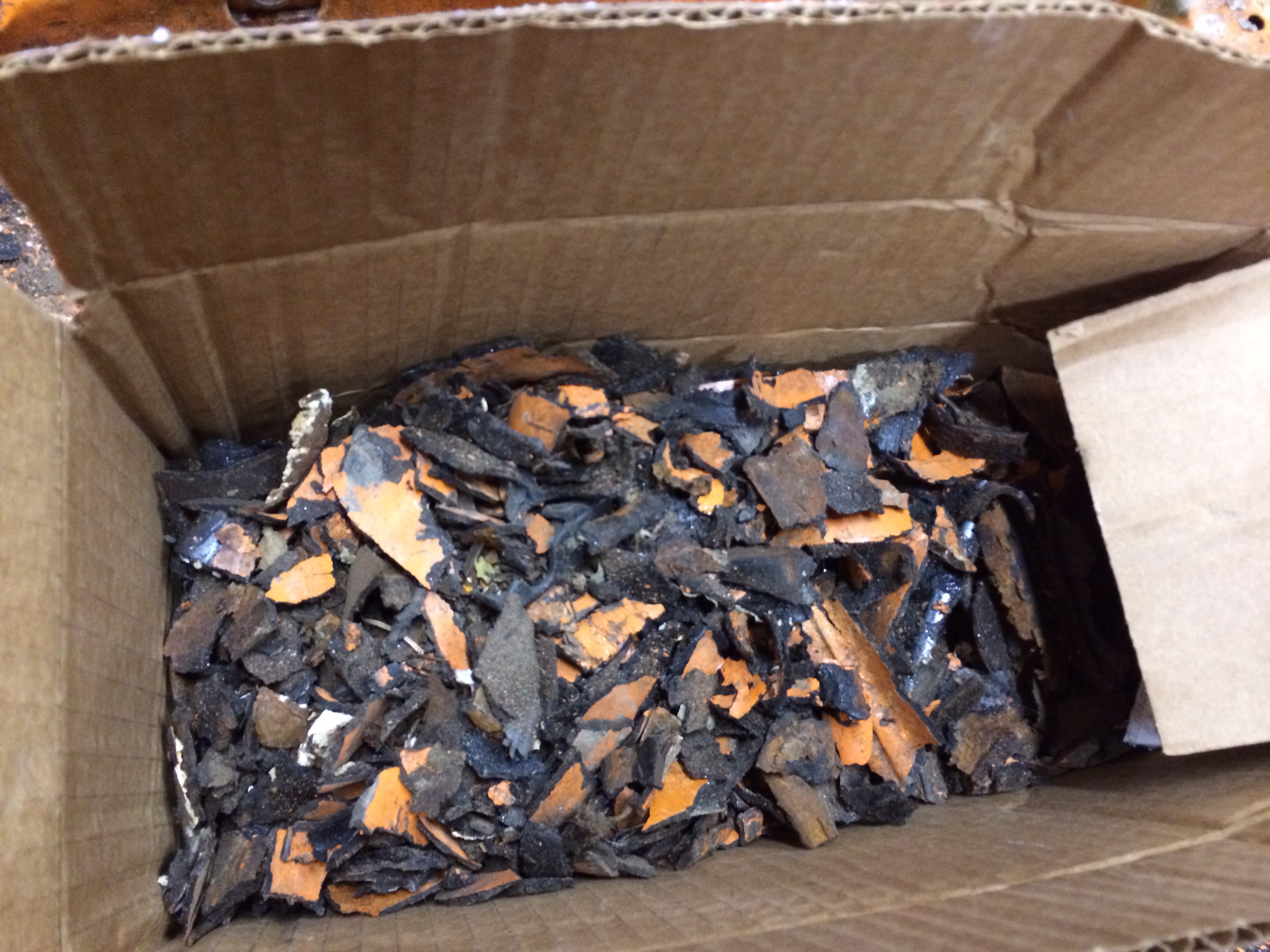

Got to work in the garage yesterday. After the seats came out, I started poking around under the tar. There a bit of rust, but nothing that's perforated and at this point, it's not worth replacing the entire floor.
So...I started scraping. Heat-Gun + Paint scraper = blisters & cheap therapy.

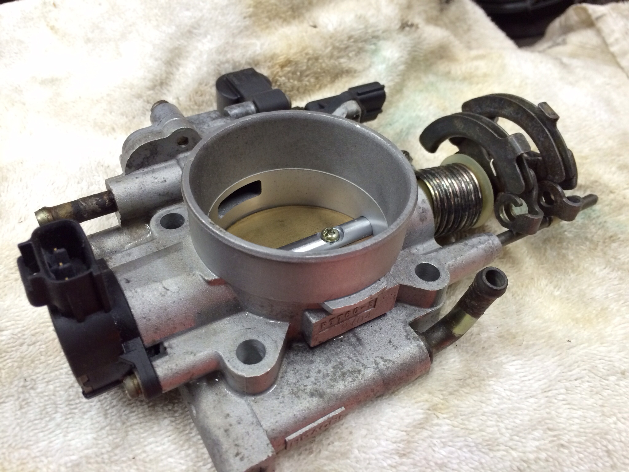

I'm going to finish up after work today and scrub it all out to see what I'm working with.
Also soda-blasted the throttle-body. Cleaned up real nice.

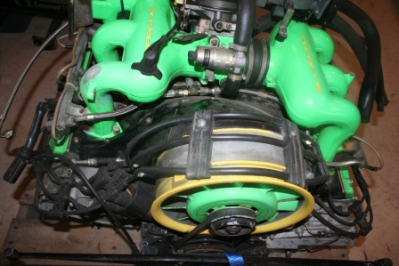

Funny, it took me a while to get rid of the green.

Damn. That's hot...and pretty much exactly what my Subie engine will look like when it's done.

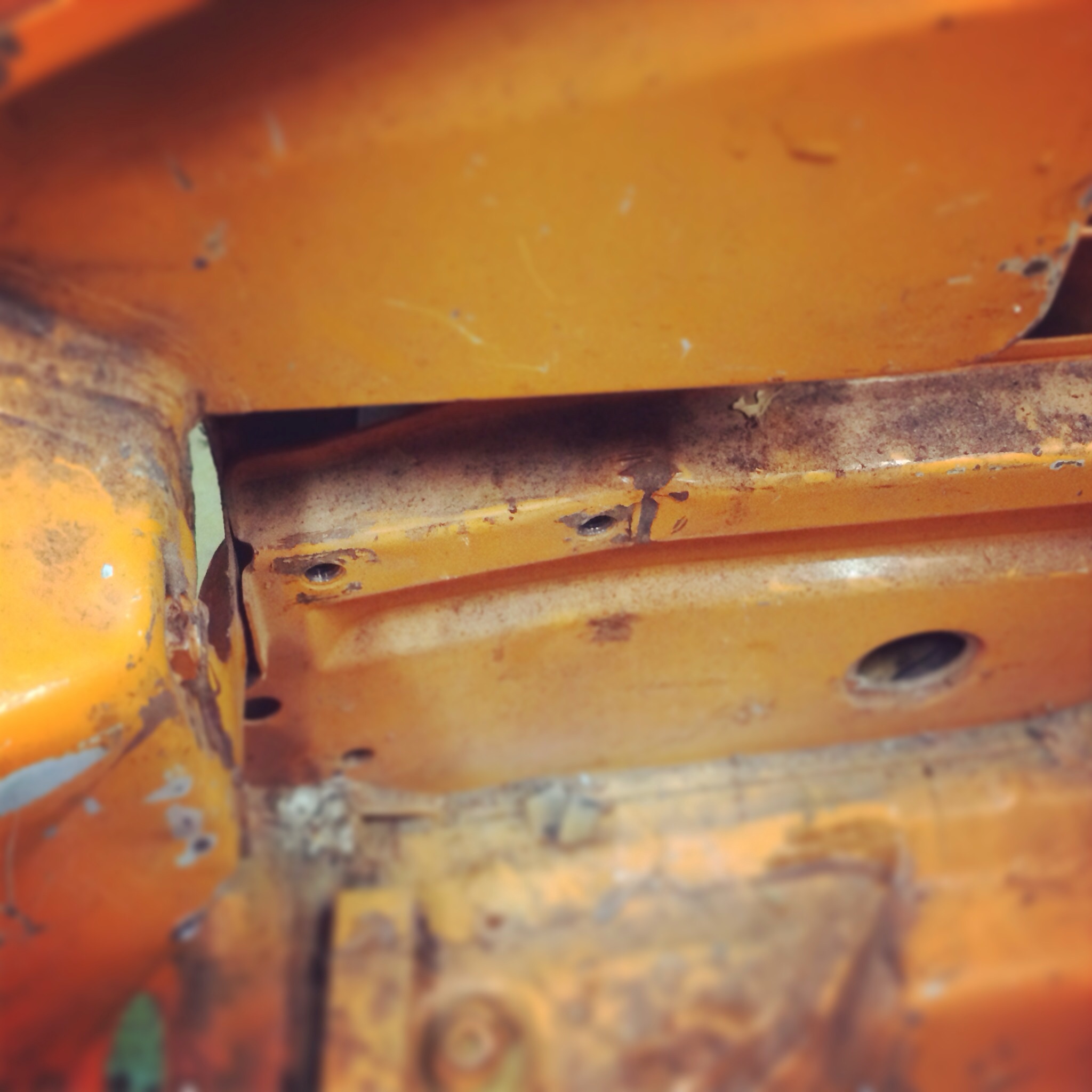

Got the whole front end torn out today. I have a fairly funny group of "DAPO" pics. This is the one that pisses me off though. No way I could have known until the radiator and '75 bumper brackets were removed.
Looks like it got hit on the pass-front enough to knock it in about 1/2". Not sure how I'm going to fix this, but I'll tackle it after I get everything else yanked. Any suggestions on how to push this back out? BAH?

Did it get wacked to fit the radiator in? It almost looks like you could use a puller and straighten that out.
