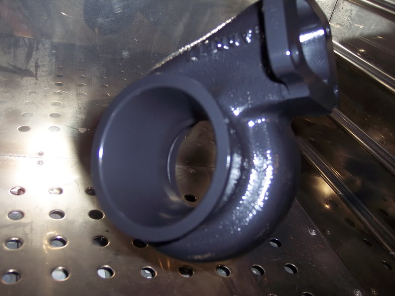

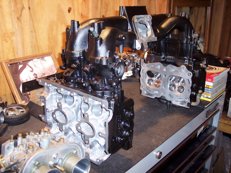

I used to do all the coatings for crucial,cobb crawford and many other subaru companies I surprised to see and uncoated crucial down pipe..Let me know if you need any help with the heads or turbo
(IMG:http://www.914world.com/bbs2/uploads_offsite/img.photobucket.com-9738-1387172542.1.jpg)(IMG:http://www.914world.com/bbs2/uploads_offsite/img.photobucket.com-9738-1387172542.2.jpg)
I've got a great Subie guy doing the heads now. Just picked up a rebuilt VF39 turbo, so that'll cover me there. I don't think I'm going to bother with power-coating the snail. It'll be pretty hidden anyway. The downpipe is going to be shortened a LOT so I'm going to wait until I have it all welded up with the muffler flange before I have it ceramic coated.

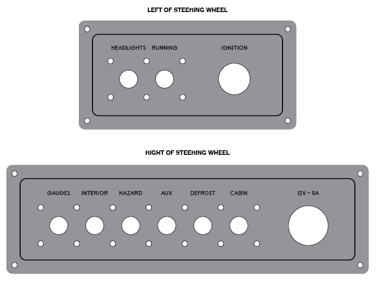

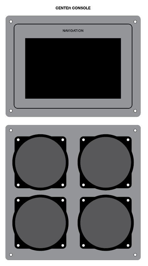

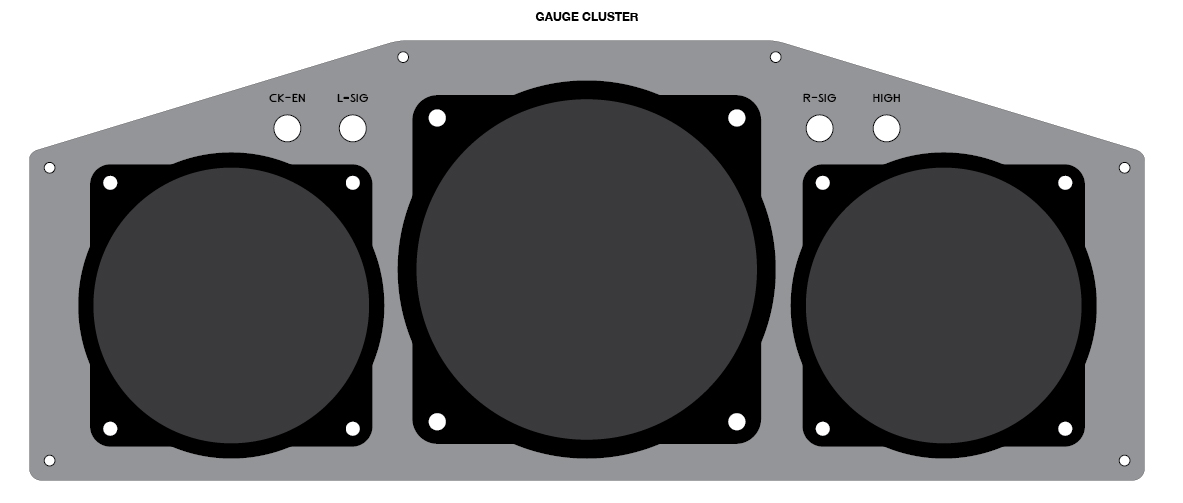

This is more of what McMark would call "digital progress" but it needs done at some point. (IMG:style_emoticons/default/biggrin.gif)
These are the plates I'm fabricating for the dash and gauges. 1/8" aluminum that'll be anodized to match the Momo steering wheel. The backing material will be a perforated black vinyl, and these will bolt over that. I'm removing the heater controls, and hopefully having two discrete fans that will either be on rheostats or 2-stage switches for Defrost and Cabin.
C-Loop guards between the switches, and the toggles have green LEDs at the tip when "On". I'm also thinking about re-locating the key to left of the wheel. Still up in the air on that one though.
Nav is a TomTom unit that I have gutted out to have it mounted in the center console with an external antenna.
I'm going to end up with a 100% custom dash to accommodate the gauge cluster. Guess I'll fab that up soon too.

West marine makes some really nice switch plates.

I know...but for what I was looking for, custom is the way to go. Most of the parts have come in already, and I'm VERY excited to see what they look like when everything is together. I'm already starting to spec out the build for the dash. I've added a few plates too, and should have a very cool setup after all is said and done. I'm going to space the controls out a little more so I can fit the 1-2 knobs I'll need into the plates. The gauges should arrive on the 26th or 27th, so I'll be able to drop them into the test plates I'm cutting and get a good feel for what the rest will look like.

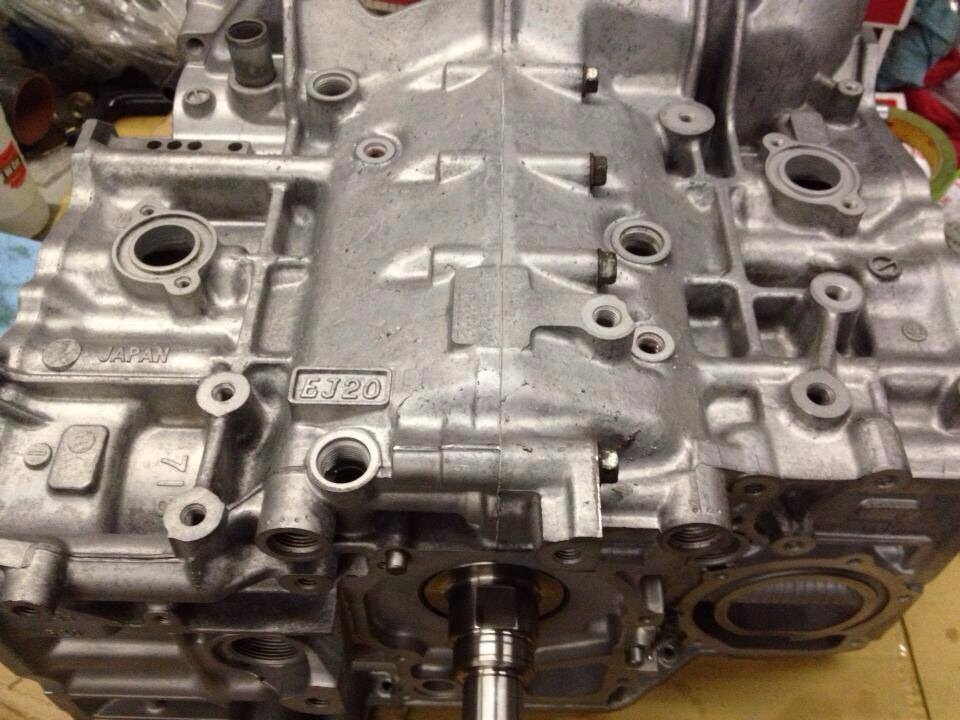

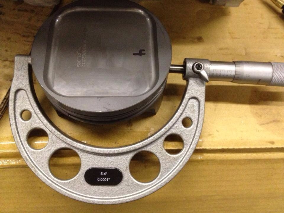

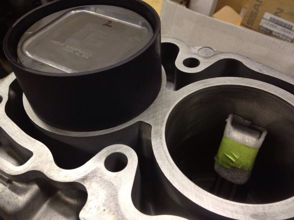

Makin' a motor.
CptTripps
post Dec 21 2013, 12:17 PM
Post #211
:: Punch and Pie ::
Posts: 3,585
Joined: 26-December 04
Member No.: 3,342

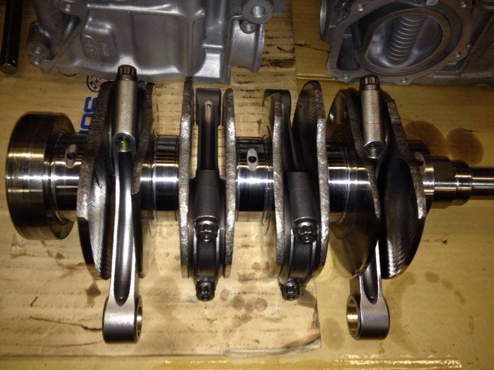

Wiseco forged pistons
Manley forged rods
ARP studs
King XPG bearings
...lots of good stuff.

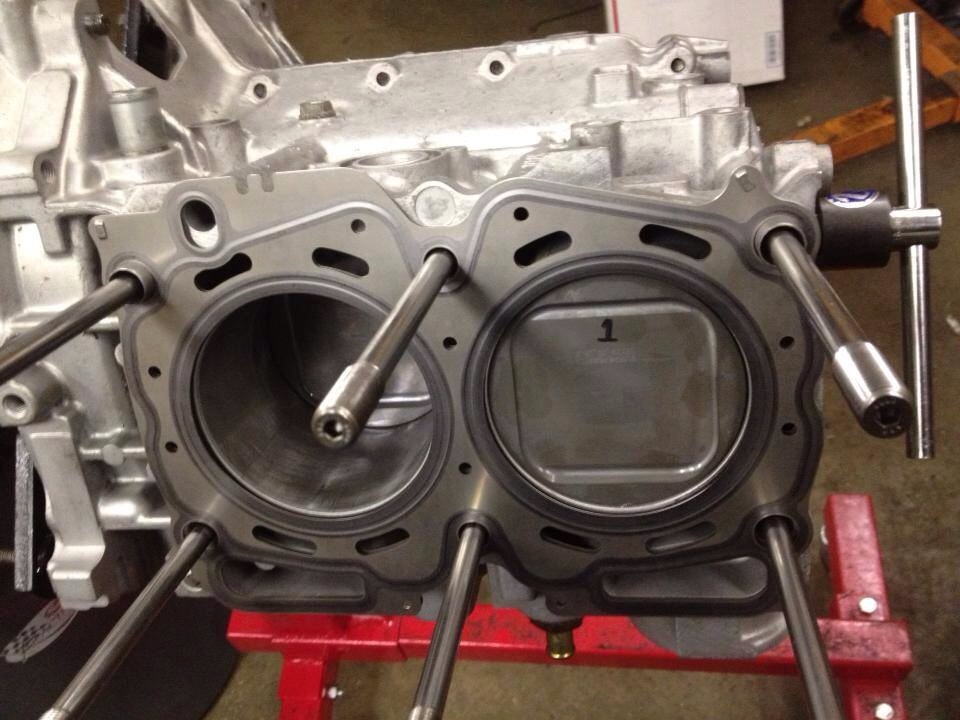

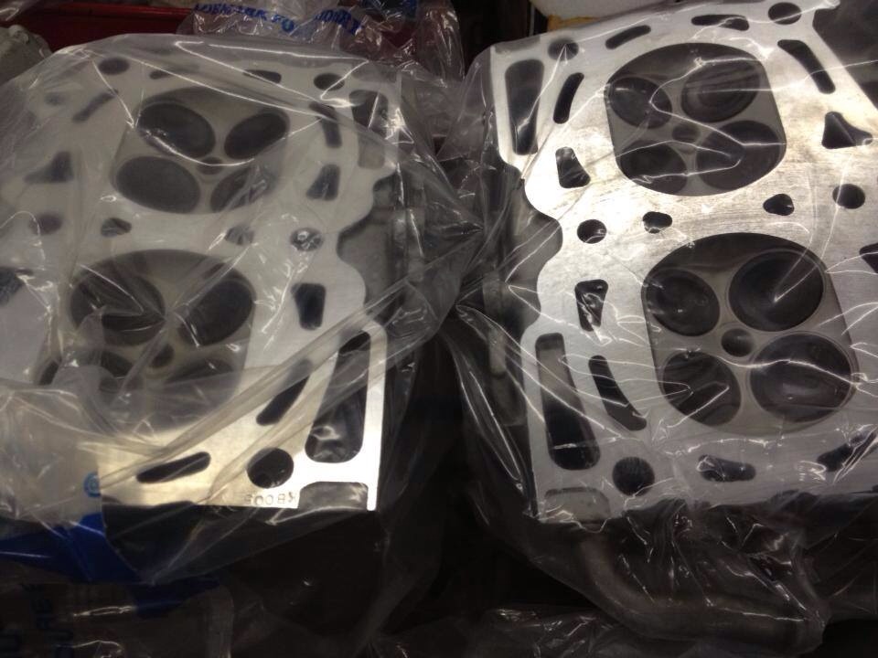

And here are the heads. Freshly rebuilt/honed/floated.

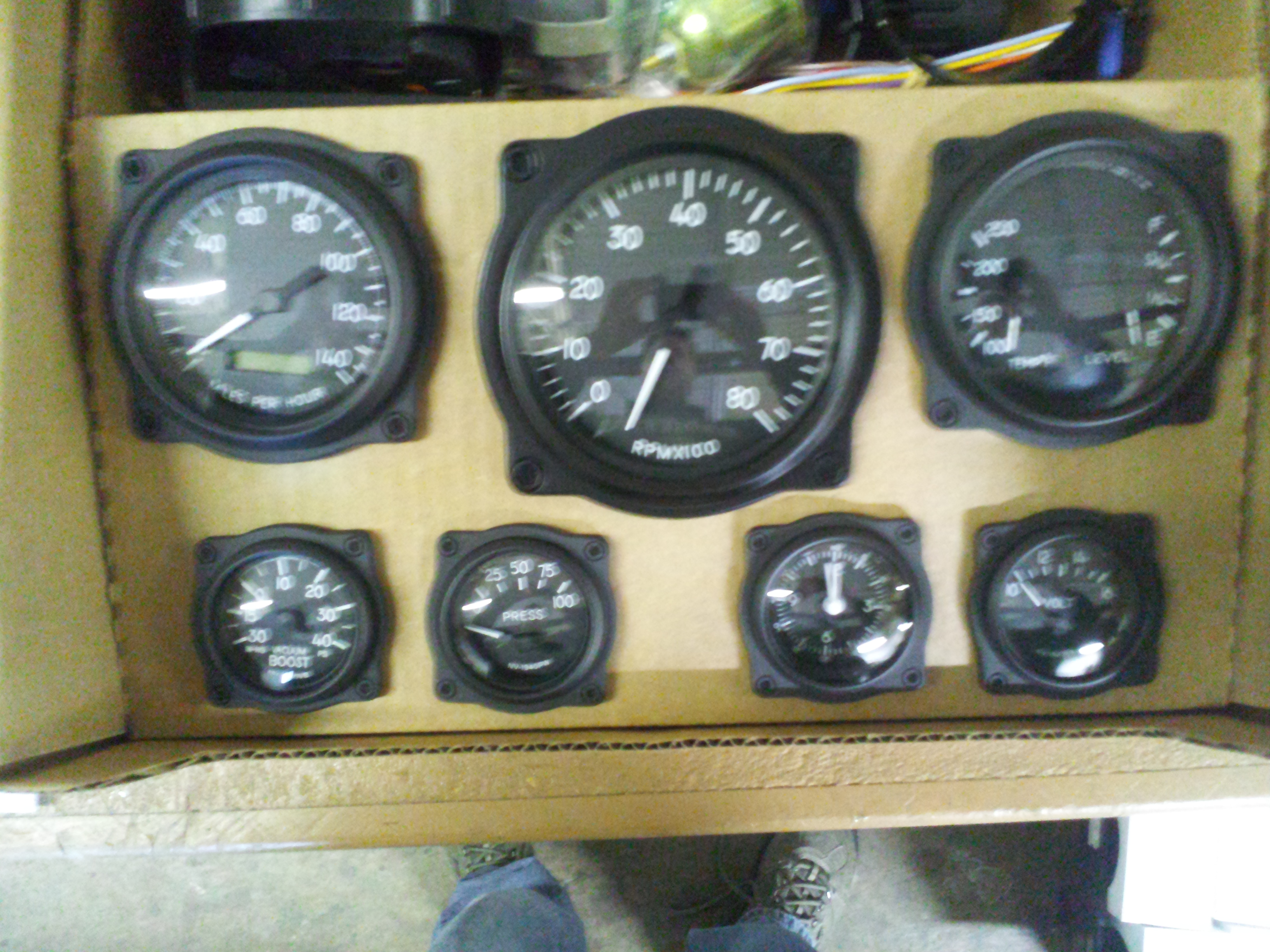

post Dec 29 2013, 08:13 PM
Post #214
:: Punch and Pie ::
Posts: 3,585
Member No.: 3,342
Gauges from New Vintage are all done. (Looks like he borrowed Andy's camera.)
Engine is almost ready to come home and meet up with the transmission!

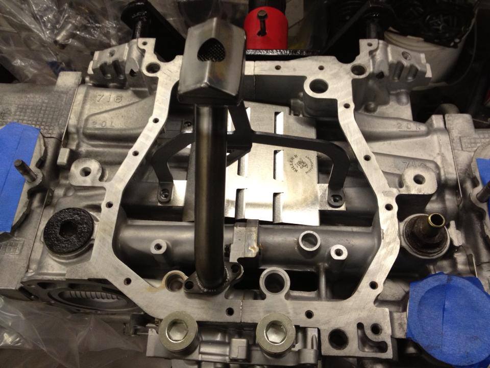

Killer-B oil pickup and a new STi Oil Pan. (so I can use equal length headers)

CptTripps
post Dec 30 2013, 04:43 PM
Post #218
:: Punch and Pie ::
Posts: 3,585
Member No.: 3,342
Well, I'll have them tomorrow or Thursday. I'll take pics immediately and let you all know. I had him do a custom Green LED light inside all of them, so it should look pretty good.

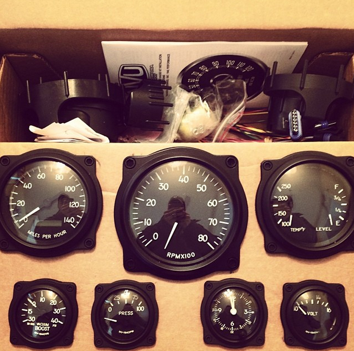

:: Punch and Pie ::
Posts: 3,585
Member No.: 3,342
Got the gauges today. Lots of other goodies too, but I needed to be in the garage working...not looking at all the boxes.
So here's a quick shot of them. They look SPECTACULAR in person. This is going to be a great build!
effutuo101
post Jan 5 2014, 12:24 AM
Post #220
Posts: 2,737
Joined: 10-April 05
From: Lemon Grove
Member No.: 3,914
Oh! Those are sweet! (IMG:style_emoticons/default/wub.gif)
