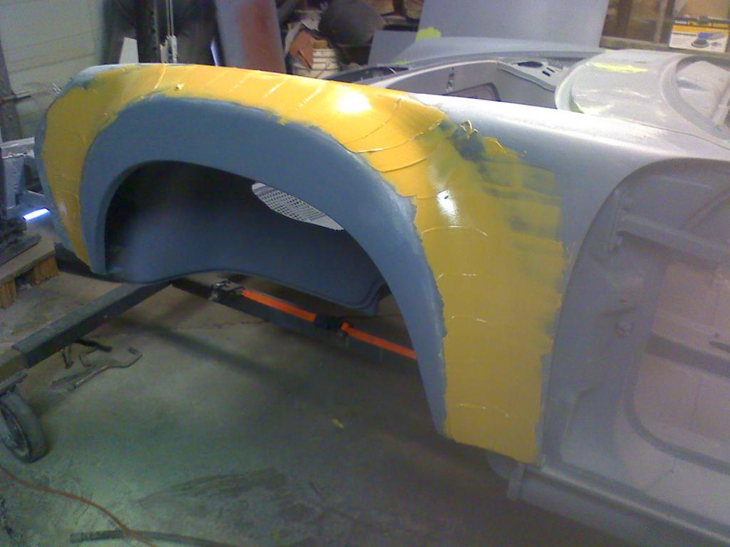

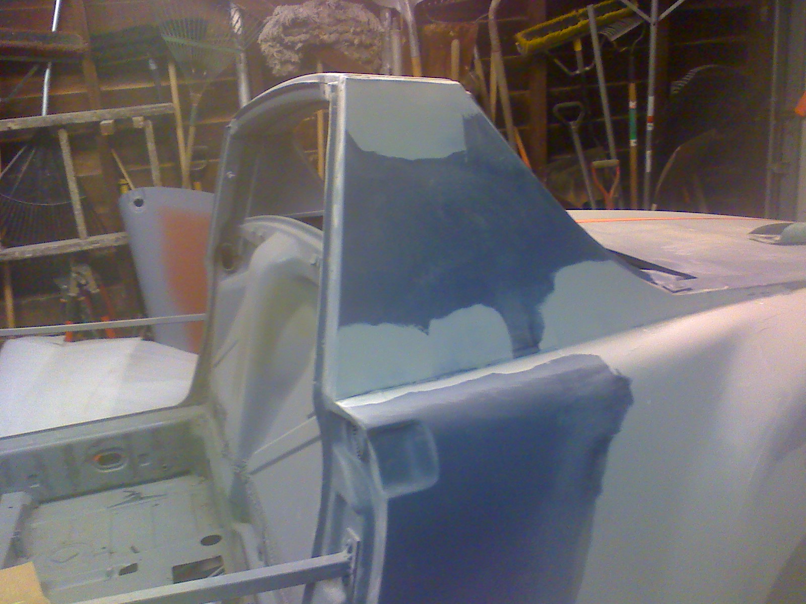

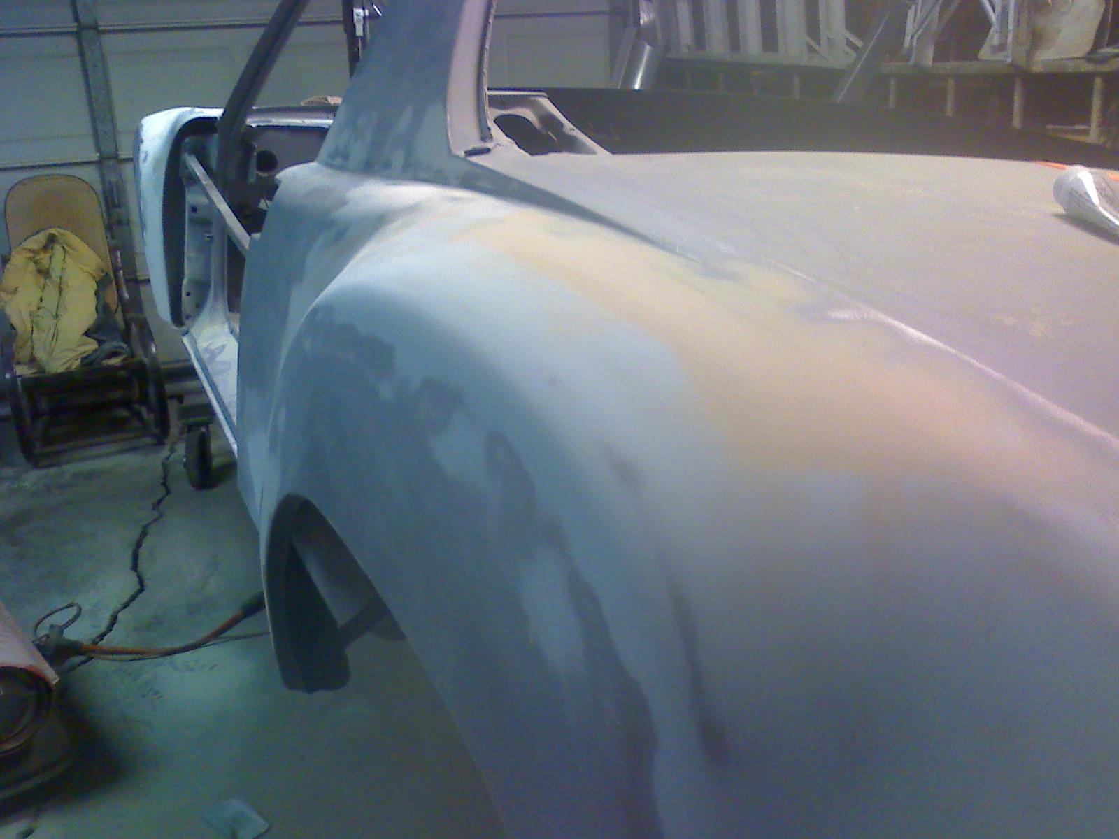

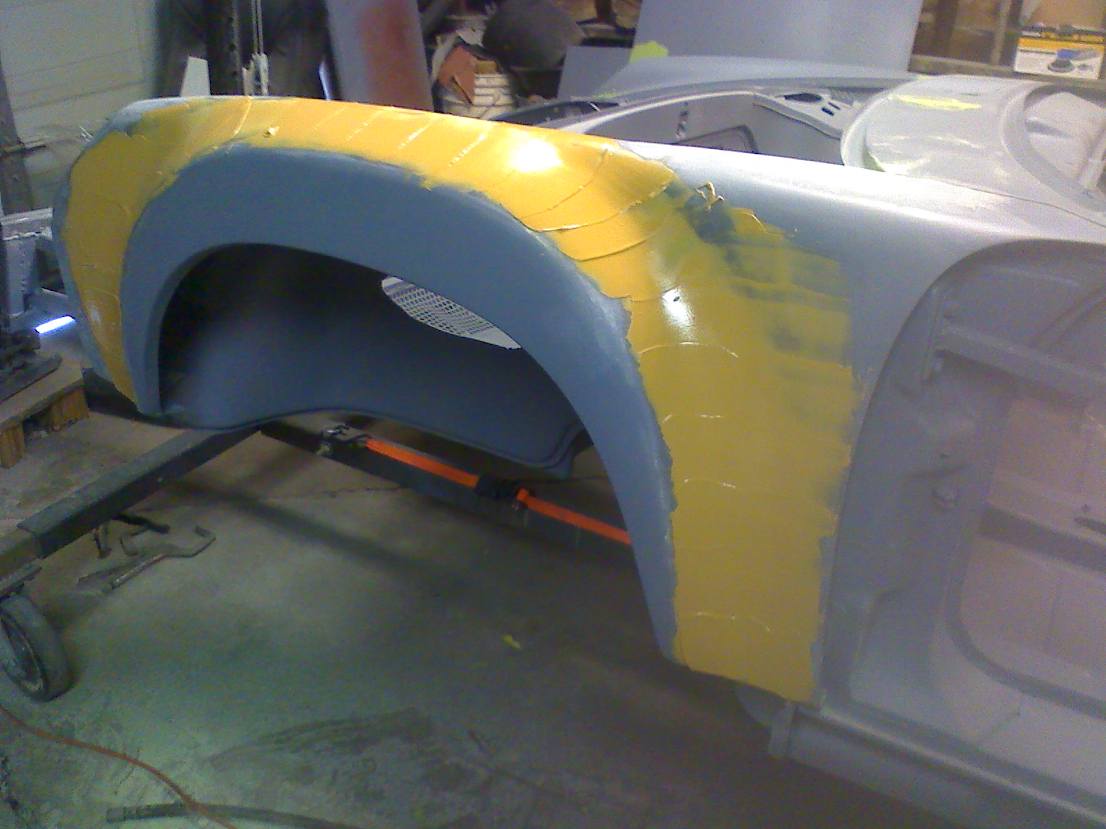

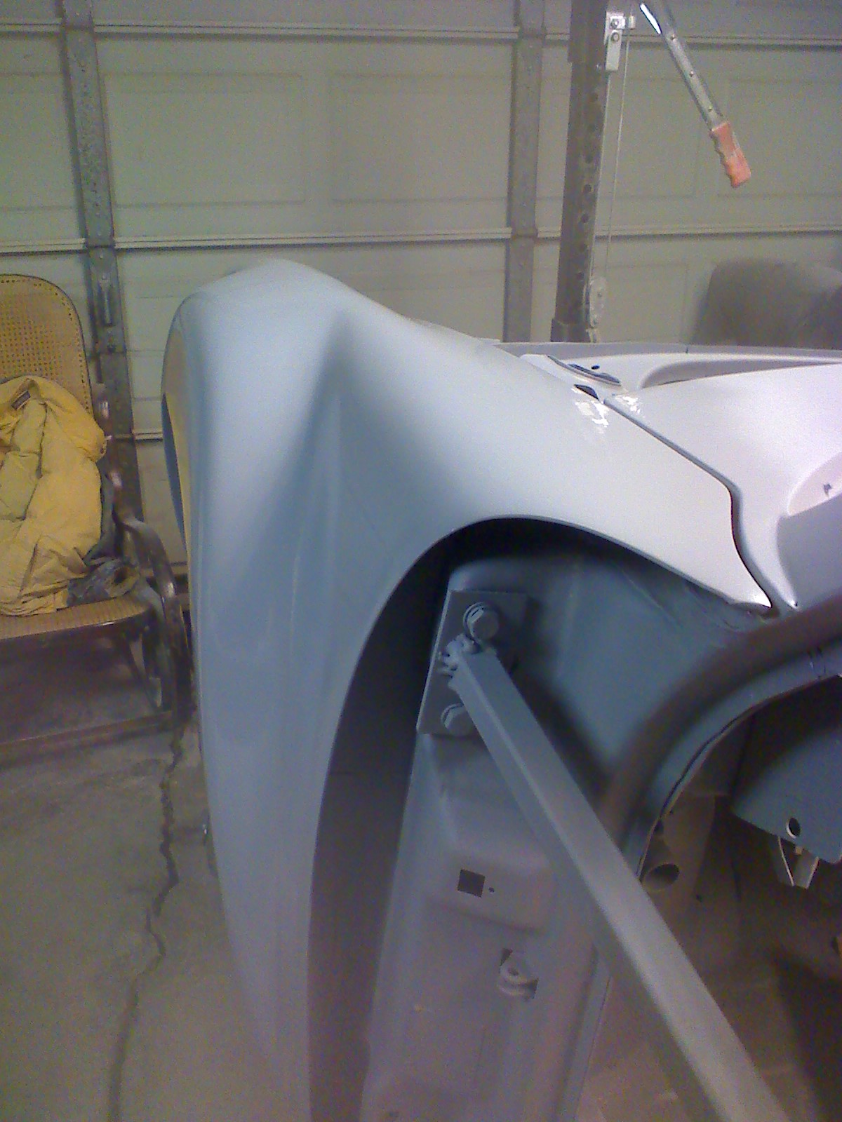

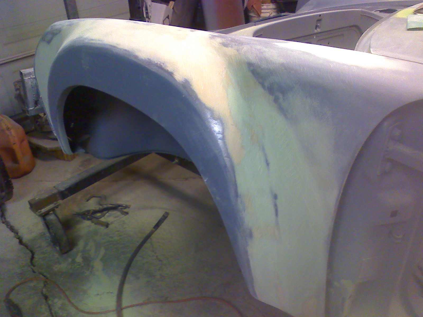

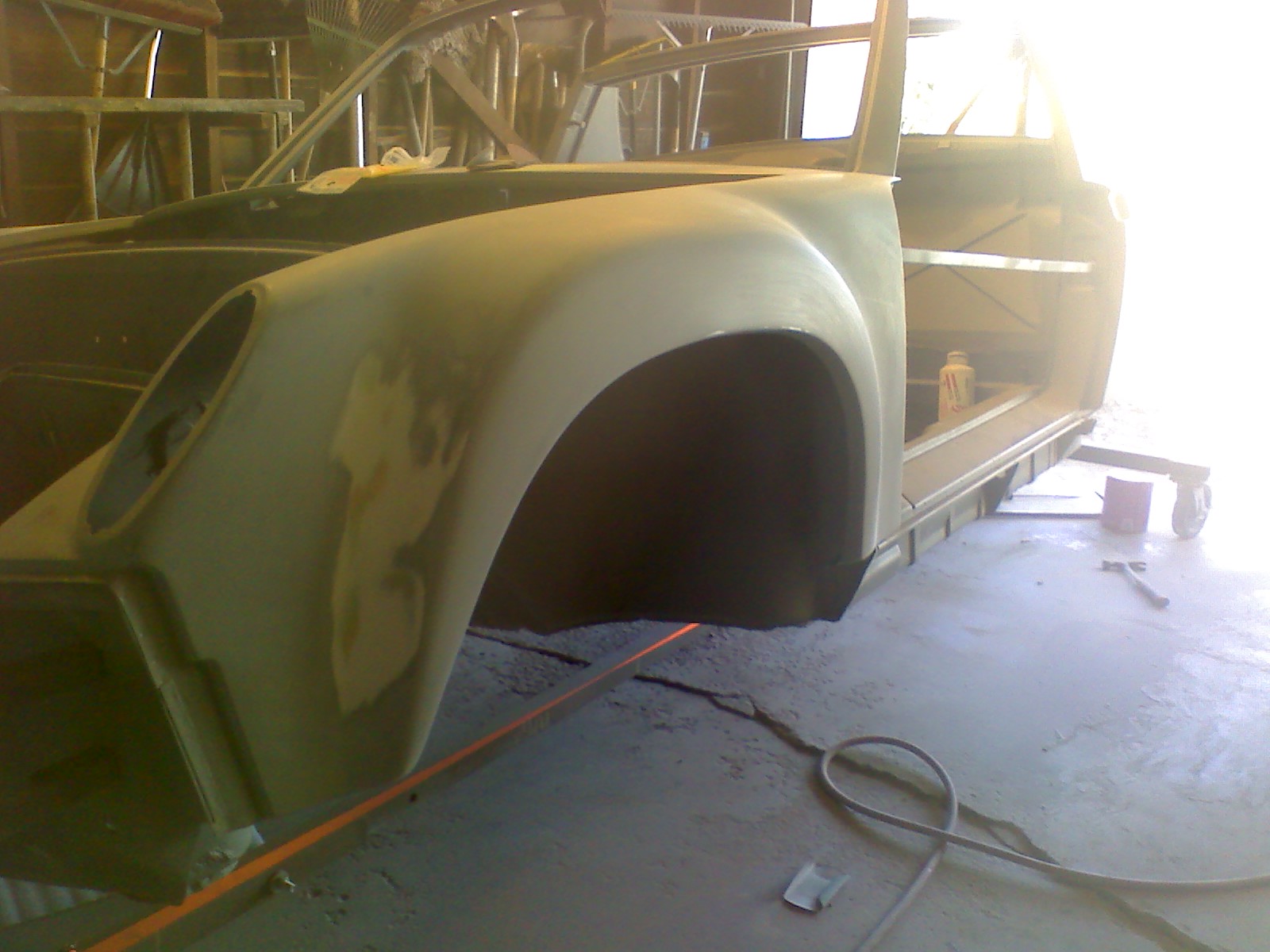

More progress from my body guy. He sends me about 20 pics every night at about 2:00am. The body of the message from these pics said he felt good about the drivers side now, and was going to work on the pass today. He'll have the whole thing in 2K primer by tomorrow and can start working on sanding/blocking everything again and again. "Looks like a lot in some pics, but after sanding it'll be nothing much thicker than a dime."

That looks great! Almost time to guide coat and block it out! (IMG:style_emoticons/default/wub.gif)

Dude you're gonna hug it out with that guy when you get back. (IMG:style_emoticons/default/grouphug.gif) He's really diving in. Looks really good.

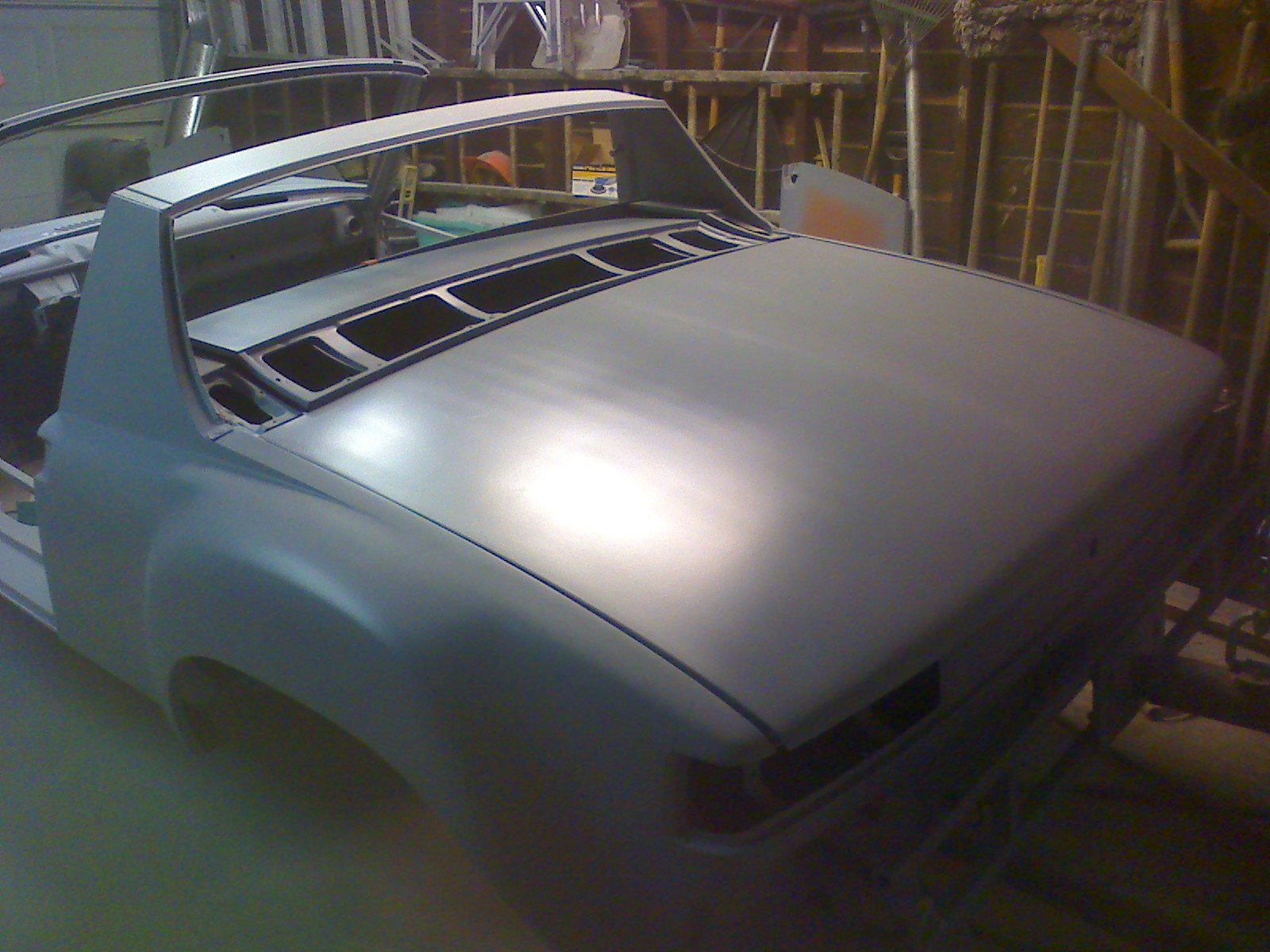

He JUST called me as I was pulling in my drive in Palo Alto. He thought he needed to have it done by Thursday when I got home! I told him I wouldn't be able to take it until Monday or Tuesday. I've got to get the V8 I pulled out shipped first. It's taking up too much room in my garage! (...and, it'll be needed shortly.) He already has the whole car in primer, and will start blocking it out tomorrow afternoon and Thursday. Said he'd like to do 2-3 coats of primer to make sure it's tight before I get it back.

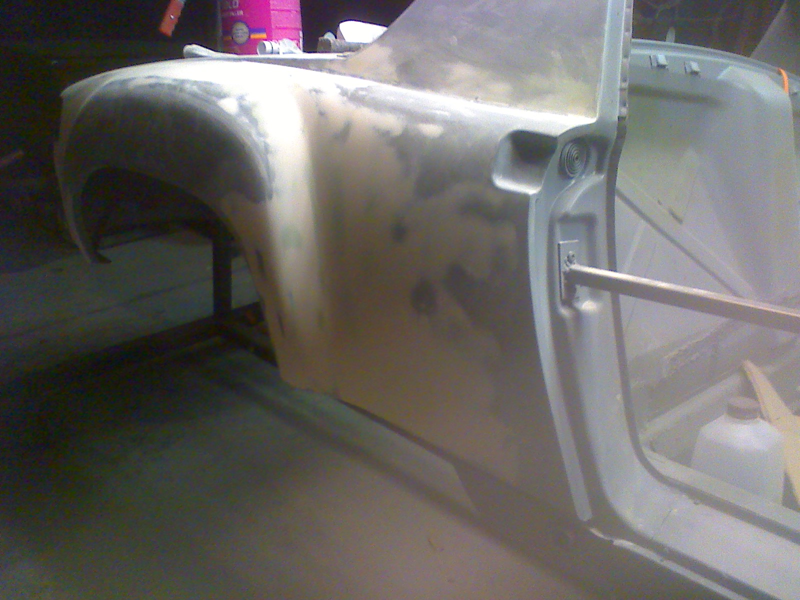

Here's his email from today. (He sends me about 20 pics every night.)
hey doug, got left side in filler 1/4 is ready for prime fender still needs to be blocked straight, left side was block sanded today and needs to be sprayed with primer again but it feels beautiful. i found a bunch of dents in hood and trunk lid i have to take care of tomorrow also. i cant guarantee anything yet but it looks like the shell itself may be finished for you to take home on friday if you dont mind leaving the doors for me to finish over the weekend

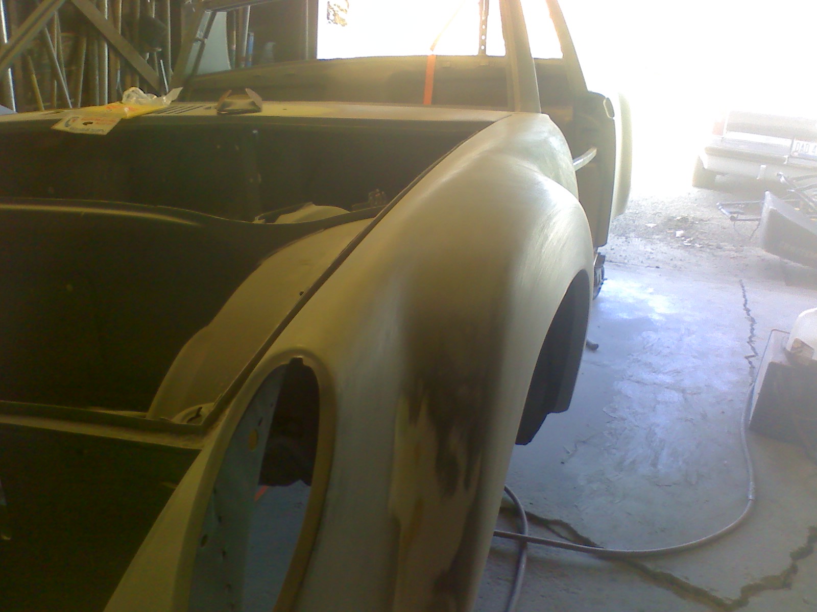

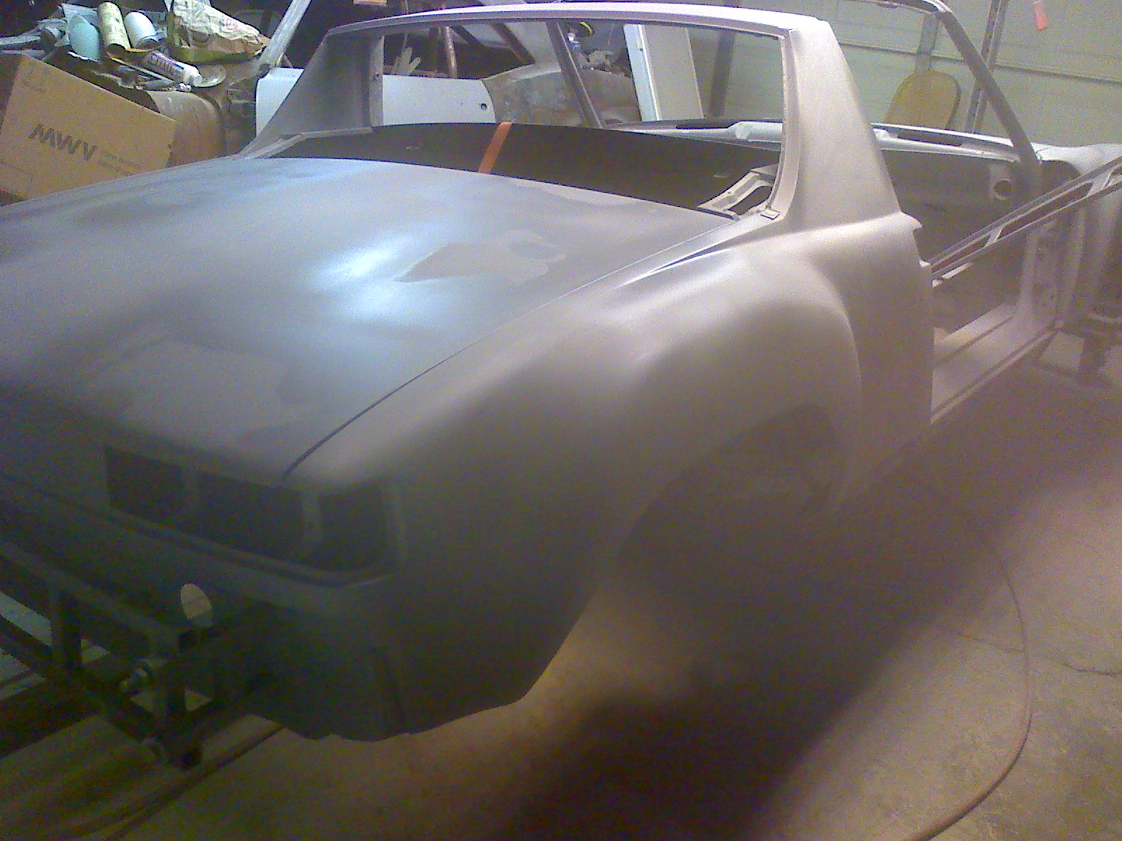

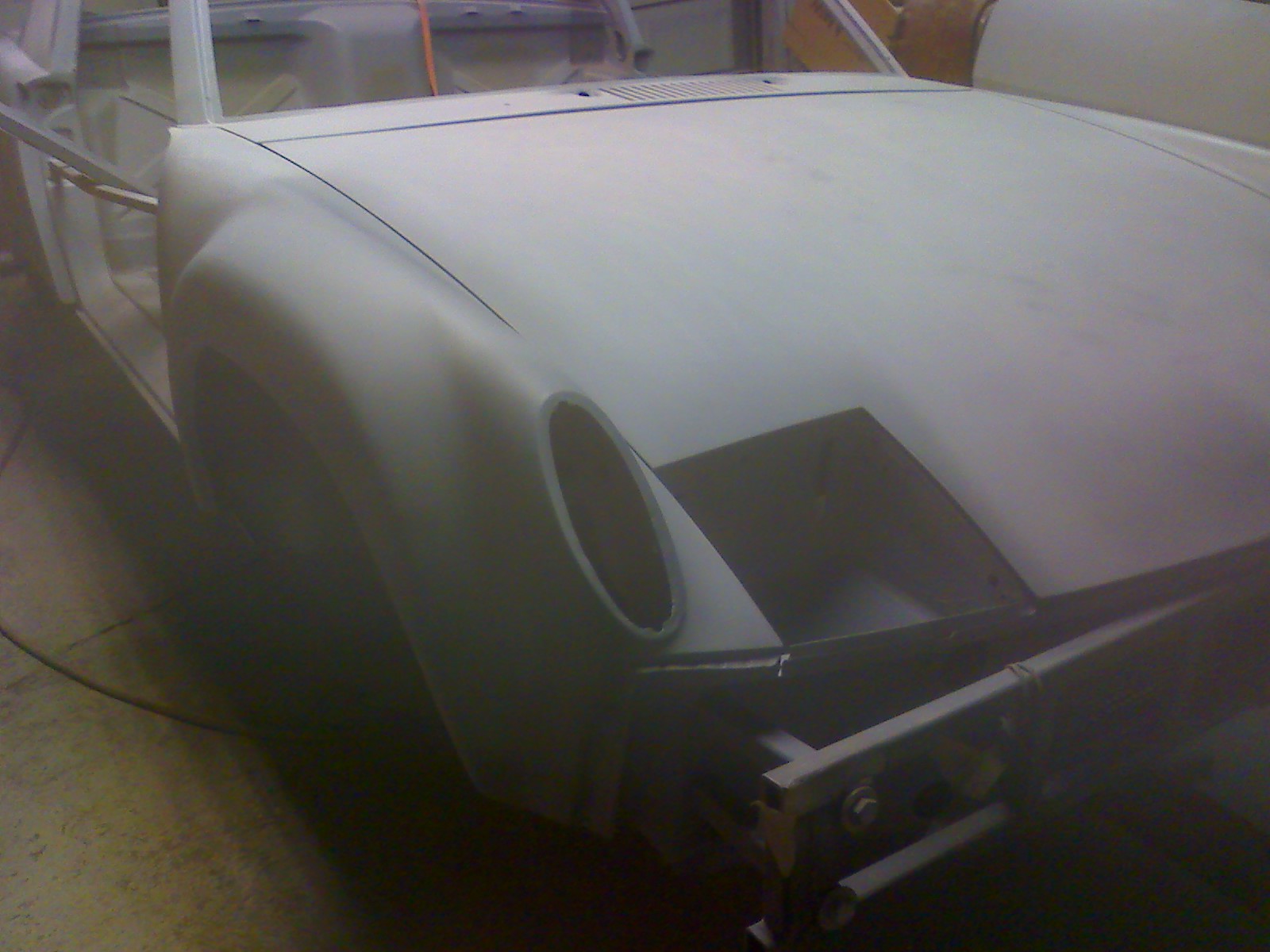

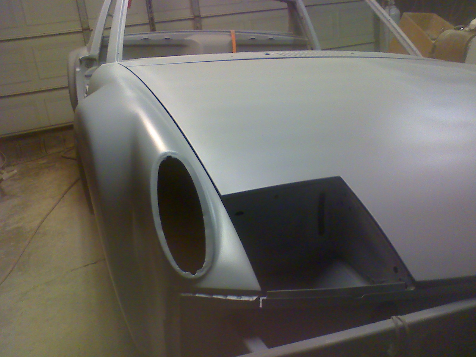

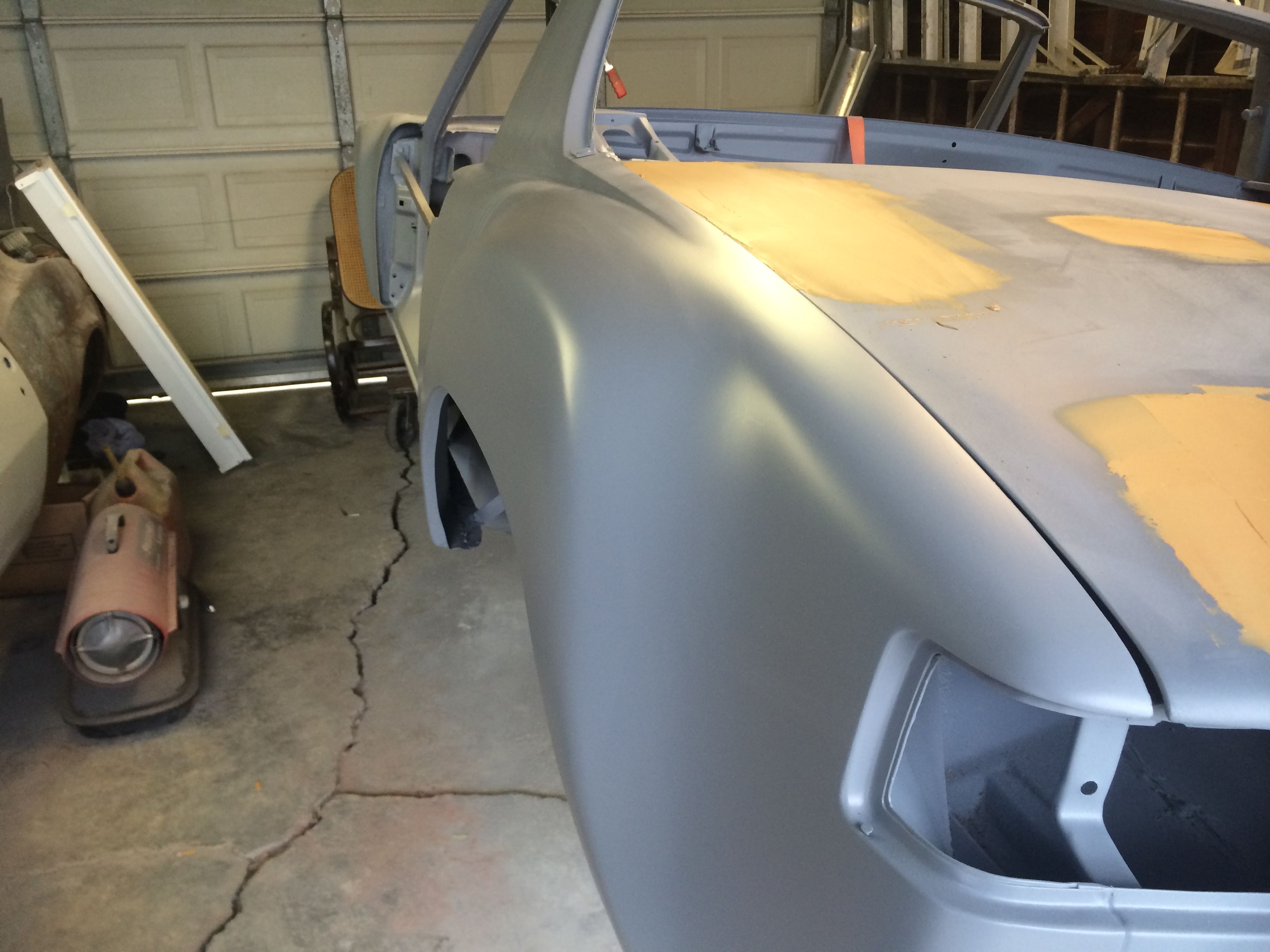

Stopped by this morning on my way home from the airport to check in and see how it was going. Man...I'm a happy camper.
The driver's side will be blocked out after he's finished with the passenger side later today. He's going to shoot the whole car with 2K one more time before I get it back.
He's really doing great work. I can't imagine how I'd have done this good of a job on my own. All the welds on the inside of the flares were ground down and feel nice. Every little hole is patched and now smooth. It's exactly what I was looking for.
Here are a few pics I took with my phone. Hope to have it back in my garage Monday after someone comes to grab the engine I'm shipping. (I need the room...badly!)

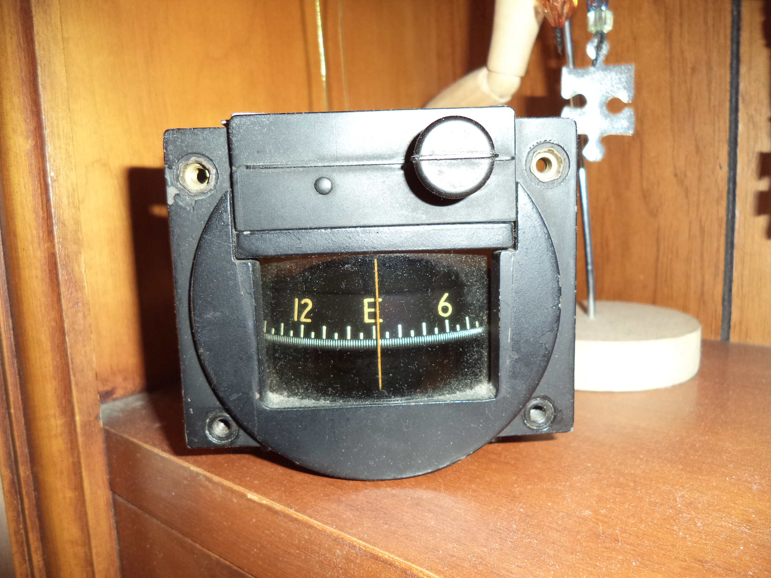

love love love all that chrome look powder coated suspension parts (IMG:style_emoticons/default/wub.gif)
my compass, similar to your gauges.

I DID look at using real airplane gauges at one point, but bailed on it pretty quickly. Too much work!

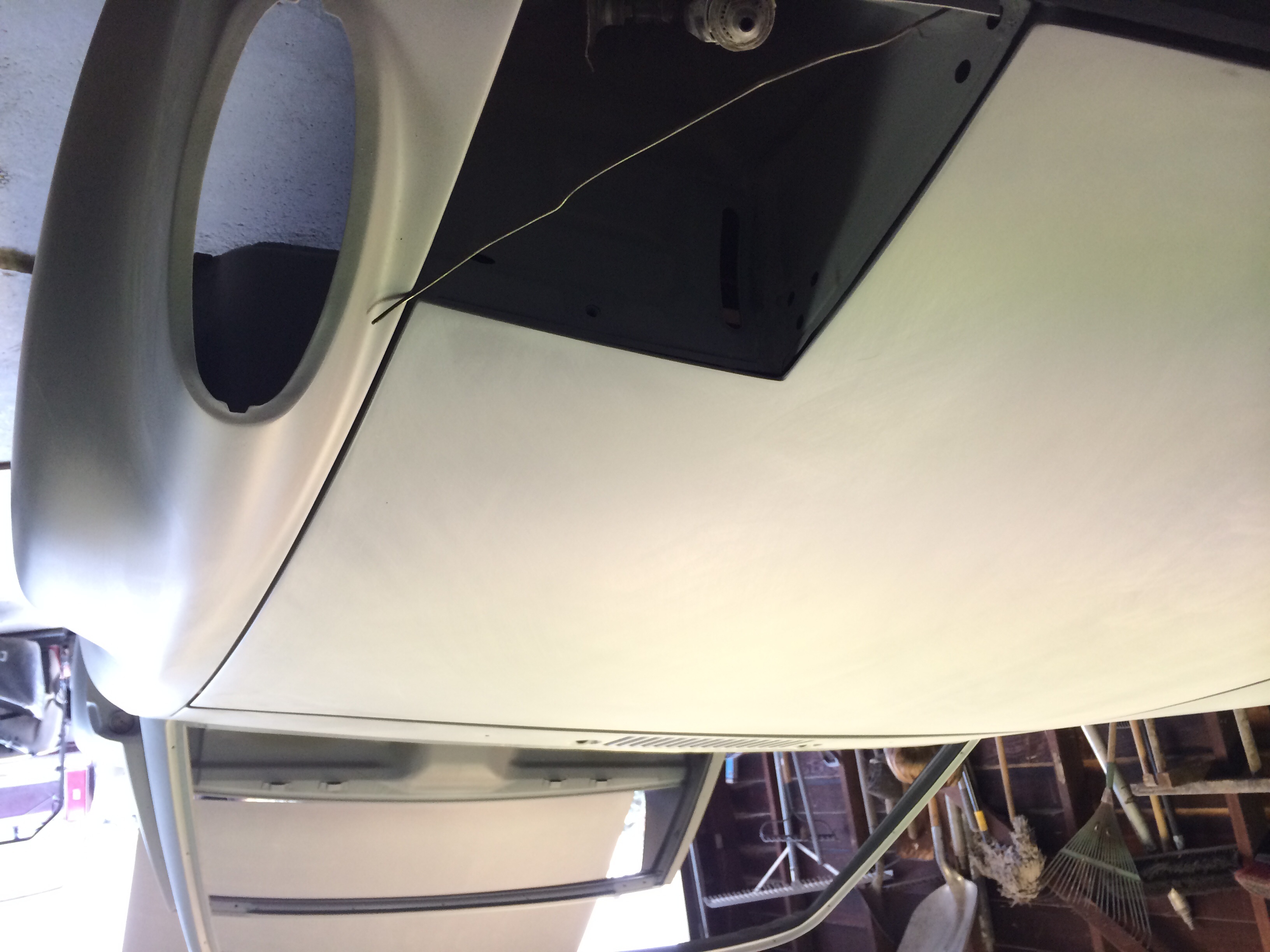

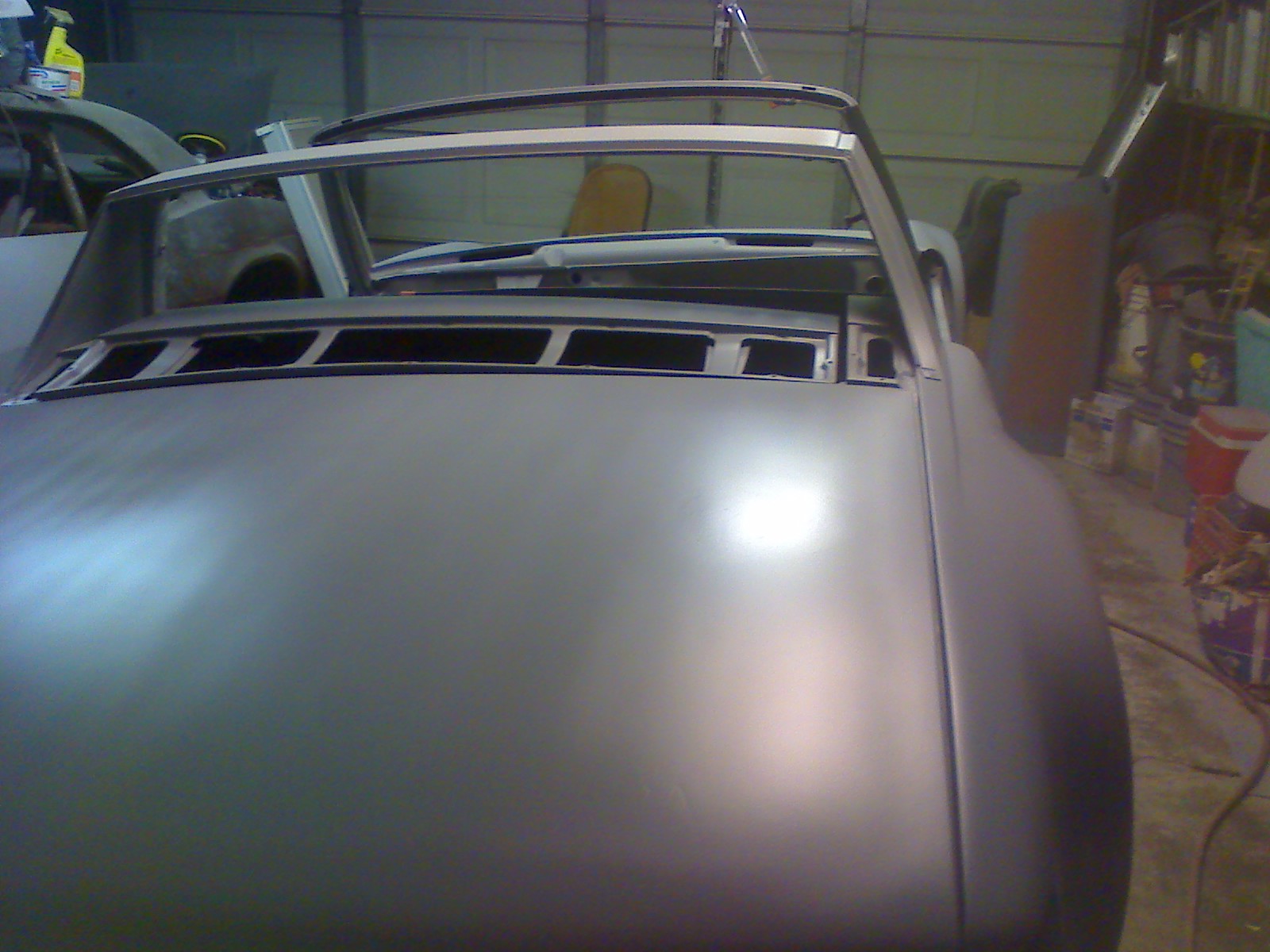

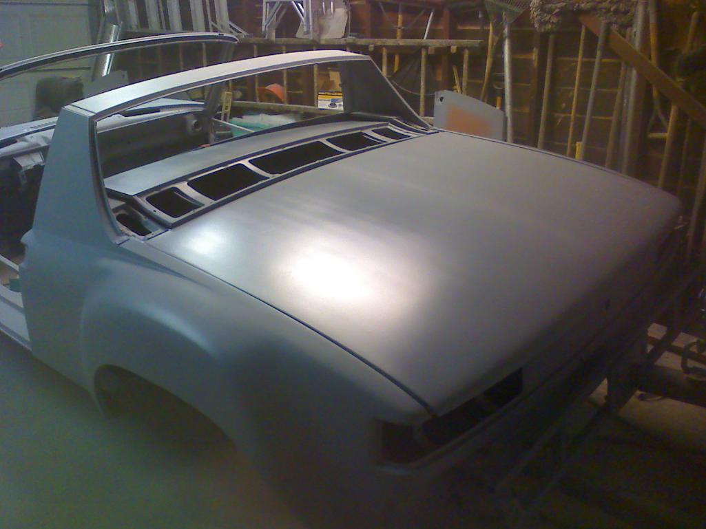

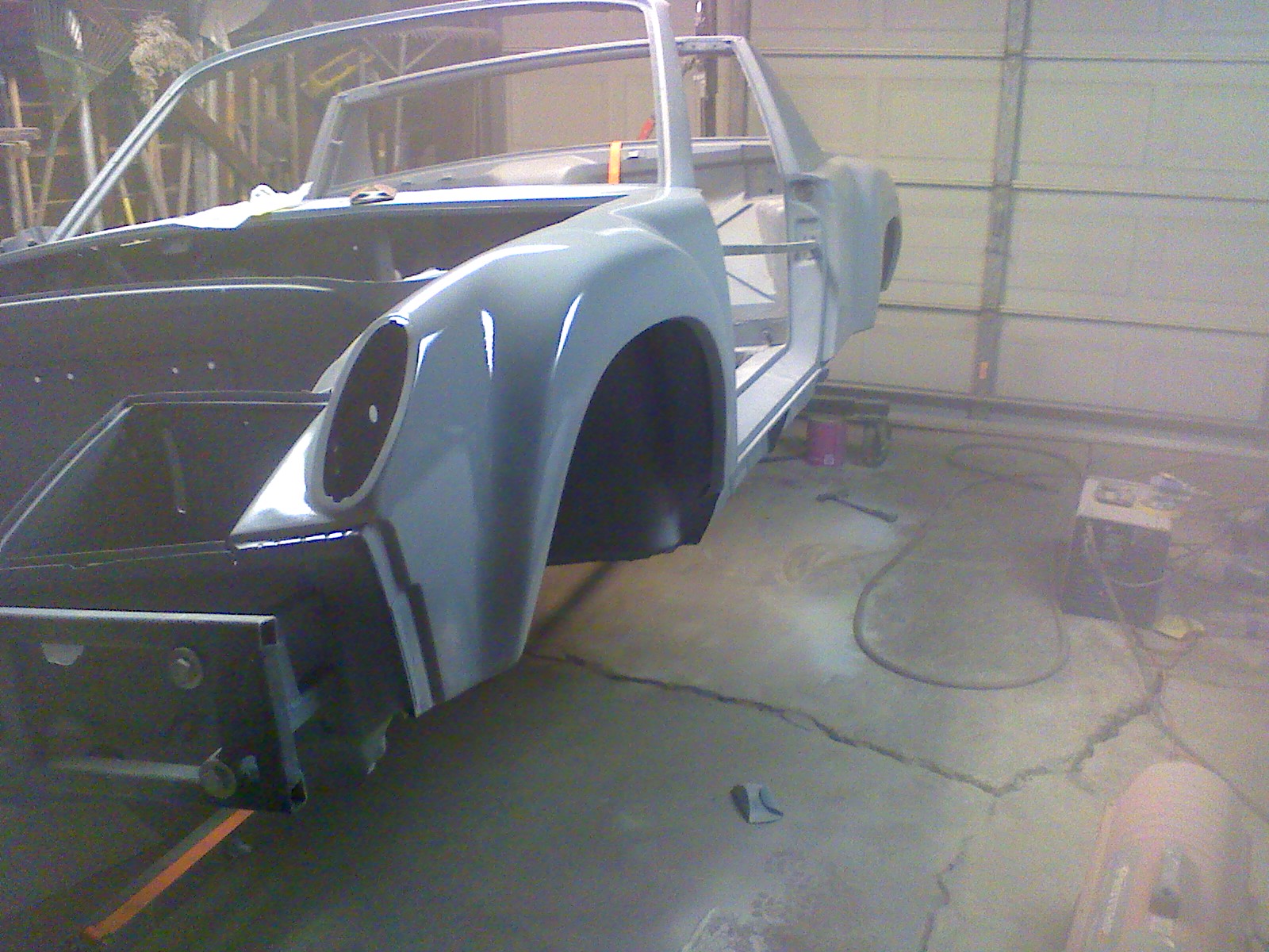

It's really starting to come together on the body front.
He knocked out the lids and put a few more coats of 2K on the car yesterday with some additional blocking to knock it all down. I'm quite pleased. He's going to start on the doors today and I should be in good shape to bring it home on Monday so I can get the bottom, interior, and trunks sprayed with the base coat. I can start putting the wiring harness and interior in from there.

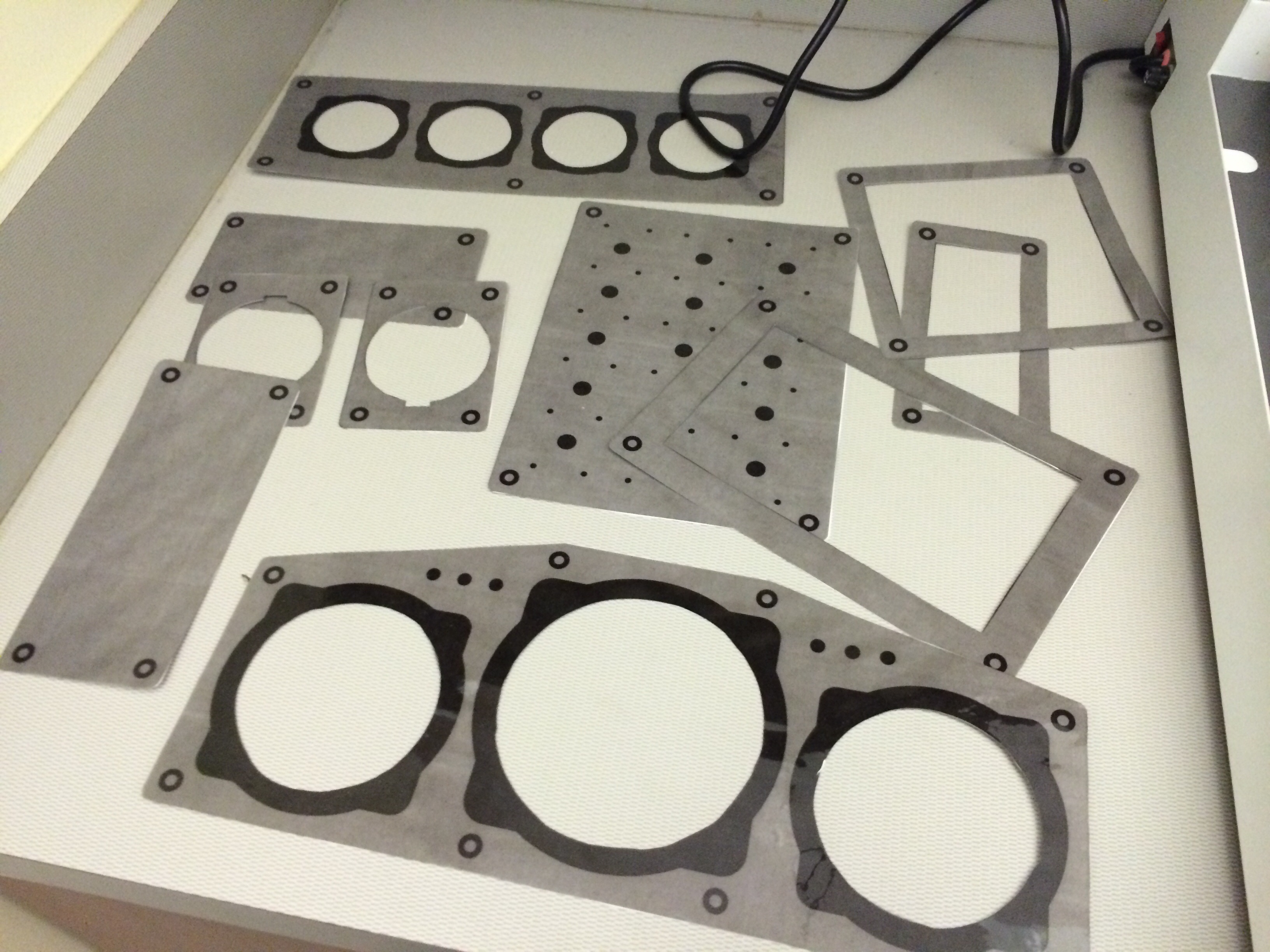

Working on the interior this weekend.
I printed all the plates I was going to have water-jetted out of 1/8" Aluminium. After I laminated them, I can mock everything up from here. Then I just need to make adjustments once and I should be in good shape.

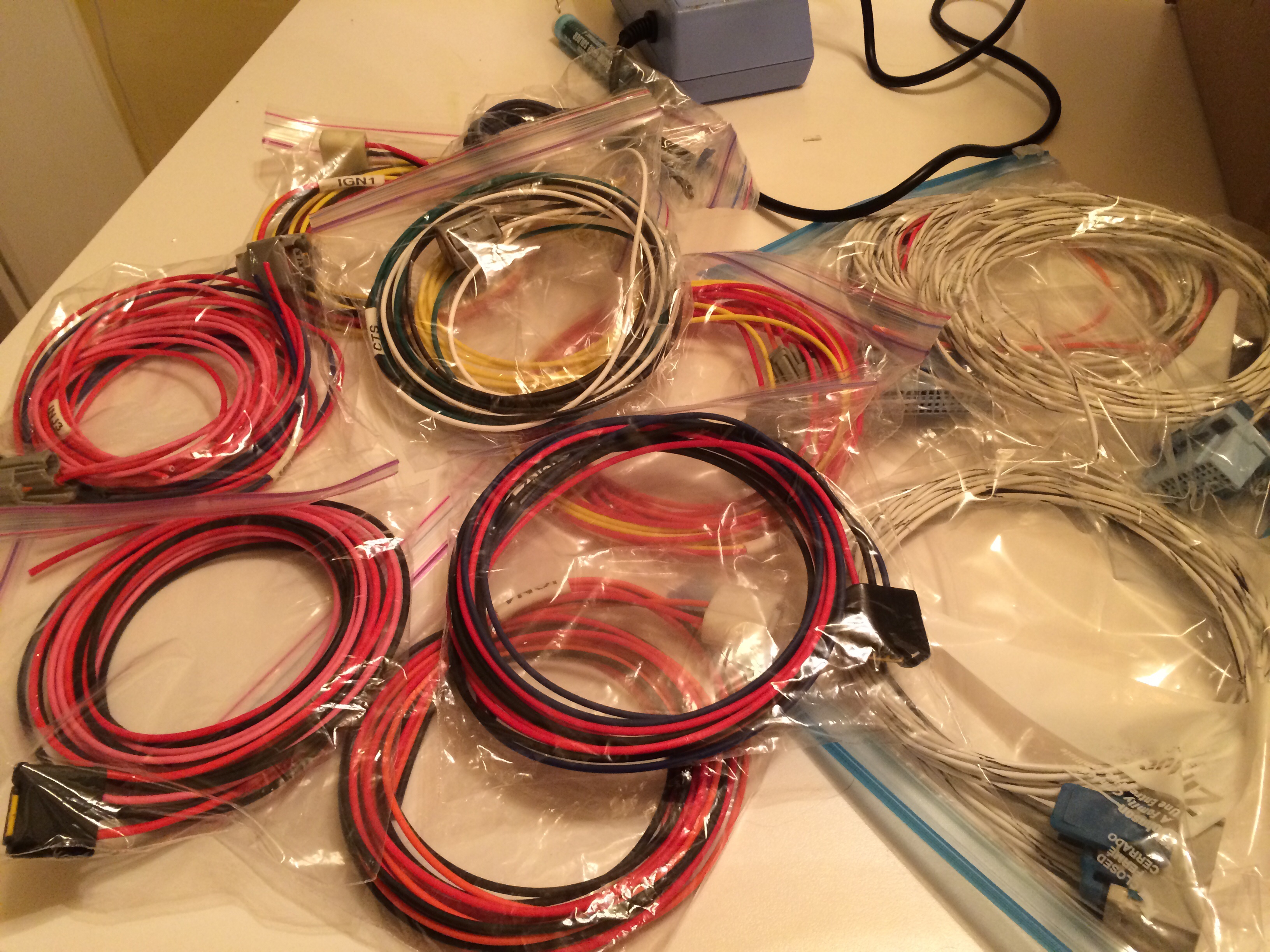

Spent the night building the engine's wiring harness. I still have 3 sensors left to do, but I want to double-check the names and connections BEFORE I crimp them down. I started working on the dash plates like I mentioned in the previous post. There are a few changes I need to make to those before I have them water-jetted. Glad I played with paper first!

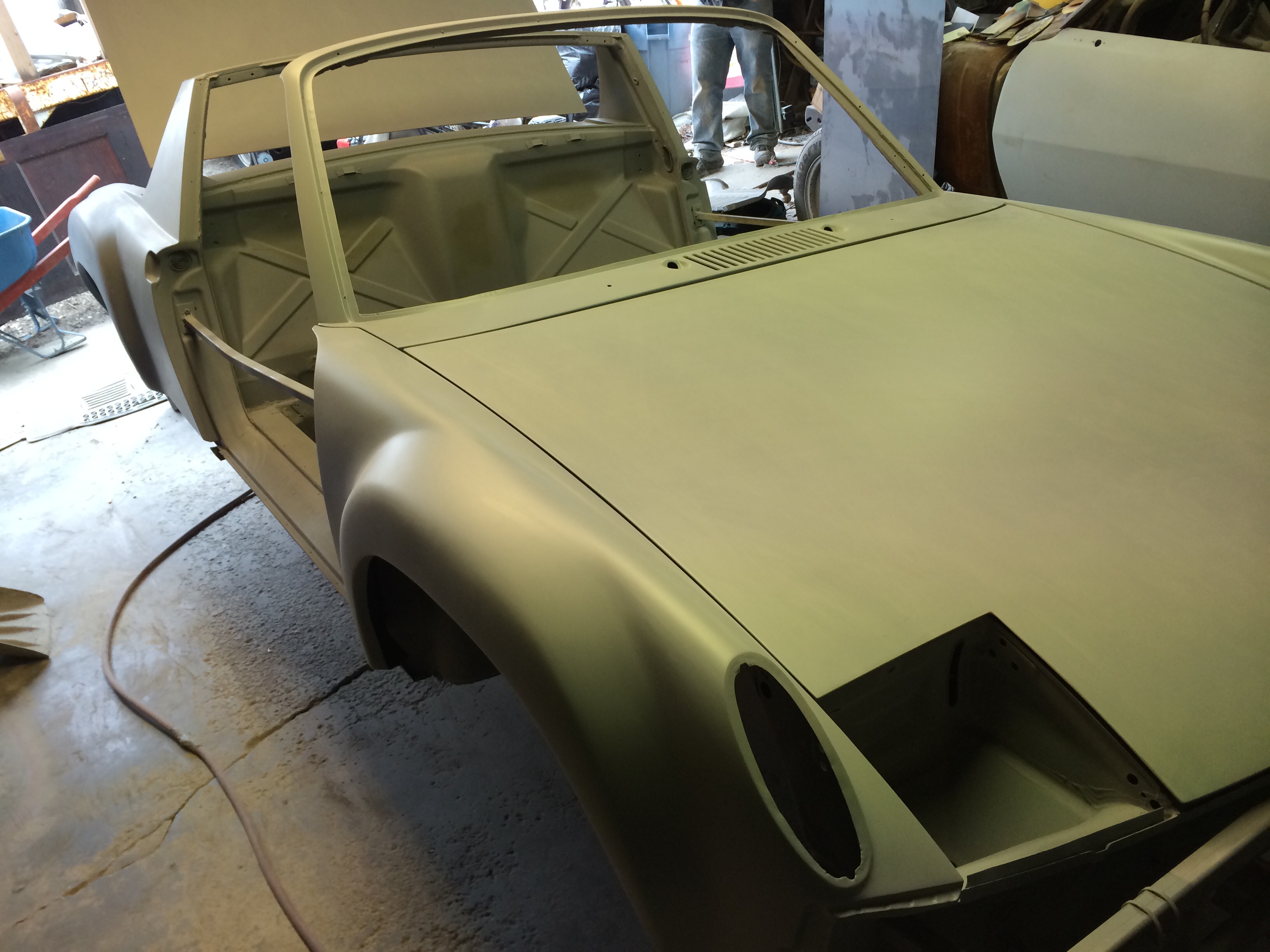

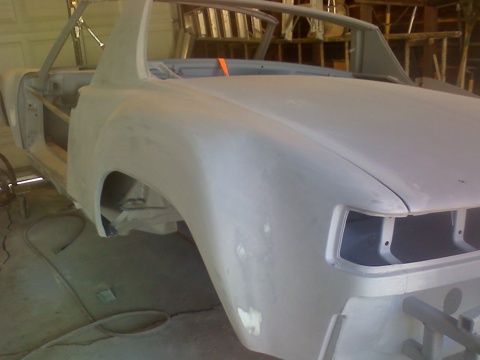

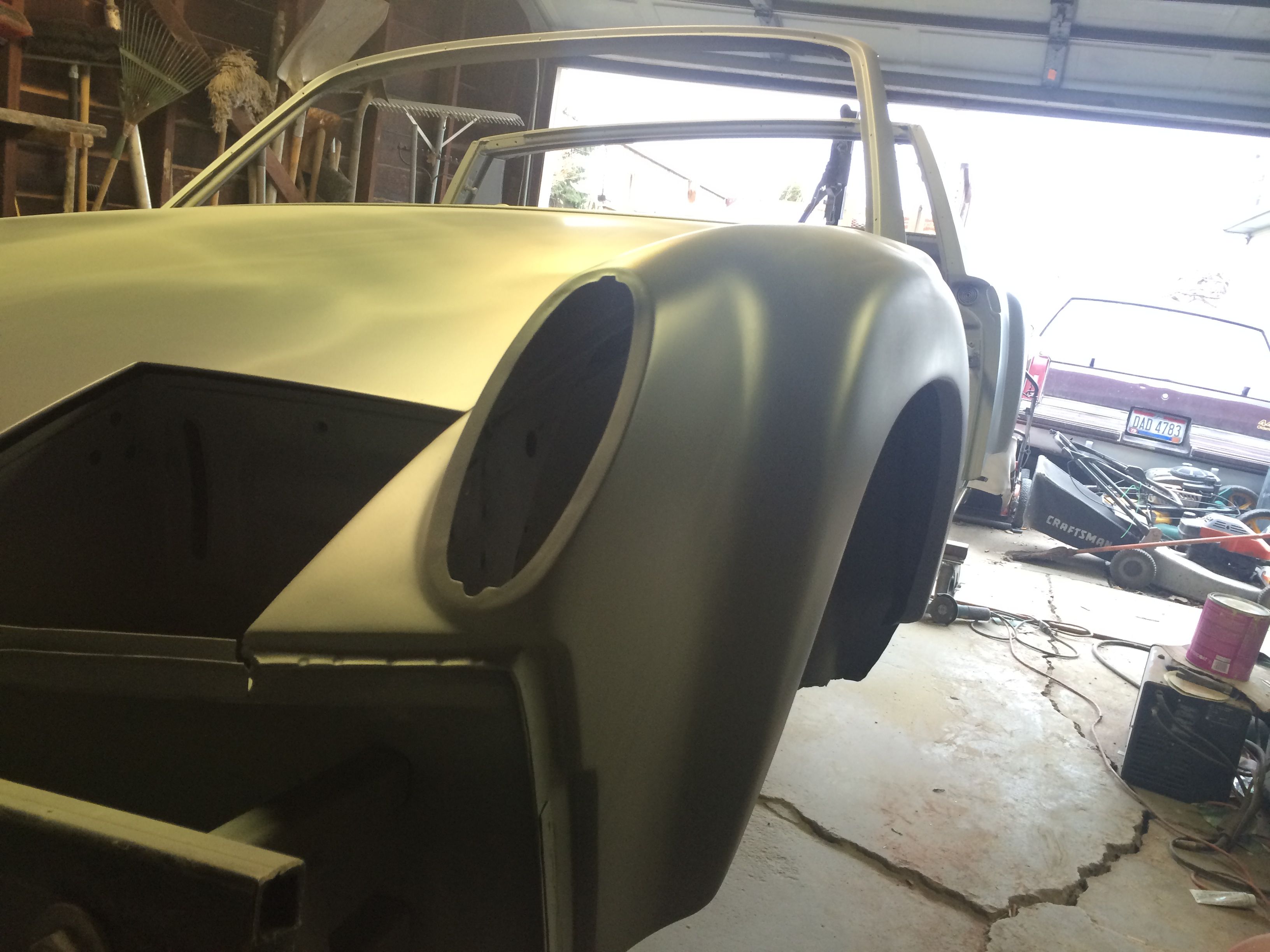

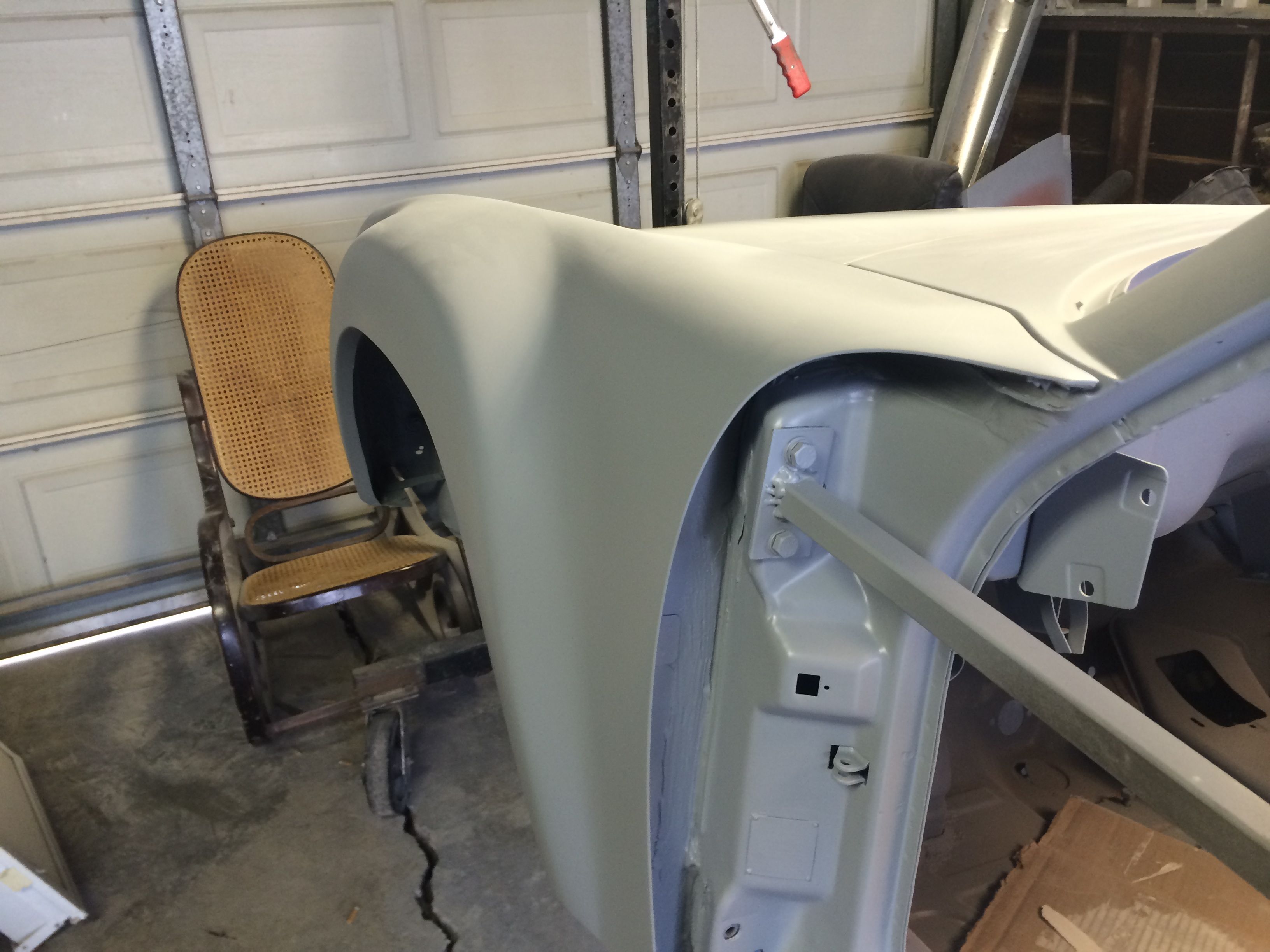

Stopped by to check on the progress today, and I'm loving what I found.
The body is primed, blocked, and ready to go! I was going to paint it at home, but he's doing such a great job, I have him some more work. He'll be replacing the rear trunk pan for me, and building the cutout for the Subaru stuff. I'll have the car back and painted by next Friday, just in time for my wife and kids to leave for the weekend.
I plan on cranking through the weekend and HOPEFULLY I can start the car at some point on Sunday.

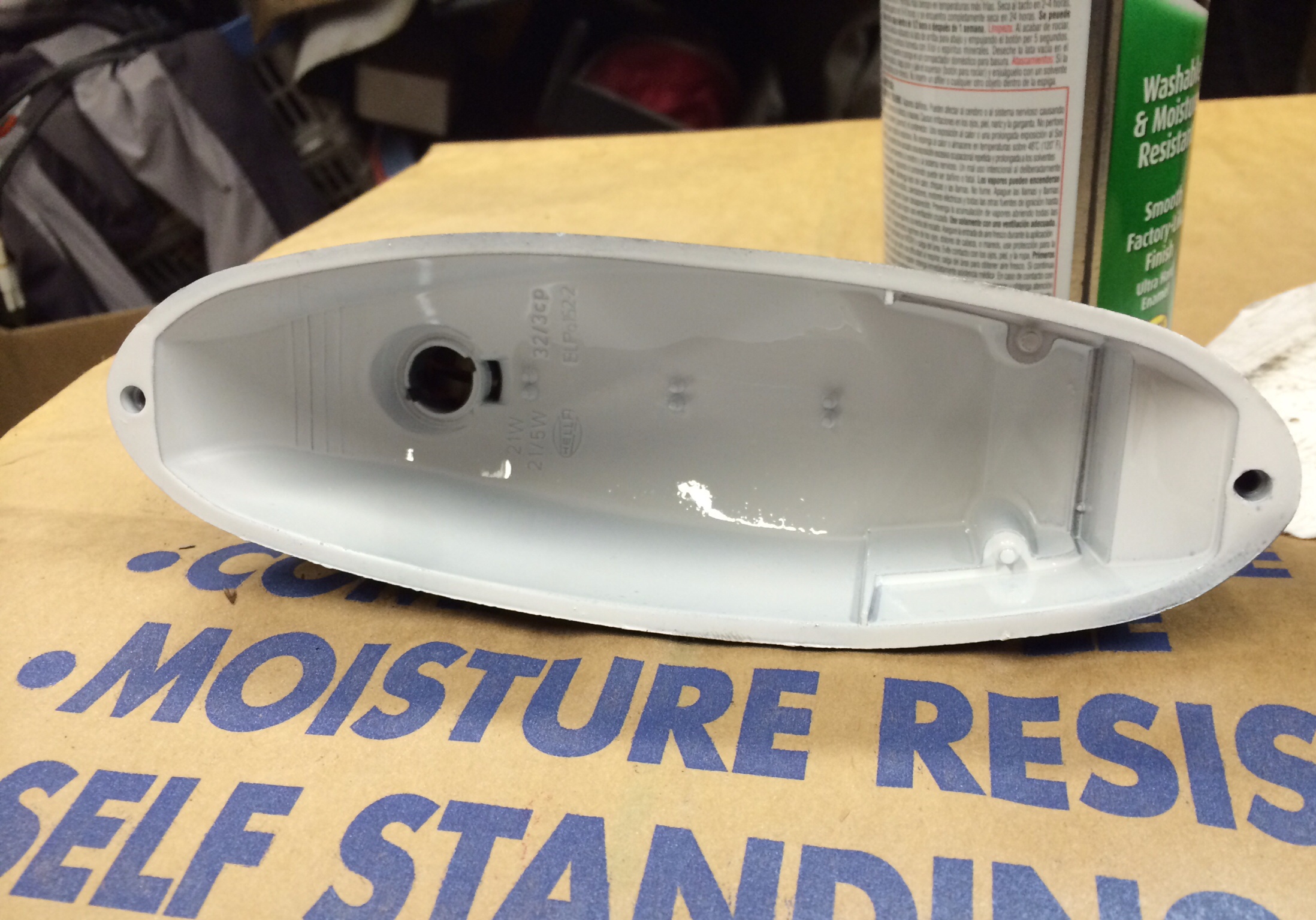

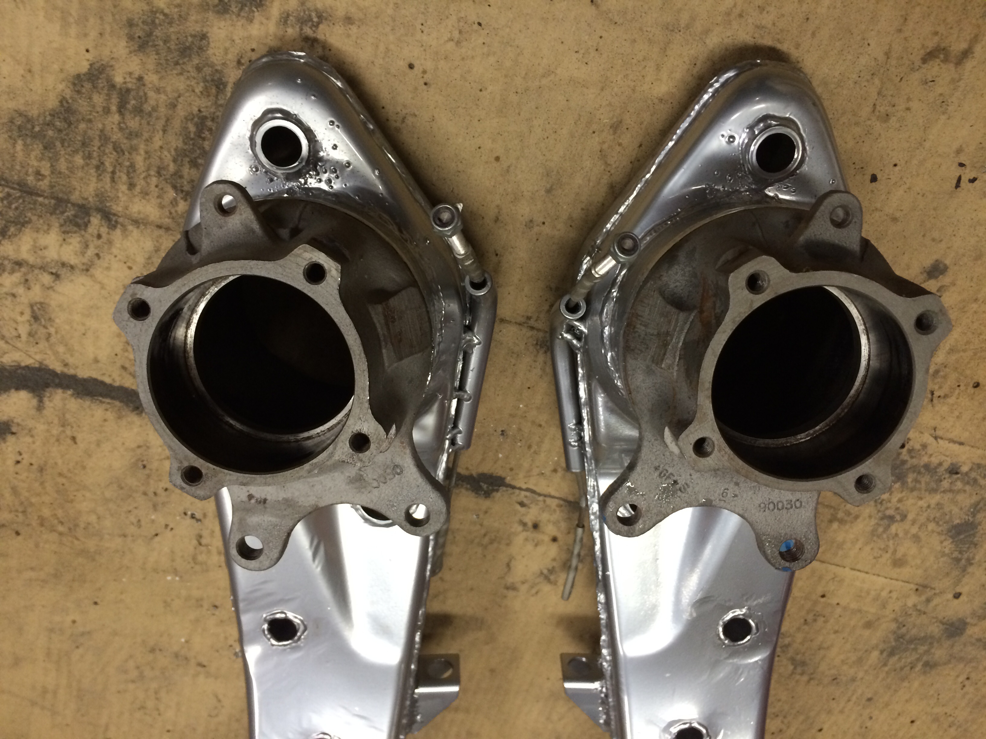

I couldn't sleep so I went to the garage to clean and get a few little things going.

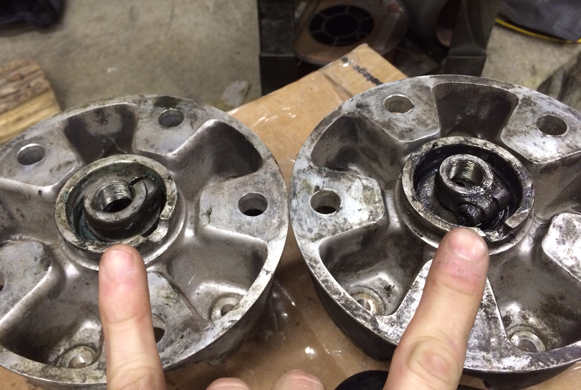

Yanked the bearing pieces out of the rear arms and blasted the front signal buckets. I'm painting the insides white so they reflect the DRL lamps better. I'm going to add those in the morning and get that piece of the puzzle solved. One thing at a time.
I also noticed that the hub clamp nuts are different sizes. Gotta figure out the right one to order another of. (If I need to.)
