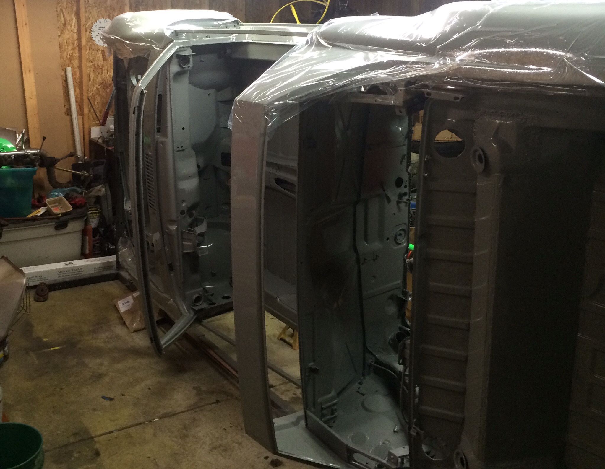

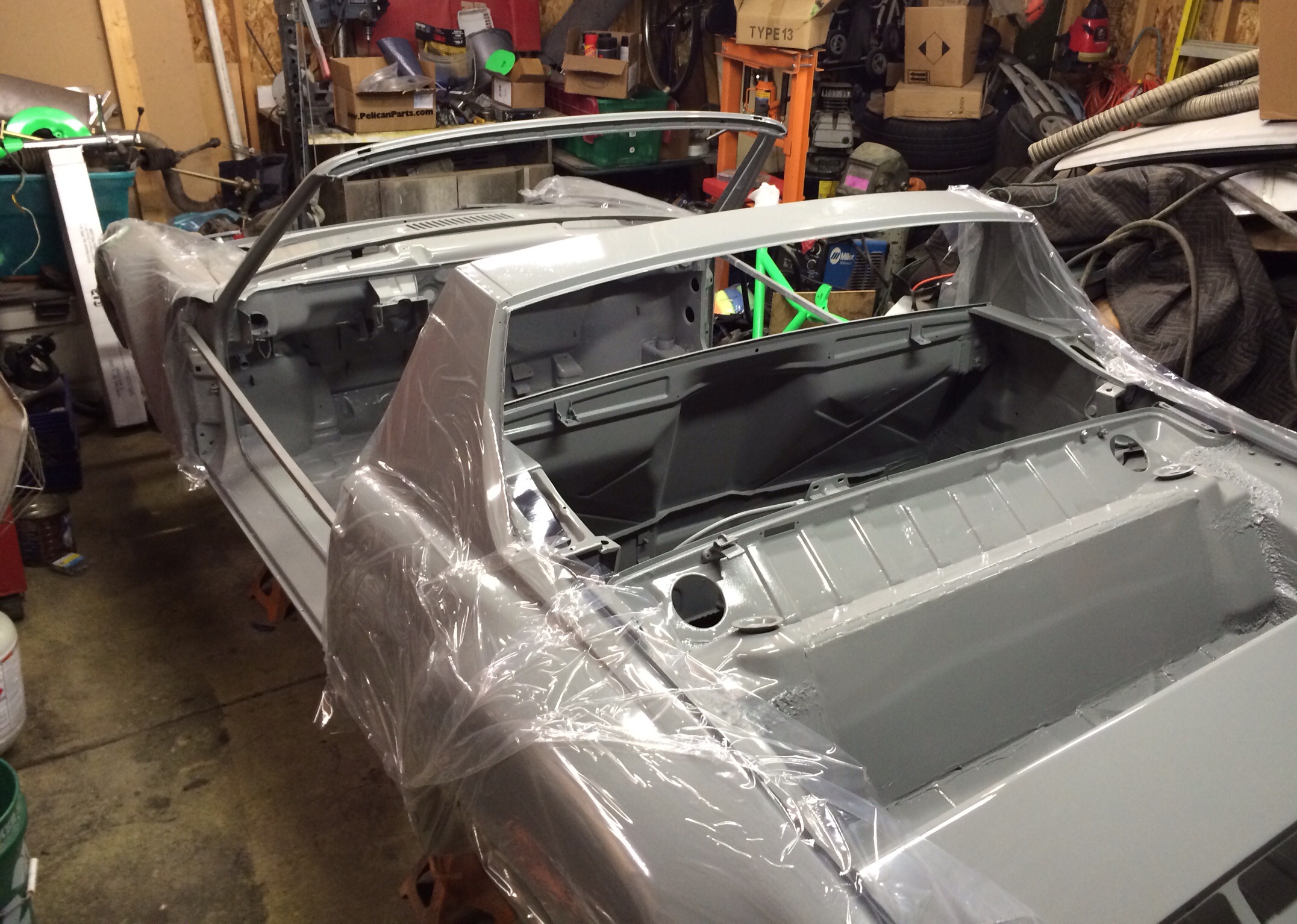

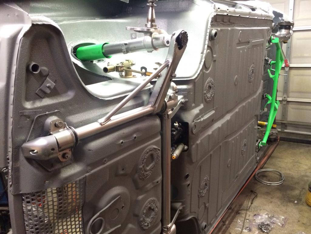

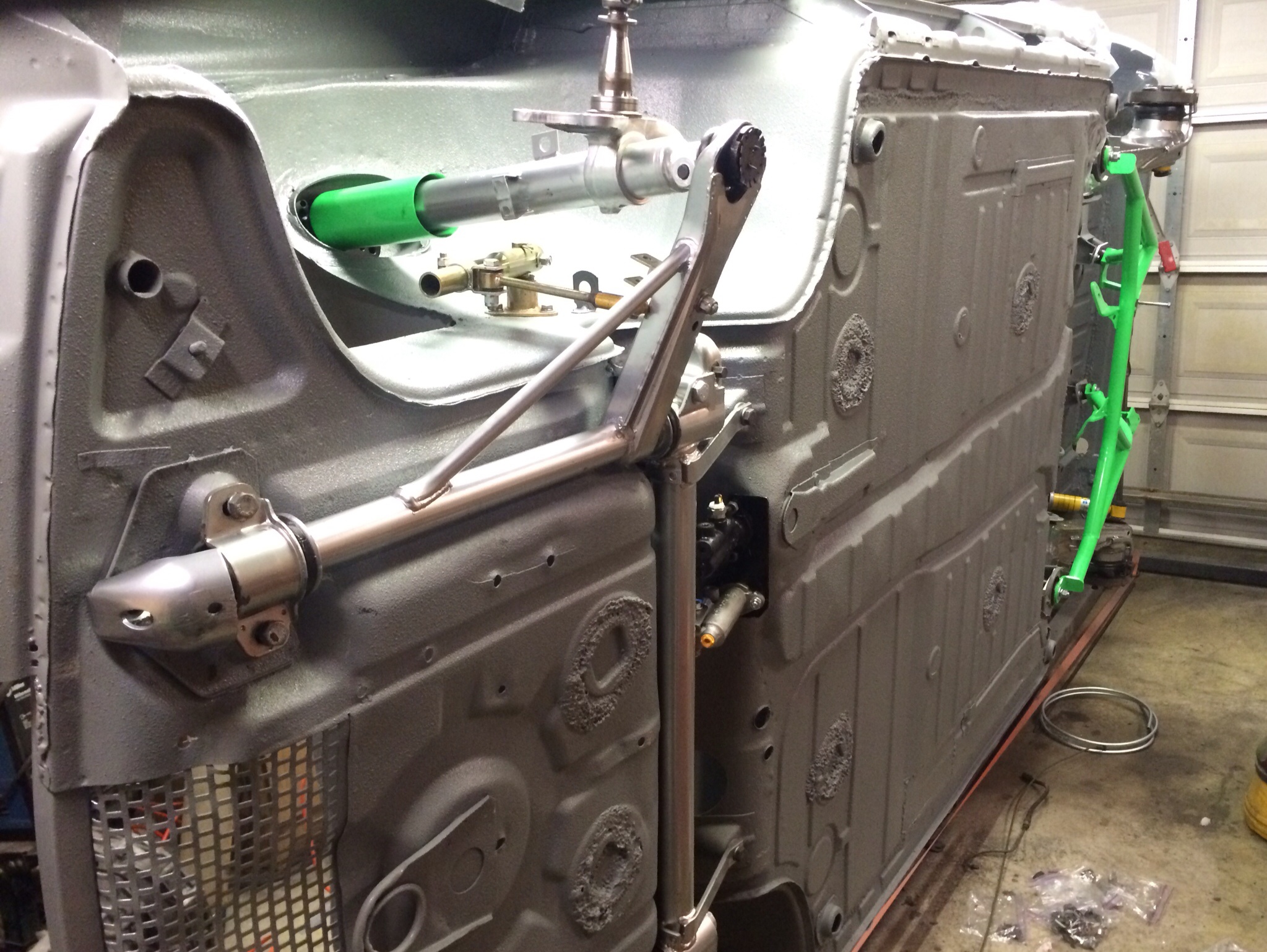

Got the car back in the garage as planned. I bought some "crash wrap" to keep the fenders from getting scuffed up while I'm walking past it, until all the crap leaves the garage this week.

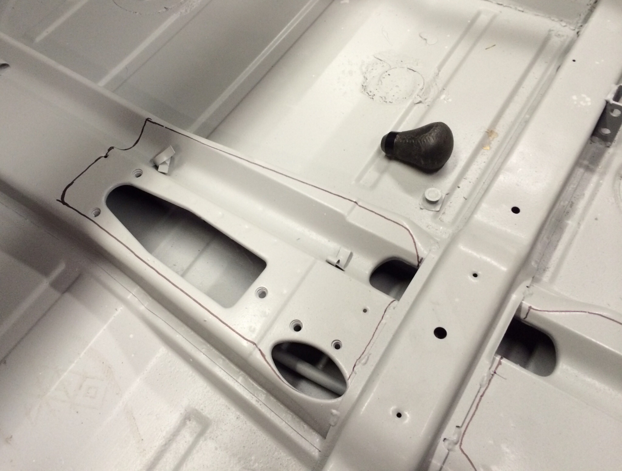

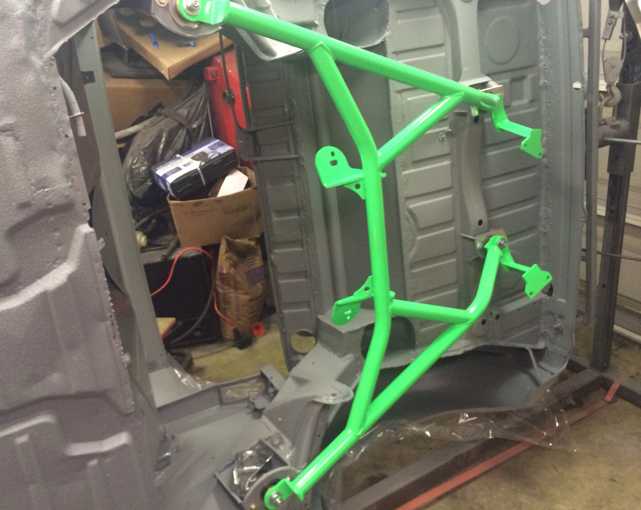

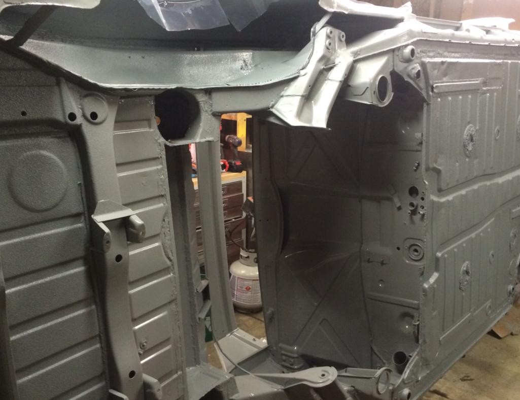

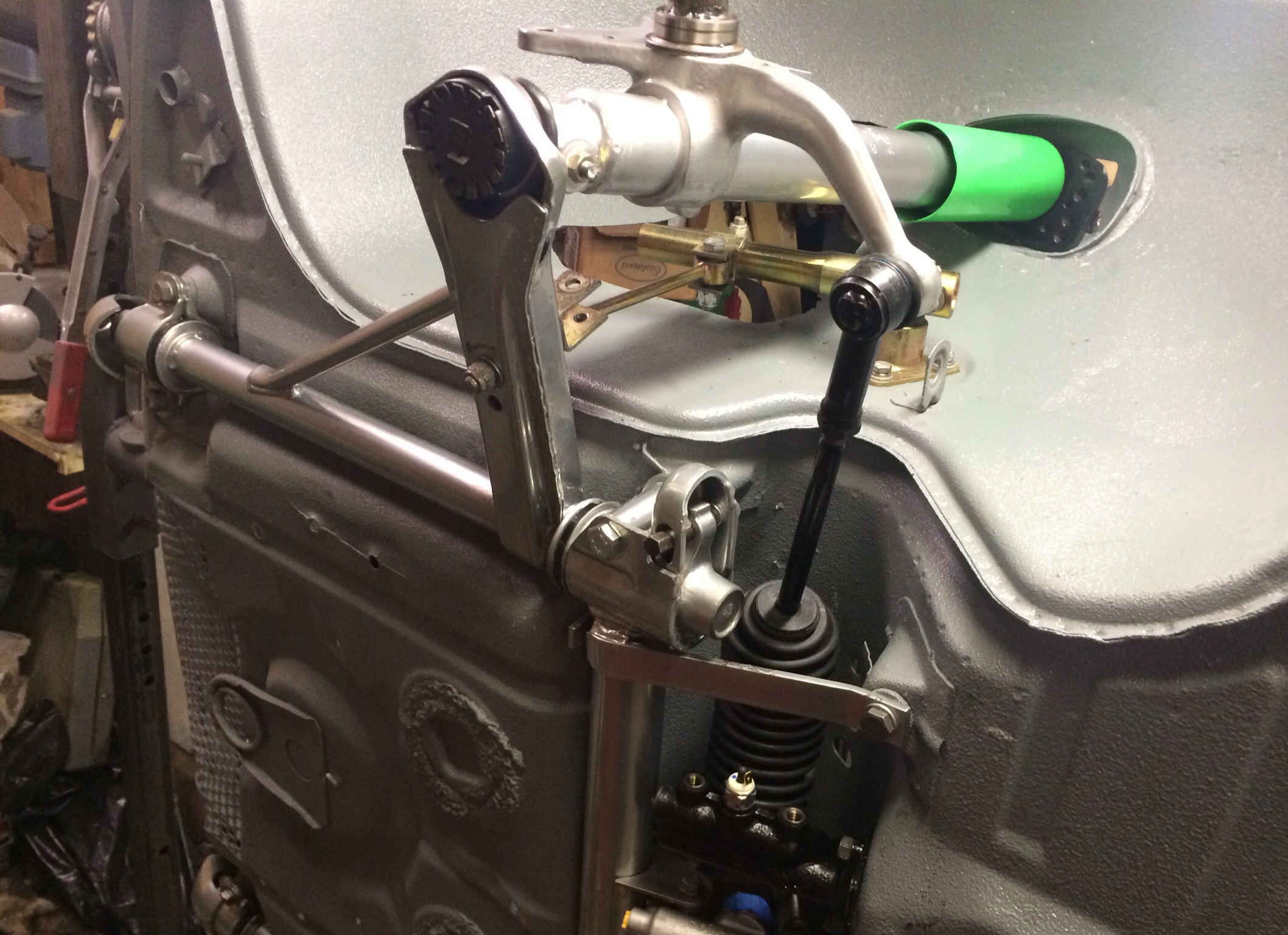

I marked out the area of the center support that I want to cut out so it's easier to get to the wiring harness, and so I have room for the cables to the transmission.
Got her up on her side, and got to work...

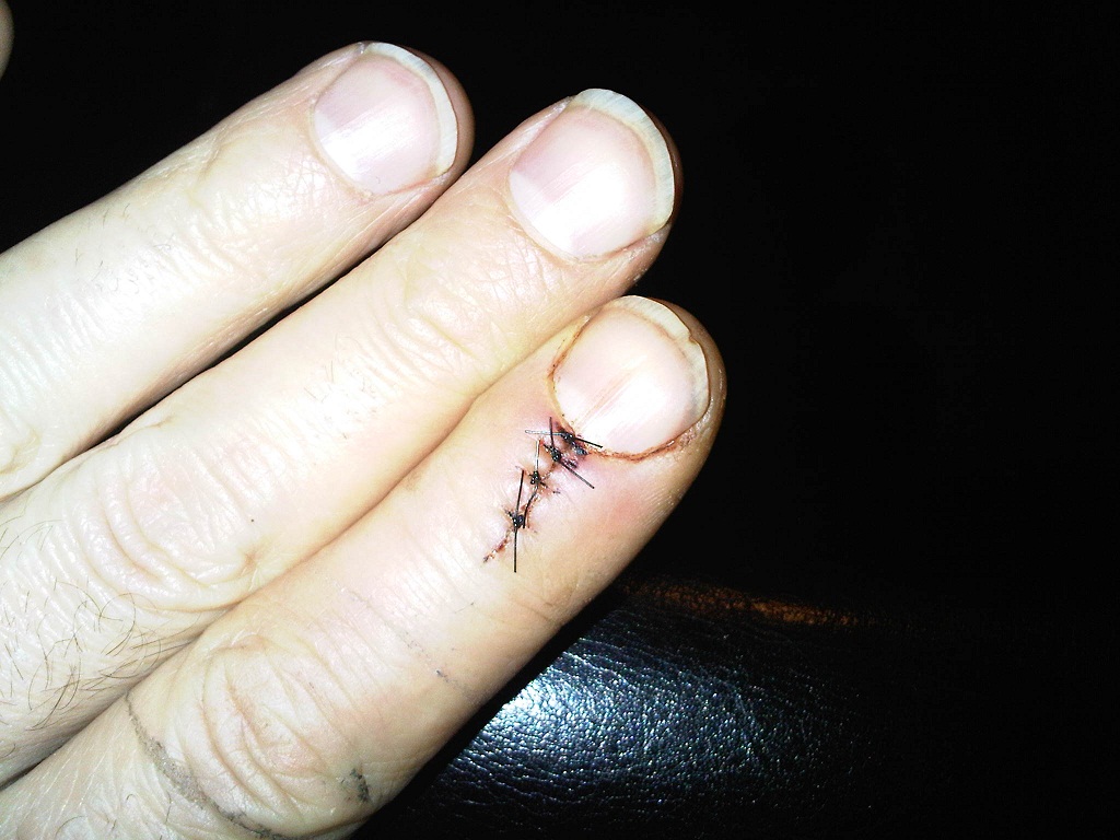

...then about cut my finger off with a cut-wheel on my grinder. So now I'm sitting in the ER waiting to get this stitches up so I can get back to my garage!

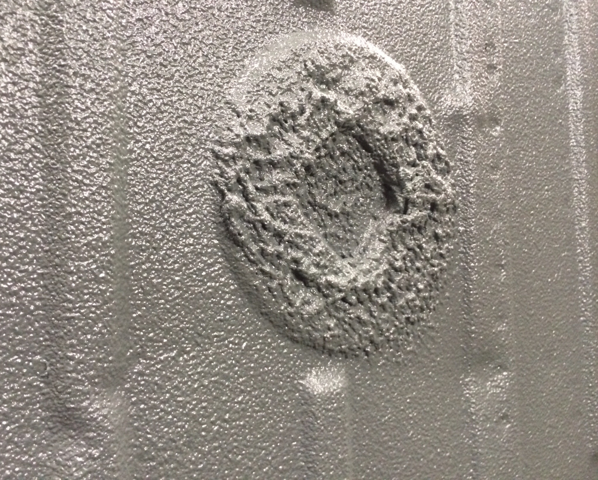

On another subject...I'm loving the Raptor Liner.

Oh, I'm not letting 6 stitches stop me. Headed home now to get back to work!

(IMG:style_emoticons/default/agree.gif) . with Billie. If I can avoid an ER, hospital (read petri dish) I do.Duct tape and toilet paper makes for one Hell of a bandage. But it will heal faster if stitched. Doug, to what and how will you mount your shifter once you've removed that area detailed? (IMG:style_emoticons/default/idea.gif)

Color: Dove Grey. NOT a Porsche color. I wanted something different.
ER: the cut wheel went through my leather glove, and the nitrate glove. I could see bone before I even took the glove off! Check it out!

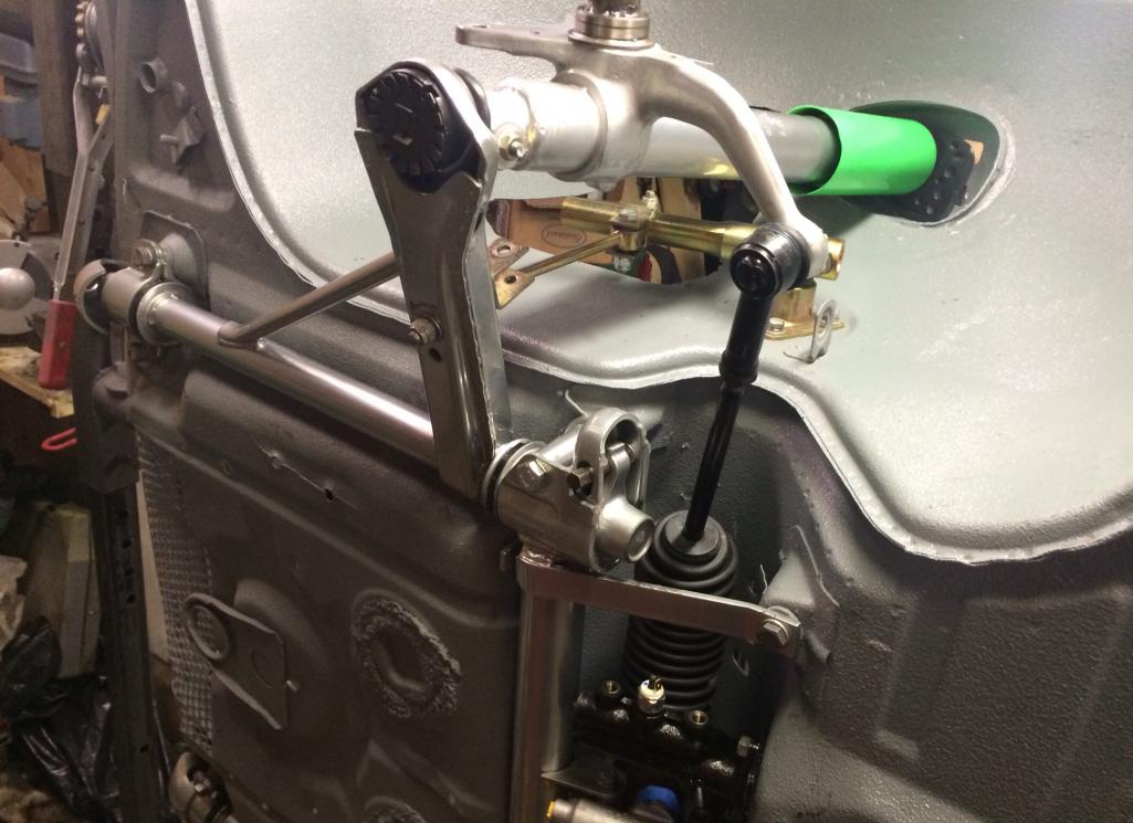

Shifter: I'm adding cross-braces so it'll be lower and give me room for cables.
I've been busy trying to get the damn front bushings on. The powder is WAY thick inside. Now I realized I have the tortion bars in wrong, so I'm trying to figure out how to remove them.

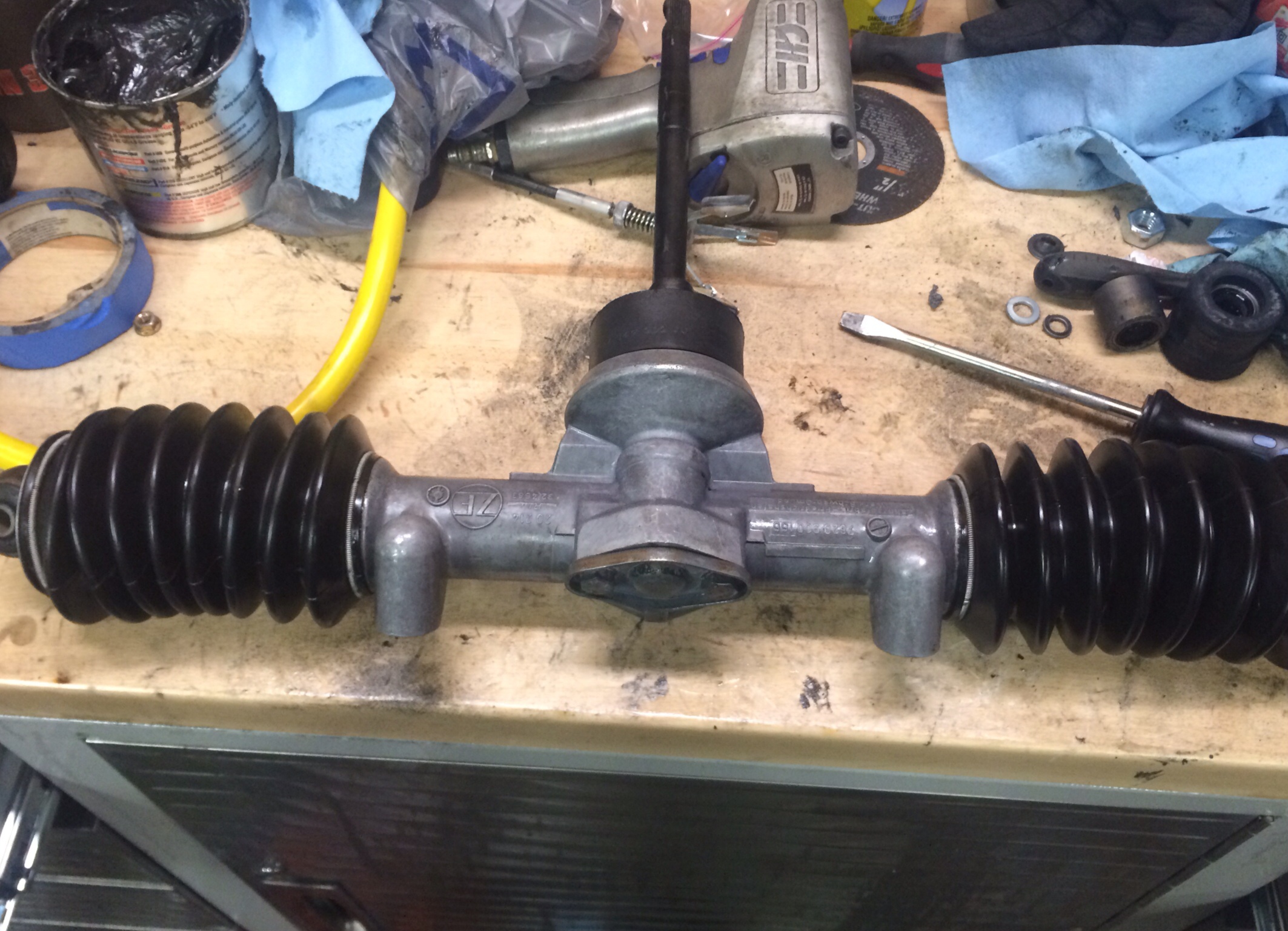

I rebuilt the steering rack while frustrated. Bead-blasted the case then re-greased everything. Looks awesome now.

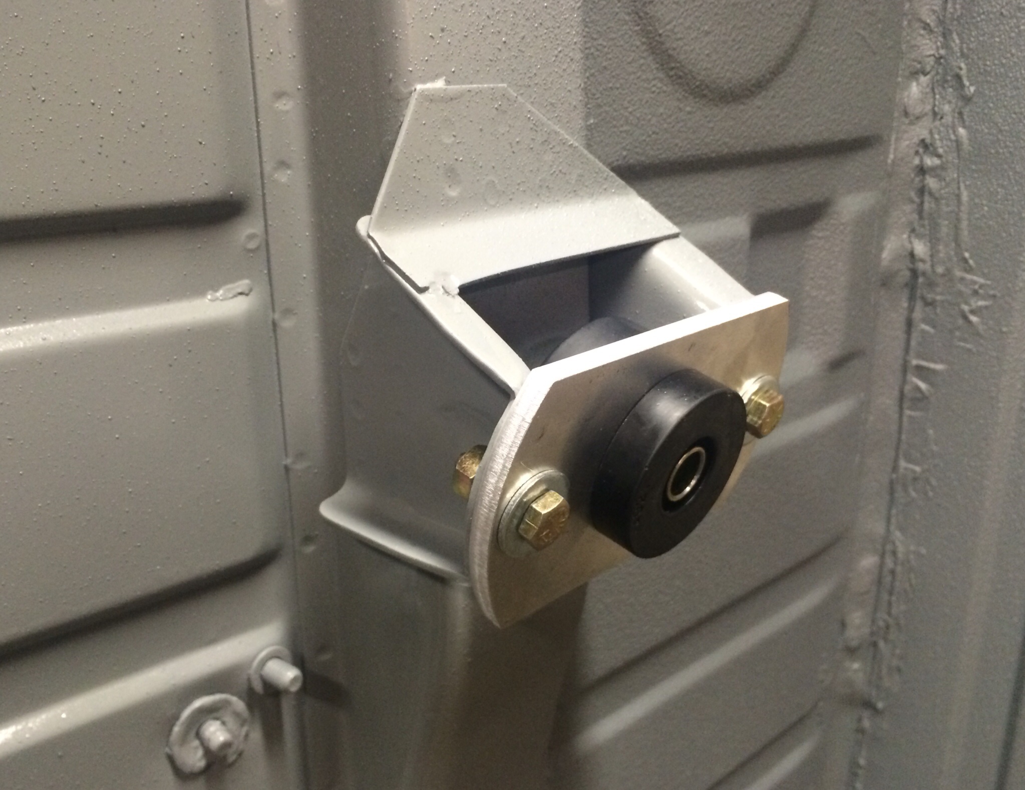

I also put Ian's cradle and mounts in. They're awesome.

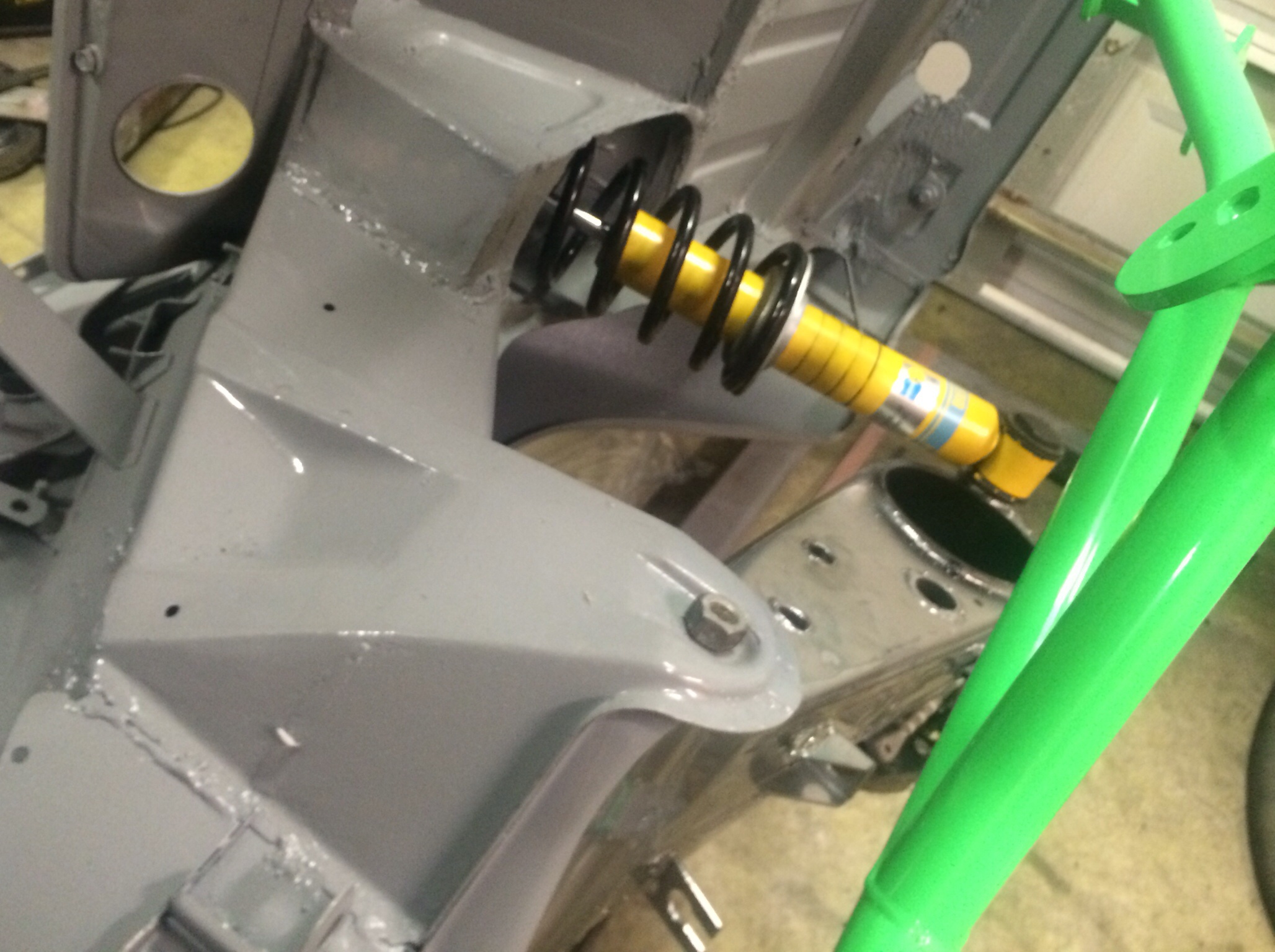

Got the entire suspension installed and ready. I still need to hook up the e-brake before I put the rear hubs on. Just want to make sure it's 100% before I press them.
Had the front suspension on/off 4 times. The bushings were too tight, and then when I finally had it right, I realized I hadn't put the 930 tie rods on. Then I did that and after I got it all back on, realized I forgot the steering rack bearing and boot. So...that was the 5th time. Ugh. I burnt 4h on stupidity.

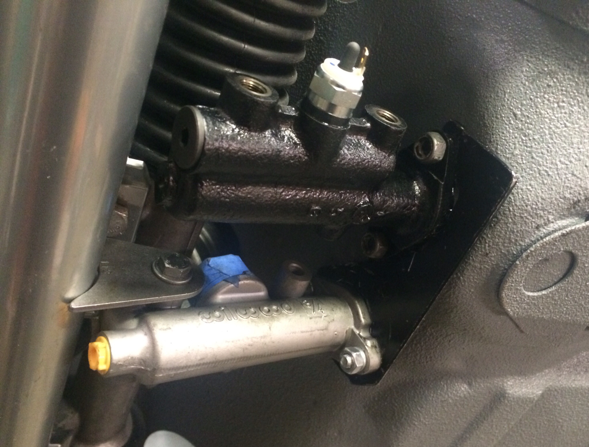

Installed the master cyl and the hydronic clutch stuff. I'm not sure I have it right yet, so I'll re-visit that soon.

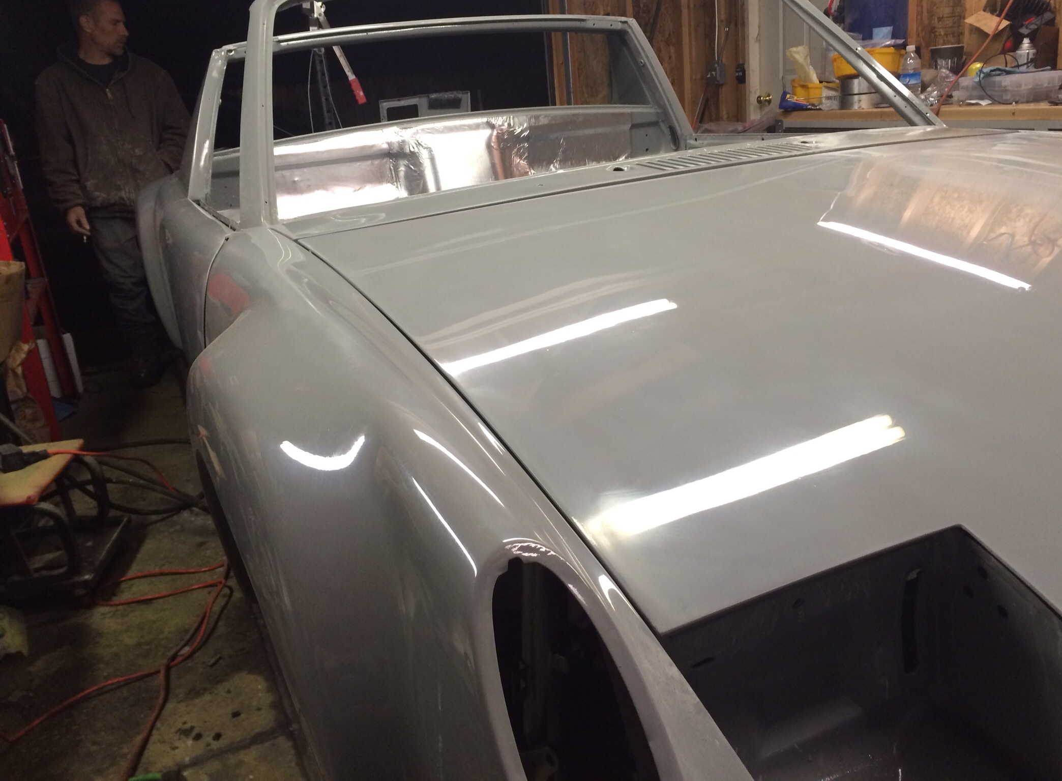

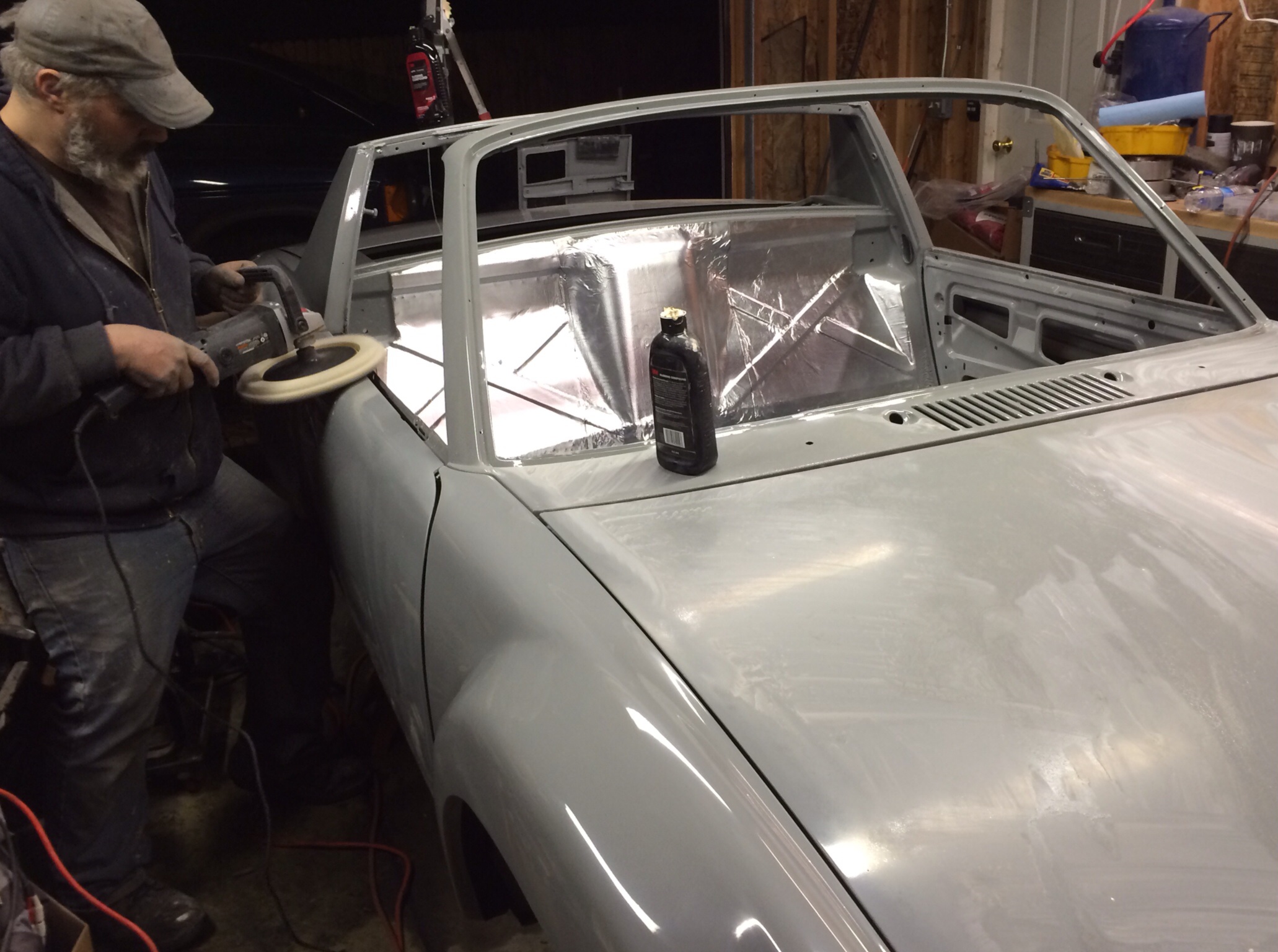

Dan and his brother Doug stopped by with the doors and hoods tonight. They're hard at work sanding and buffing while I'm putting DynaMat in the interior. It's starting to look amazing. I'm real happy with the body.

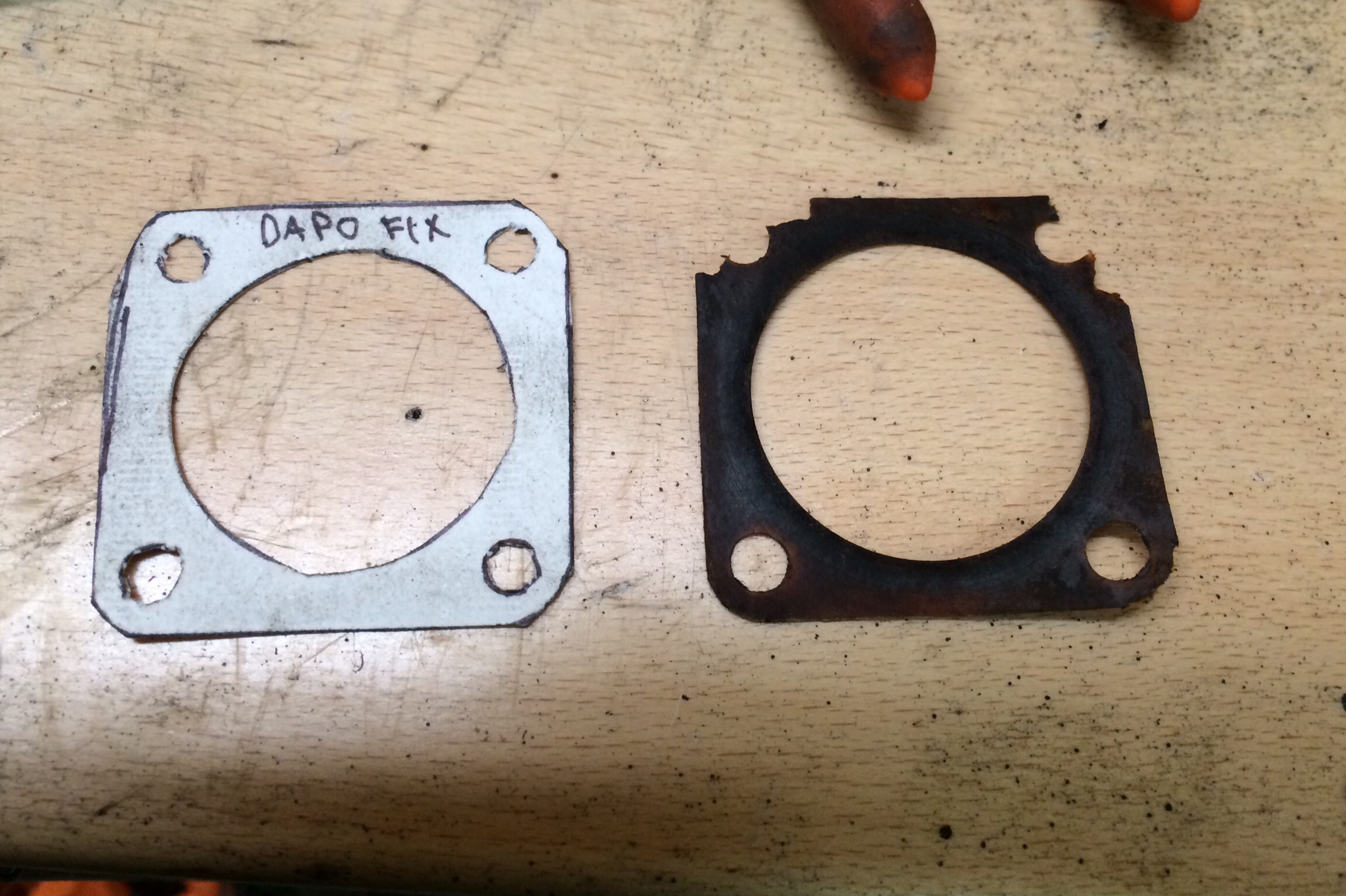

The rear proportioning valve is a huge pita to put back together. I took it all apart and cleaned the gunk out. Made up a gasket out of an old pack of cigarettes, and left a note for the next guy. Now I need to get it in a vice to put it back together.

Dan and Doug (Dan's brother) came over last night to finish wet-sanding and buffing everything. They're doing a great job. I MAY have the car sprayed one more time, and then clear-coated, but I'll make that determination after they are done, and before I put all the rubber seals in everything. It's single-stage paint that can be cleared, so I can go either way. I really don't want to do it after the seals are in place though. That never works out well.

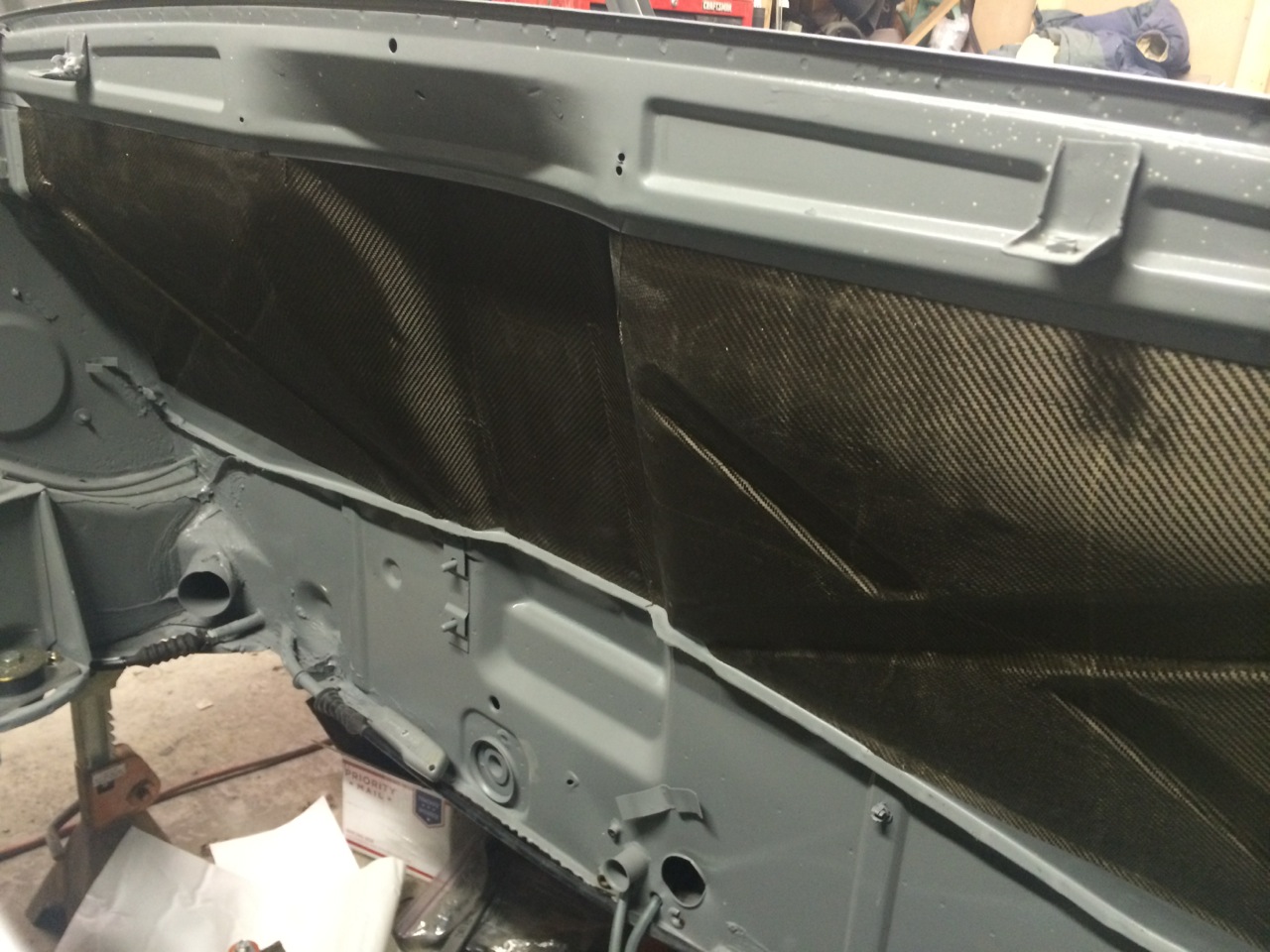

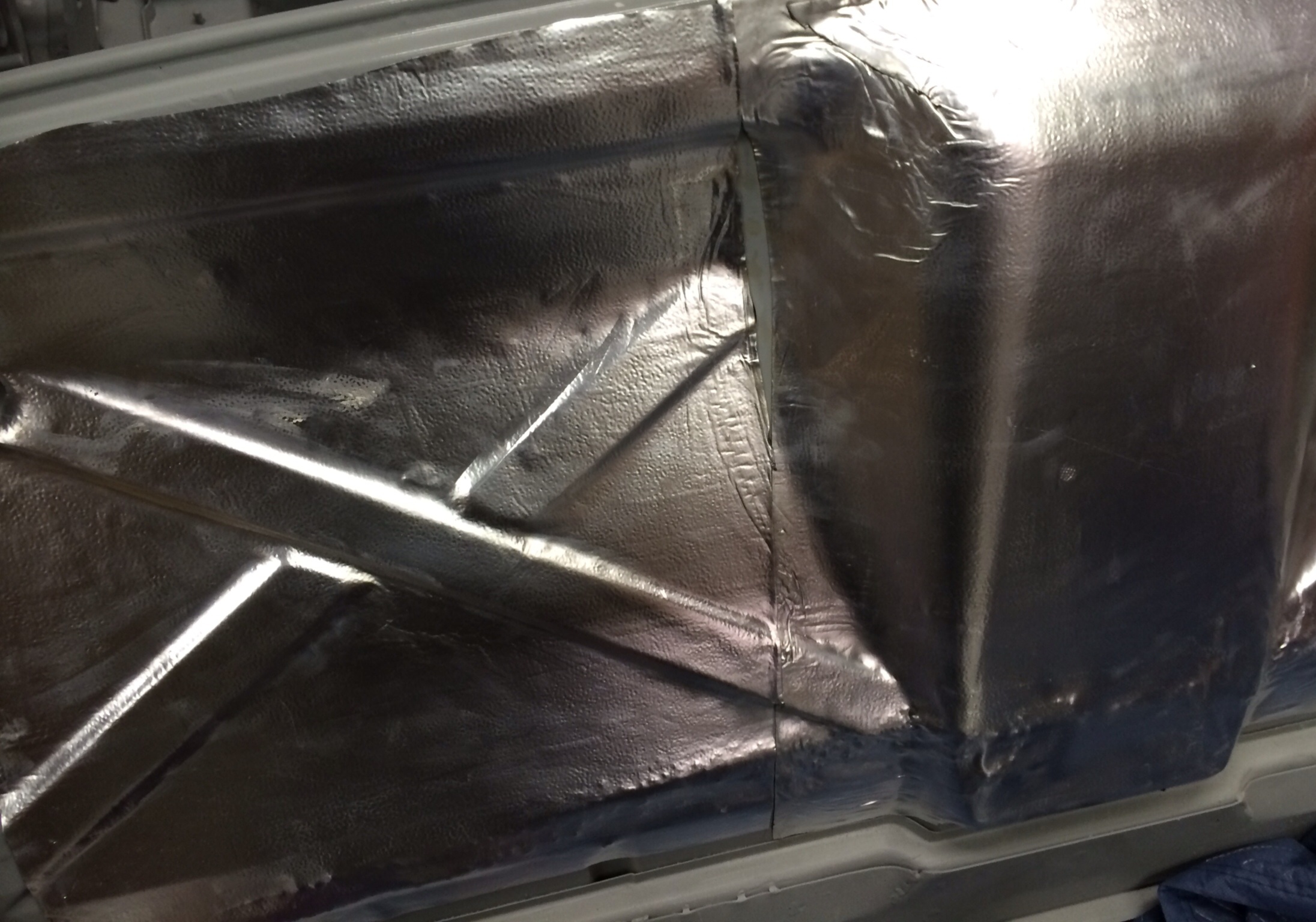

I installed Lava Mat on the back of the firewall to a: help with heat and b: look bad-ass. I still need to do the lower section, but the temperature in the garage was dropping and this stuff gets harder to work with when it's cold. Getting it worked into all the contours is important.
Here's a link to the stuff I got. The 4' X 5' piece may be a little big, but I'm planning on using it in the cabin if I can to help with heat from the radiator tubes
Amazon: Lava Mat

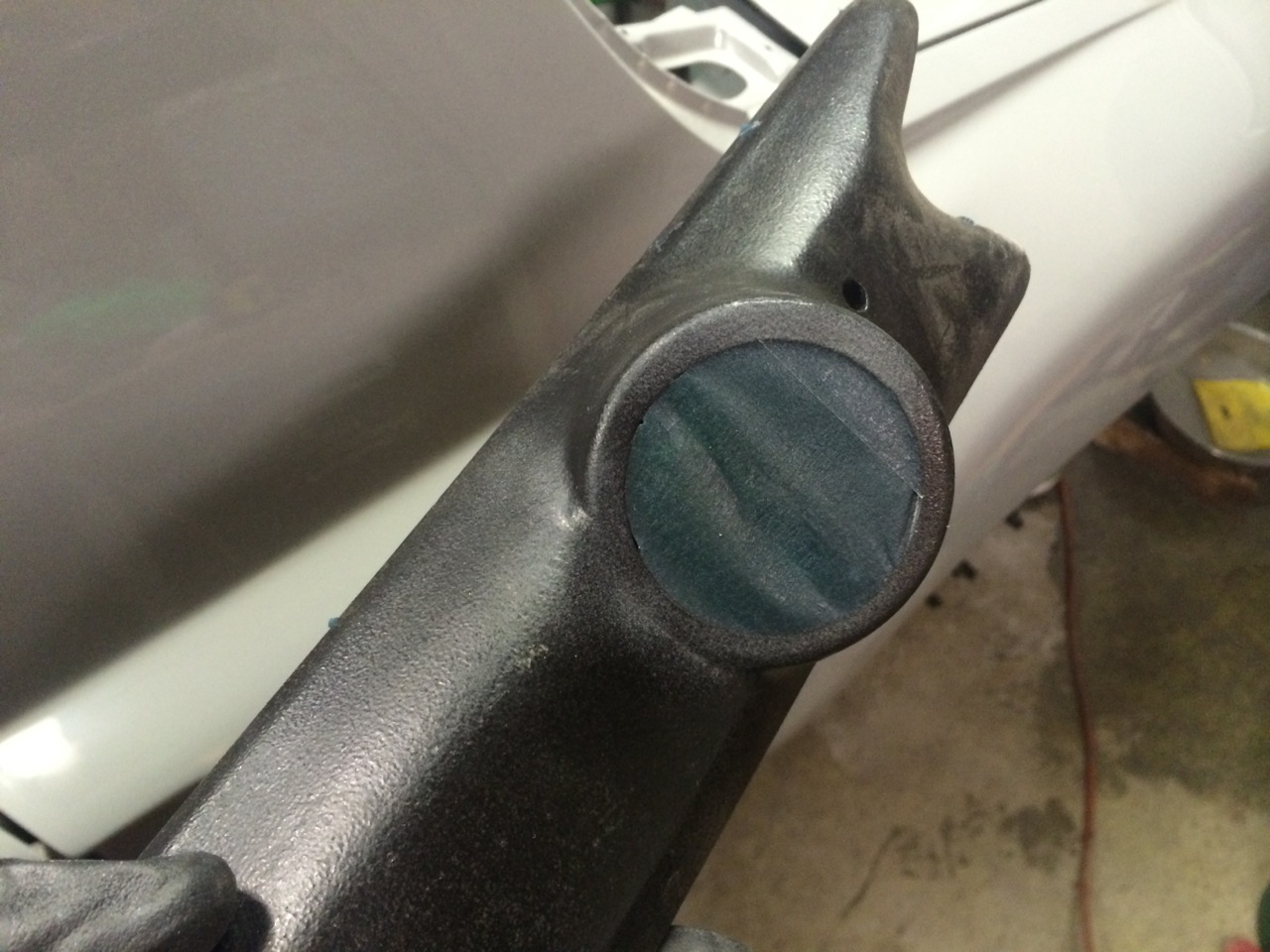

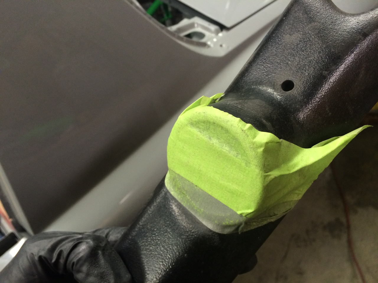

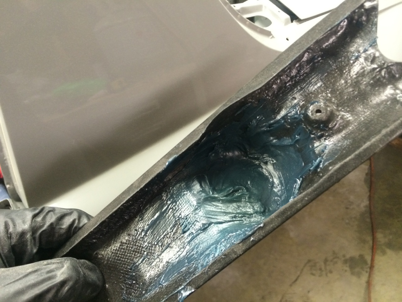

I also did the FG work on the speaker pods for the pillars. The holes were a bit too big for the separates I have, so I closed up the holes, and I'll re-drill and then cover in Alcantara.

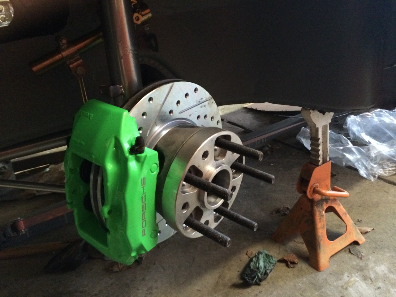

I did a bunch of other stuff like blasting the slave cyl for the clutch, found all the locks and installed them in the trunks and deck-lid, installed the e-brake cables and checked all of that out, then I put the hubs on the front and back. I think I'm a little too long on the front studs. I'll deal with that later I guess.
Last thing I did was get the brakes started. Picked up a BUNCH of brakeline, and I'm mapping it all out. I put the hubs on, and placed one of the calipers...just to see what it looked like.

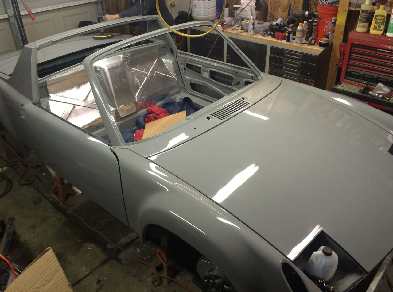

One last pic to show what she looks like all shined up!

Keep both hands on the tool, and dont remove the guard. Same thing with a zip wheel. Just lucky it didnt go further in the nail.
