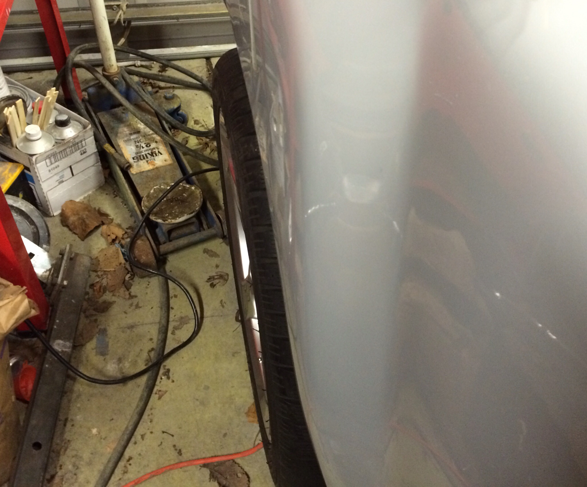

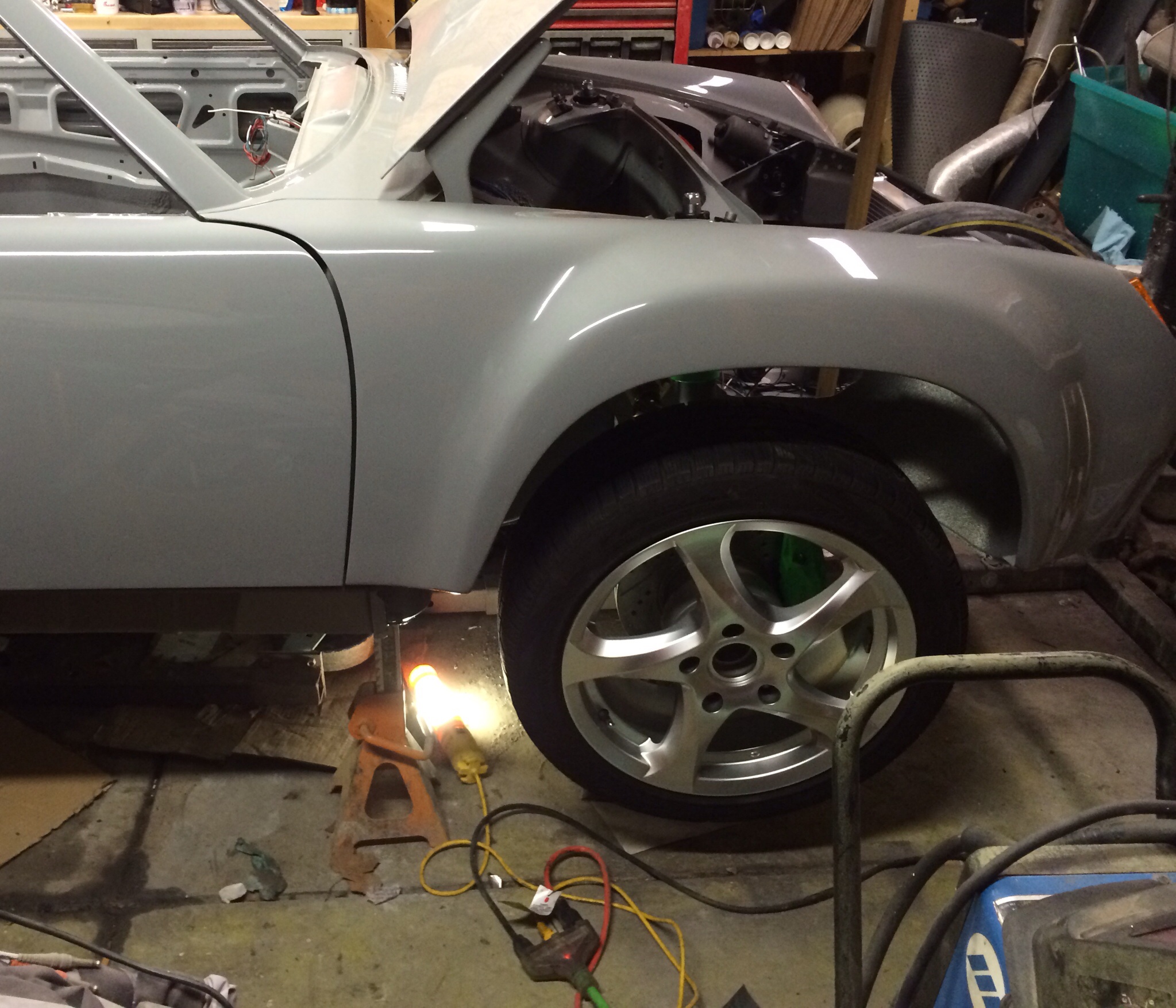

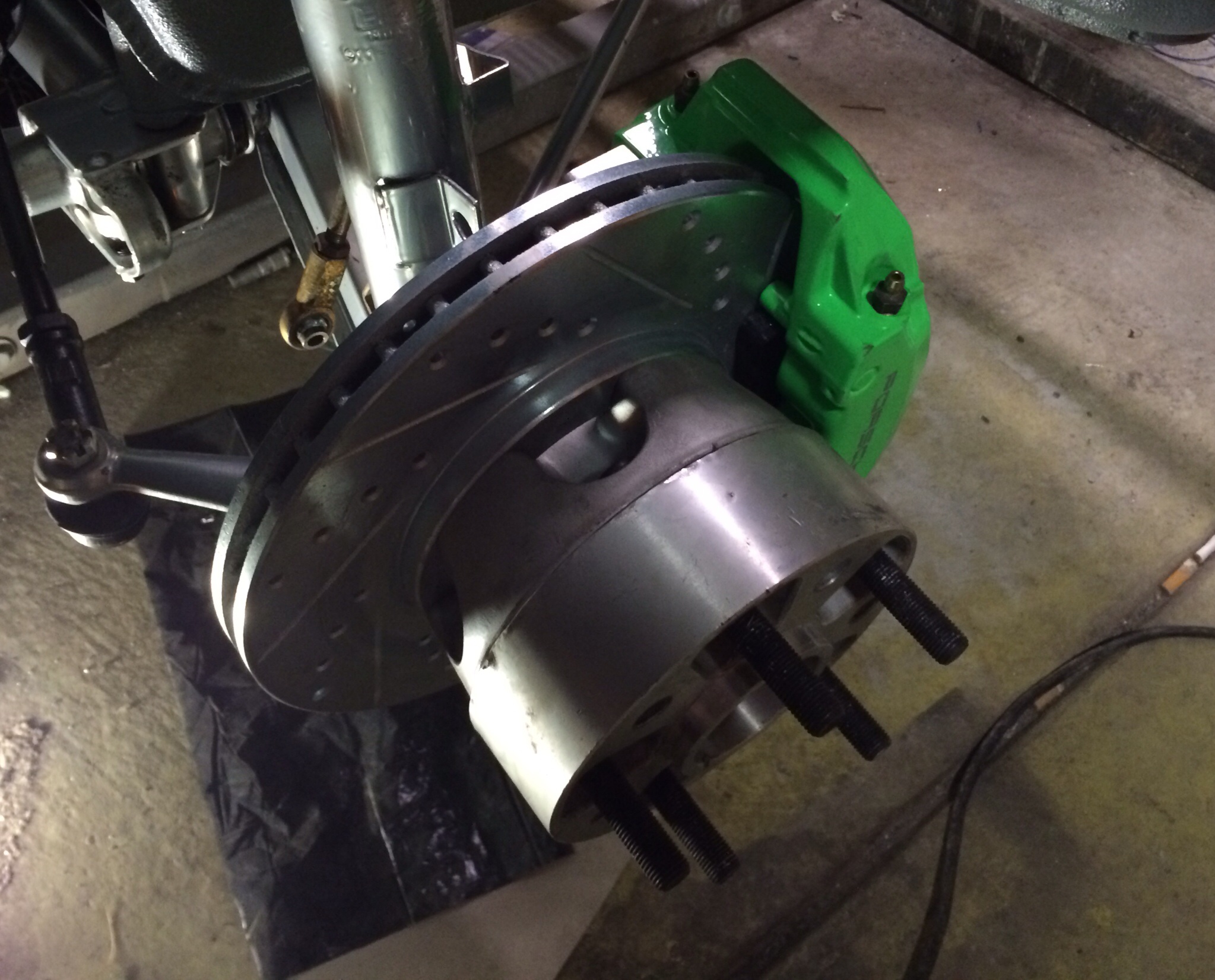

The 5mm spacers came in from PM so I was able to get the back hubs, disks, calipers, and CVs installed. Tried the wheels on for size and realized the following:
A: 2" spacers in the rear are too much.
B: 1" spacers may be just right
C: I have a lot of negative camber in the front.
So now I'm 2" up front, 1" in the rear, and looking to replace these 100mm studs I bought! (Or at least put spikes on the end.)

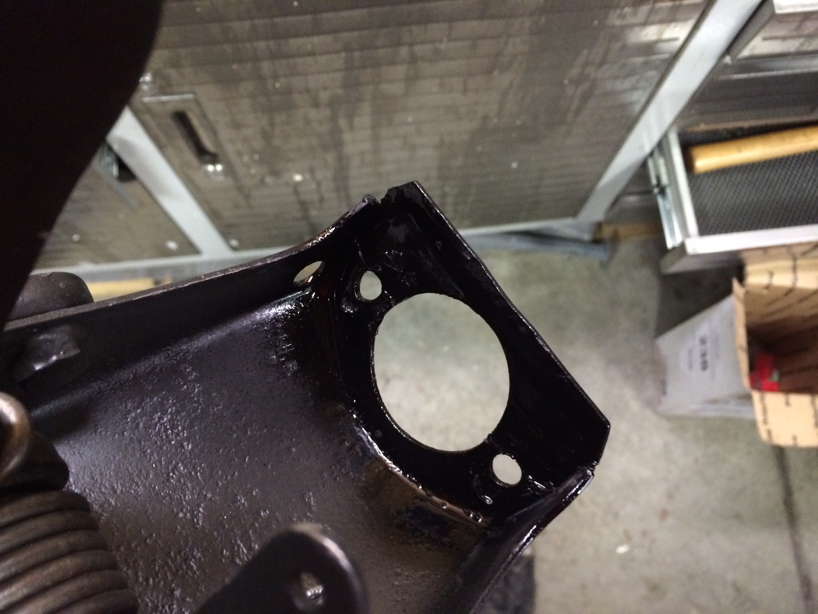

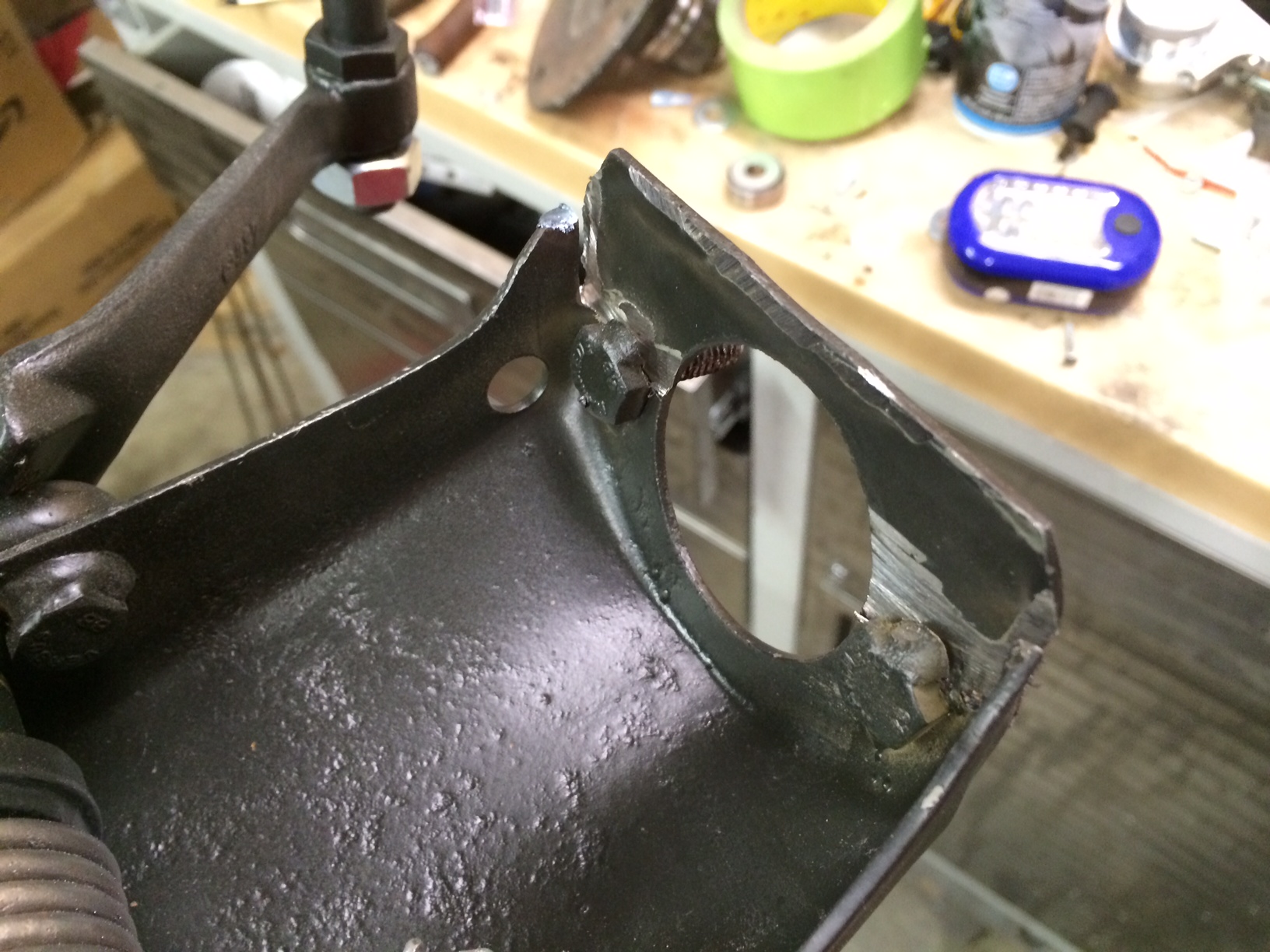

The pedal cluster bolts weren't really long enough for me to get a good grip on everything after the Raptor Liner was sprayed on, and the plate for the clutch slave plate was installed, so I needed to make a few adjustments. I tool a cut-wheel and got rid of the captive bolts that were in place. Then welded up the cuts, ground them down, and re-painted it. I just left the 2 holes. I'll use bolts that are about 1cm longer so I can get the threads on and feel comfortable with the safety of it all.

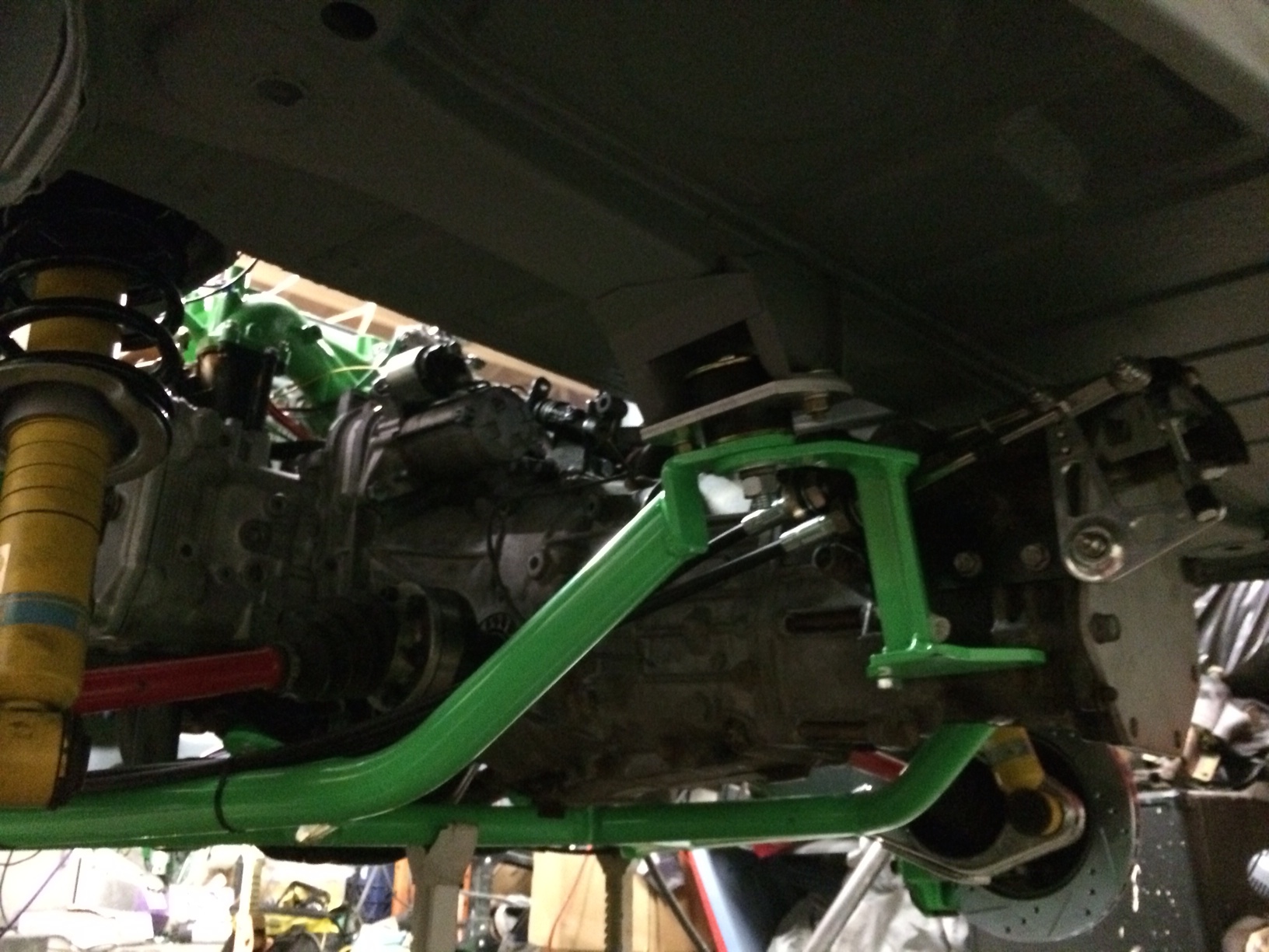

I also forgot to add the CV joint gaskets, so I had to pull everything off and re-do those too. After buttoning everything up...again...I realized that I may need spacers between the trans and the magic flanges. HOPEFULLY I can just pull the flanges, but I may not have enough travel available for that, so I'll need to pull the drive-half of the CVs off again before I get on the road. It's starting to look like a proper car from behind though!
The exhaust is going to be trickier. The divorced down-pipe I have drops just a LITTLE too low for me to weld the can directly to. There's also the question of how I'm going to orient it. The thinking right now is that I'll cut a 2" section out where the bung for an O2 sensor was, and use that for my wideband, and then weld the exhaust to that. I'll have to curve around the engine cradle and leave myself enough room to still get to the cradle bolts if needed. In reality though, I shouldn't need to pull the engine without taking the exhaust off. It's only 3 bolts and it'll come out in one piece.
can you send me some measurements on how far the shifting stuff sticks out behind the transmission? I need to get some data to start fab work.
