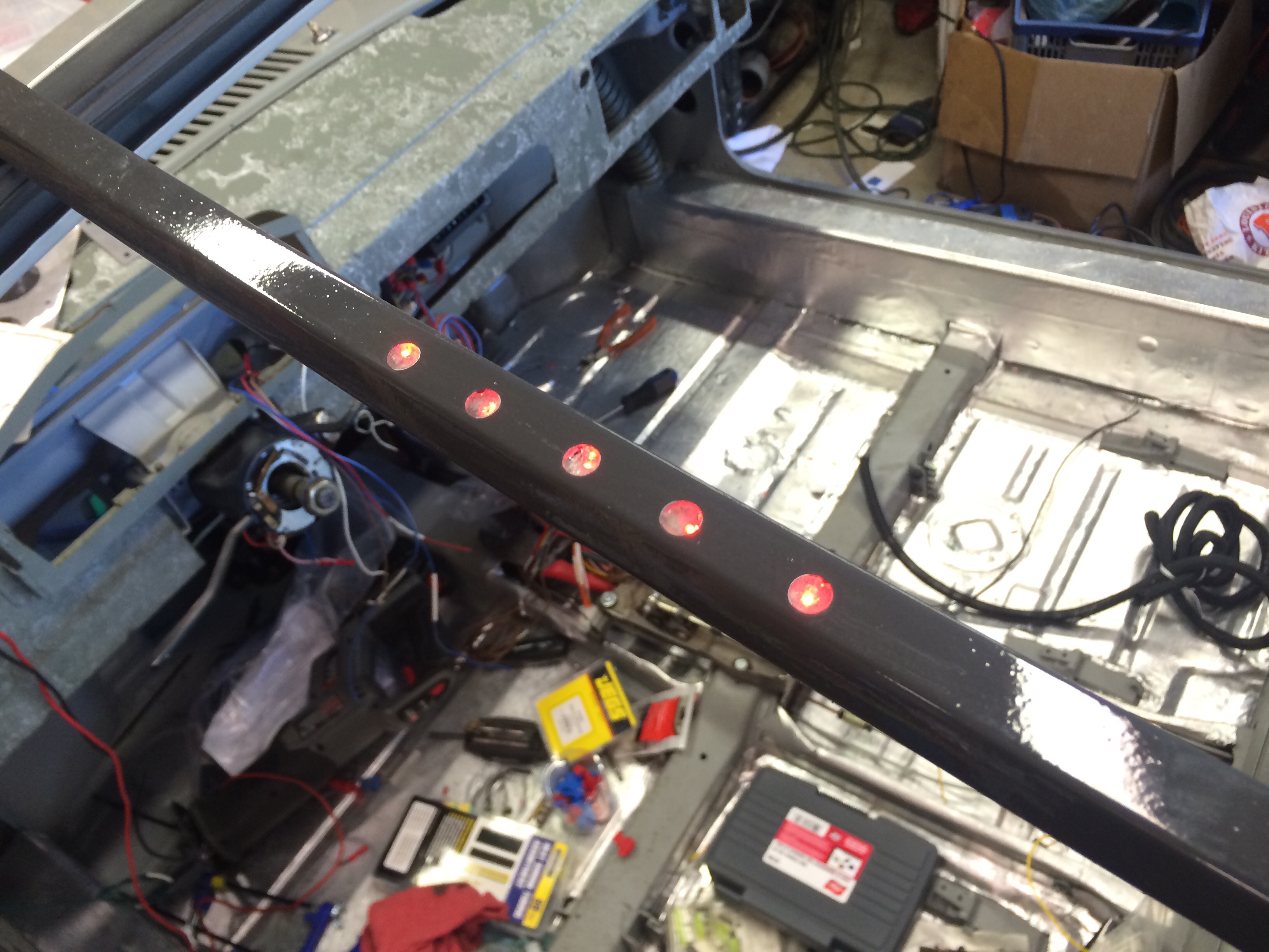

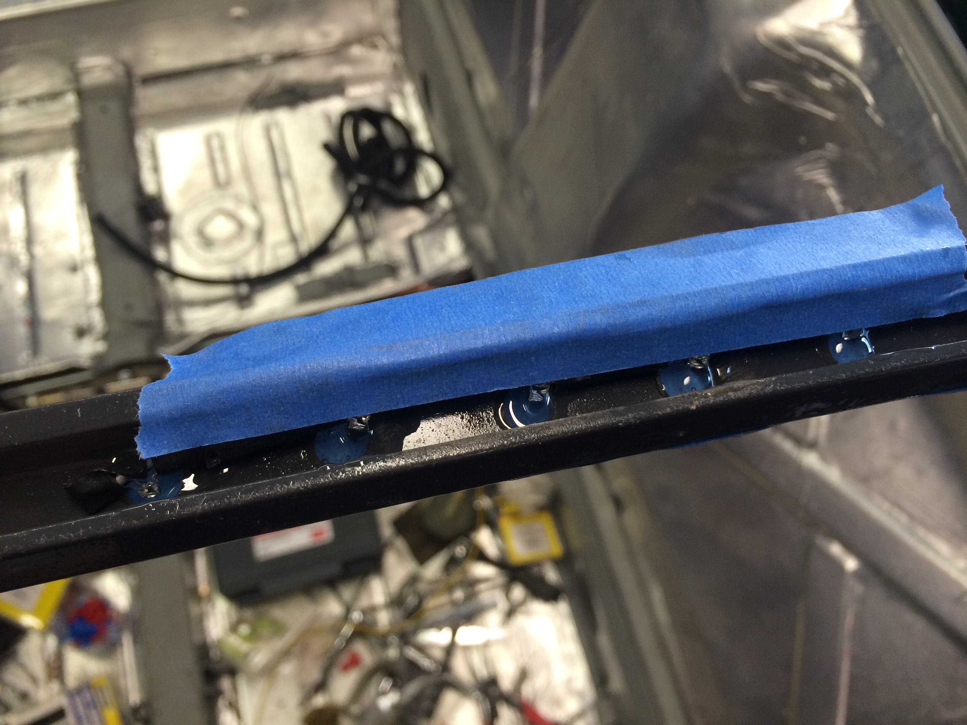

Did my 3rd brake light this am, by drilling holes in the back bar, taping off the holes, adding a clear epoxy and inserting LED lights. It's pretty bright, and doesn't detract at all from the lines of the car.

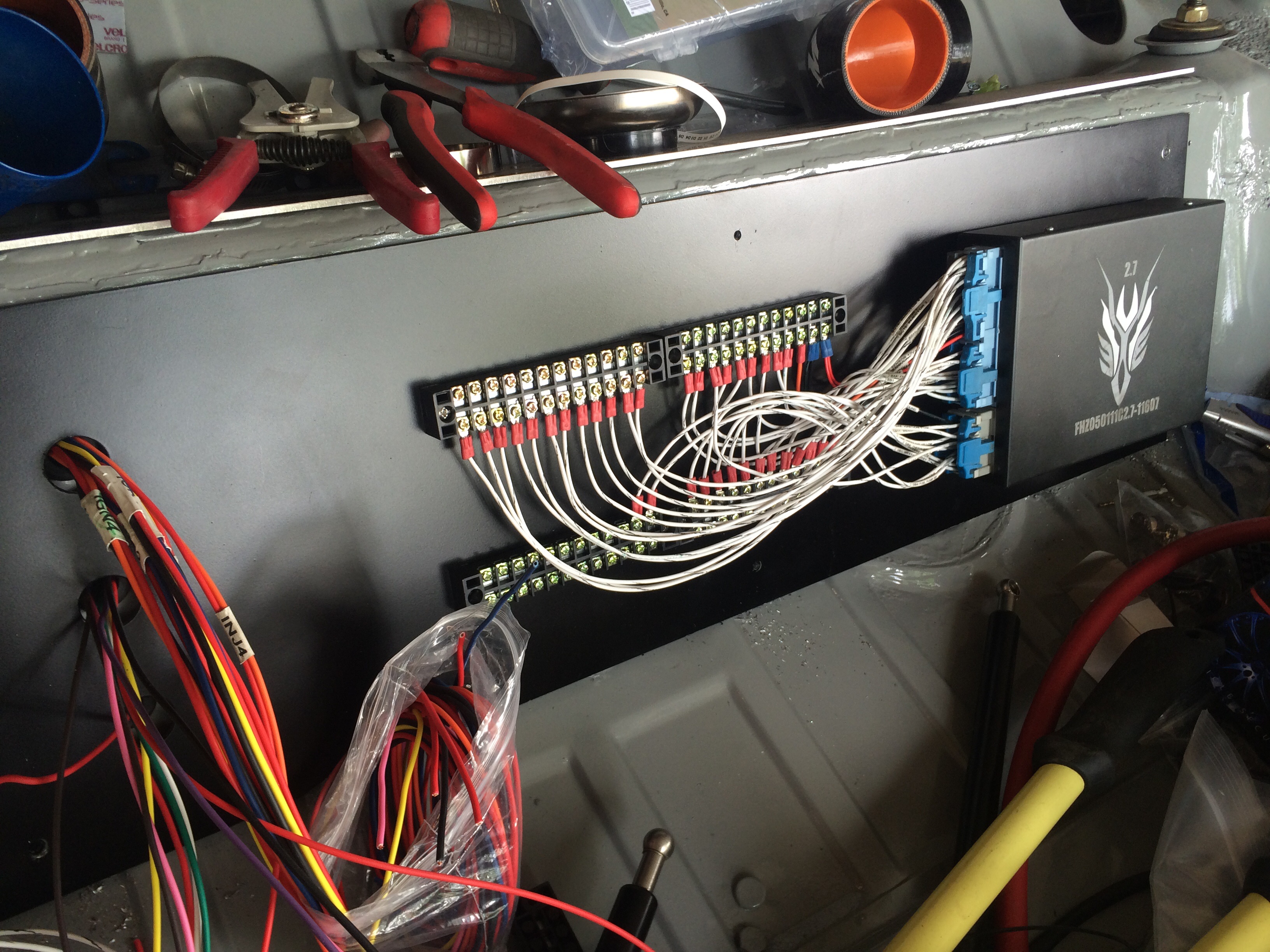

Spent all night on wiring. Then I ran out of crimp ends. I have all the wires installed on the engine and marked off where they go on the Hydra blocks, so I'll have that wrapped up later today.

Looking at that pic, I should clean those up a bit to make things easier down the line. An extra hour on this side will make for a more refined look down the line.
I just picked up 6 3/4" spacers to raise the panel off of the wall a little bit. That'll give the wire more room too. I was hoping to get a 8-10" service loop behind it to make moving the panel a little easier too.
So I *should* be all the way wired later tonight. Still pondering the intercooler stuff here and there. I think I have a plan now. Need to dry-fit it first though.
