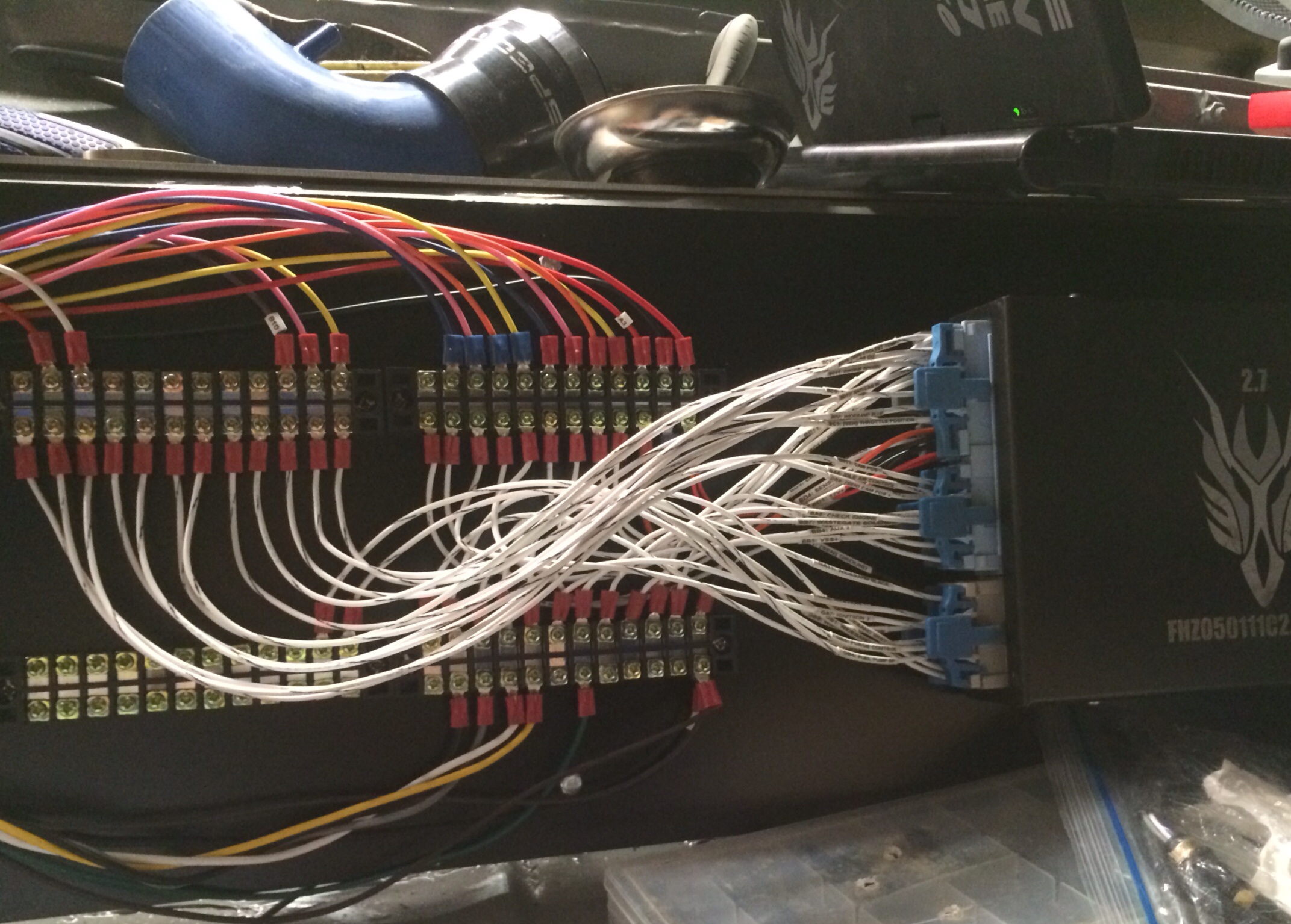

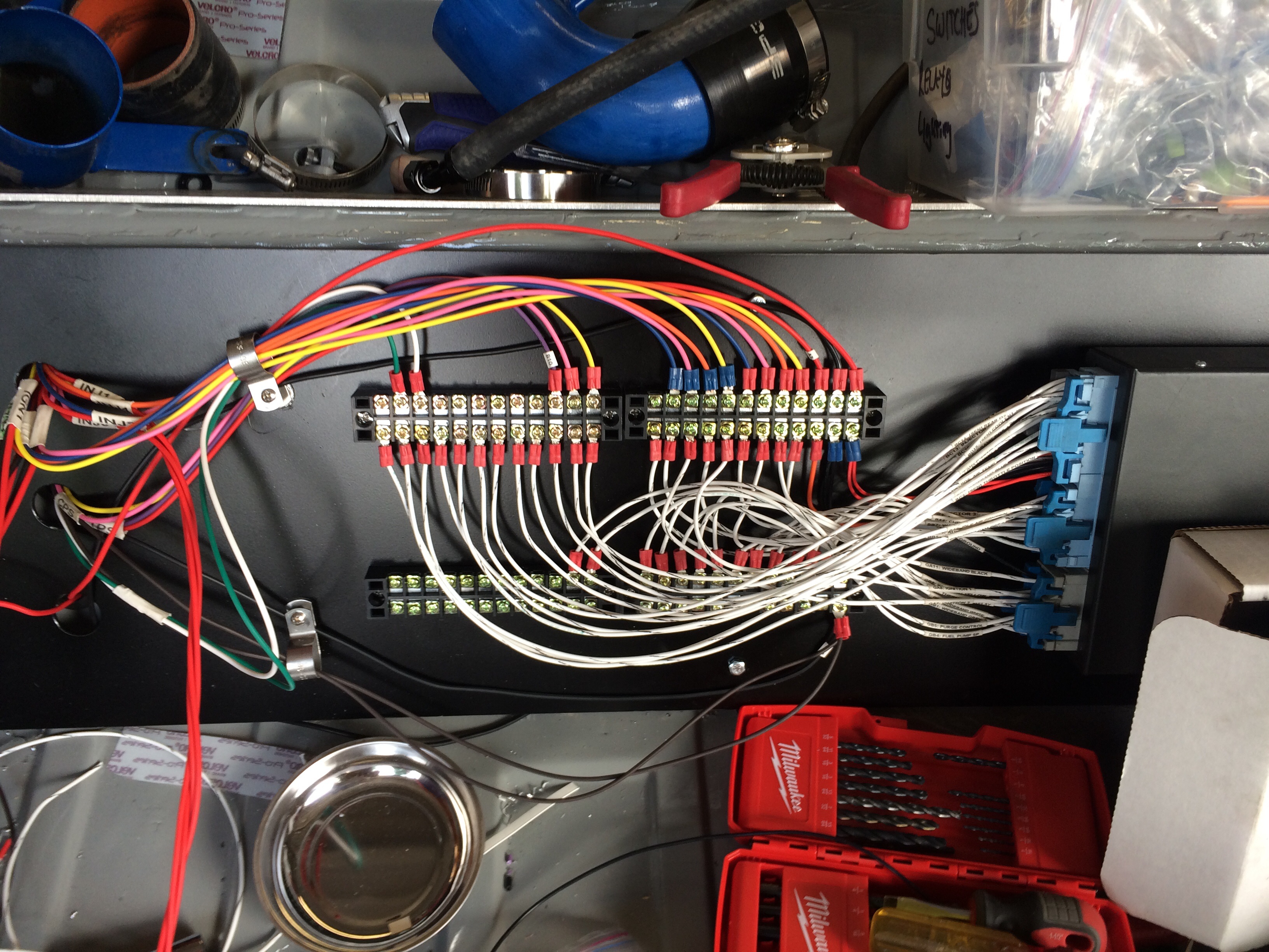

Wiring for the engine is complete. Except for the ignition coil pack relays for power. Working on the boost solenoid and fuel system tonight after the kids go to bed.
Here's what it looks like now.

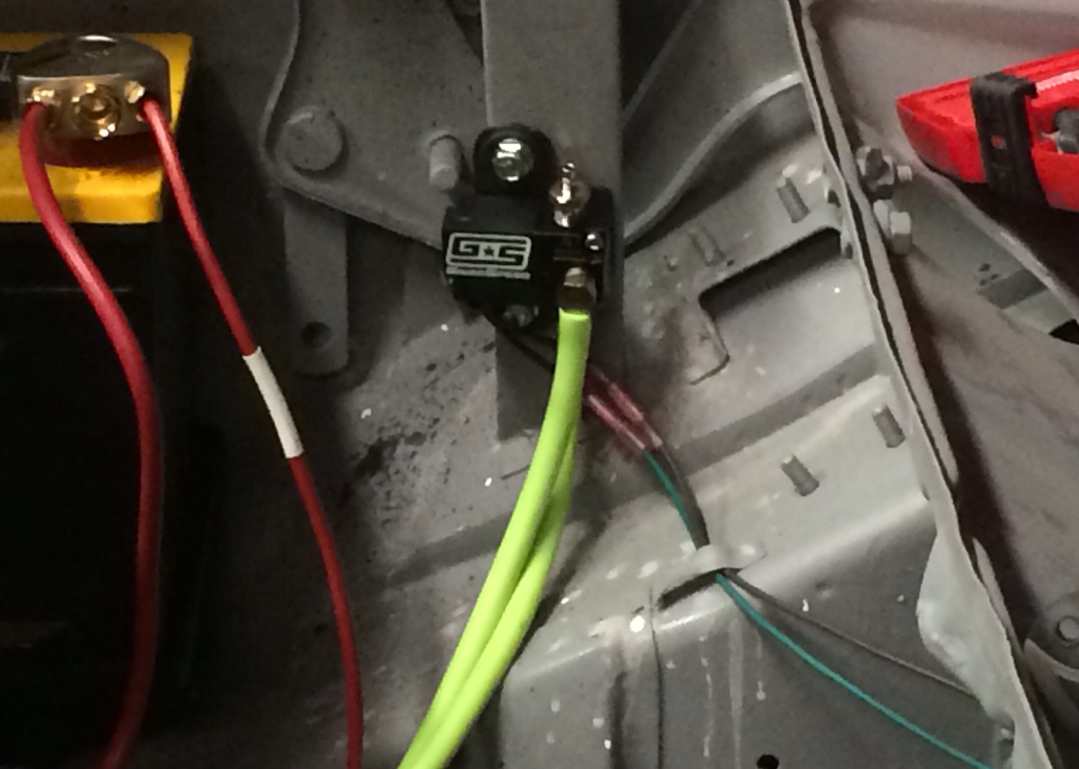

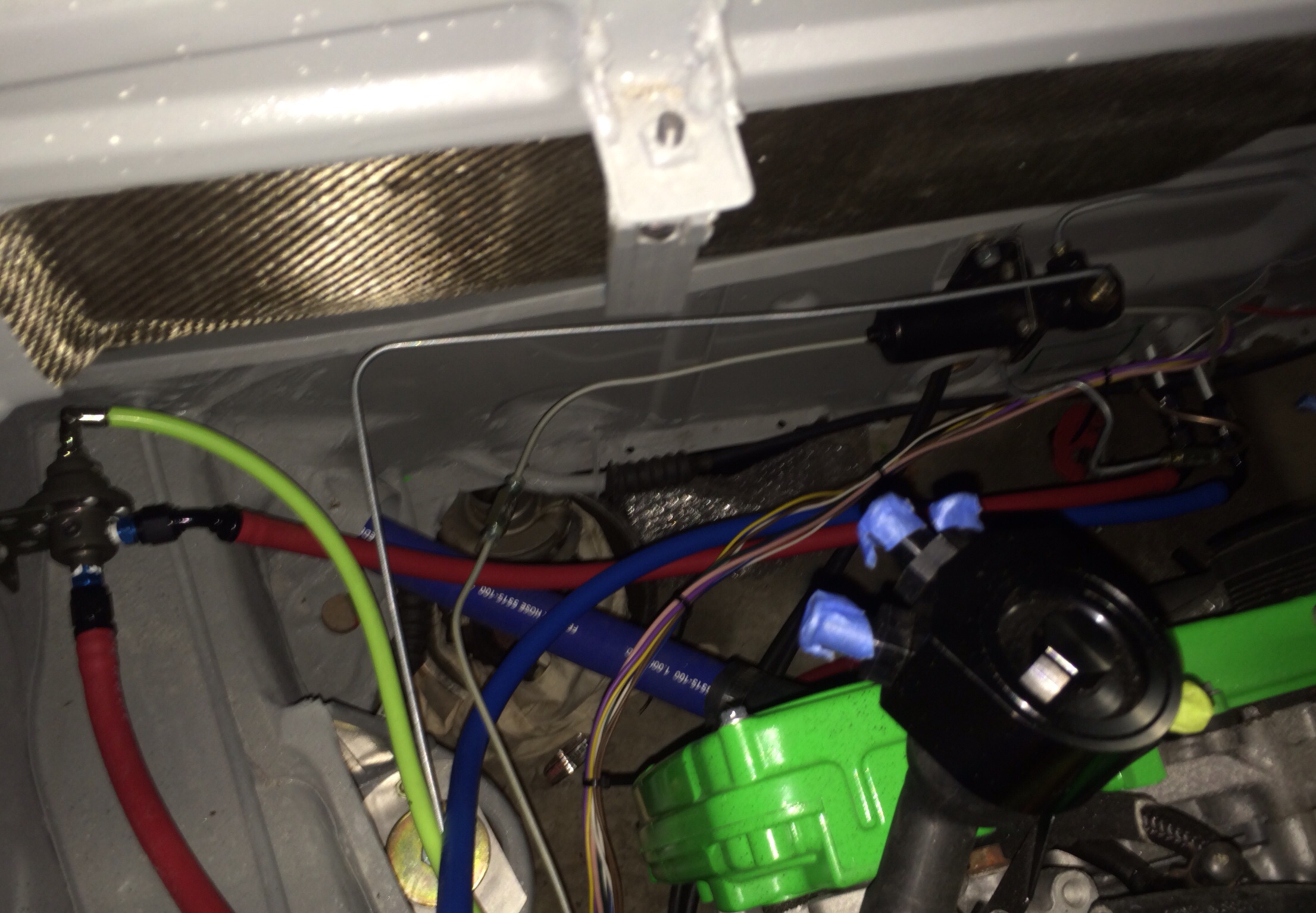

Got a shit ton done tonight.
Fuel system: Complete (tank to rails to pressure reg...good to go!)
Hydra Wiring: Complete (just need to connect the wide-band at the exhaust)
Boost Solenoid: Complete (wired and vac lines run)
Throttle Cable: Complete (had to build a custom cable mount)
Starter Relay: Complete (it turns over and everything!)

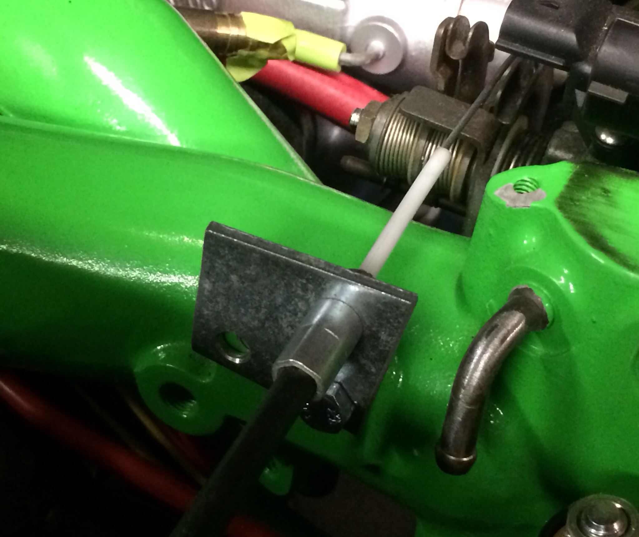

I'm still a little stuck on the throttle and how to connect it to the stock (new) 914 cable. The subaru uses a lug at the end, and the 914 has the pressure-pole-thingy. Right now, just putting it in there holds just fine. I just want to make sure it's solid.
Any ideas?

QUOTE(CptTripps @ May 28 2014, 11:15 PM) *
Any ideas?
Not sure what each end looks like. Got some pics?
BTW, great progress! Lookin' pretty sweet.

I'm also worried that the roll-pins I have aren't substantial enough, and that I need a washer or spacer of some kind behind the Magic Flanges I have. I remember someone saying I needed something there, but I can't find the email/pm/thread that talked about it.
Update: Found it -> http://www.914world.com/bbs2/index.php?showtopic=115804
Anyone know where I can get a set of the rings/washer things I need?
Just going through my list of "last-min" stuff before I fill the trans with fluid in preparation for "go time" next week. (IMG:style_emoticons/default/driving.gif)

Here you go Doug. This is from the horses (Steve aka Porcharu) mouth.
I used all my pipe up on another project. It's 1" pipe schedule 10, fits perfect. I actually think this spacer is not needed as the aftermarket axles have long splines and just let the CV slide around, but if you can get the pipe and cut 4mm slices I would do it.
Steve

Spent about 2h in the garage last night running the accelerator cable to the pedal, and contemplating the air/water intercooler setup. The others I've seen have flopped the intake and moved the radiator. I don't think this is an option for me, as I've got a lot of other custom stuff up there that'll prohibit the move. So I need some tight radiuses and maybe a different can for the intercooler.
Off to the interwebs to find a better can for my application.
