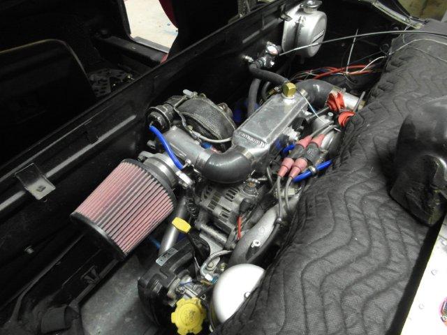

Hitting it HARD today. Getting somewhere too!
Moved the ECU and all that pretty wiring I did. Need room for the intercooler! I bought a bunch of 2.5" pipe and bends. Then started cutting.
I also figured out where to mount the radiator. Should be perfect, but the water pump may be tough. Gotta play with that a but yet.

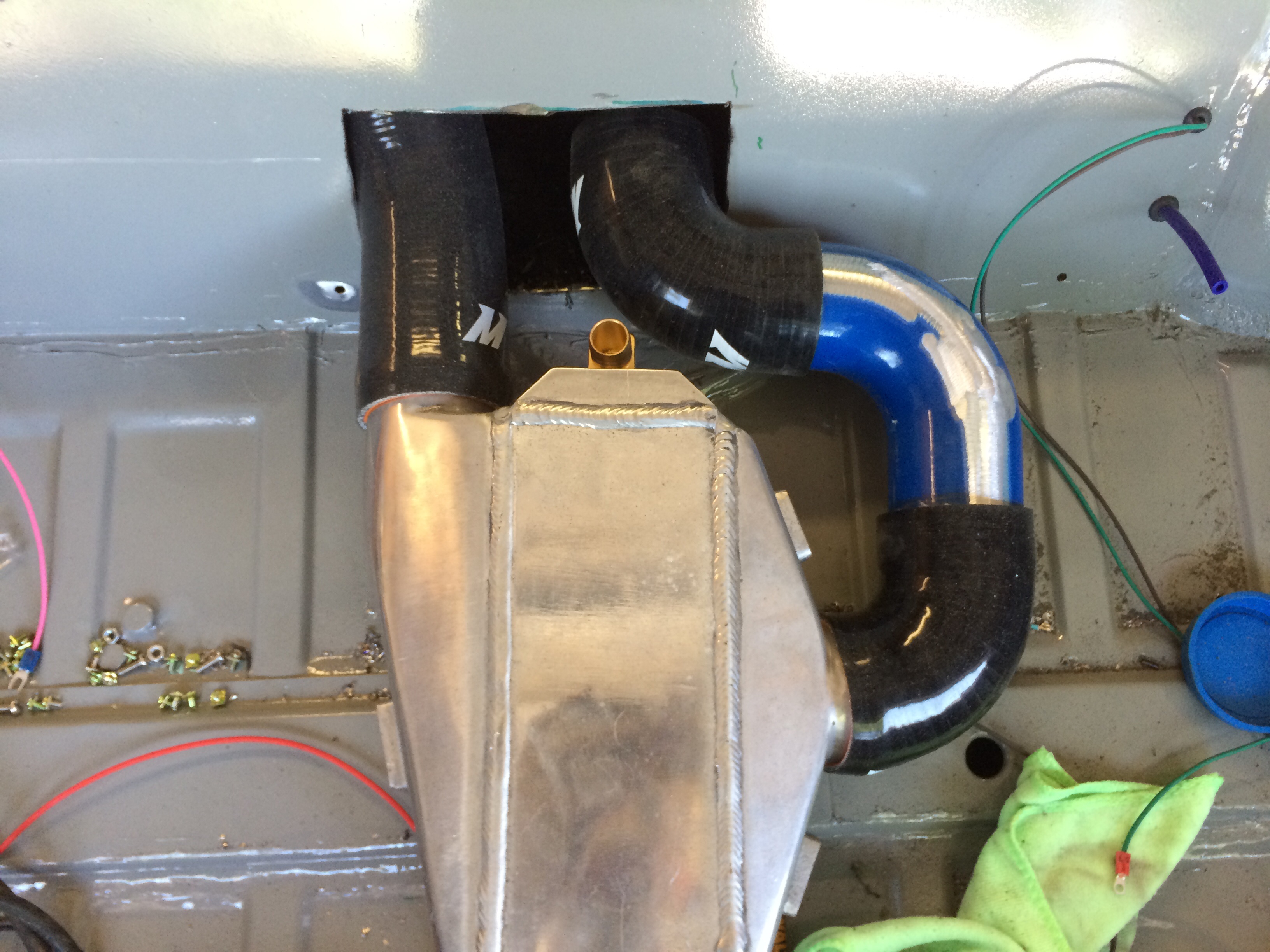

Here's the pipe I fabricated. So I have the intake covered. Now for the turbo output. Hmmm.

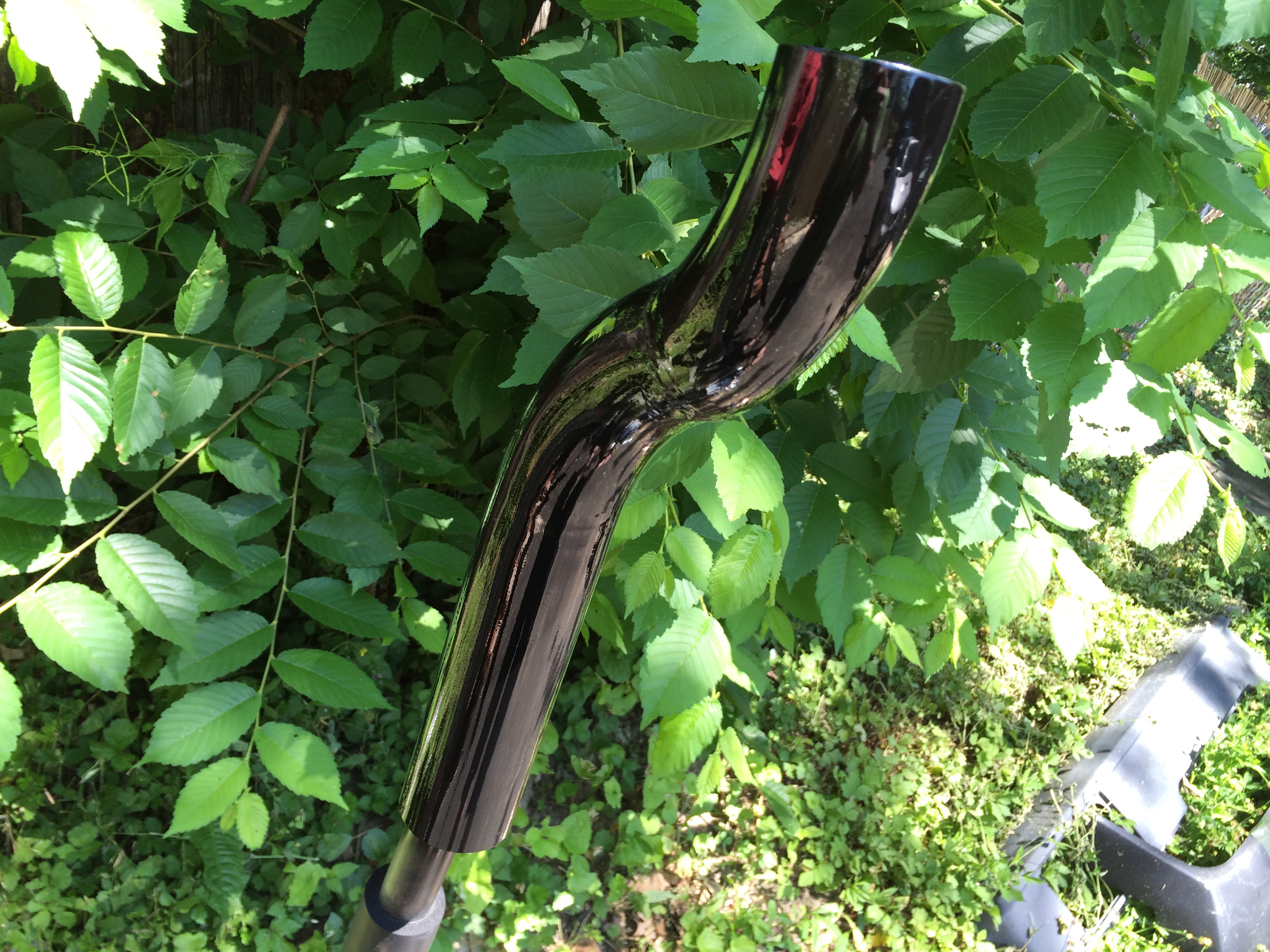

Got it!

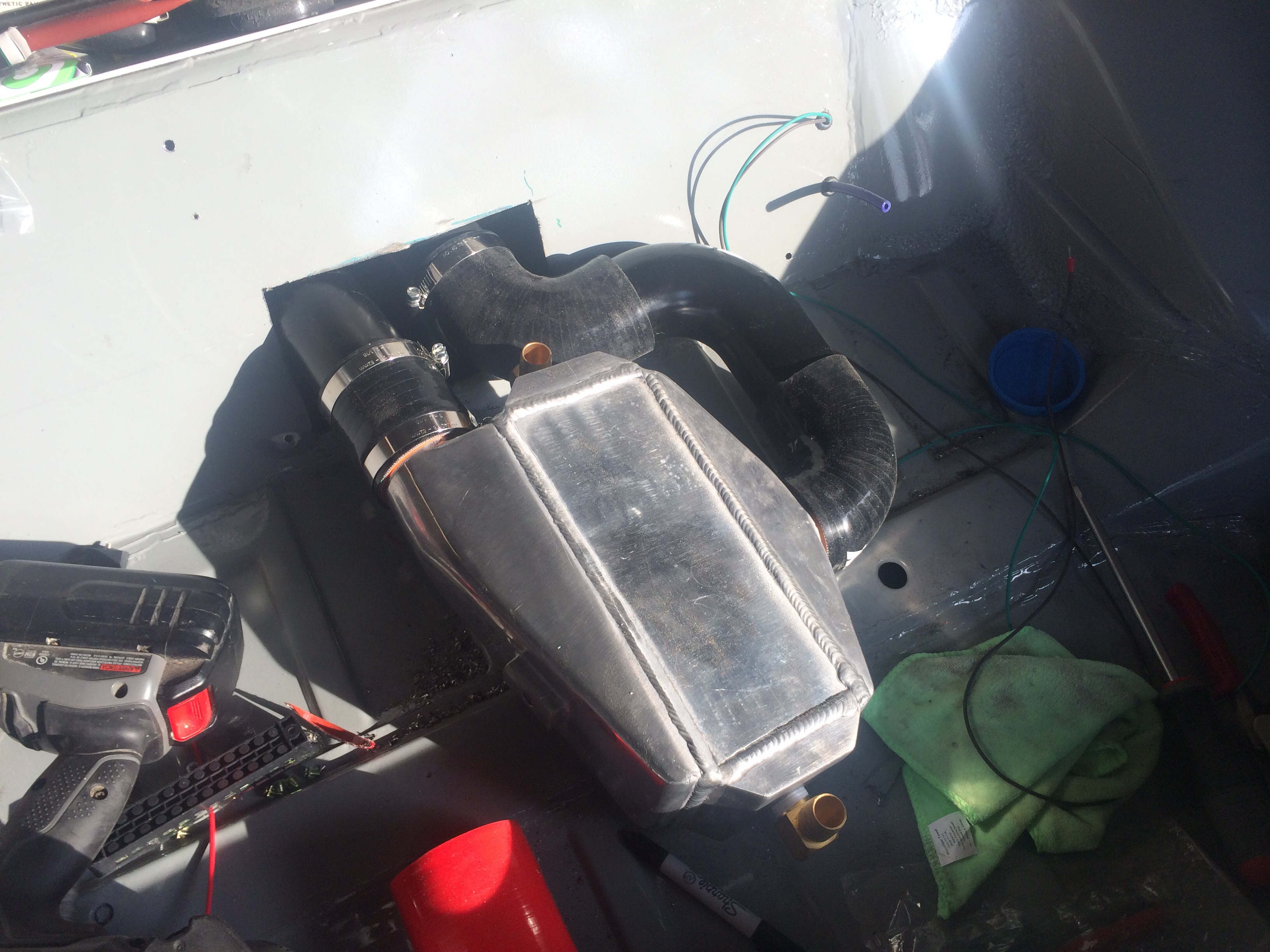

Here's how I'm thinking I route the filler for the intercooler. Since I need to fill at the highest point, I'm thinking here is a good place to start. This will let me mount the pump under the car and not have to worry about it getting choked up with air. (In theory anyway.)
I'll be routing the tubing inside the trunk compartment so the lines don't get too hot by being next to the exhaust. Really the only way I CAN do it. So I guess my thoughts of a waterless trunk are kinda out the window. I'm going to have to make up a plate on risers for the ECU and wiring too then. Maybe a double-stack kinda configuration. That'll limit my ability to monkey with the wiring if I ever need to, but I could likely do it where with 4 wingnuts, I'm in good shape. Who knows...I'll have to get in there and see what's possible after I get the radiator mounted and plumbed.
This is a royal PITA, and I hope I only have to do it once. I'm really looking forward to my FactoryFive 818 build this winter. Having a mid-engined car with INSTRUCTIONS will take a lot of the "How in the f%@k am I going to engineer this?" out of the equation.

Don't forget there will be a big bubble of air inside the intercooler. This will be above the level of the pipe fitting. Leave it loose so you can lift one end after filling with water. The pump alone will not be able to get the bubble out.

Already planning on it. I think I have a plan for that.
