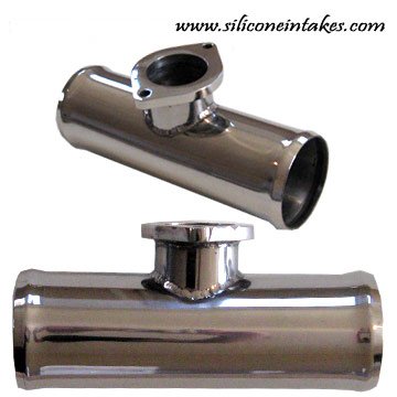

Ordered this today for $25 from Amazon. I can shorten it a bit and put it wherever I want. This should be perfect.

QUOTE(CptTripps @ Aug 7 2014, 03:54 PM) *
You might want to leave it as is. The humps will help you from hoses blowing off. Make sure you get quality T clamps and hoses. My old TDI ran 45 PSI boast levels, I had to change all my intercooler piping from the turbo on out. All joints had 12" of slip and double T clamps on each side and that finally solved my constant issue of tubes blowing out of the silicone connector hoses.
You shouldn't see that kind of boast range with your little gas engine, but it is the point that these things do leak, and air will find or create a least restrictive pass to atmosphere. It really does not like being compressed, shoved down a series of pipes, chilled, and then burnt. If air molecules have feelings this would be like their own personal trip to hell. I would try to form a revolt, and find the weakness in my prisons defenses and escape also.

The part I ordered isn't going to cut it, so I'm dropping the hot-side piping off tonight to have a BOV mount welded to it. I'm also having him make me 1" inserts for the radiator tubing and weld the Wide-Band bung in the exhaust so that'll be nice and tidy.
