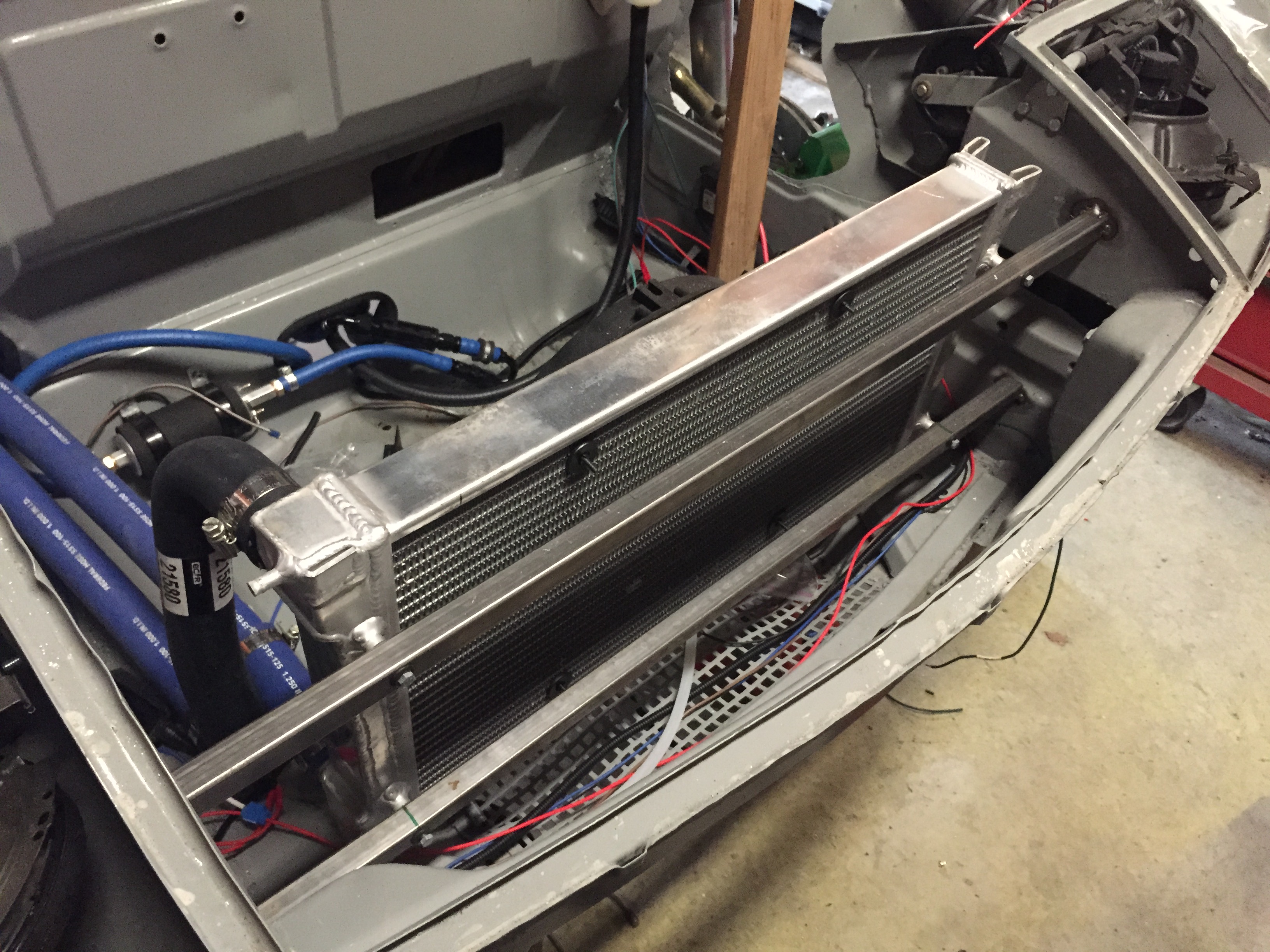

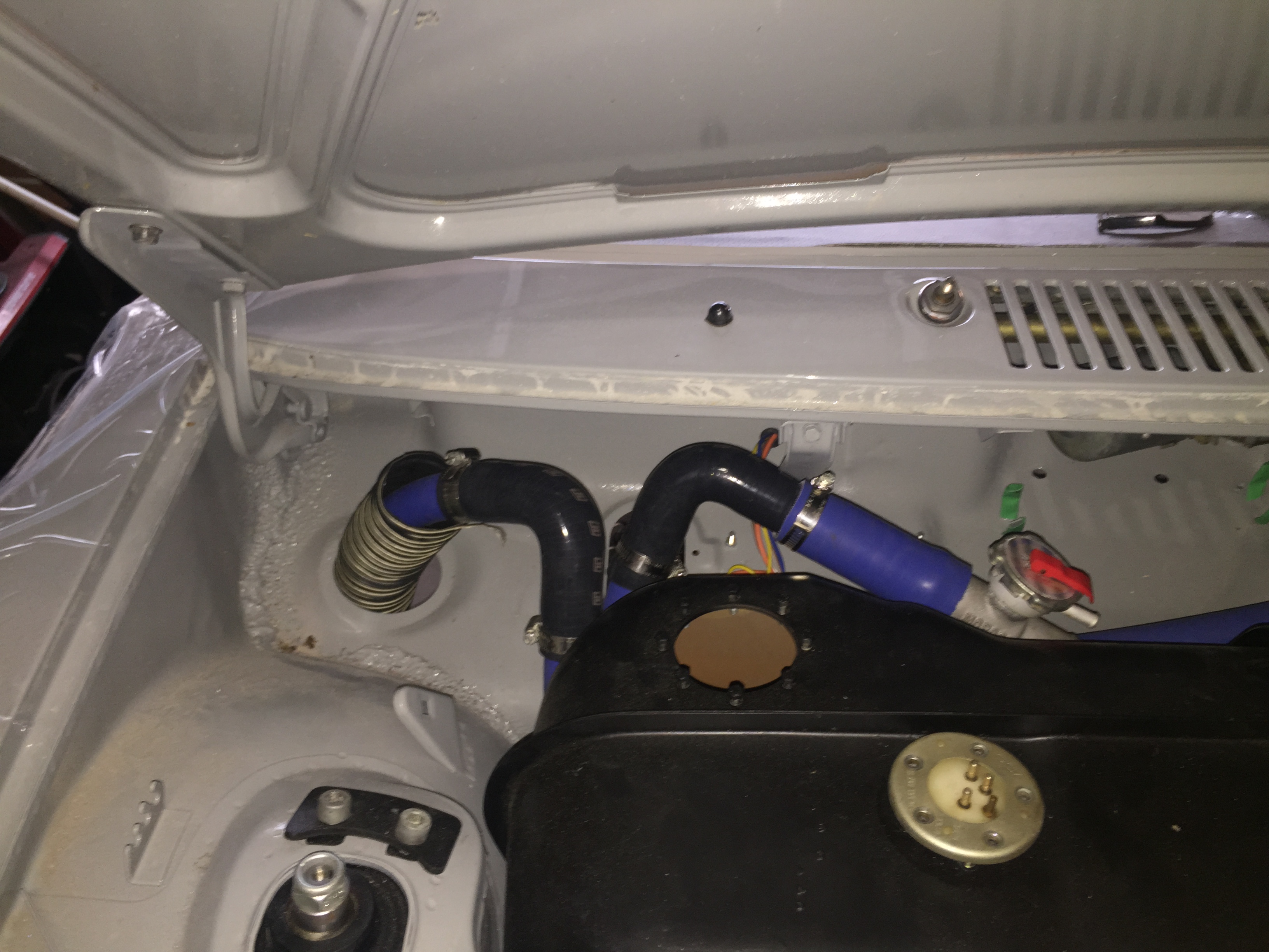

OK....I'm back at it.
First order of business: Clean up the elbows up front. I need to replace the rubber elbows with something made of stainless. I'd bought 1" copper pipe to use that, but the copper pipe is actually 1-1/16" OD, which WILL NOT fit inside the silicone tubing I'd purchased.
So I need a few 1"OD stainless elbows and connectors to get the front tidied up.
Right now, I don't like this setup AT ALL....I think it's not nearly as refined and sturdy as I'll ultimately want it. Time to make some changes.

Member No.: 14,748
Doug, I've been following this but didn't see where you got your coolant cap adapter piece from- that's pretty slick!

Member No.: 3,342
It's just kinda lying up there right now. That's absolutely the highest point, so I thought it would work best to have the coolant fill/burp valve up there. Just kinda sitting up there right now while I decide the best way to do it. I may end up with a solid metal tube up there to get the water from one side of the car to the other, then elbow down off of that.
The highest point is the key, but where did you get that piece? I've been looking around and seems they're difficult to find...

Doug, just FYI I have the same fuel pump as you and it's kinda loud. It's a great pump, so I wouldn't change it, but if you notice the whine you may want to wrap it in some insulation.
Those radiator fillers are on e-bay...
Radiator filler
Summit, Jegs, etc.
