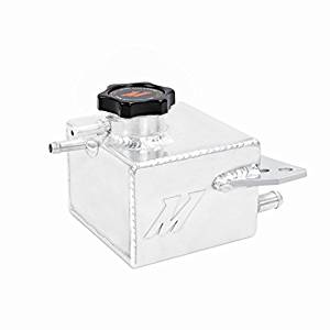

I was at outfront last week. I picked up a new oil filler set up that is a little cleaner.
We looked at using that one, but I couldn't use it with my air/oil separator. So we went a different direction. I'll let Scott post pics of what he's going to do when he gets to it. Going to be very cool! (of course.)

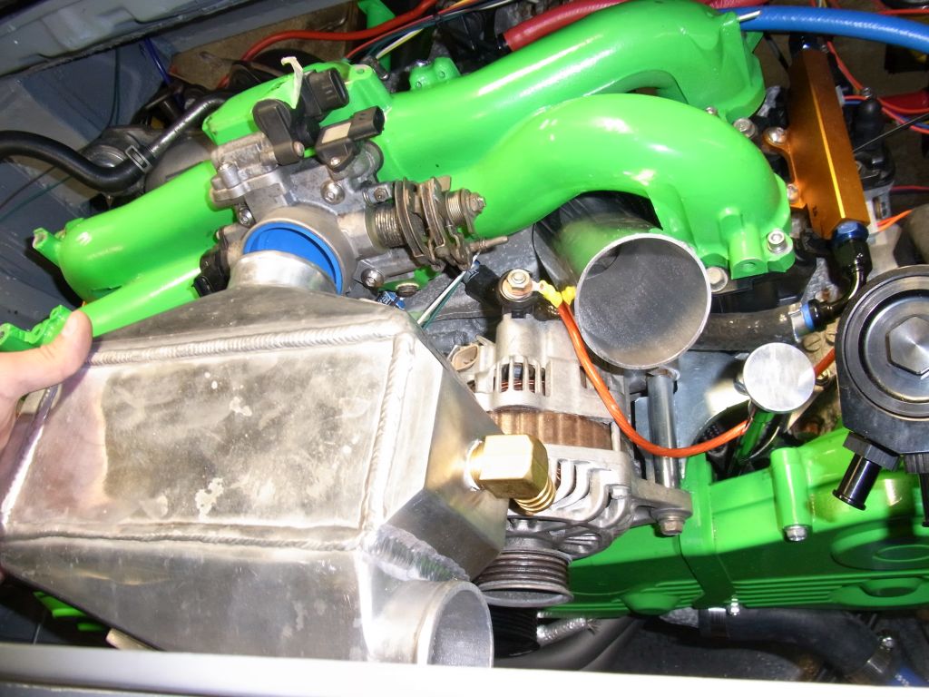

I pulled the offending coolant line tonight and installed the alternator. It is really close but I will be able to snake the tube under the manifold and past the alternator.
This install is going to be super clean and functional. Loads of (IMG:style_emoticons/default/sawzall-smiley.gif) (IMG:style_emoticons/default/welder.gif) in the coming weeks.

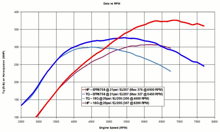

I was "helping" Stephen find a snail for his project and found this.
2.0L Subaru Borg Warner EFR 6758 and E85
Now wouldn't that be exciting! (IMG:style_emoticons/default/blink.gif)

Great suggestion, but the vf39 should be plenty for me. I know everyone is saying I'll want more HP later, but my target was 250hp and it's looking like I'll be way over that now. Hell, I had a blast in my 2.0 and that was only 100hp.
Besides Scott, your car scared the shit out of me.

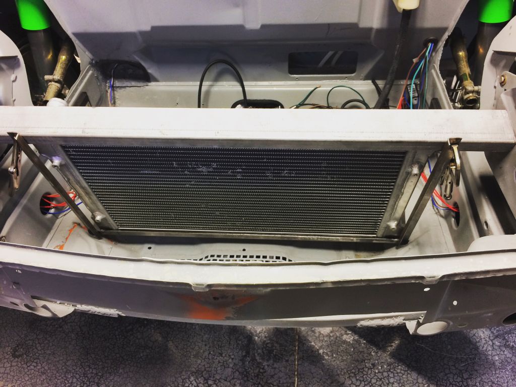

I havn't been slacking...promise (IMG:style_emoticons/default/yellowsleep[1].gif)

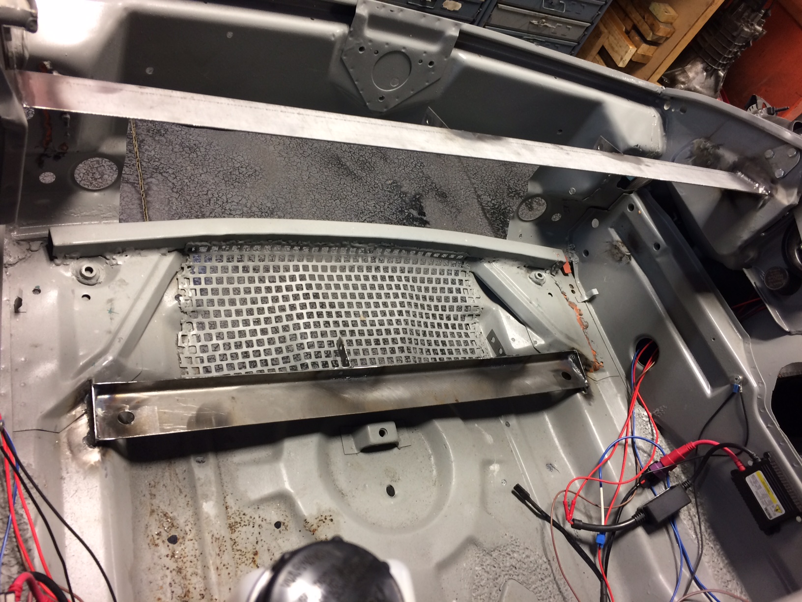

Just about done with the radiator mount. All made from flat.
Bottom will be held in place by the pins in rubber grommets. IC heat exchange will be mounted with 4 tabs to the radiator frame.
Fits like a glove. Still need to make end pieces for the bottom to weld to the chassis and stiffen everything up.
The vertical angle pieces are there temporarily to hold the top and bottom pieces in place as I take it in and out for fitment.
Tight gaps will make it easy to put down pretty welds.
Cheers,
Scott

post Nov 13 2016, 08:49 PM
Post #931
That's opposite lock!!
Posts: 645
Joined: 27-May 05
From: Dublin, OH
Member No.: 4,154

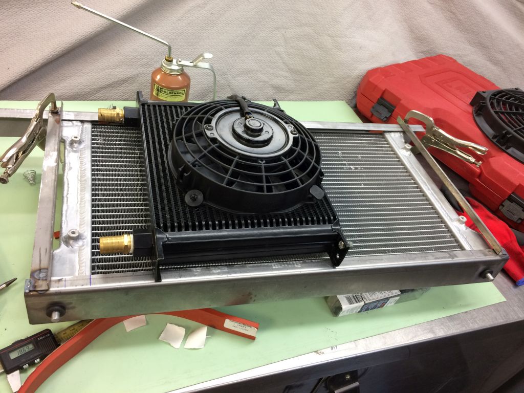

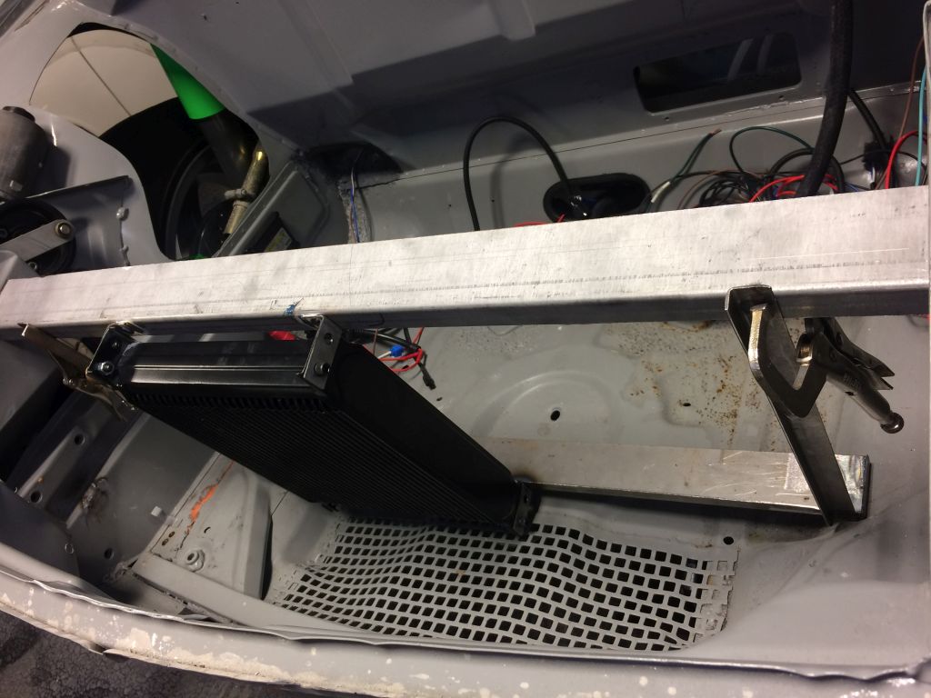

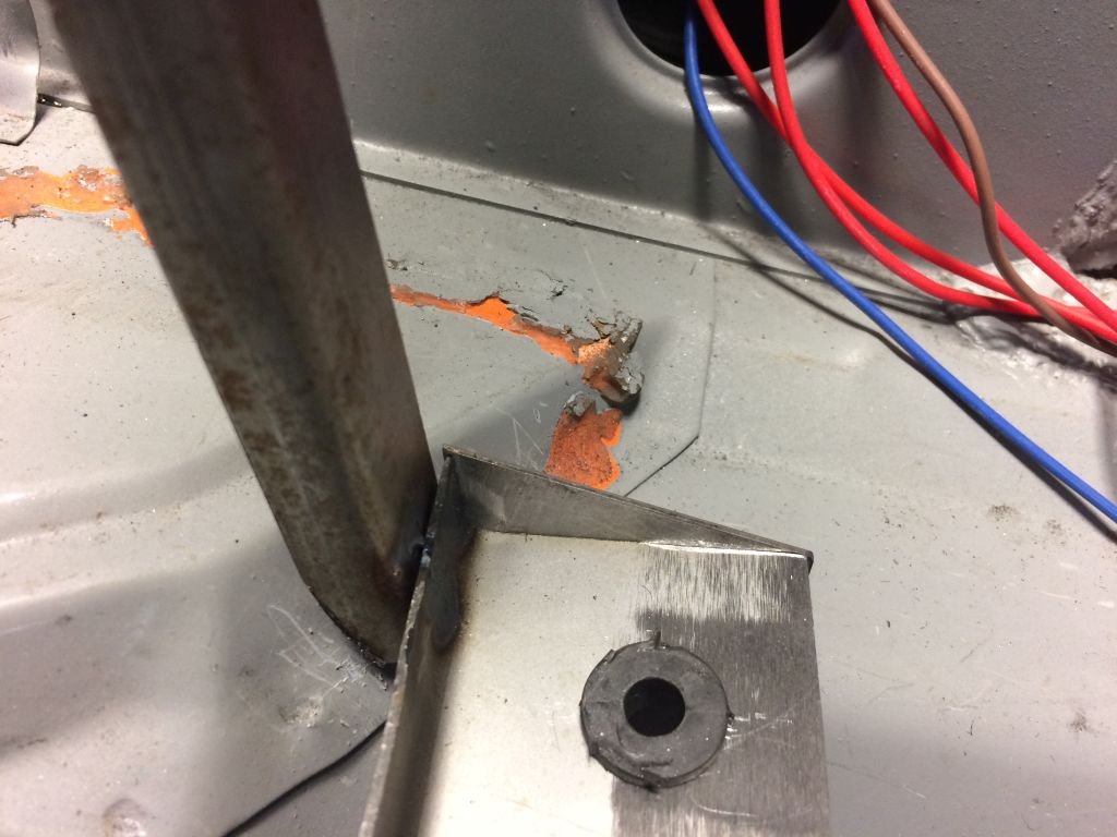

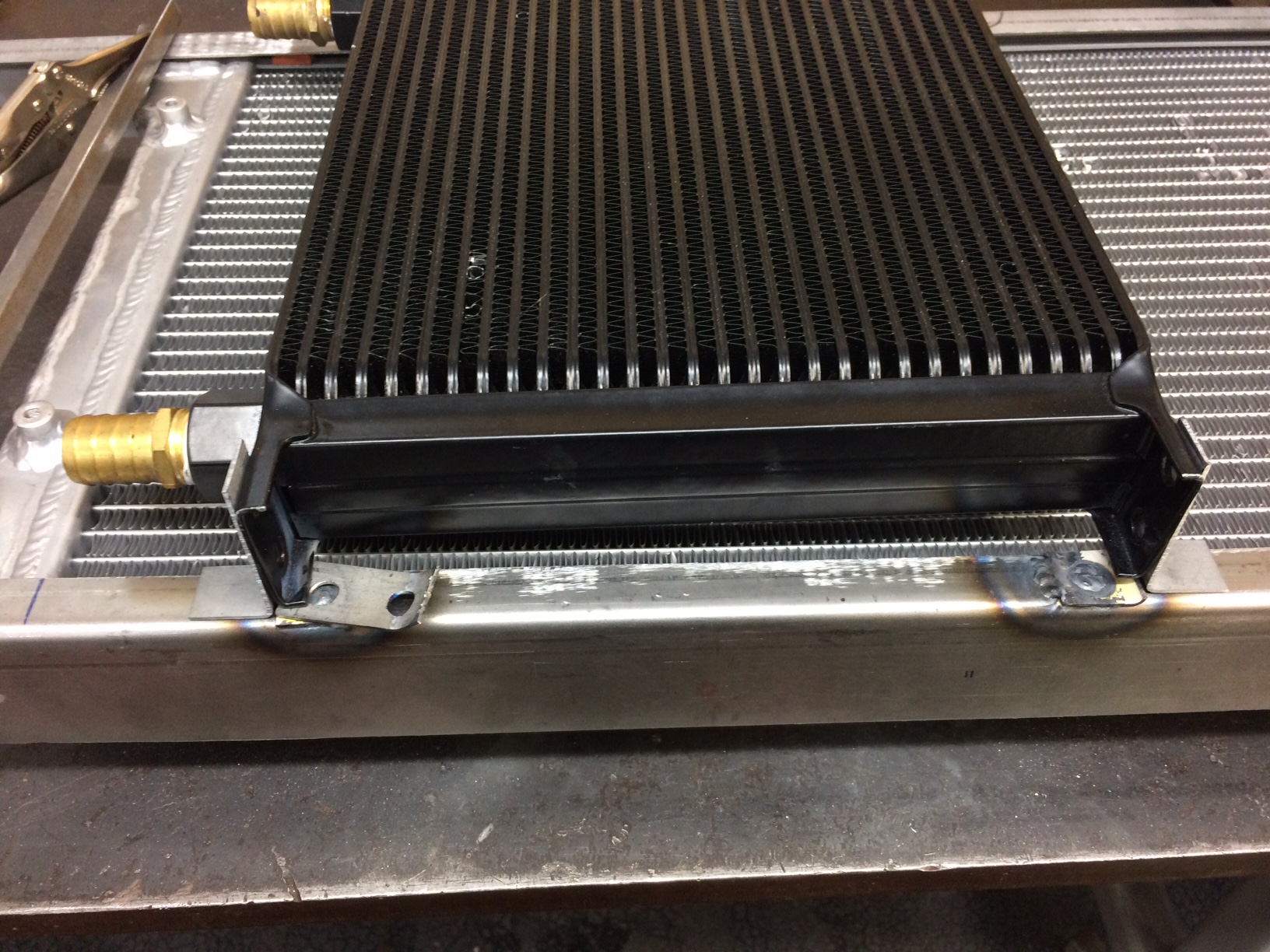

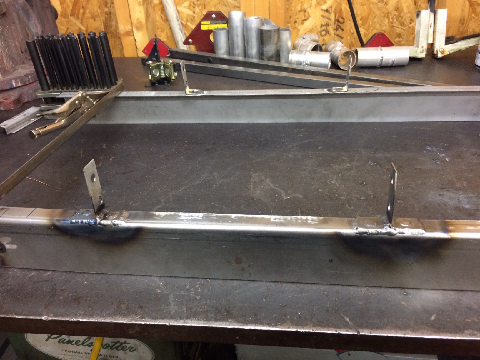

Why do things the easy way when I can spend countless hours on details no one will ever notice.
Made the feet for the lower part of the rad mount.
In place.
Also made the mounts for the IC heat exchange.
I probably could have welded it all in place today but I did not remove the lower grommets while welding and ruined them. I though that I had two more but only had one.(IMG:style_emoticons/default/headbang.gif)
Cheers,
Scott

I'm a little pissed that I see orange paint. I'd paid to have the entire tub sand-blasted, but I guess they forgot part of the front trunk. Guess I missed that when I went to inspect it before they put the primer on. (IMG:style_emoticons/default/headbang.gif)
Amenson

QUOTE(CptTripps @ Nov 14 2016, 09:01 AM) *
Looking good Scott!
The orange paint was under some sort of rubbery calk stuff. I assume that it was from the previous radiator setup. It took some serious scraping to get up, sand blasting definitely would not have removed it.
CptTripps
post Nov 14 2016, 09:23 AM
Post #934
:: Punch and Pie ::
Posts: 3,585
Joined: 26-December 04
Member No.: 3,342
Ah! Gotcha. That makes perfect sense. Yeah, the rubbery stuff never comes off with media blasting of any kind.

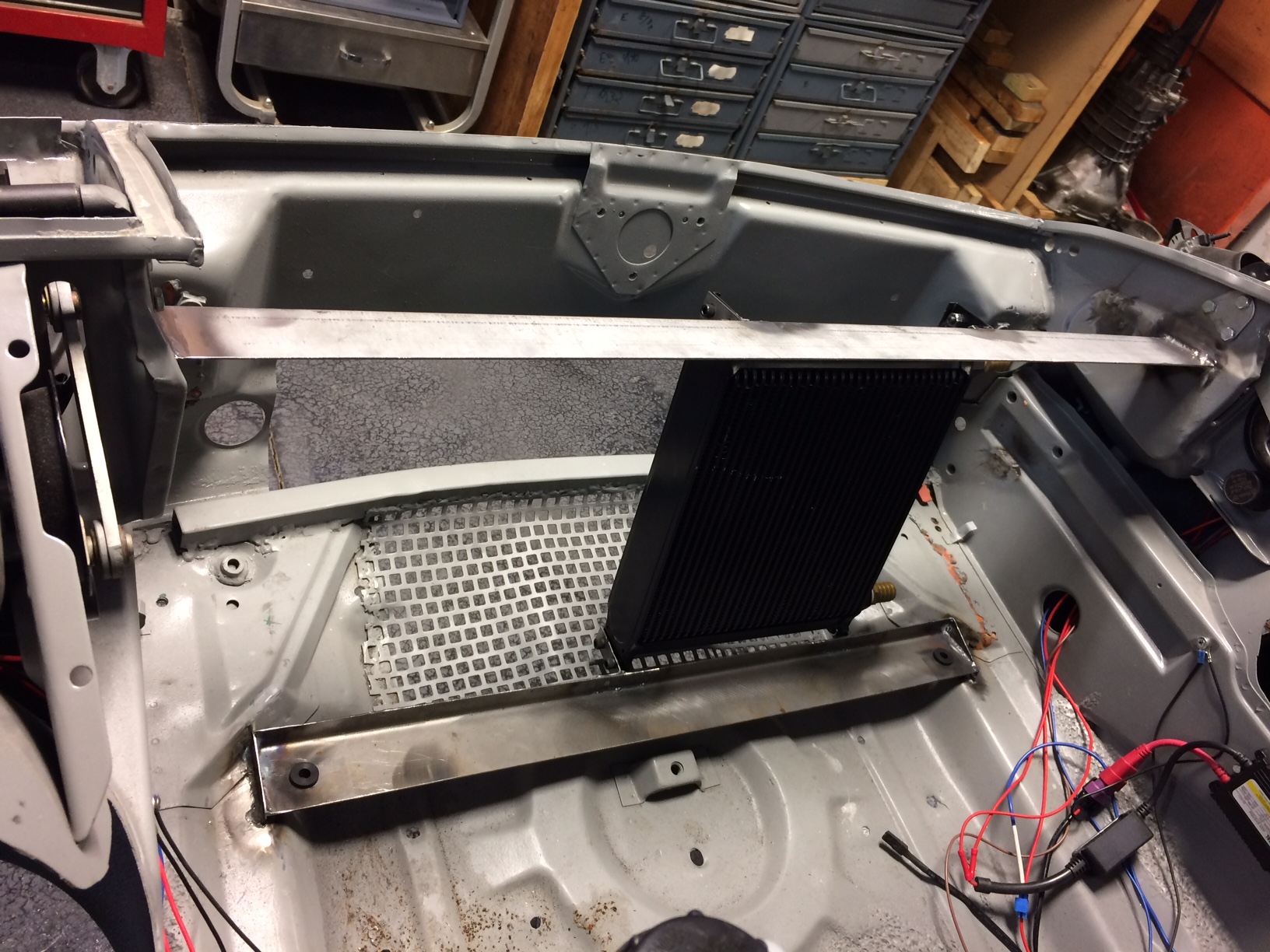

post Nov 20 2016, 09:29 AM
Post #935
Posts: 645
Joined: 27-May 05
From: Dublin, OH
Member No.: 4,154

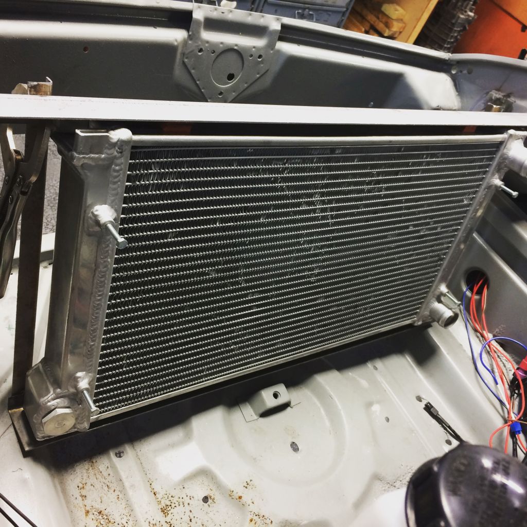

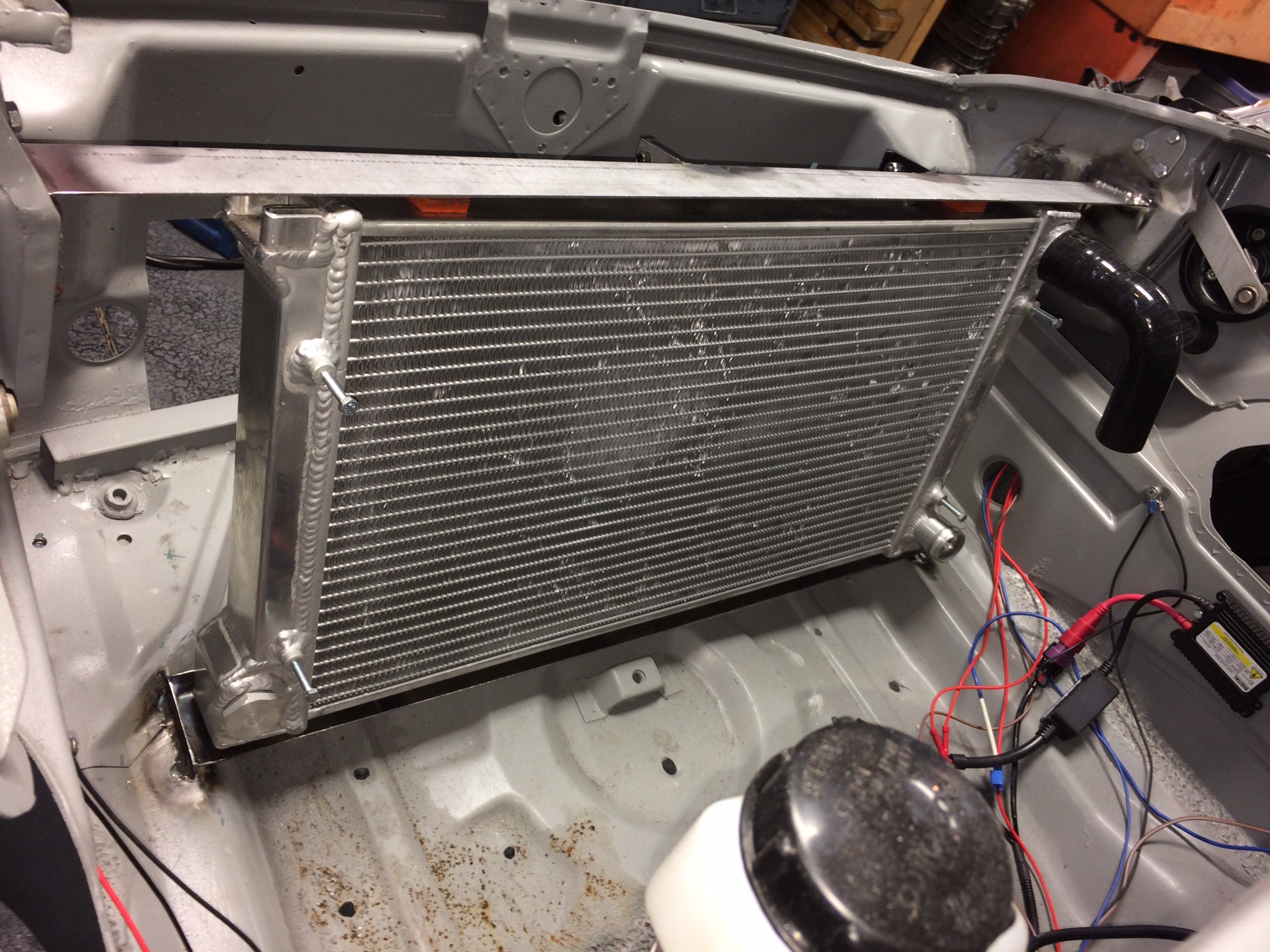

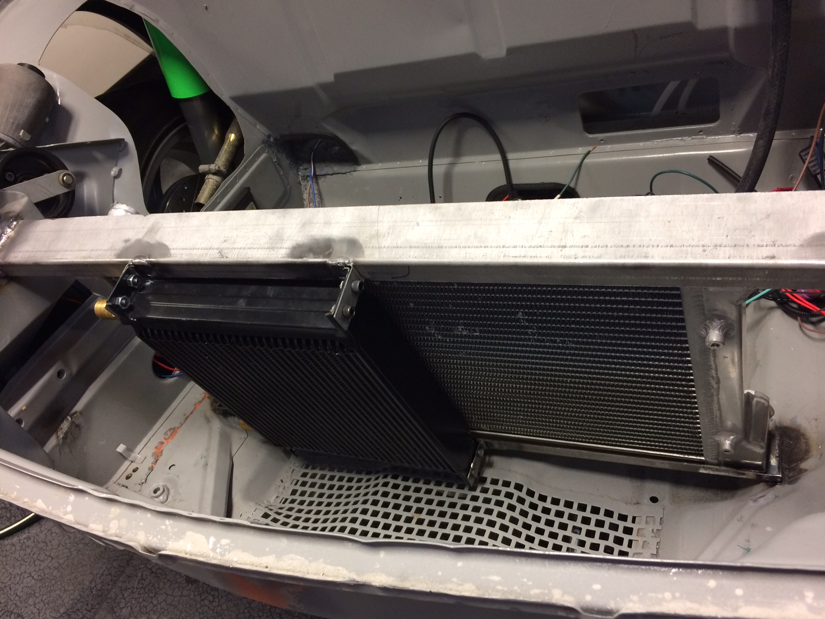

Phase 1, mount the radiators is complete!
While doing the final fitting I did not like the way the holes lined up for the IC heat exchanger so I removed the bottom tabs and started over.
Much better now. No slotted holes allowed.
Welded in place. Getting to the bottom piece was the toughest TIG welding I have had to do. Good practice for when I put a cage in my car. Definitely going to need another tig torch with current control.
IC heat exchanger in place.
And the radiator just drops in.
Now on to running the hose to the radiator.
Cheers,
Scott

Looking awesome. That sure beats the hell out of the janky-ass mount I made up...consisting of one piece of 1" square tube.
