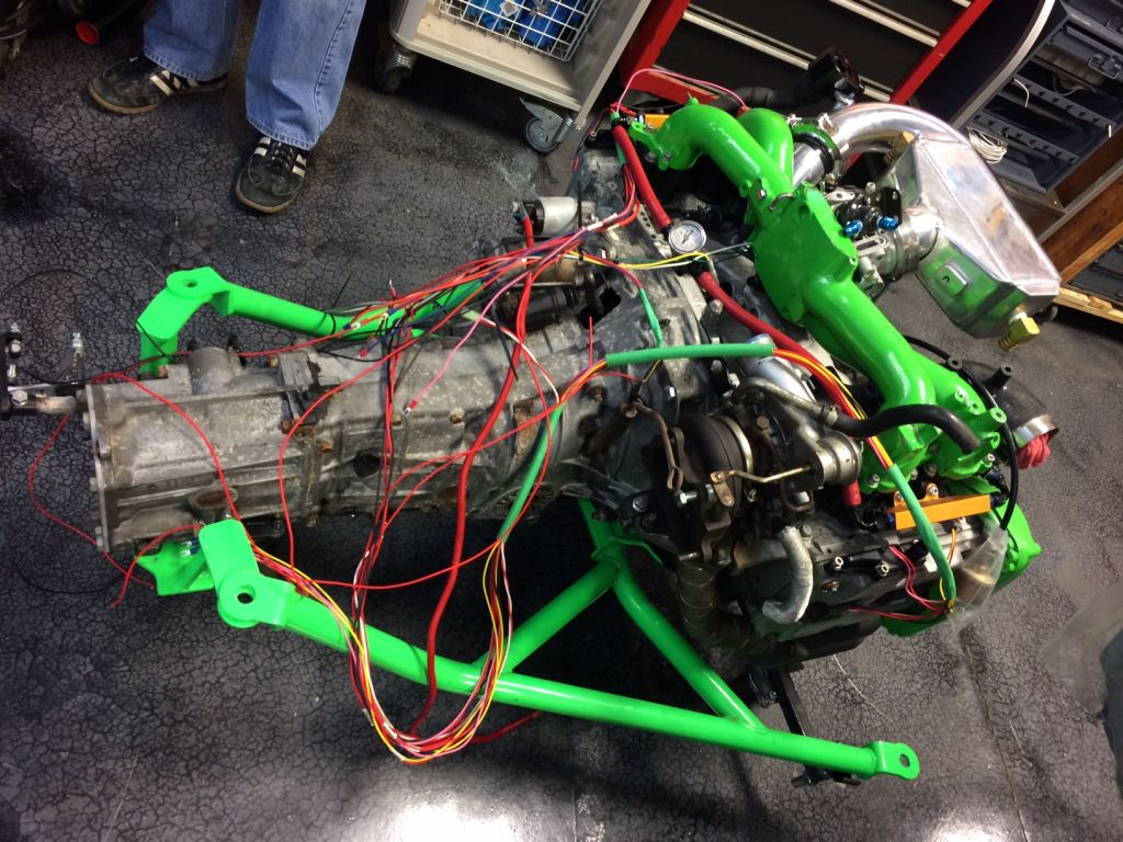

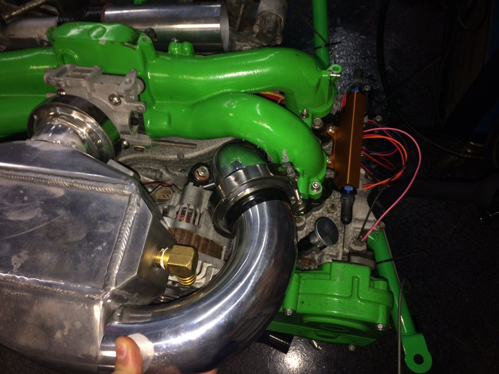

QUOTE(Amenson @ Jan 3 2017, 05:33 PM) *
QUOTE(76-914 @ Jan 3 2017, 07:38 PM) *
Maybe a rubber isolation coupling between the IC & TB (IMG:style_emoticons/default/confused24.gif)
Ya, sure...why not.
I would only take about 7 minutes to run the intercooler and throttle body through the the bandsaw to hack off the v-band clamp that I spent all day installing and replace it with leak prone rubber/silicone coupling. (IMG:style_emoticons/default/av-943.gif) (IMG:style_emoticons/default/laugh.gif) (IMG:style_emoticons/default/lol-2.gif) (IMG:style_emoticons/default/barf.gif) (IMG:style_emoticons/default/barf.gif) (IMG:style_emoticons/default/barf.gif) (IMG:style_emoticons/default/barf.gif) (IMG:style_emoticons/default/barf.gif) (IMG:style_emoticons/default/barf.gif) (IMG:style_emoticons/default/barf.gif)
Sarcasm aside, this is an upgrade that I added to the project on my own time because I did not want Doug to have to deal with the frustration of blowing IC piping apart in the middle of an awesome high boost maneuver. Nobody should have to ever experience that. (IMG:style_emoticons/default/hissyfit.gif)
Cheers,
Scott
I can understand that and it looks very nice. My concern would be cracks in the aluminum induced by the 4 cylinder's vibration. Maybe the Suby's 4 produces very little vibration. Just speaking from A/C experience. (IMG:style_emoticons/default/beerchug.gif)

QUOTE(76-914 @ Jan 4 2017, 10:52 AM) *
From my experience with persistent failure of the IC mount on the Porsti, the engine vibrates more than enough to break stuff! You can find the details and the solution in my build thread.
If you have some relevant experiences and want to share the details and how you solved the problems, it would be great to learn from them.
Cheers,
Scott

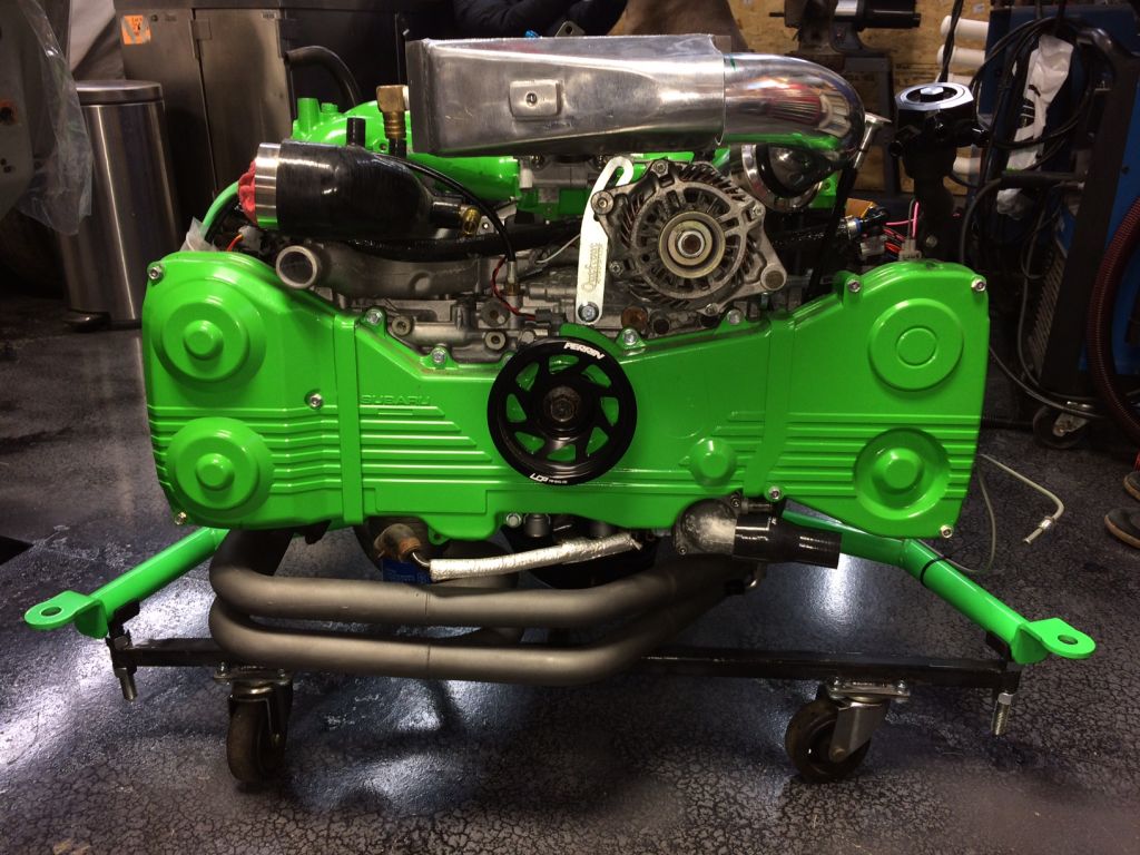

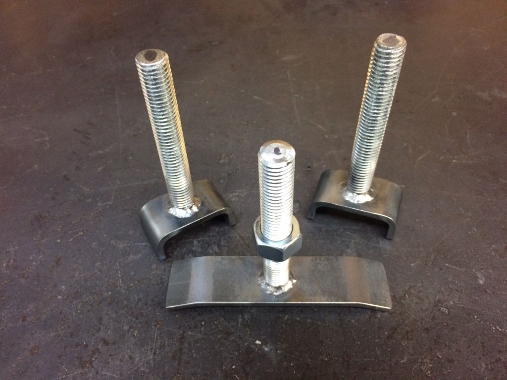

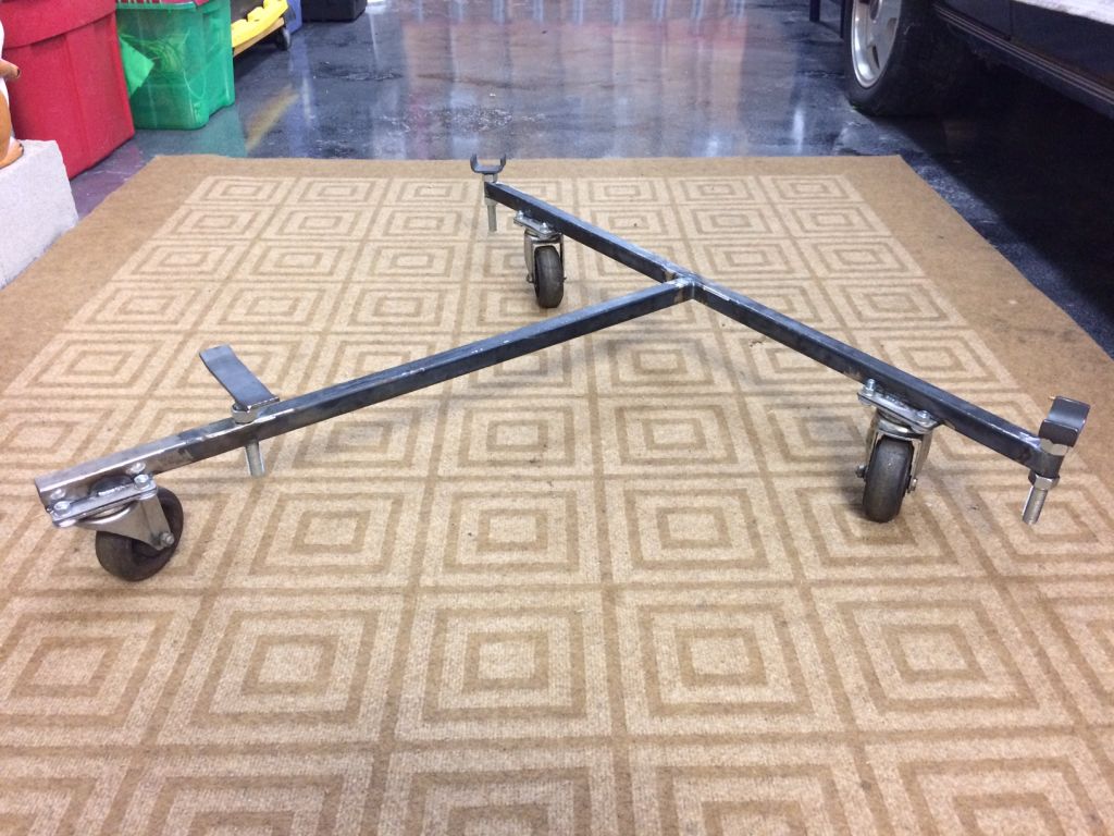

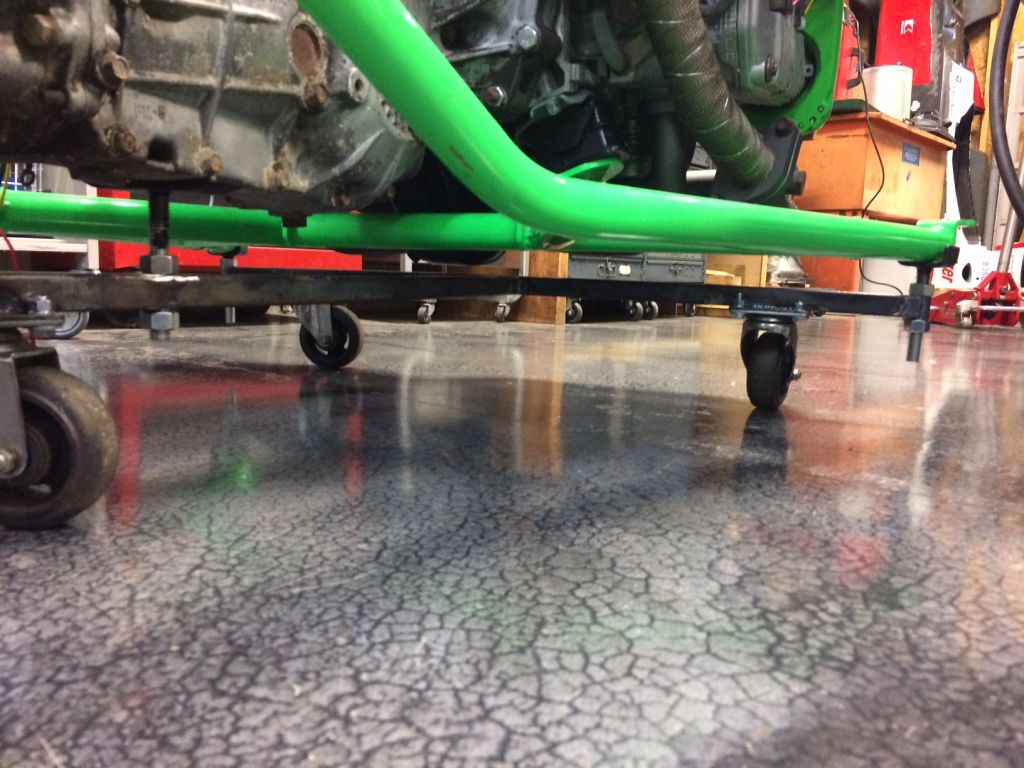

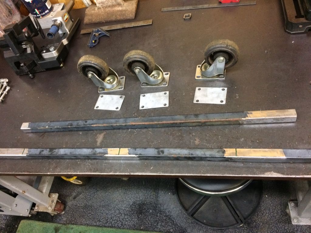

As promised...new engine cart. In total it took 14 component not including casters and fasteners.
Square tubing recycled from my nieghbors fence and castors from the cart that my C10 came on.
Threaded rod, bar stock and my bender. I coated the pads in liquid rubber to minimize scratching.
I welded bushings into the square tube for each of the adjustable pads.
Engine came out so easily that I forgot to take pictures! I removed the wheels and lowered the car until the drivetrain was on the cart, adjusted the pads and then removed the four mounts and lifted the body above the engine.
Perfect fit.
Now I can finish the IC install.
Also made a new mount for the air tools.

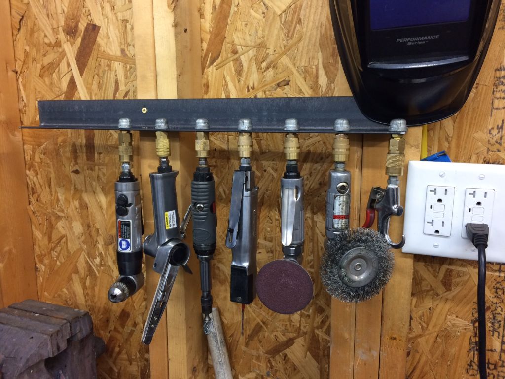

Cheers,
Scott

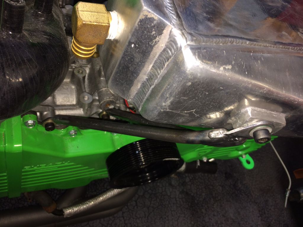

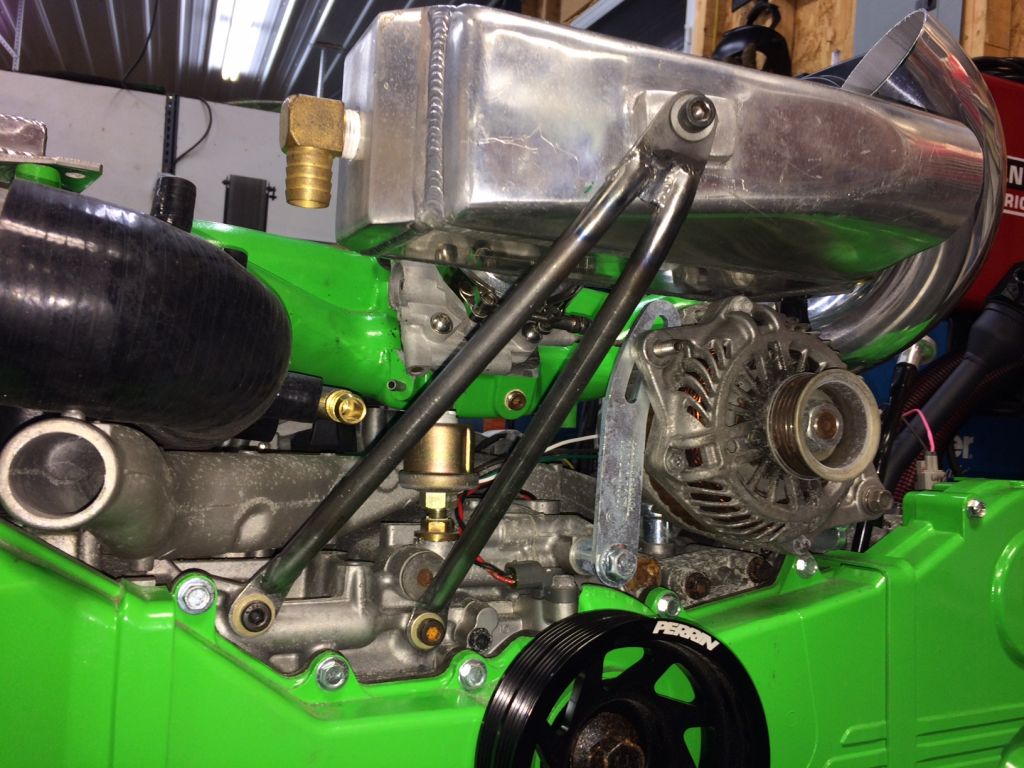

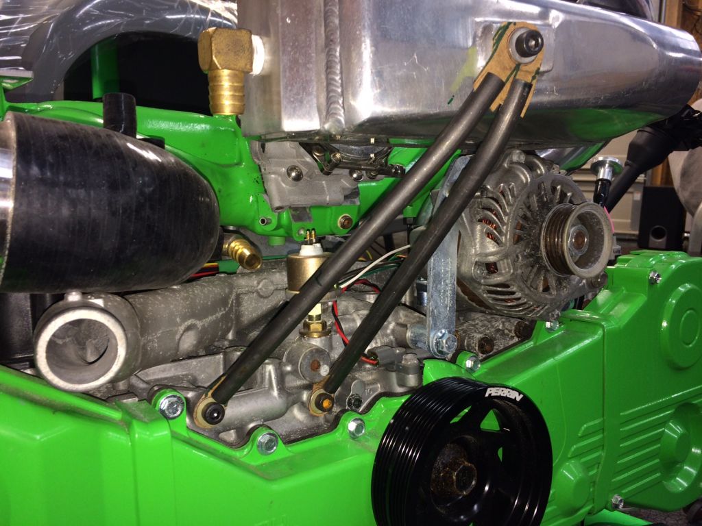

So much easier to work on the engine on the cart. Lead to a super productive day yesterday.

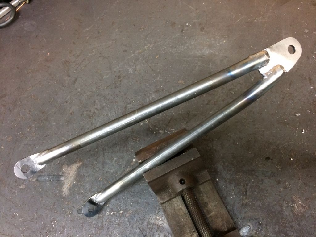

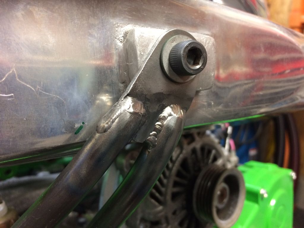

I made more room of the IC tube to the turbo by modifying the dip stick, removing some unneeded material from the intake manifold and remade the first tube out of the IC. It now clears the coolant elbow for removal and does not touch anything on the way under the manifold!!
I used CAD (cardboard aided design) to figure out the parts for the IC mount.
Many hours later.
It fits!
Nobody will ever see this when the engine is in the car so I have to show off some details.
So many angles.
Enough internets, time to get back in the garage and work on the IC plumbing.

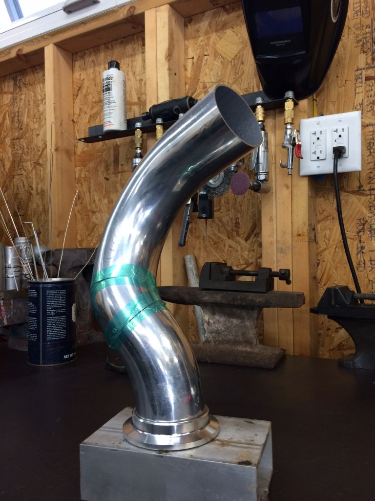

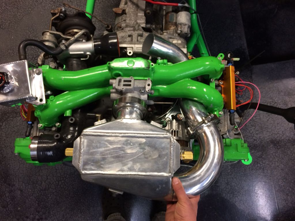

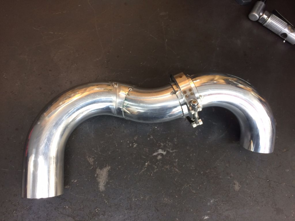

Today was the day to finally route the IC feed under the intake manifold.
After a few hours fitting and tweaking it was time to tack! The green tape is some heat resistant tape that does not leave a residue even after it gets a bit melty. It will eventually char but so much better than anything I have used previously.
The shape does not make sense until...
...it is in place where it fits perfectly.
I did not have a chance to finish the last section to the turbo or shape the IC entry so that will have to wait until next time.
