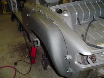

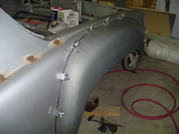

Here's what you'll have to look forward to. This shot is from after clamping the flare to the stock fender and marking the edge, then goin' at it with a saw-zall. I bought "butt welding" clamps from harbor freight to make this job easier and a little more accurate. Here's the drivers side rear after cutting and clamping...........

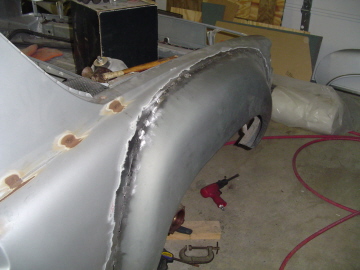

post Dec 10 2004, 09:04 PM
Posts: 1,857
Joined: 28-March 03
From: Millville, NJ
Member No.: 487
nuther...

Then spot welded between clamps and removed clamps, then repeat between previous spot welds while moving around a lot to prevent heat warping.....

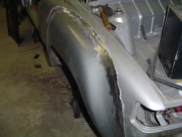

post Dec 10 2004, 09:07 PM
Posts: 1,857
Joined: 28-March 03
From: Millville, NJ
Member No.: 487
nuther.......... (IMG:style_emoticons/default/welder.gif)

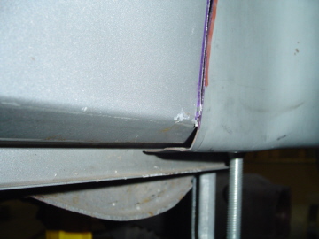

This is the challenge with the set I received. The bottoms are lower and shaped differently than the stock fenders. The stockers have a double bend and the AA flares have a single bend, not really a biggie but you need to work it some to make it look right. This is as far as I got when I started to run out of argon gas. Hopefully I can get the bottle filled tomorrow and continue the saga..........
