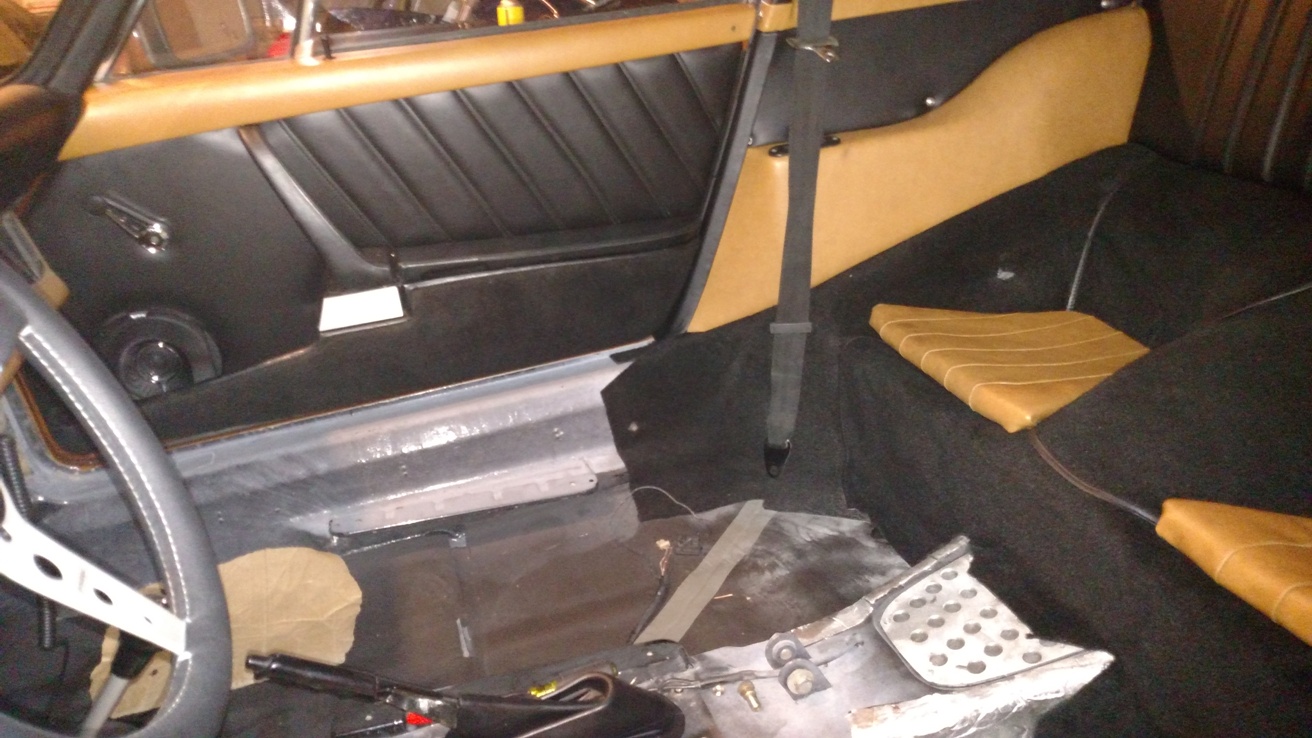

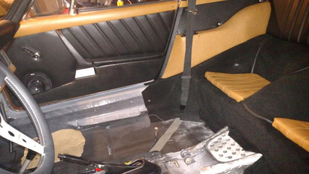

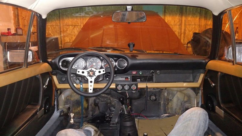

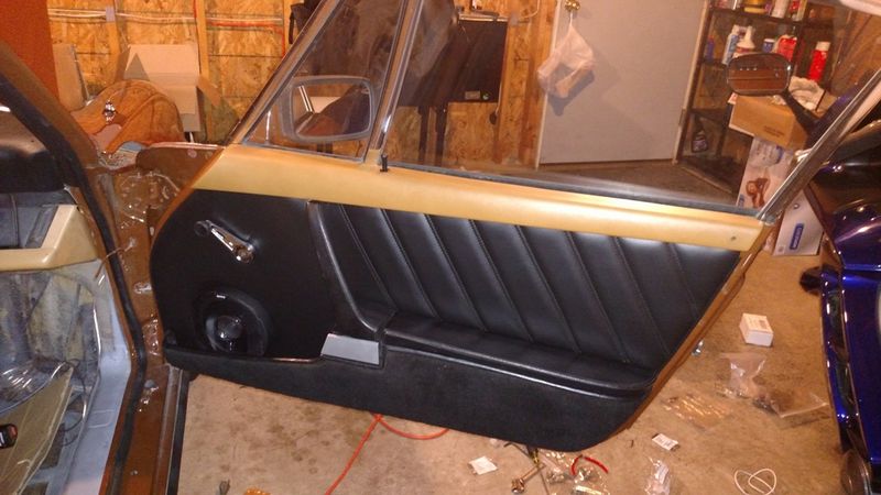

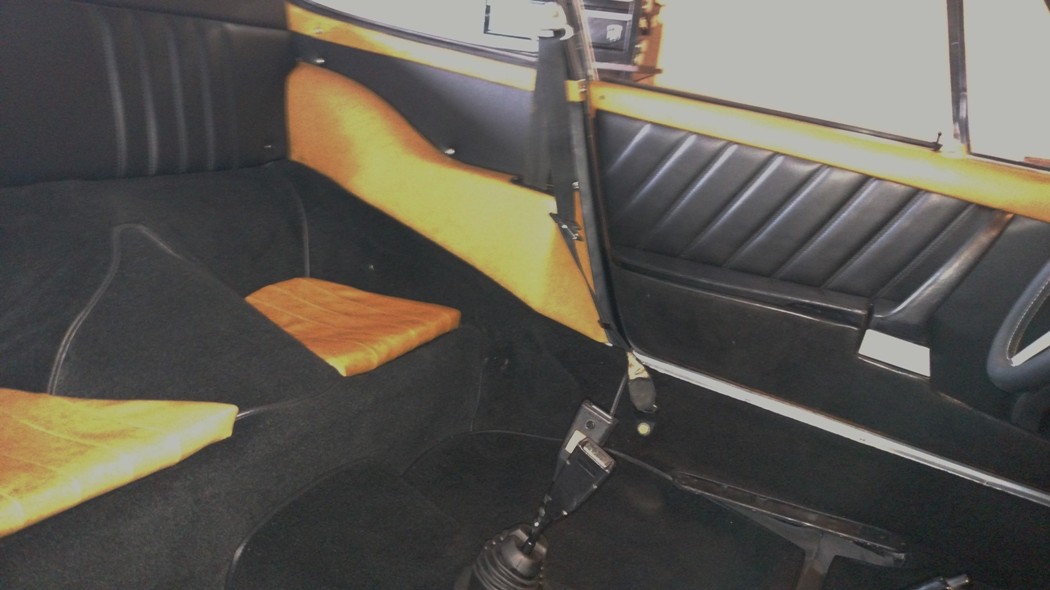

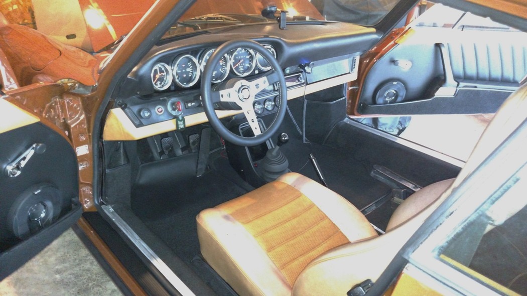

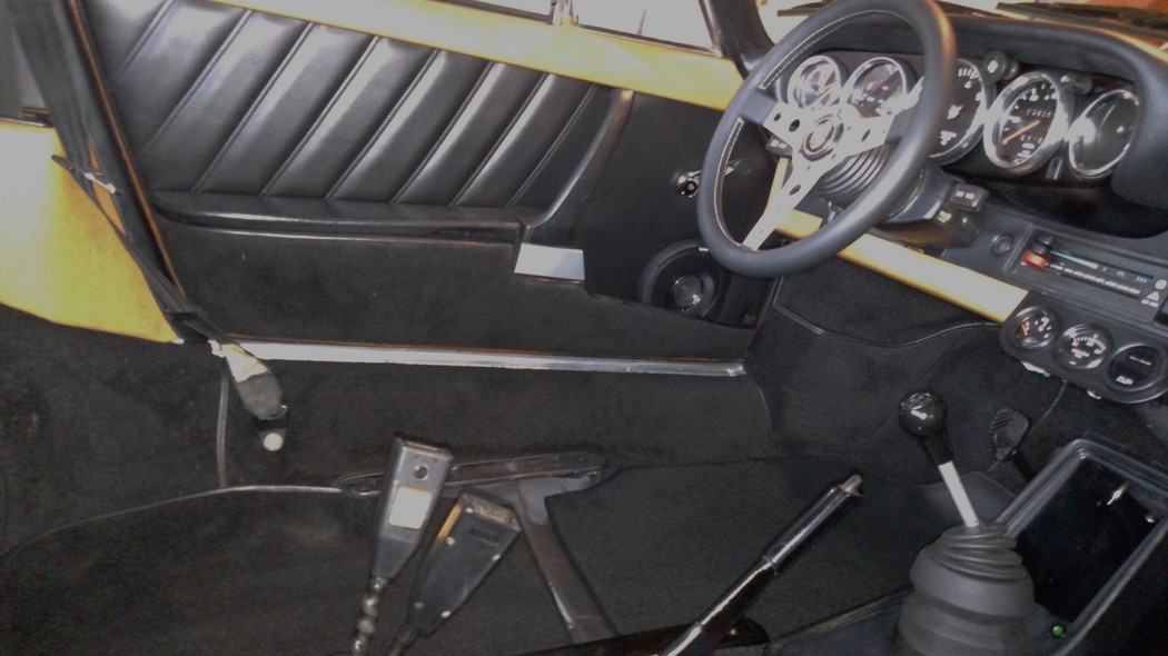

Re-assembled and installed my door panels and test fit rear deck.
Using the original stock Top Trim pieces (Cork), a set of Door handles, arm rests and pockets I bought at Hershey, new Door Panels, aluminum door handles and window crank. Speakers are Infinity Kappas, 6.5 in doors and 5.25 in rear deck. The Infinity speakers are VERY nice units, the mid/tweeter is directional, and you can point it for better dispersion of mids and highs. Also have a hifreq filter switch built into the tweeter. THe only thing I'm not thrilled about is how big the grills are, could have easily been 1/2 the height, would have looked far more refined. Isnt too bad on the doors, but look a bit wonky on the rear deck.
Installing a Tan Carpet Set from Robert Budd at Classic 9, lined the whole rear engine firewall with hush mat, and then sections of the floor to cut down on vibration, and will cover the whole floor and rear seat/firewall with 3/8 closed cell foam from super sound control foam with a self adhesive back. Don't think I will do the center tunnel or side rockers, just the floor and rear areas. COMING ALONG!
Right Door. THe pull handle, arm rests and pockets are from an 80's model, MUCH better than the original 70's era pockets. Much easier to install and more sturdy.
(IMG:http://www.914world.com/bbs2/uploads_offsite/forums.pelicanparts.com-16283-1449466226.1.jpg)
Left door. I need to align the dash pad, was missing the anchor bolt on the left side.
(IMG:http://www.914world.com/bbs2/uploads_offsite/forums.pelicanparts.com-16283-1449466226.2.jpg)
A bit of a panorama, still need to install Head unit (Using Blaupunkt Toronto 420)
(IMG:http://www.914world.com/bbs2/uploads_offsite/forums.pelicanparts.com-16283-1449466227.3.jpg)
Test fit the rear deck, am considering not using the rear seatbacks, just the seat bottom. I'm lining the whole area with 3/8" closed cell foam, so will be more comfortable.
(IMG:http://www.914world.com/bbs2/uploads_offsite/forums.pelicanparts.com-16283-1449466228.4.jpg)

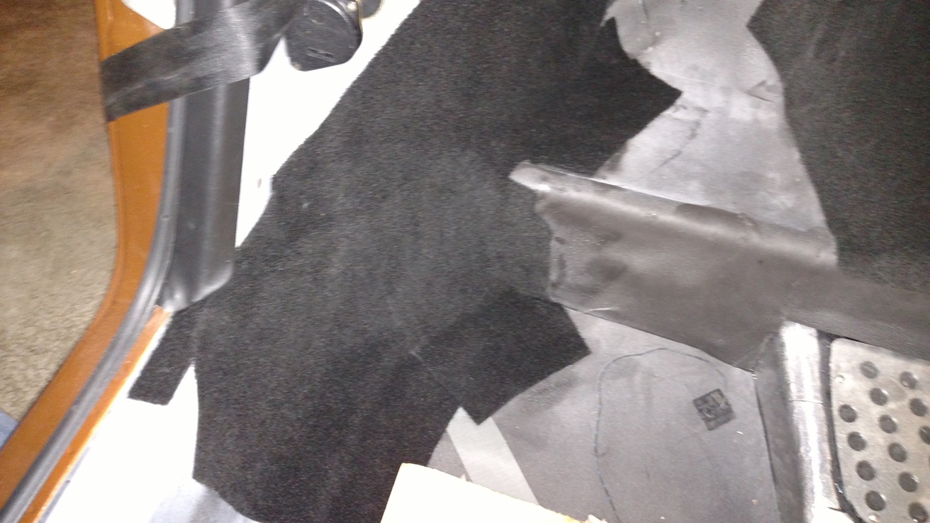

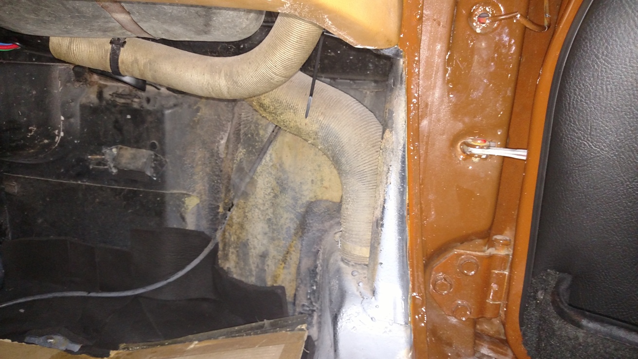

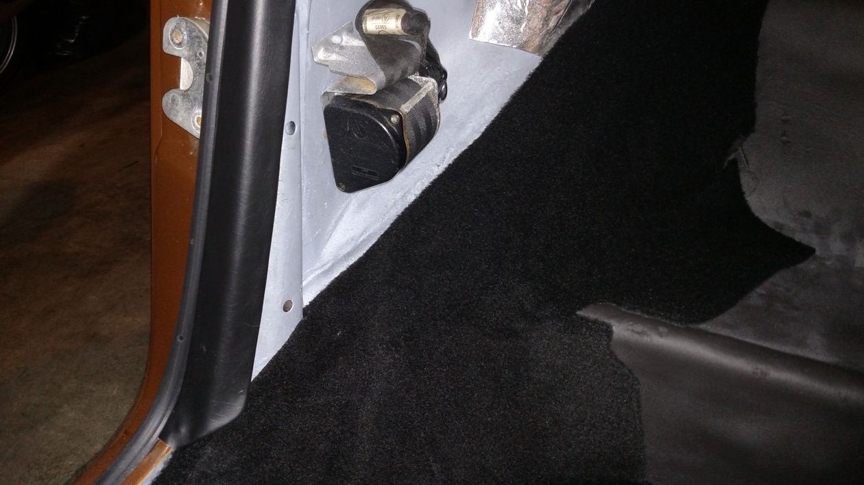

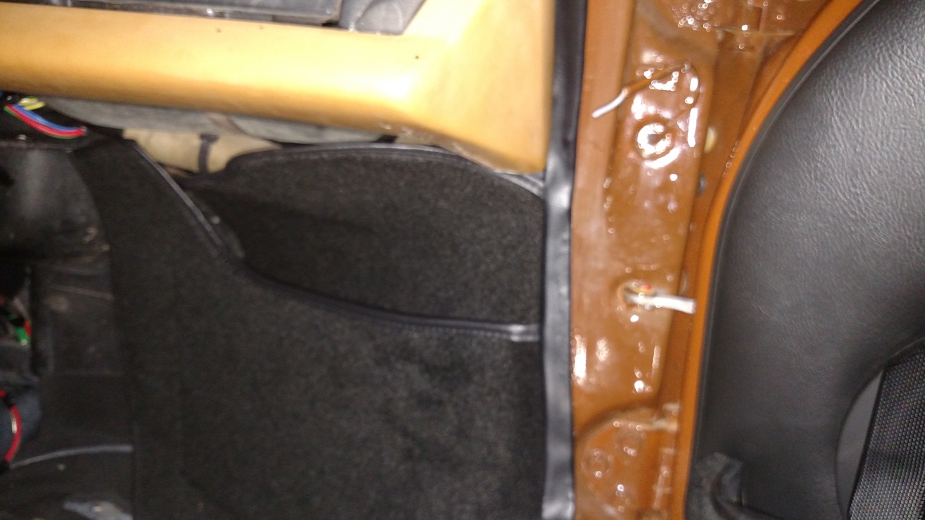

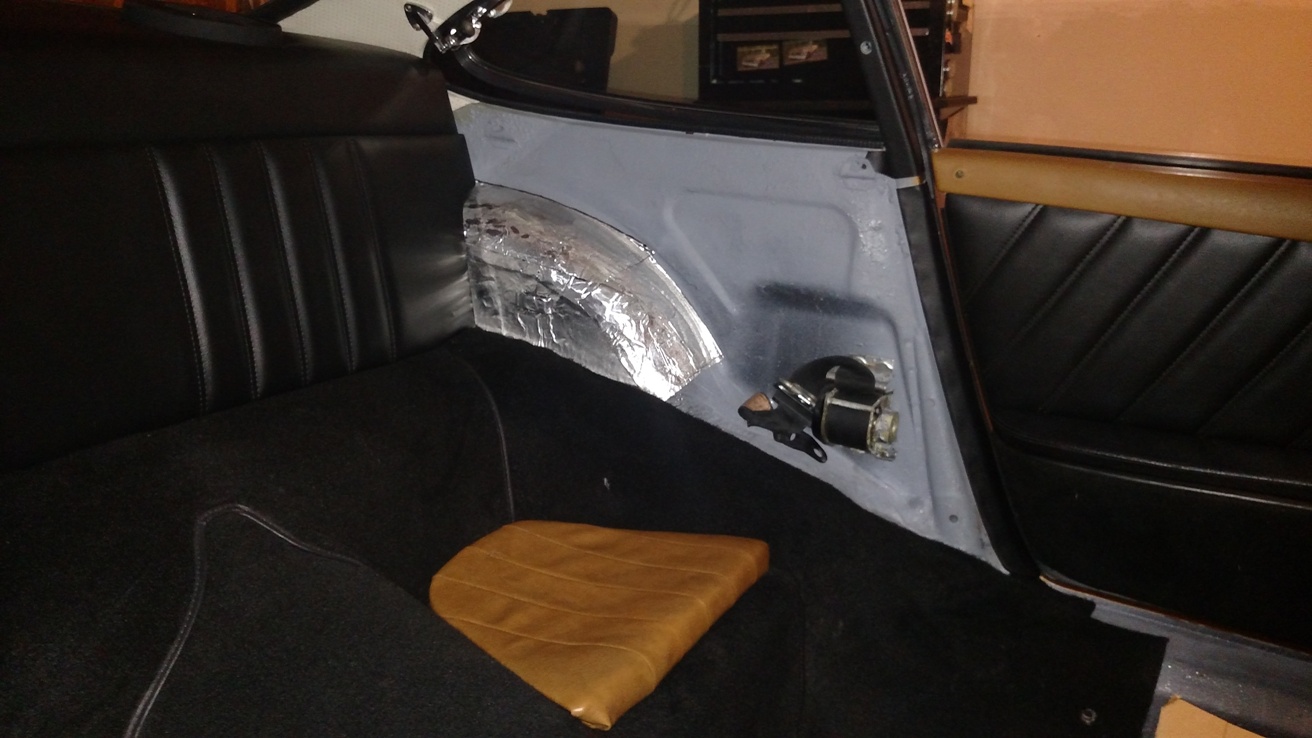

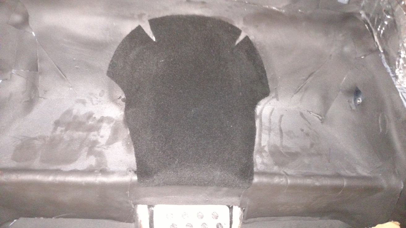

Progress continues, including some revisions. I diddnt like the location of the AFM, was blocked by the steering wheel, so I removed the left dash vent, replaced it with the original clock, and moved the AFM to the center gauge cluster where the small VDO clock was. Much happier in this location.
Making progress on the interior, got my carpet set from classic 9 and started installing. Tell ya what.... SOMEONE needs to make a premoulded set for this car.... I covered the rear firewall and most of the floor with hushmat, then a pressure sensitive (self adhesive) 3/8 closed cell foam. Hopefully will mute much of the harshness.

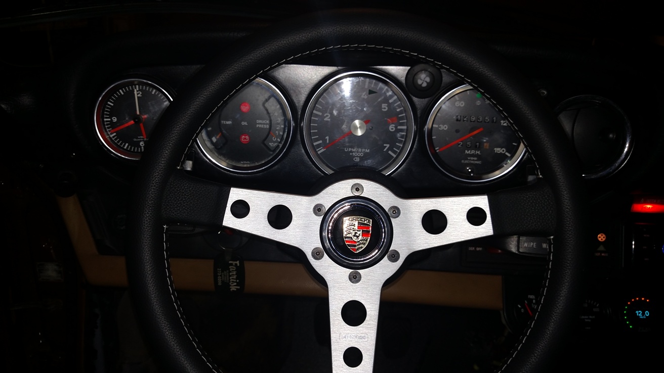

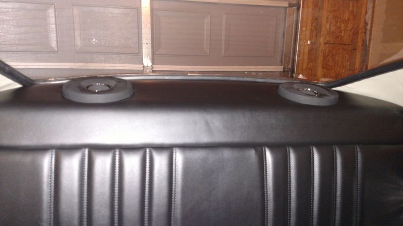

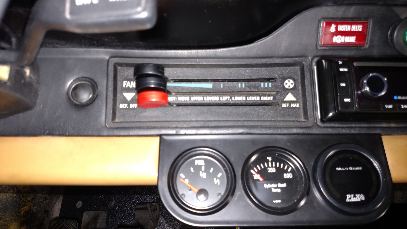

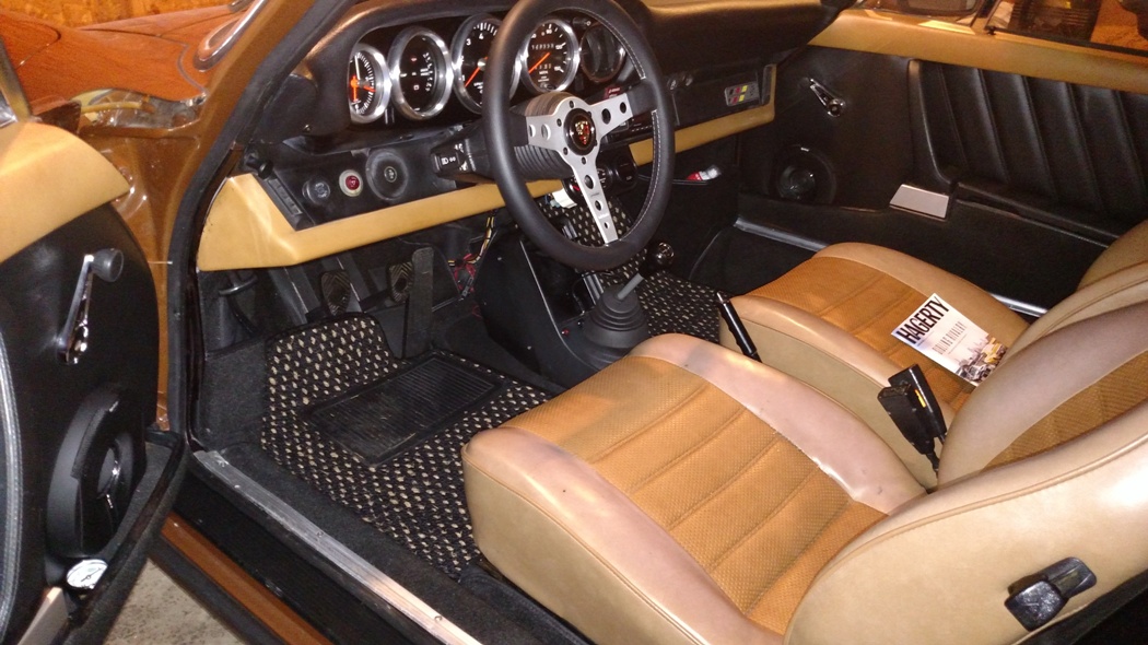

Even though I still need to mount the passenger seat, glue in the rear seat cushions, and cut in the seat belt rubber boot, I couldn't resist taking the car for a long drive to see how my sound insulation efforts went.
The Lord was good to me, the rain stopped between about 1pm & 5pm allowing me about a 3 hour drive in and around the Lacy/Olympia/Rainier areas. Prior to this I had driven about 500 miles with no sound insulation and the engine was loud and transmission even louder. I layered the entire firewall and the flat panels of the floorpan with 2 boxes of hushmat and then covered it all with 3/8" closed cell foam. With the carpet set, I am at about 38lbs for carpet and sound insulation.
The results? At start and Idle, the engine and transmission are very well muted, and I hear the engine sound more from the vents above the rear window than through the firewall or tunnel area. VERY happy about this. Road noise is well muted, though at speed I am wishing I had used CSF or hushmat on the roof, as this is where most of the noise comes from except at WOT and holding at 4000-5000 RPM. The engine booms when holding at 4500 RPM and higher, and the noises through the firewall and interior with all the sound insulation is a very nice muted growl and induction, with a little exhaust as well. The clatter of the gearbox is gladly 99% GONE.
I'm thinking the ride height is just right. I was thinking of dropping the rear a bit more, but I think this works well. I am super impressed at the combination of Rebel Racing suspension bushings and the Sachs Shocks. The car is well damped, extremely responsive, smooth and has no harshness, clunks or rattles. It is solid as a bank vault and I would say it is just a tad softer than the M3 in its ability to soak up bumps rumble strips and those awful recessed reflectors.
The motor continues to run flawlessly, there is a very slight fuel starvation issue with light throttle increases when at high RPM's (i.e. when at 4500 rpm in 3rd gear a very slight throttle advance will lean the fuel mixture (shows 16-17 on AFM) and a slight hesitation. If I get deeper in the throttle it is fine, cruising it is fine, full throttle it is fine, routine driving is fine, its just at this point. I want to play with the timing a bit to see if that will help. The engine is very responsive, and top gear acceleration is adequate, though a downshift wakes things up. Power is a relative thing, and this is NOT a muscle car, but no slouch, makes 60 in 8.5 and keeps pulling strong at 100 in 4th. Good enough, and this car in NOT about drag racing it is about the total experience. I can't wait to take it on its first drive up to MT Rainier or the Olympic Peninsula.
I cant wait to see how it drives and handles after a proper alignment, everything is set neutral (to the eye). Even so, the car tracks beautifully, though the steering is a bit slow to respond and there is more body lean than I'd like. Then again, my daily driver is an E36 M3. After I get the car aligned (this weekend) and I drive it a bit, I amy opt for a thicker front roll bar and rear bar, but I dont know. I have to let the car talk to me a bit.
The Stereo and Infinity Speakers ROCK. Though the rear speakers lack the necessary depth for full bass, they balance out enough of the high tones to make the sound feel rich and full and the 6.5 Infiniti Kappas in the doors are incredible and take all the 50W head has to offer with full bass and balanced sound, so no need for an underseat subwoofer...... Besides I'm 51 you know? Dr. Drey has no pull on me....... That said, I wouldn't recommend these speakers unless they were going to be mounted behind a grill. THe Kappa grils stick out about 3//4" and IMO, arent bery aesthicially pleasing. Only one rattle in the interior, the car is very solid.
I'm very happy with the gauge changes, the clock looks great, and I have clear view of the AFM/volt meter. The Mom wheel makes the 50-70 area of the speedo unreadable, but oh well. I may eventually invest in one of those momo offsets, but I'm not too worried about it. The right side controls of the Stereo are just beyond comfortable reach, though the rest of the controls are natural in their feel and response. The single One nice surprise was just opening the windows allowed air to come out of the dash vent and the now single vent outlet on the fan feels much stronger. I'm a bit of a symmetry fanatic, so it is hard to see the dash unbalanced, but I much prefer clear view of the gauges and a stronger airflow from the vent.
All in all I am beyond psyched.... Army Life and 15 years of war has burned much of my ability to truly 'feel' but yesterday I actually had a very nice moment of elation. I just hunted out back roads, and found these horses. I stopped to take a picture to send to my girls and while doing it the horses started dancing and jumping around. I got a bit nervous one was going to jump the fence.
Many people to thank, and I will wait for that until I am finished. Still need sun visors, trunk carpeting, and a few other odds and ends.

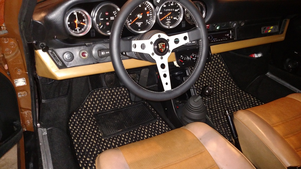

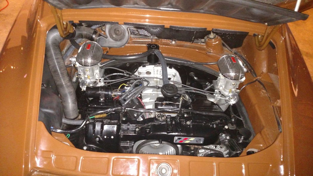

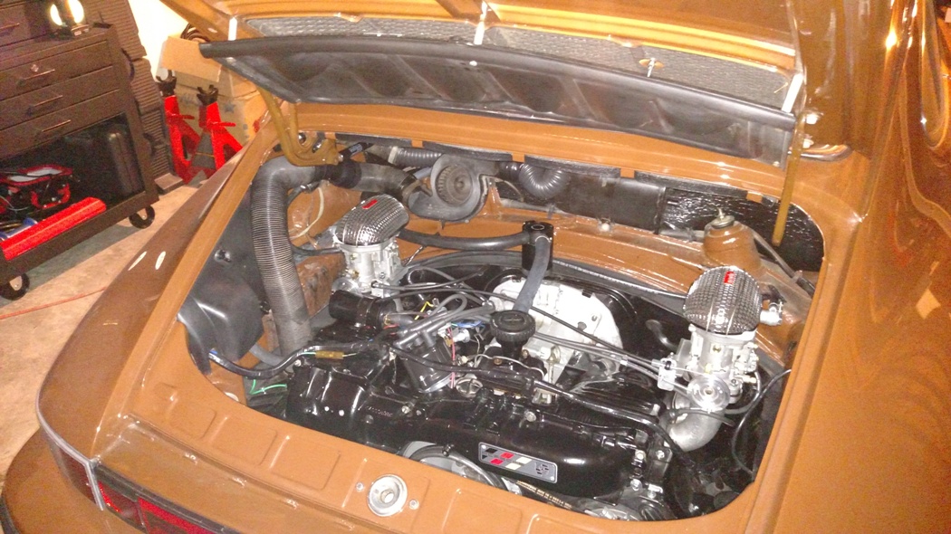

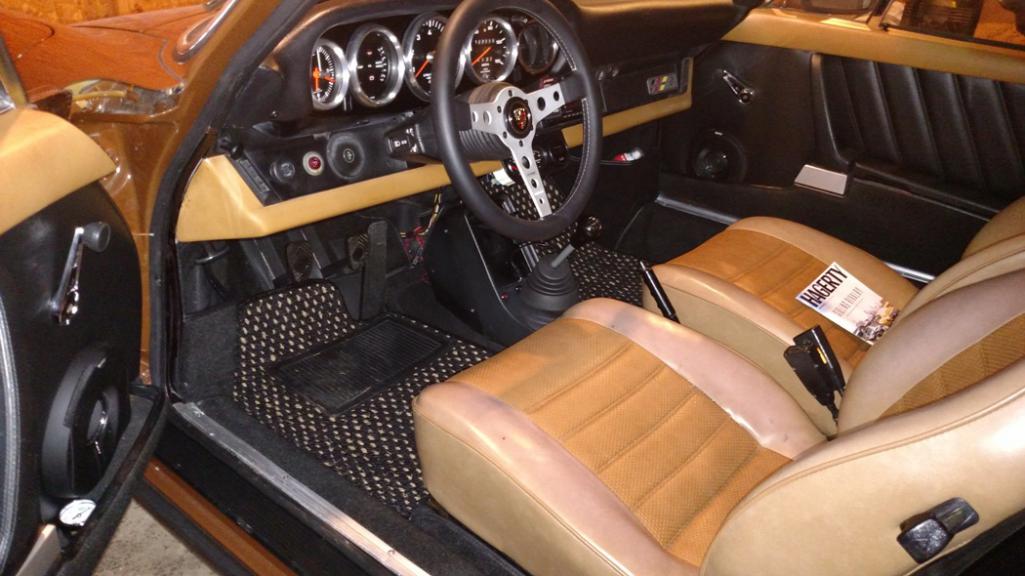

Progress continues, trying to put a few miles on the car, fine tune the carbs, and make adjustments for daily driving. REally like how the car is sitting and looking. I'm thinking the foglights may go, they are too big.
The COCO mats finally came, took 3 weeks, but they look great and are super high quality.
I initially set the motor up with ITG filters and 1.5" Velocity stacks. I also picked up a set of RAMFLO filters at a swap meet for $25. Am trying them out. The main difference seems to be sound, the RAMFLO's without V stacks is much quieter at WOT. Midrange also seems a bit weaker without the V Stacks, but may be related to other tuning issues.

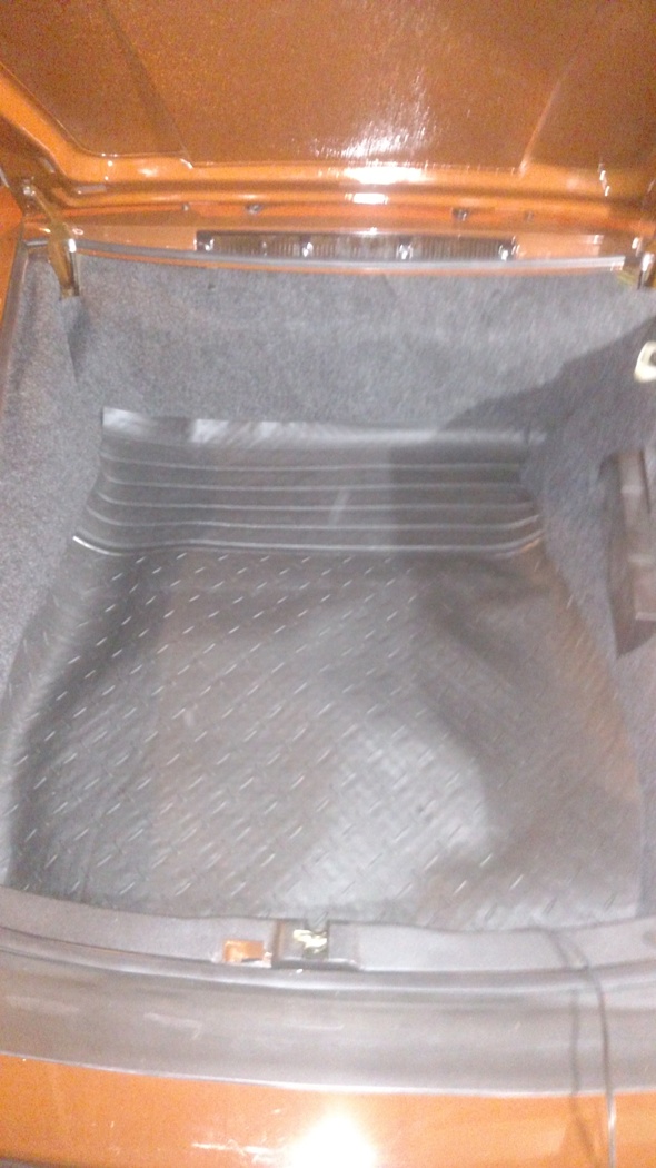

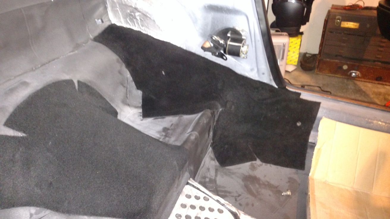

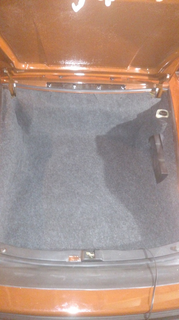

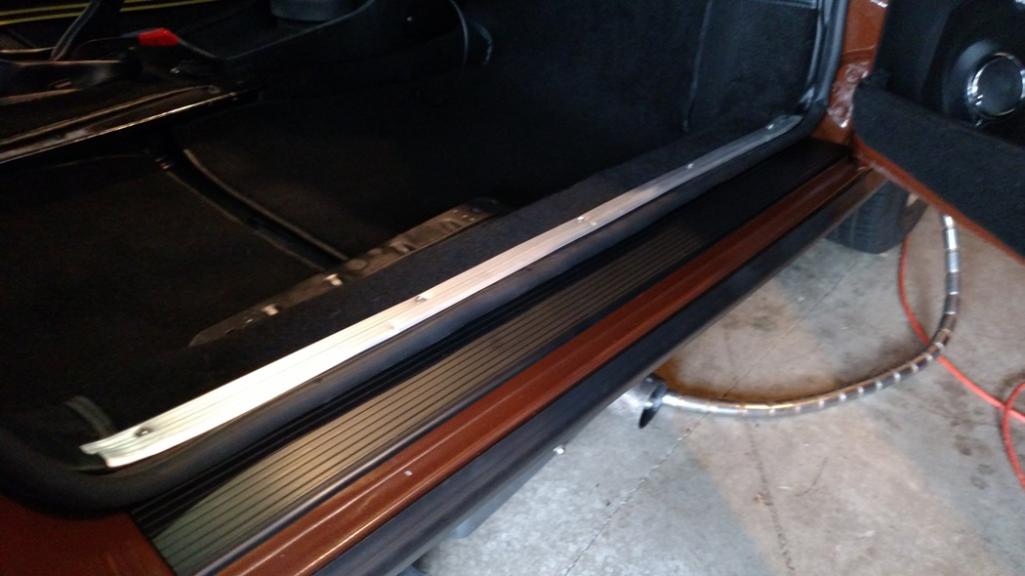

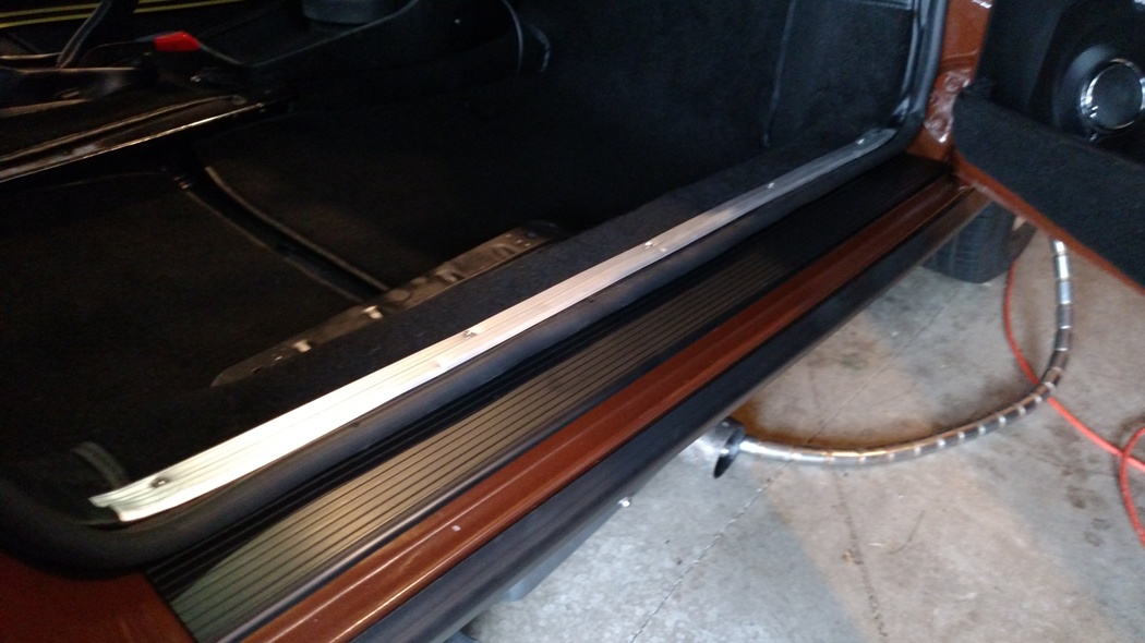

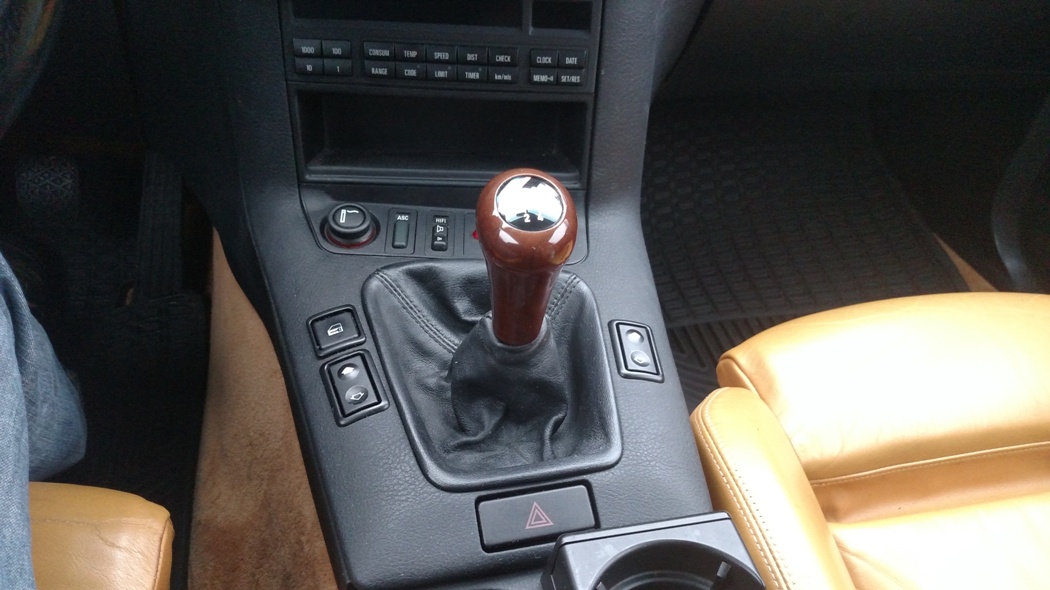

Rounding the corner, down to little items and refinements. Installed the trunk carpet and put a rubber mat down, put all my hambone stickers on, even did a grocery run. It was nice on Saturday so after a drive I washed the car, and parked next to the M3. Funny, the 3 never looked stodgy before. I'm definitely going to swap out the Hellas for something smaller, will put them on the Jeep.
And now that I have some more spare time on my hands its time to show the 3 some love. Replaced the cracked and peeling wood center console with a black piece. GOt it from ECS tuning, didn't have the cut out for the power locks, but a few seconds with the dremel fixed that.
Attached Image Attached Image Attached Image Attached Image Attached Image Attached Image Attached Image Attached Image Attached Image Attached Image Attached Image

QUOTE(Steve Pratel @ Mar 6 2016, 07:34 PM) *
Congratulations! A beautiful build!

Thanks guys, has been a ton of fun. This was my first P car. WONT be my last.
I was just about ready to do a hotrod/modern handling restore on an 86 Olds 442 when I found this 5 years ago, its safe in a garage back east. I'm ready for the next project ;-) Been looking at several options, want to go Targa or convertible, but I'm only 6 years from retirement with at least one more deployment to AFG/IRQ and likely a European Assignment, so will likely hold unless I come across a great deal on a long nose targa. I want to retire with a modern Targa or Convertible.
As for the rear windows, The PO added the pop out windows in 1980. Vent windows are fixed.

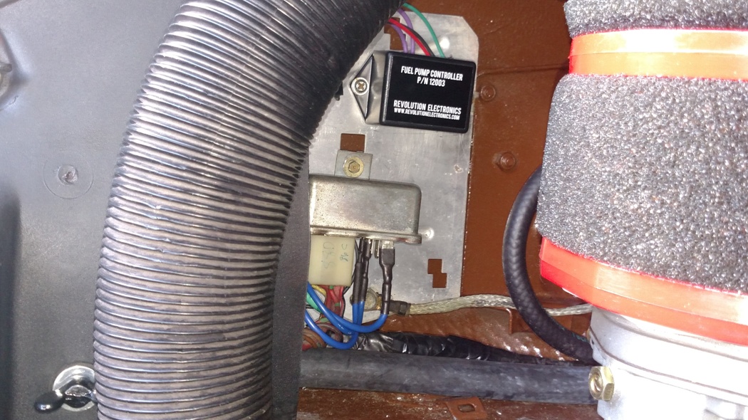

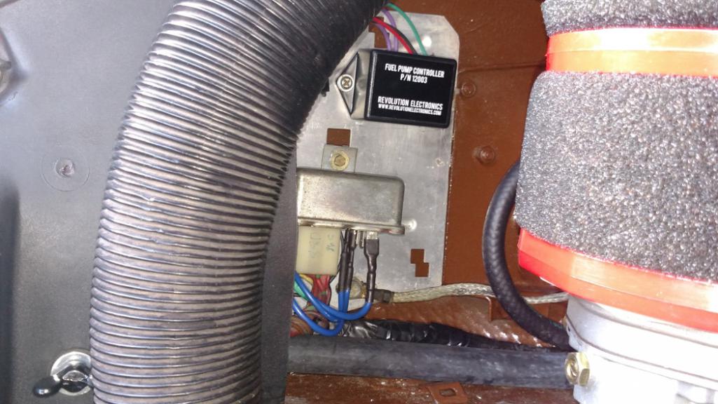

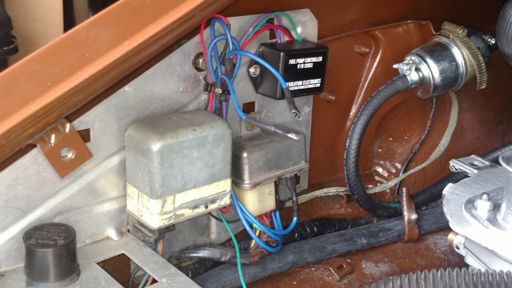

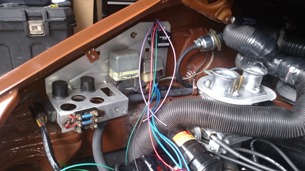

As part of my rebuild, I initially installed an oil pressure safety switch to run the fuel pump, this way if I leave the key on or the car stalls or am in an accident the pump won't continue to pump fuel into the engine compartment.
I kept the original wiring and fuel pump relays which activated the pump when in start and when there was a signal from the airflow sensor. I initially installed a Normally Open Oil Pressure switch, and when the oil pressure hit 4 lbs the contact would close and keep the pump running.
The only problem with this is that when the car sat for 2-3 days most of the fuel would drain out of the fuel lines and back towards the tank, essure. This meant that the car would often stall immediately on letting off the key because the pressure in the fuel lines wasn't up, and if the motor didn't crank enough to build oil pressure.
To prevent this, what I was doing was jumping the fuel pump, listen to the fuel fill the bows, then go and start the car, all was good. This was kind of a pain. I could have just jumped the relay and called it done, but that left me in the always on if the key was on. So I started doing some research and found this fuel pump controller http://www.revolutionelectronics.com/Fuel_Pump.html among others.
The advertisement says the pump runs 3 seconds at initial key on, but mine runs 10 seconds then shuts off. This allows proper priming of the fuel system, and will shut off if the engine stalls because it gets a signal from the negative tach lead.
Of course I have no idea how long this thing will work, so I also built in a jumper to the wiring, so if this controller decides to crap out I can just plug & be back in business. Not bad for $60, I got mine cheaper on Amazon, and I am sure there are other options.
If you are converting to carbs and dont want to run the fuel pump 'on' all the time with the ignition, this is a great solution. Easy to wire in and go.
