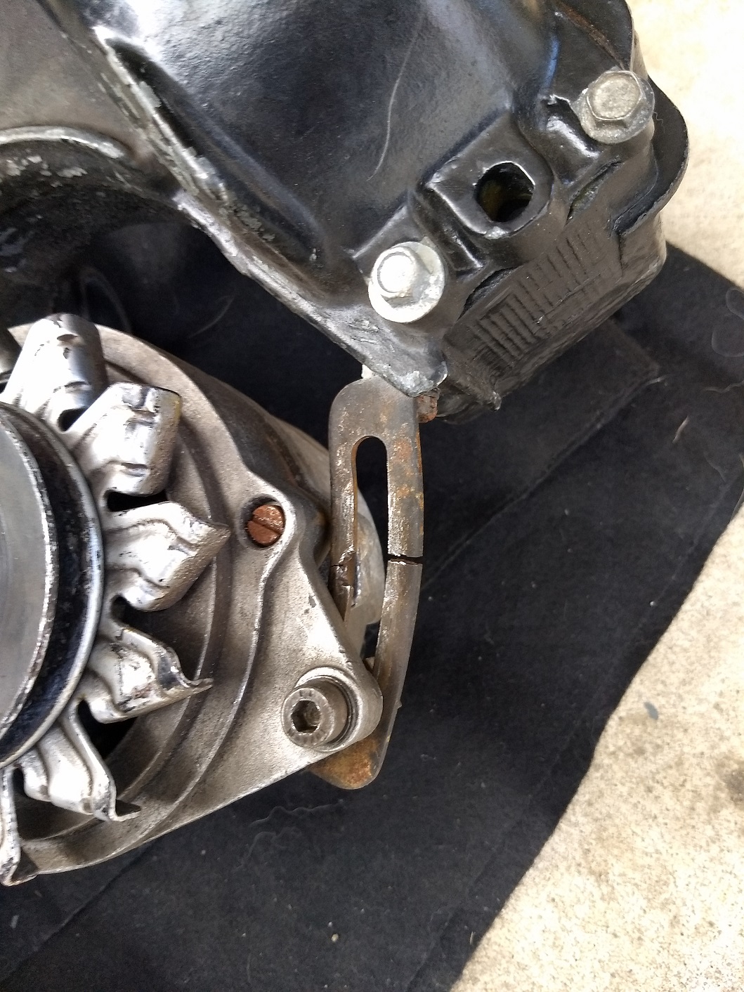

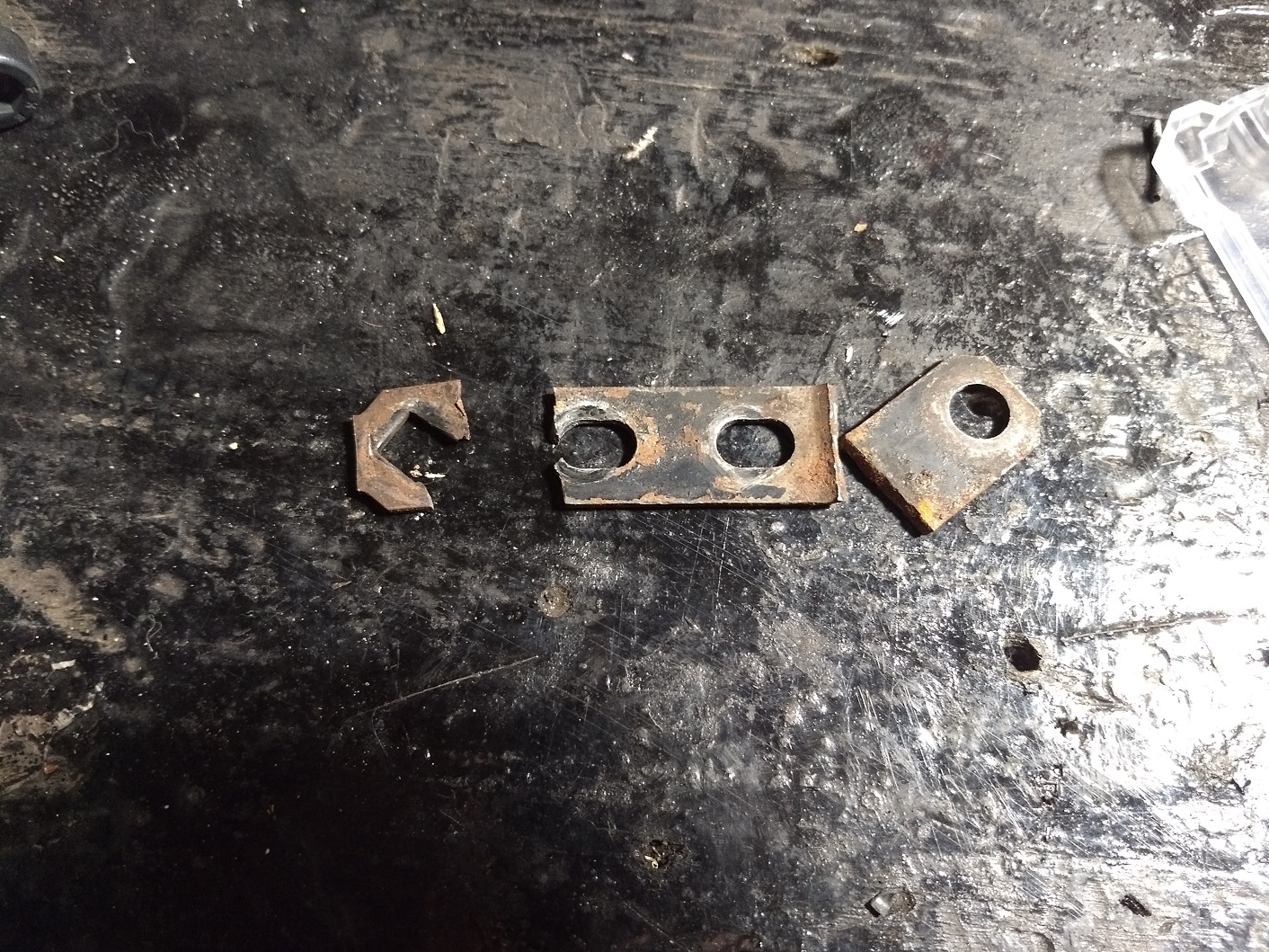

Well.............. Bracket slayer strikes again........... Bracket #4 (or maybe 5) is broken. I put a backer plate on and it lasted about 5K miles, but was heaidn out for a drive saturrday and once again it broke. Between this and the terrible belt eating pulleys I'm DONE...........
Time to look at either a DTM or FAT 911 style. There was a guy at Hershey selling a full FAT system, should have grabbed it.
Anything newer or better for the Type4/914 Motor? Insert a few minutes of cursing............. lol
Other than that, everything is running great!

Finally took the time to address my latest broken bracket. Went through the routine, replaced the lower bracket and noticed the upper was cracked too. Made sense as have been driving the car, mostly short trips no more than 10-15 miles from home figuring I could drive back on battery if it threw the belt. It didn't, but was basically hanging from top bracket, which cracked it..... sigh.....
So this time I took out the entire fan housing again, swapped out both brackets. Probably did it right for the first time (IMG:style_emoticons/default/poke.gif) Taking both off forced me to have to ensure proper alignment with not only the fan, but also in relation to each bracket and range of motion on the slide bracket.
Til now I have basically swapped out the bracket and called it done. I THINK the alternator was in effect mounted crooked, and put pressure/twisted the lower bracket, causing it to crack and break. It basically broke in the EXACT same place every time. (IMG:style_emoticons/default/blink.gif)
This time, I took measurements to see where the brackets needed to be so the pulleys lined up, then took the fan housing off the motor, mounted the brackets sightly tight and the alternator to the brackets finger tight and played/adjusted tapping here and there to make sure that the alt slid freely on the slide bracket and while doing so put no torsional stress on the lower bracket, and most importantly, when pressure is put on the alternator on full acceleration. Now it appears to be properly square and aligned. I can see that I had both brackets cocked a bit in the past, and this is hopefully what caused the bracket slaying.... I didn't think it was that much of a big deal.... but... Going on a 300 mile drive today, lets see how it hold up!
Broken Lower Bracket
Cracked upper bracket

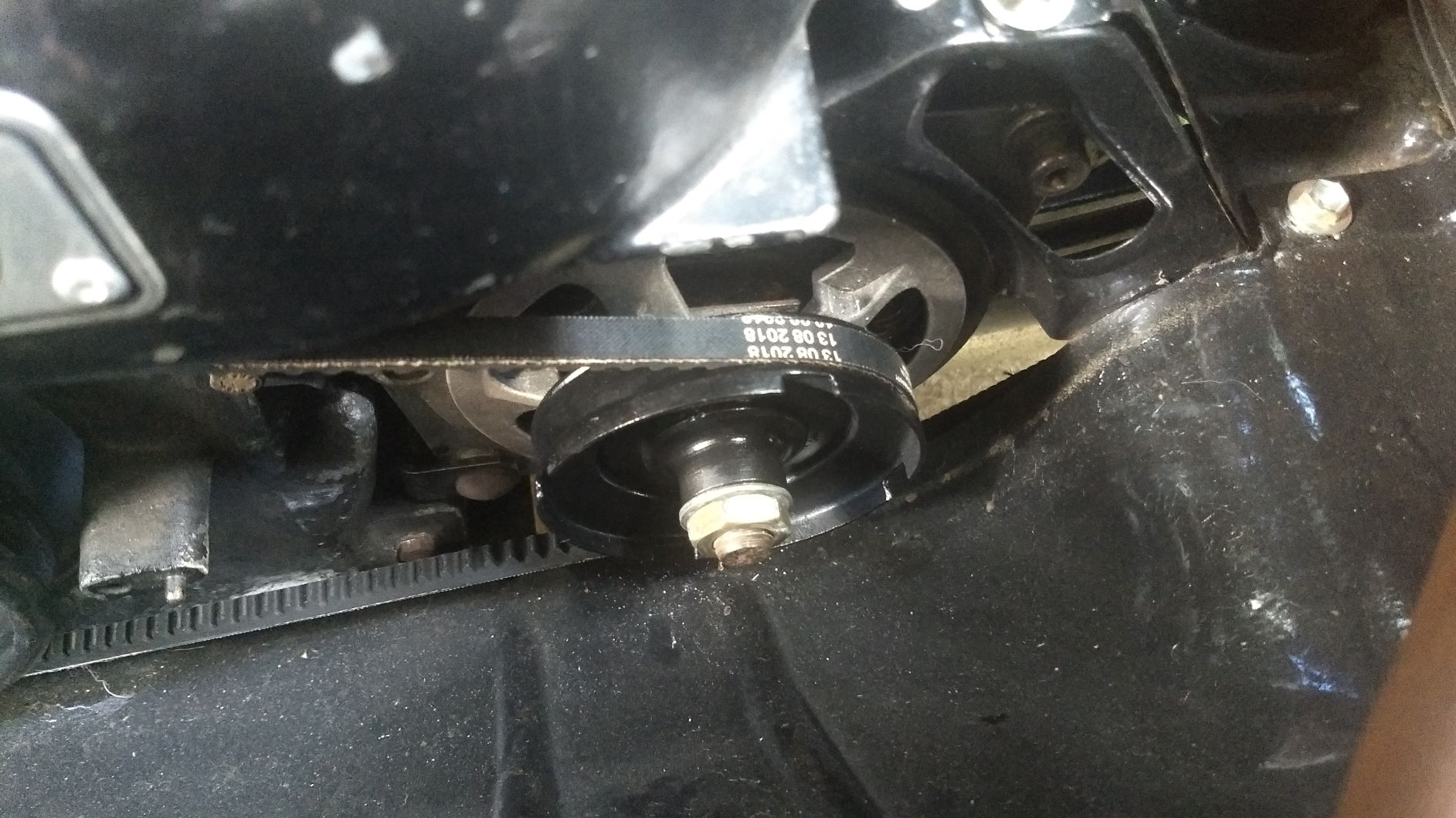

I think I finally have the alternator bracket situation sorted. The stock pulley ate belts at a 500 mile rate, and once adjusted to the full extent, the bracket would break. I ended up buying a re-manufactured alternator for a 914, pulled the pulley and put it on the alternator, put on a new belt. Between the total realignment back in March, and pulley, 2K miles later, belt is wearing well, and in a 'healthy' adjustment range, so no broken brackets anymore (crossed fingers). Now I just need to sell the alternator.... lol.

Here is the new pulley. 2K so far. Hoping after a run to Hershey next Spring to take the car on a Tour of the Kentucky Distillery's with the wife.

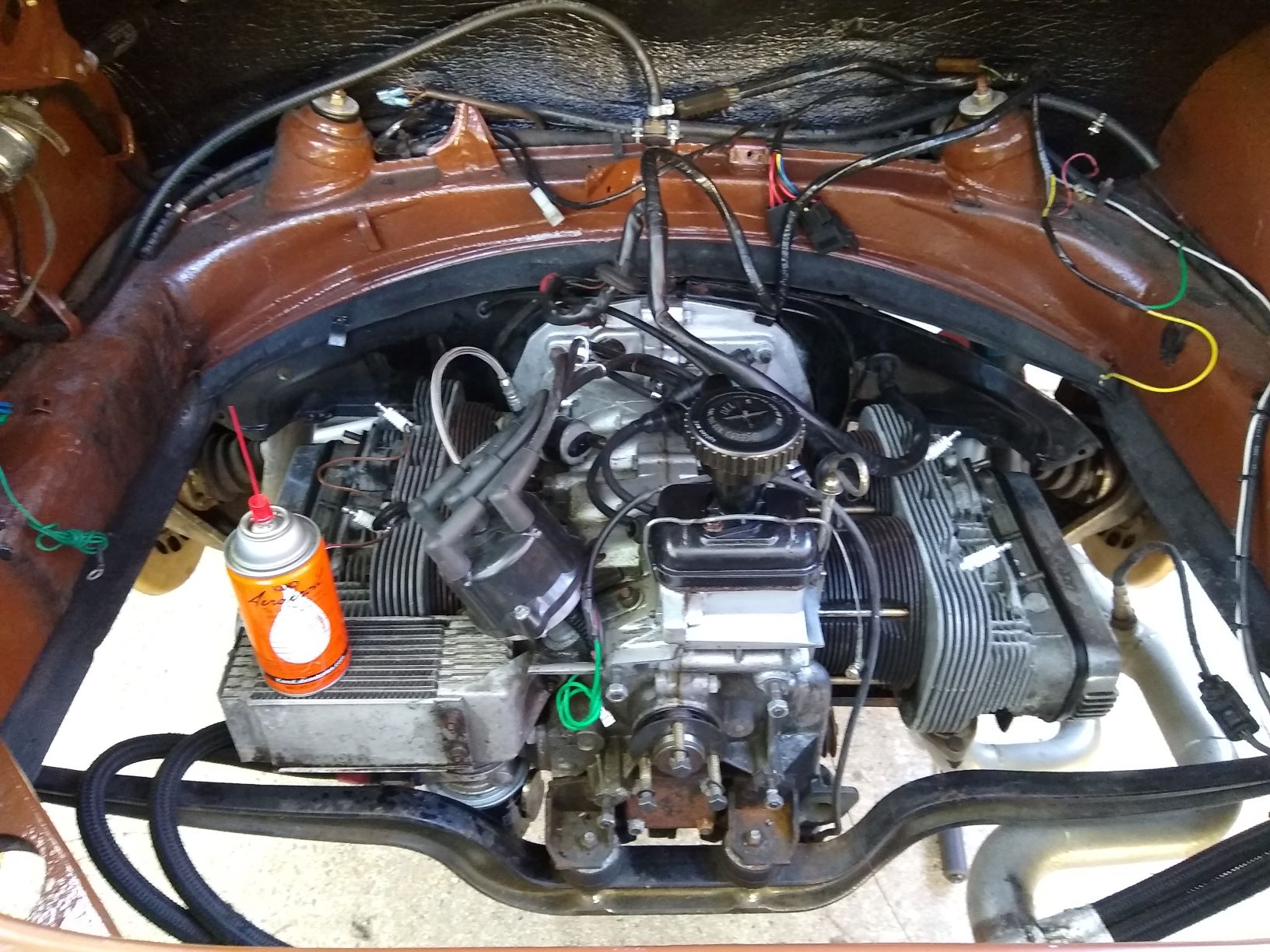

Current state of affairs as I prep to convert to the Tangerine Cooling system and stainless pushrod tubes. I'll also be swapping out the starter with a hi-torque unit and installing an external cooler with fan in place of the stock unit.
Overall, pretty happy with how it all looks after 5 years and 15K miles.
2 quick questions.
1. As I'm going to be changing out the pushrod tubes, and all the upper valvetrain will be removed, is this a good time to re-torque the heads? If I do this, should I do them one at a time, or back all off slightly and then retorque?
2. Anyone know of a fuel filter with a check valve that works with the low pressure pump? Tired of the fuel being sucked back to the tank after I shut the car down.
Will post pics of updates as they go.
