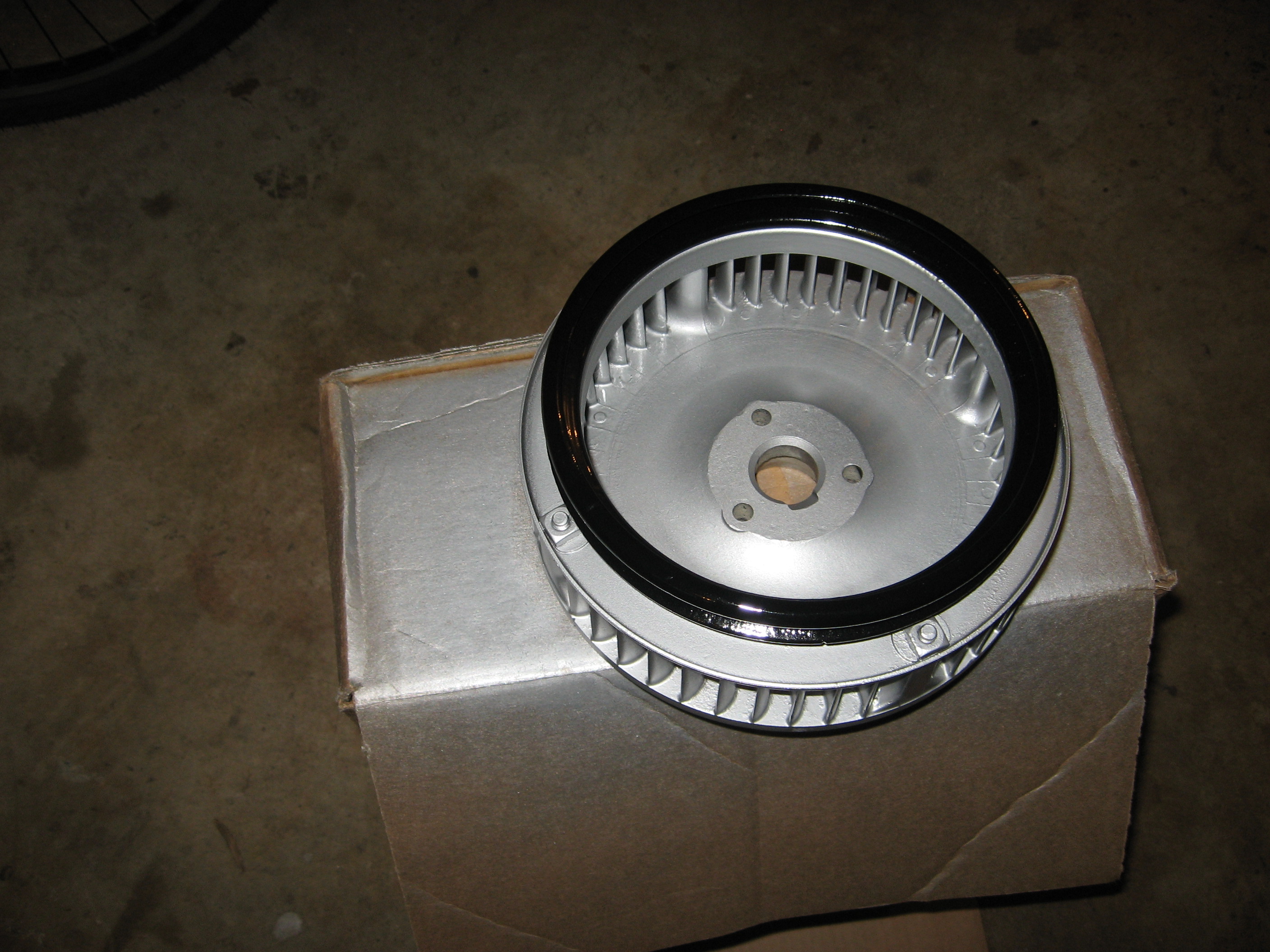

And the fan is finished being blasted and painted. The pulley metal was very rusty so I removed the rust, and between wirebrush, sandpaper and a grinding stone on my dremel and smoothed it down to metal as good as possible, then used Eastwood Rust encapsulator once that cured for a couple days, I topcoated with PJ1 case paint. After curing for 2 days I then baked it at 200 for an hour to fully cure and complete the ceramic hardening. Then painted fan housing with silver and baked. Tomorrow I hope to pick up my crankshaft remount the front bearings and gears and get back to the mechanic for balancing with all the parts.Attached Image
euro911
post Nov 19 2013, 08:14 PM
Post #57
Posts: 8,945
Joined: 2-December 06
From: So.Cal. & No.AZ (USA)
Member No.: 7,300
Nice. I can already tell how the rest of the motor is gonna look (IMG:style_emoticons/default/thumb3d.gif)
