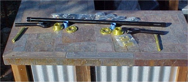

Install the largest you can afford.
31mm here.
KT

yes, sorry.
For a road only, not tracked or autocrossed, driven at the speed limit car, a stock bar would probably be enough.
If you plan on hammering the back roads like a wild man, which I suggest you don't, get a big bar.
The big bar I added, transformed my car from a swaying questionable ride into a tight, dialed, on rails experience.
I have it turned 1/3 to full stiff. Stock front torsion bars, Koni yellow's, 200# rear springs and stock rear sway bar installed.
KT
